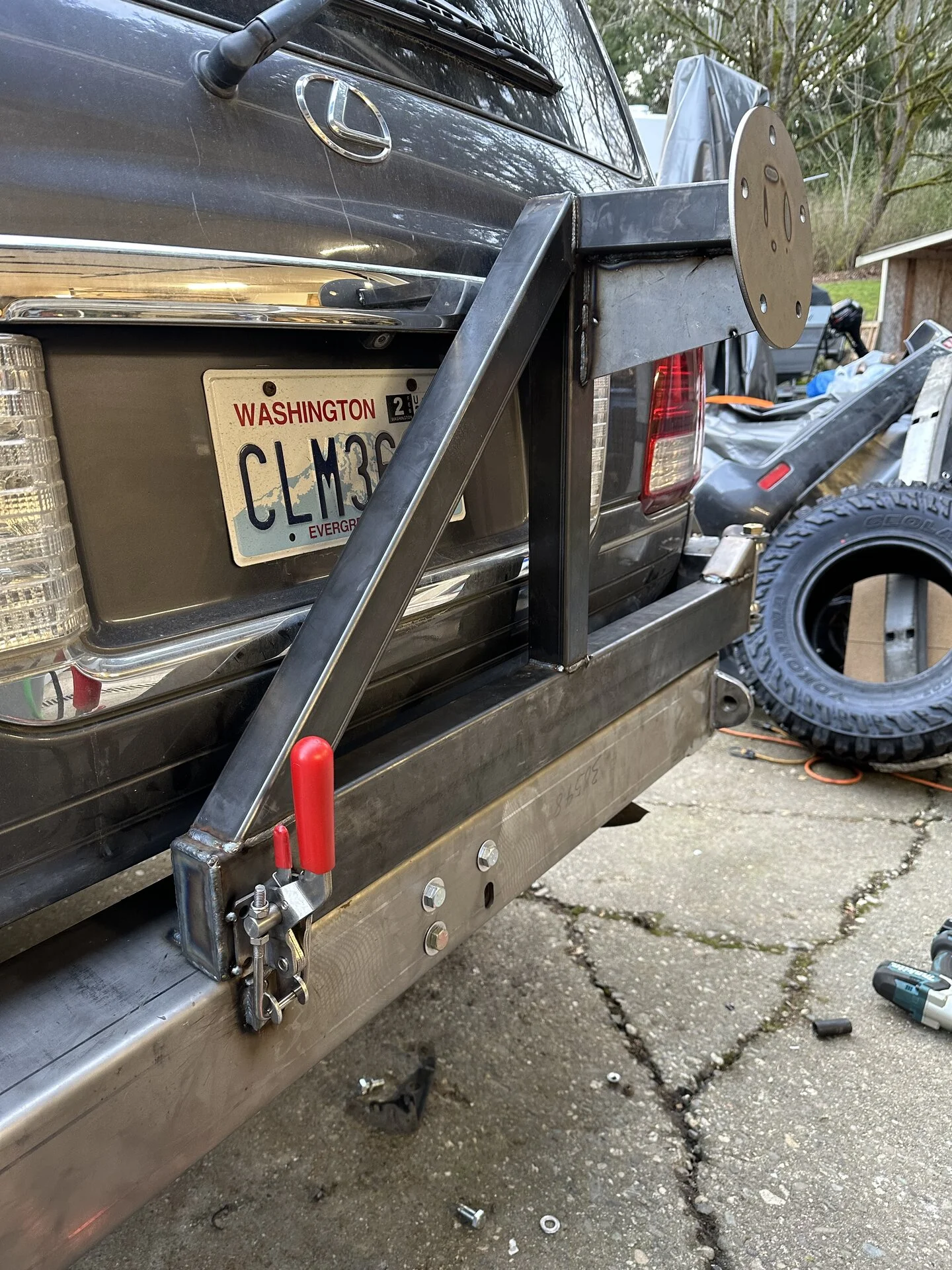

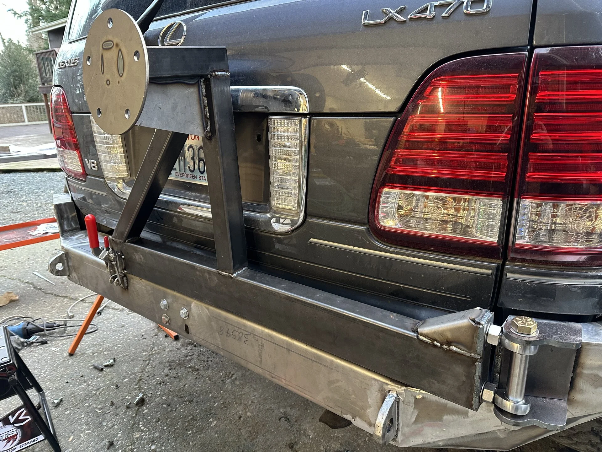

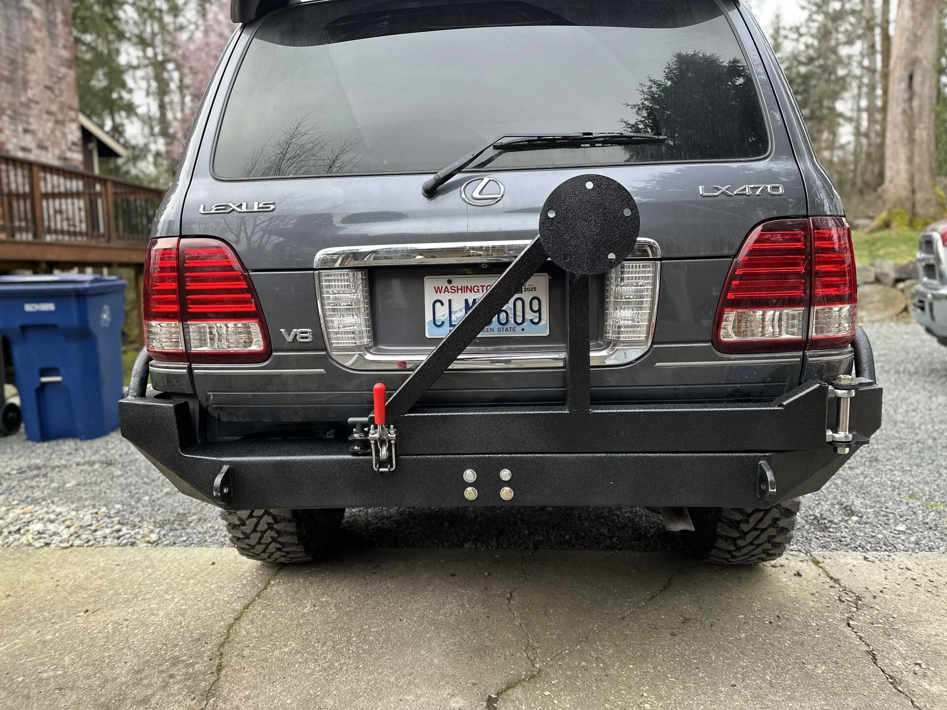

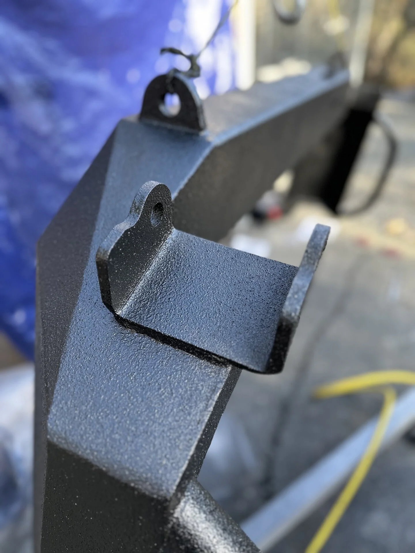

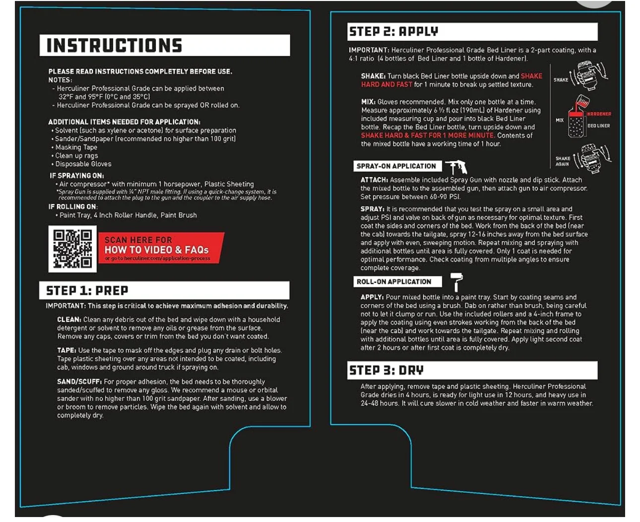

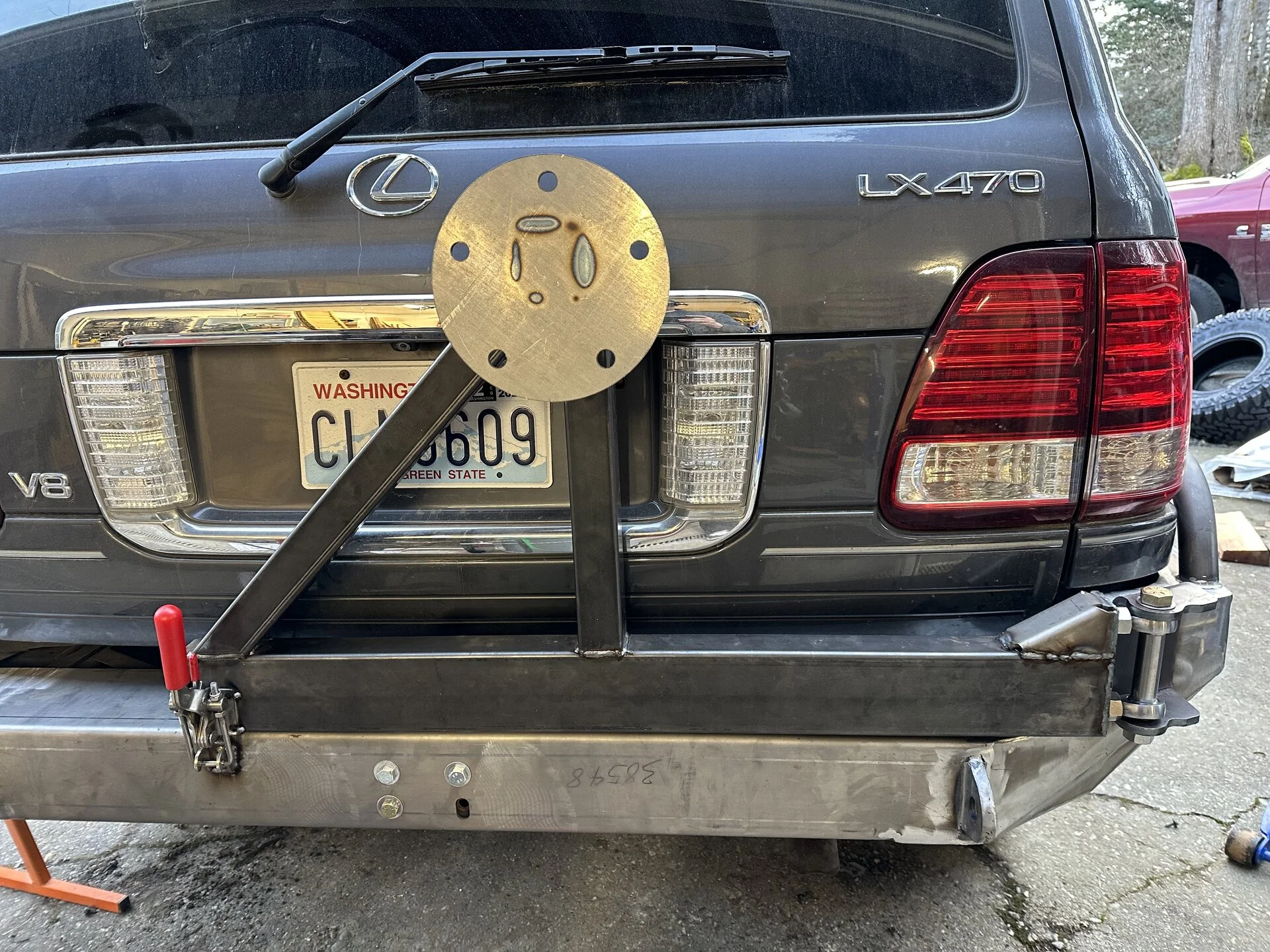

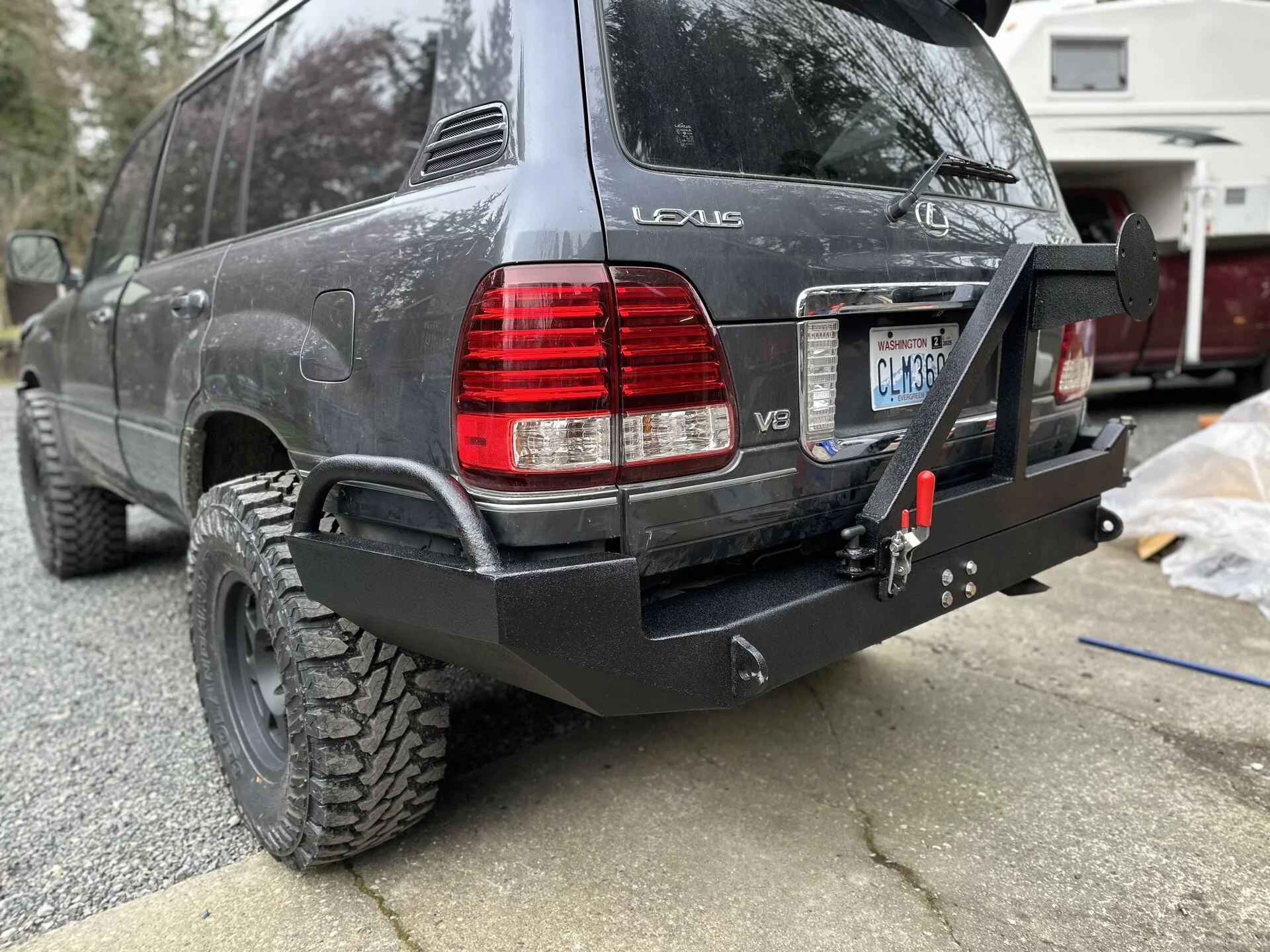

Now to build the spare tire carrier. Once that is finished up will finish sand and prep for spray. Going to spray with Herculiner bed liner I think.
Impressive progress for a first time welder :-)
Does herculiner require a primer? I did a 2 component epoxy primer on the bare metal before raptor’ing my van.
BTW:
In case you want a bit smoother surface you can usually thin down the liner and use a HVLP gun. I did 15% thinning and a 20$ HF HVLP gun with 1.4mm nozzle and the surface is kind of in the middle between typical bedliner and regular paint.
Impressive progress for a first time welder :)
BTW:
The kit has a spray gun, so I’m gonna give that a go. I watched a ProjectFarm test of these bedliners and this one had a good score… so figured I’d give it a try. If I recall the Rustoleum was solid as well.
Good idea on thinning it. I might have to give that a go. I’ll have to look at what’s in this stuff and see what I can thin with. Do you recall what you used?

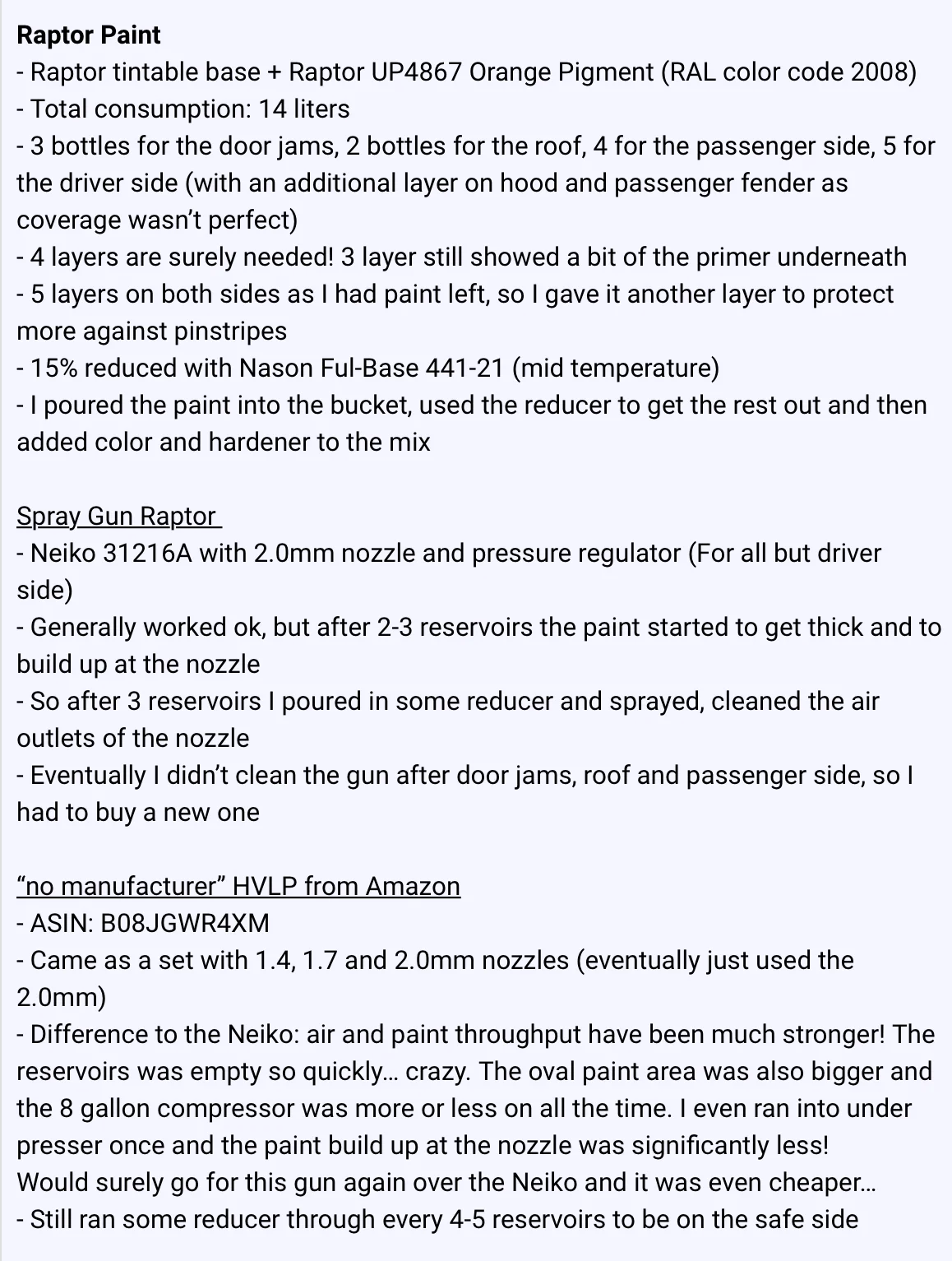

Screenshot of my writeup at the sportmobile forum and the link
That orange paint job is wicked. I love it.

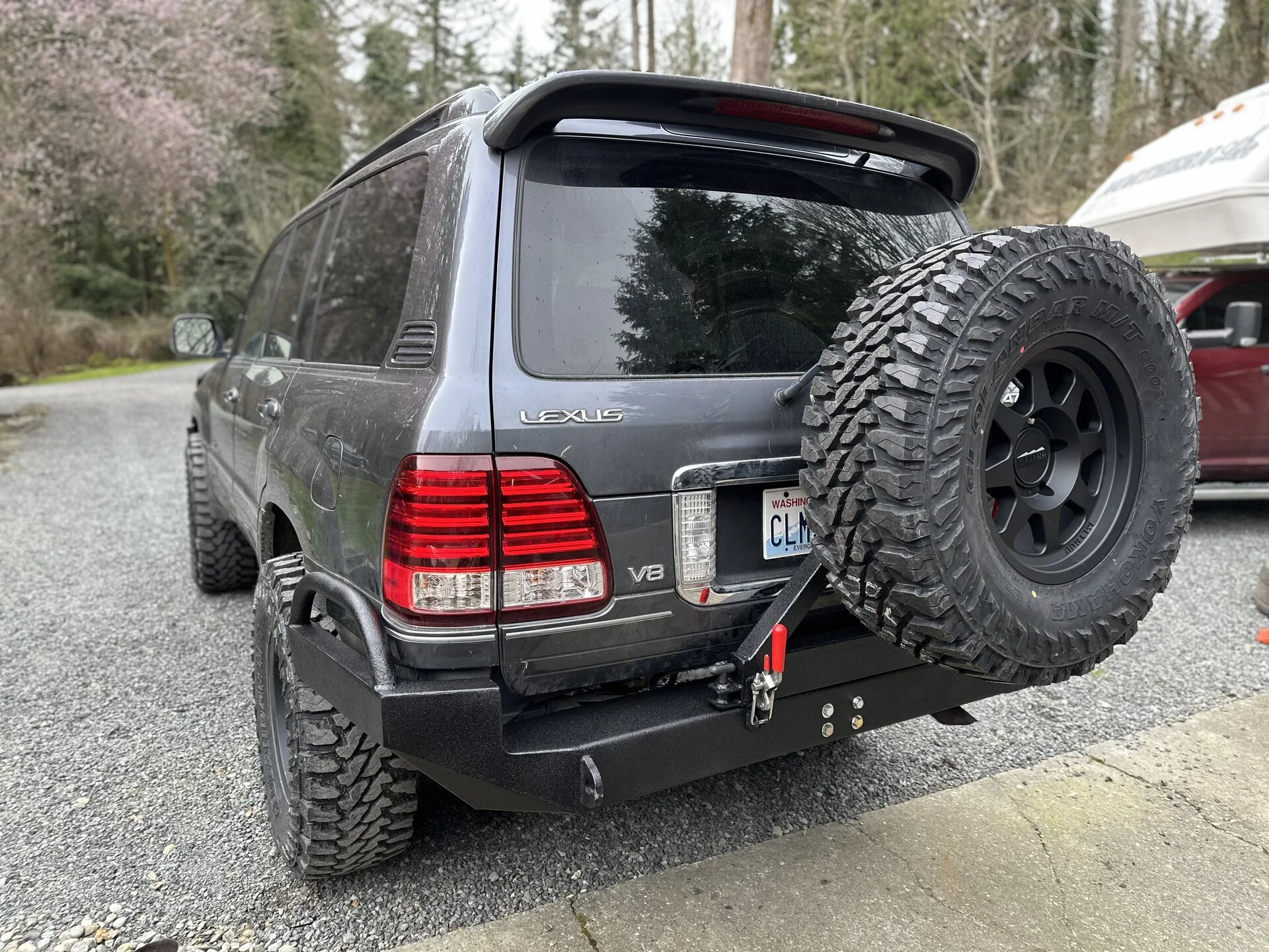

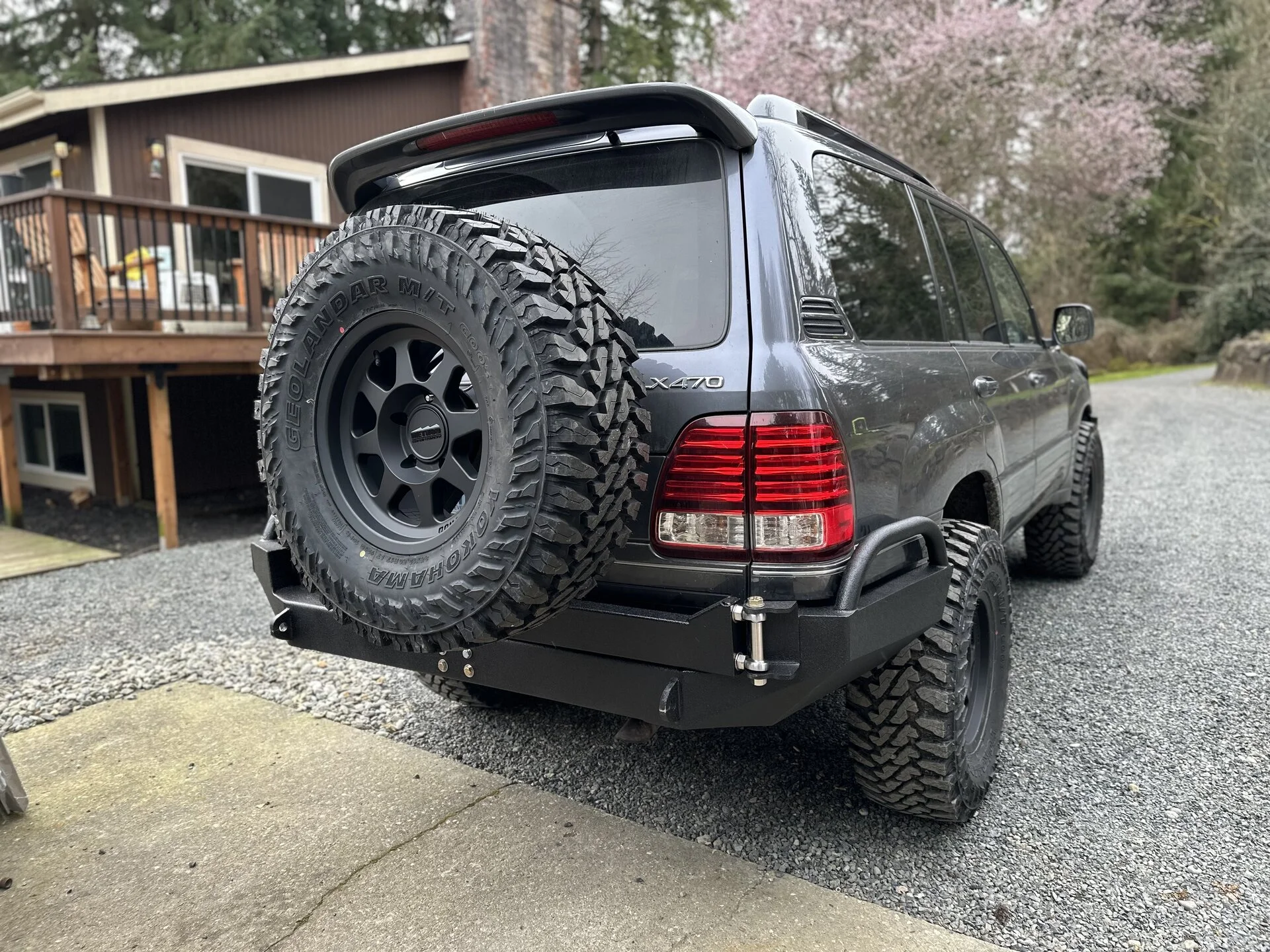

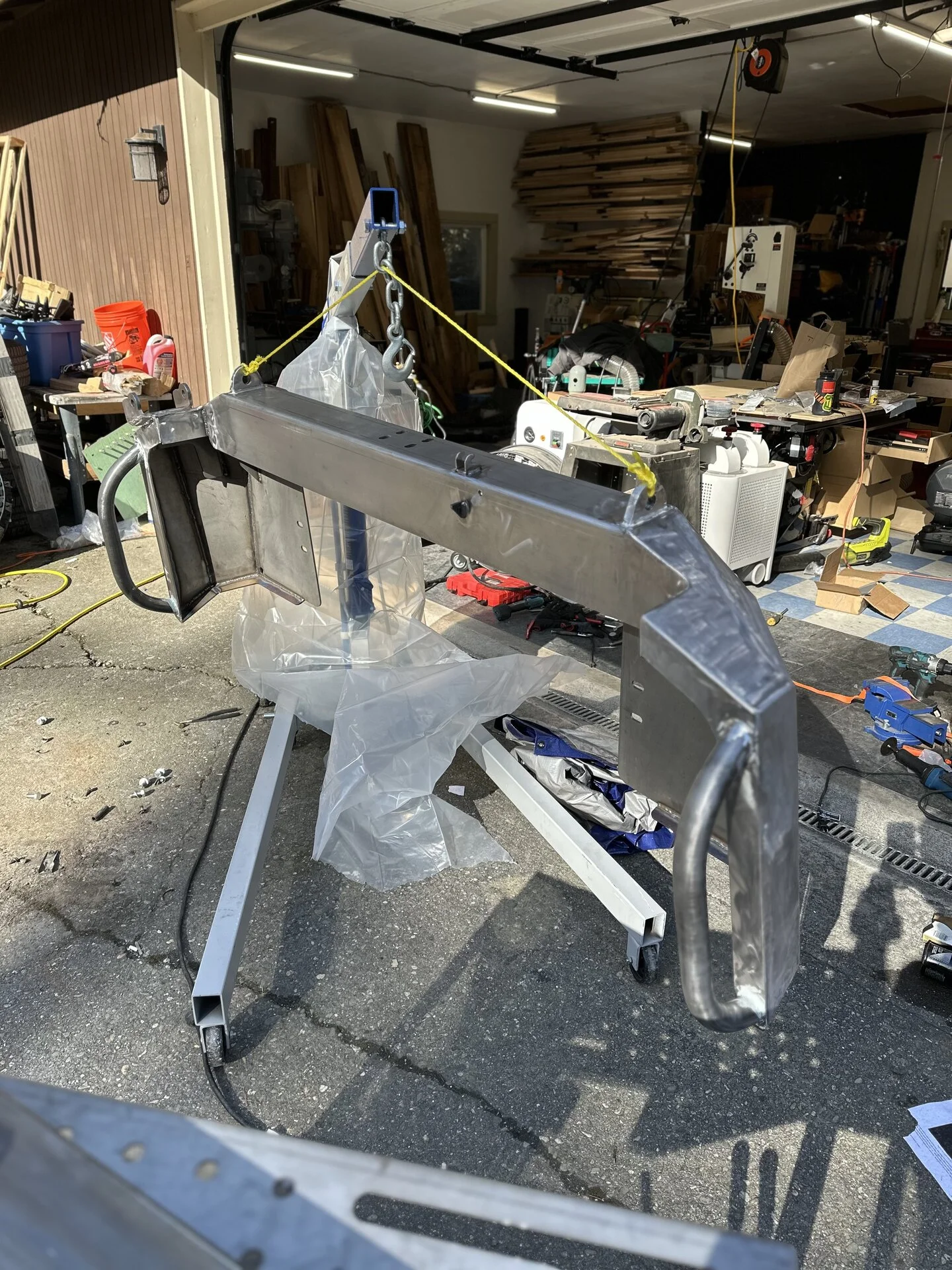

Looking towards the final “armor”. I ordered white knuckle sliders originally. Will have to call and see if they have started build. But…now that I have the welder I’m considering cancelling if they haven’t started and putting the money towards tools instead and trying to build my own…..

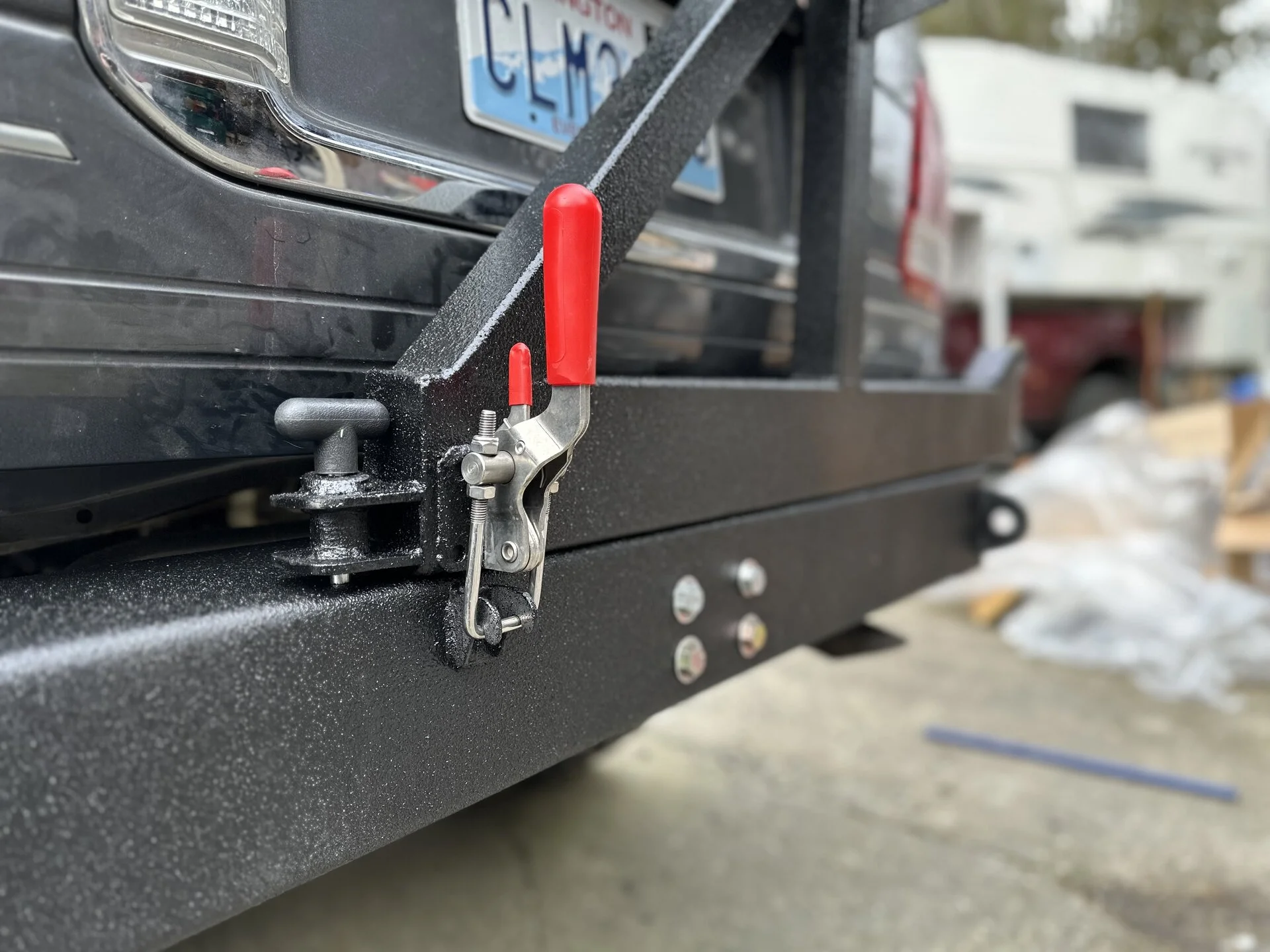

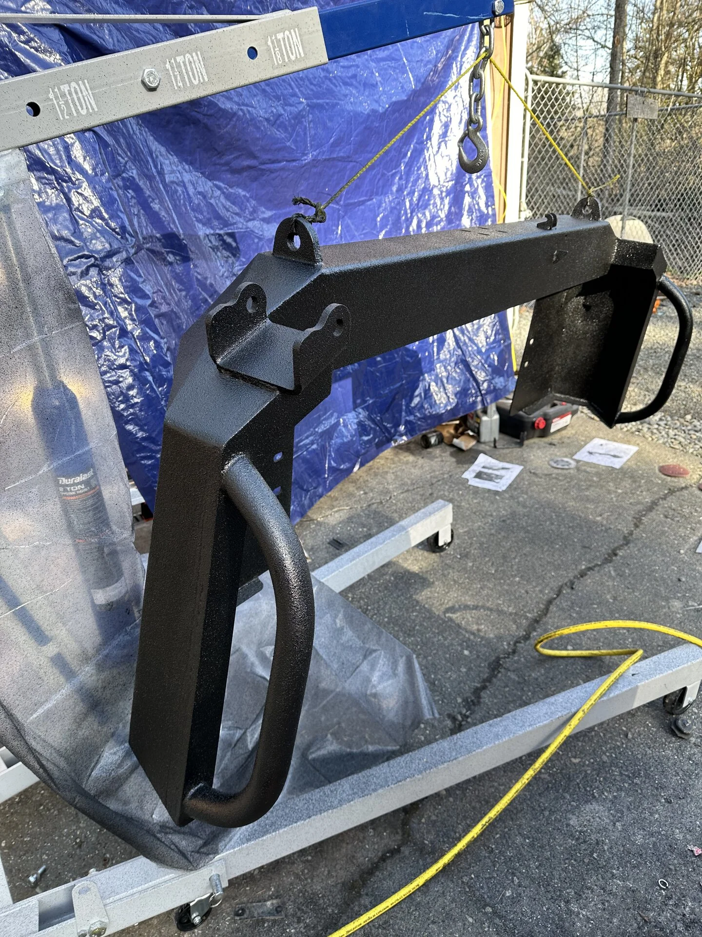

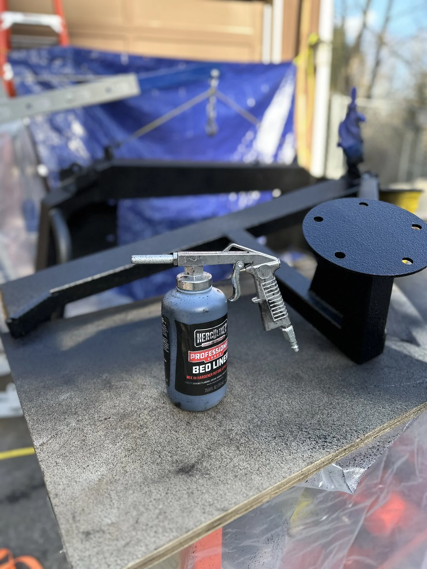

Going to dry overnight and get on tomorrow!

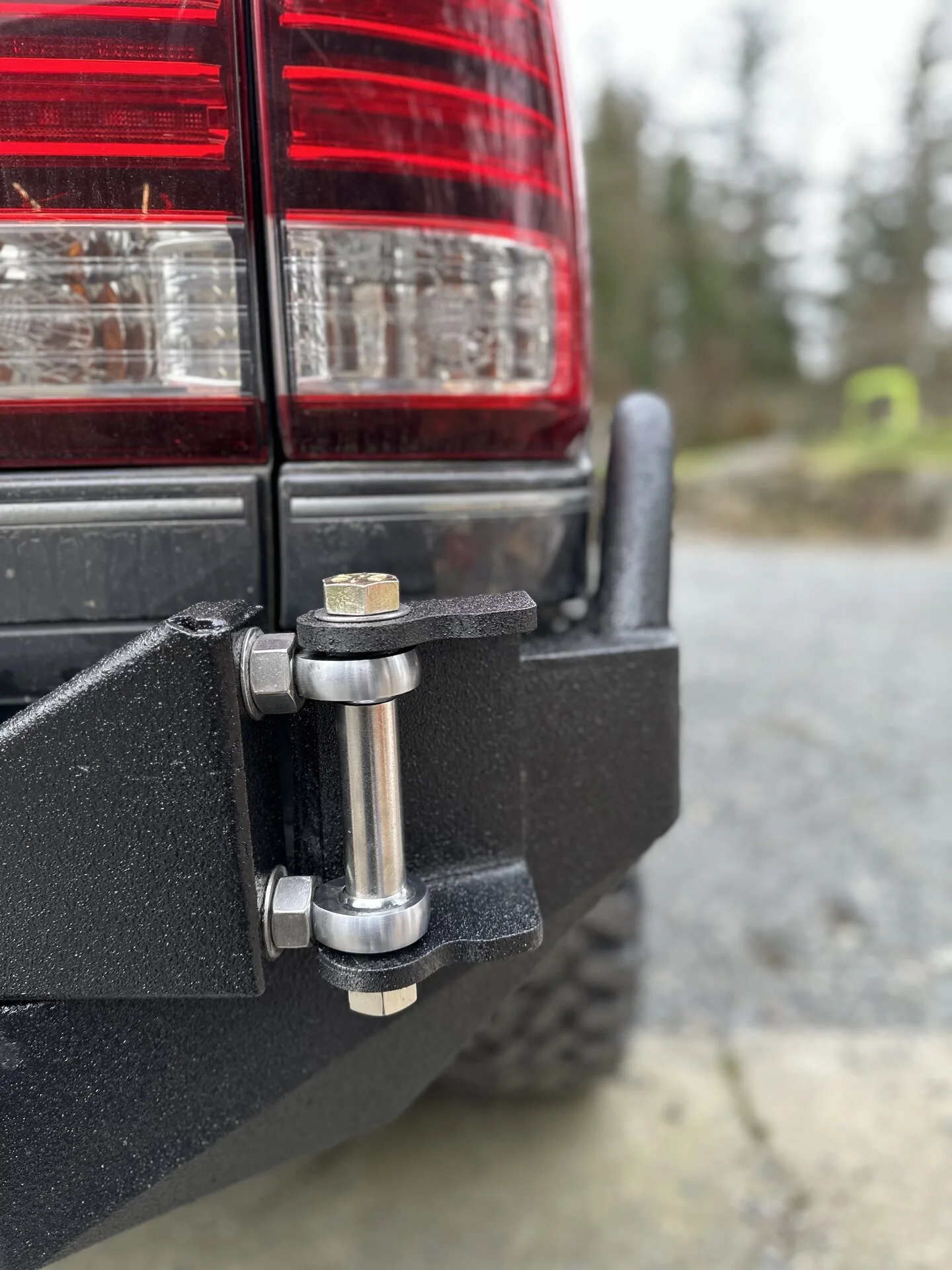

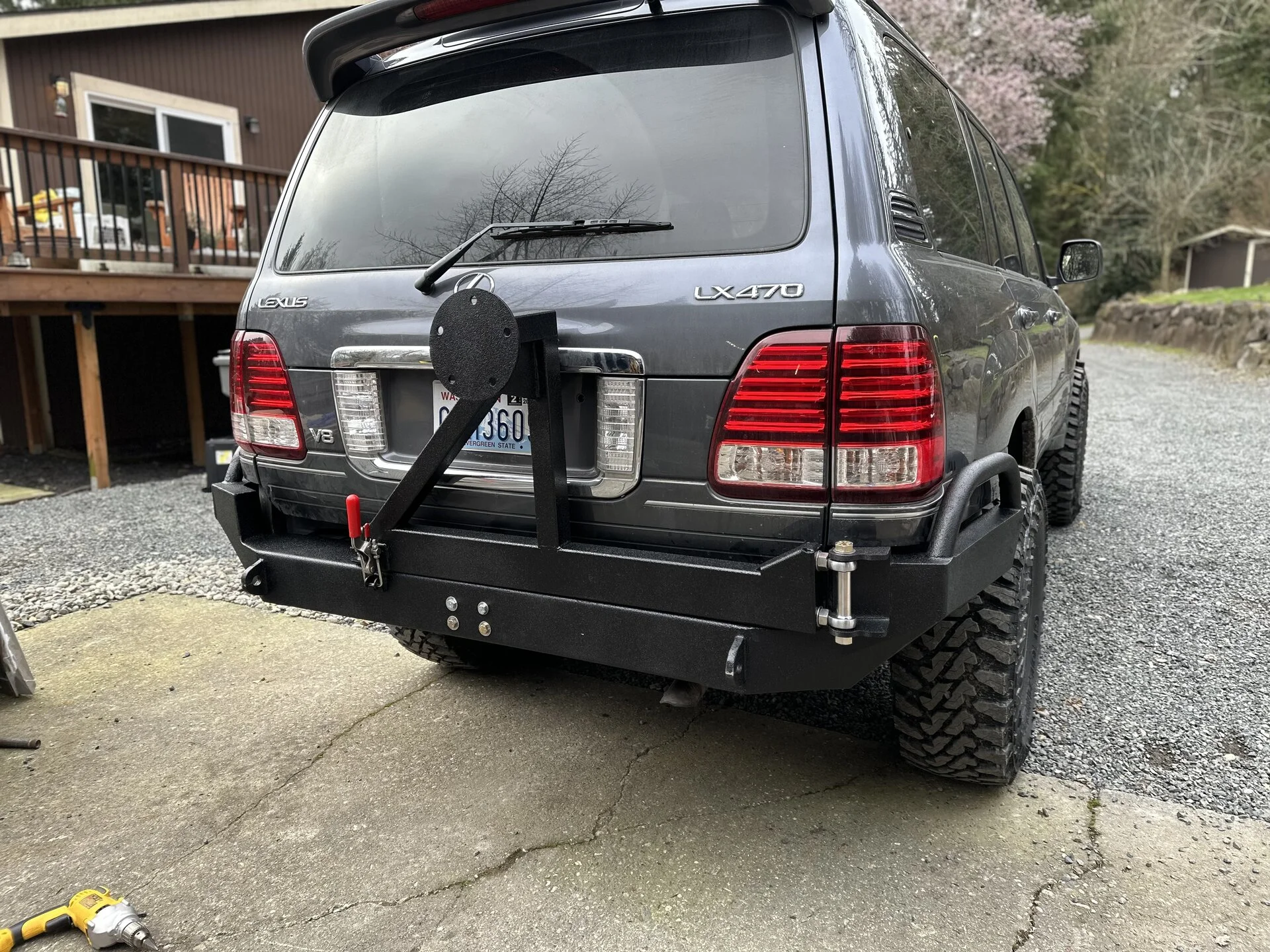

Spraying went well. Minus accidentally starting without eye pro and splattering myself. One of these days I’ll have a spray booth for wood and this crap, but until then will continue to remain half assed in my spray setups.
You welded, painted and installed it in less time than I took to just install a Dissent rear bumper. LOL.
Good work!

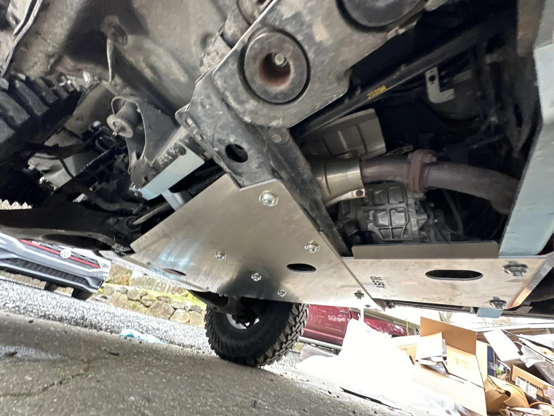

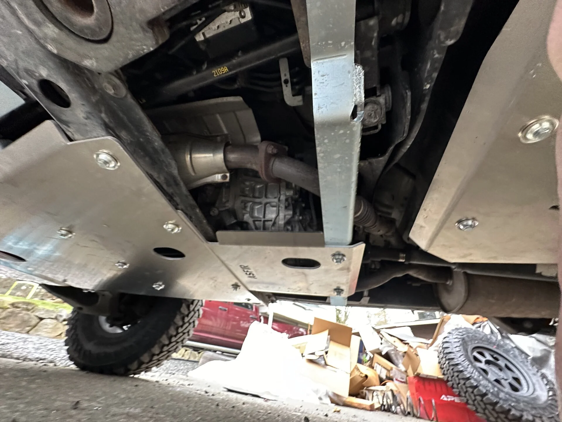

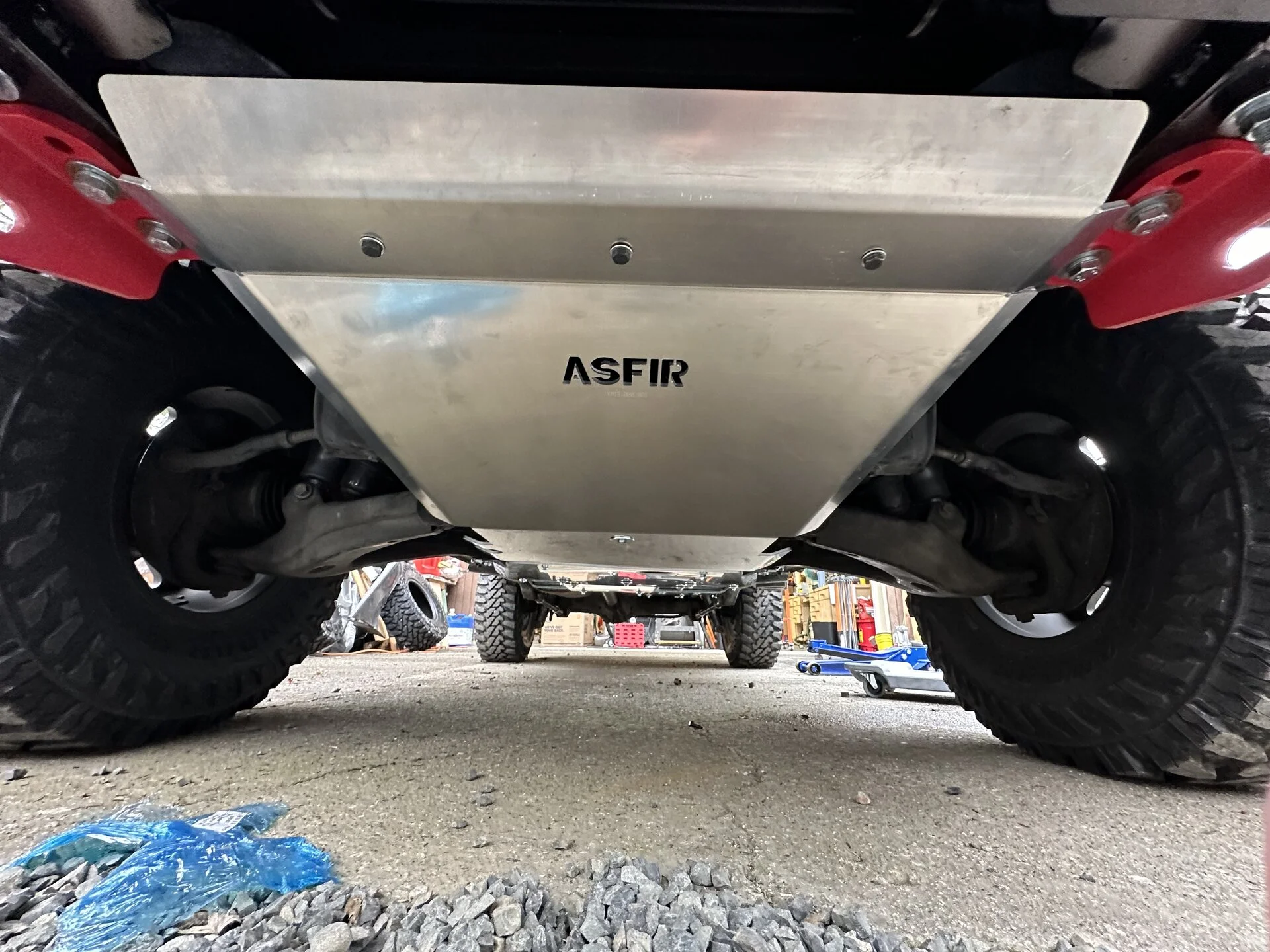

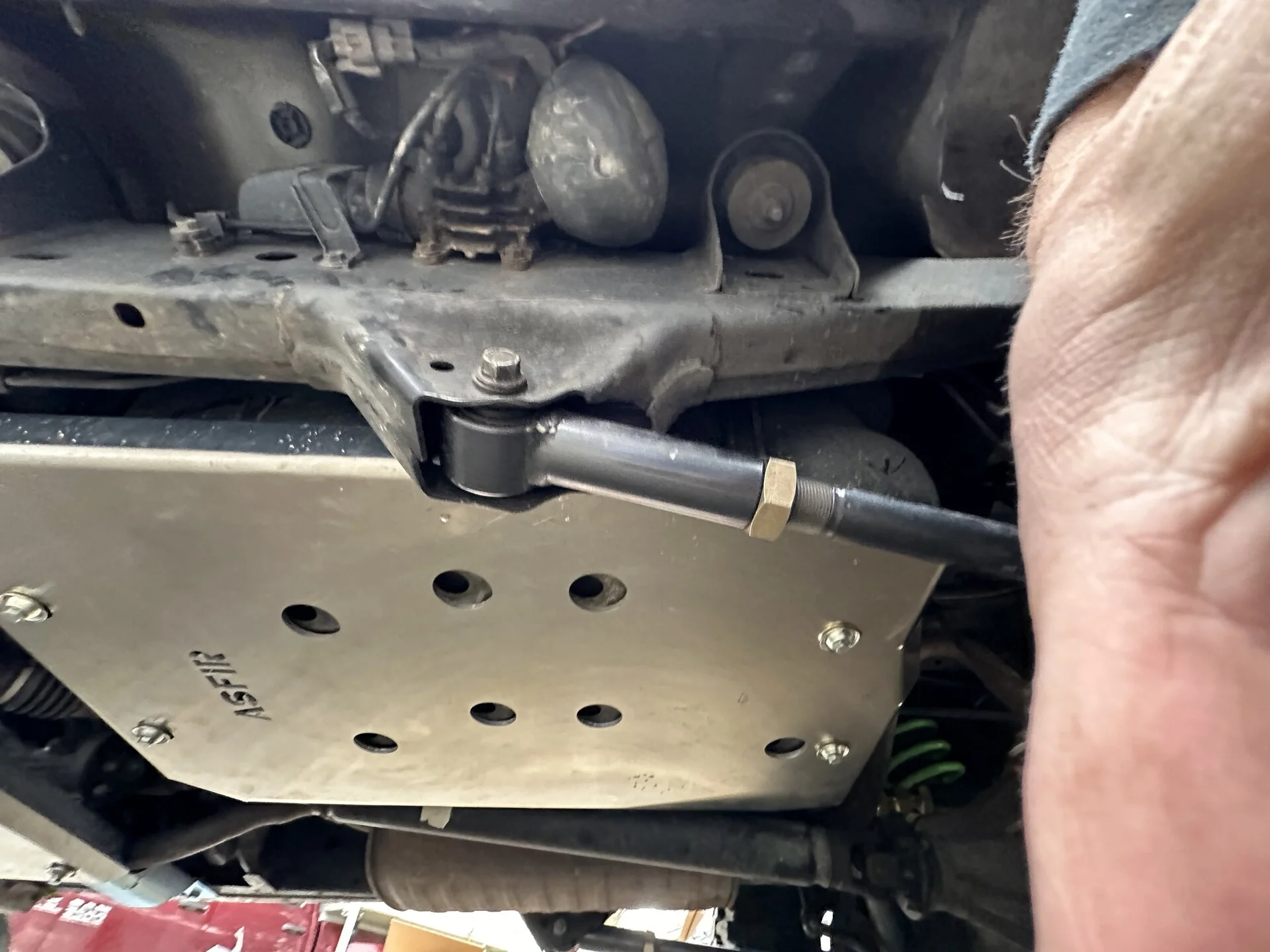

Well. ASFIR full skids installed. I’d honestly rather rebuild the entire bumper from scratch than put those on again. Constant frustration with 50% of the fasteners being too short and having to run to hardware store multiple times. Ended up having to build some spacers for the transmission skid. With the diff drop I was able to use the supplied diff drop spacers and make the front skid work ( needed longer bolt for middle one). But wasn’t expecting to need spacers for the transmission one.
Probably user error like most s*** I do 😂.
Anyways. They are on. Was considering pulling front diff for ARB locker, but the skid plate is going to be my crutch so maybe I’ll wait a few weeks 😆.

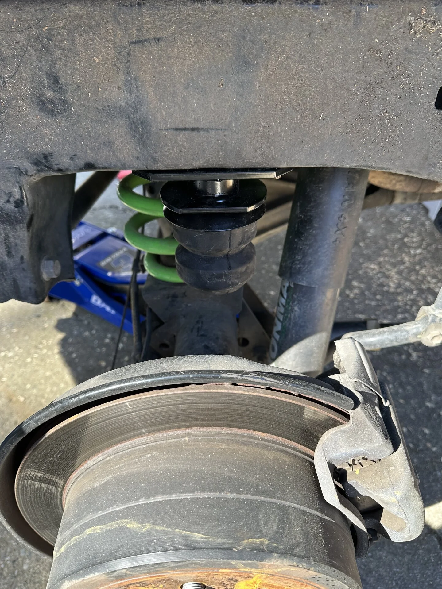

Well. Pulled off the rear shock to put on the dust cover I had forgotten initially. I recall the thread going on easily on install, but it was absolute hell to get off. I think some mud got up there and dirtied the threads and the nut started seizing. Ended up re-threading the shock and nut and install was cake after that.

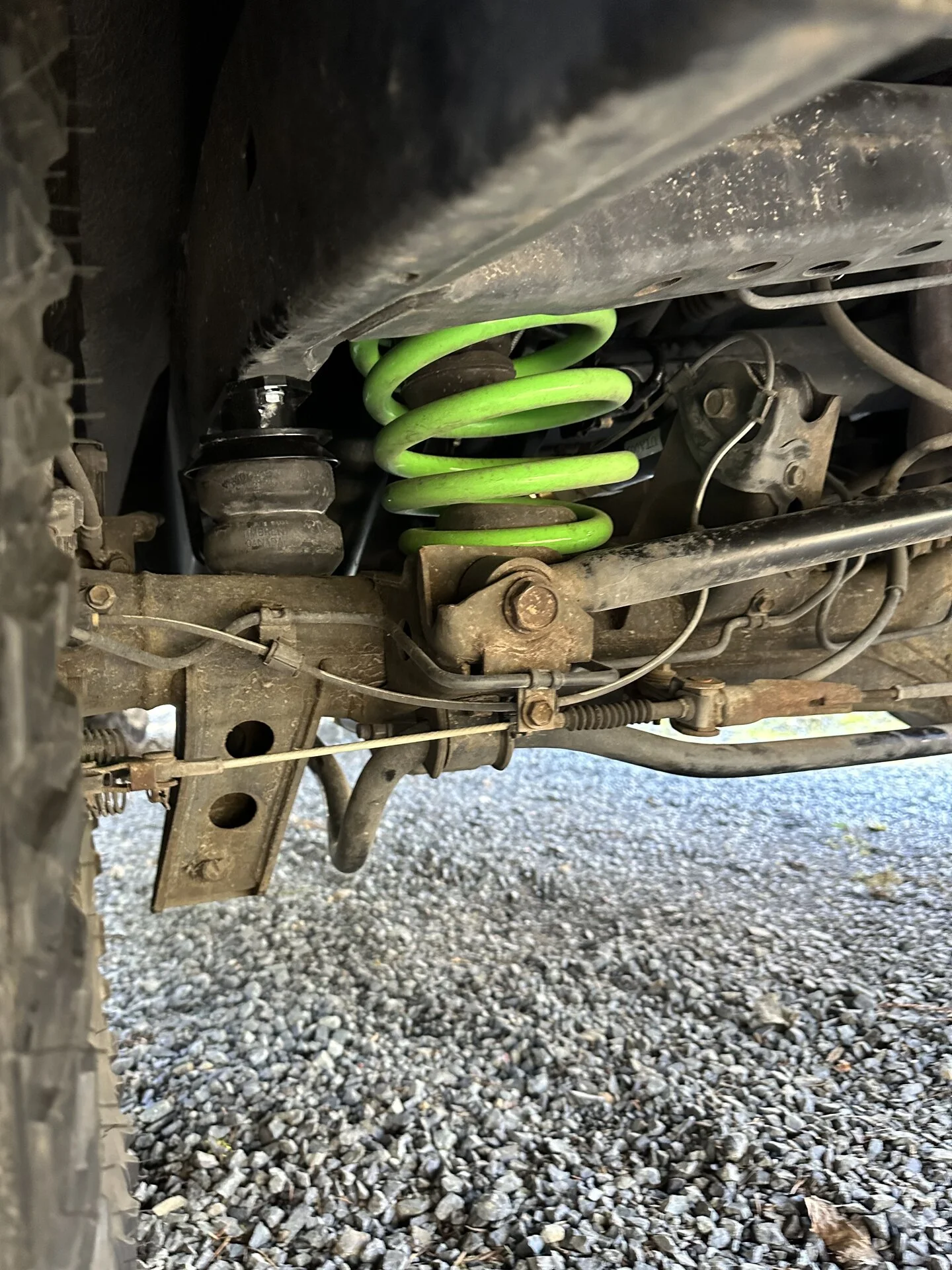

Threw on the rear Timbren bumps while I had the wheels off.
Still need to put the front driver bump (rear one) on, but the bolt is broken deep inside. Just need to find some copper tube so I can weld up a bead/nut and get out.

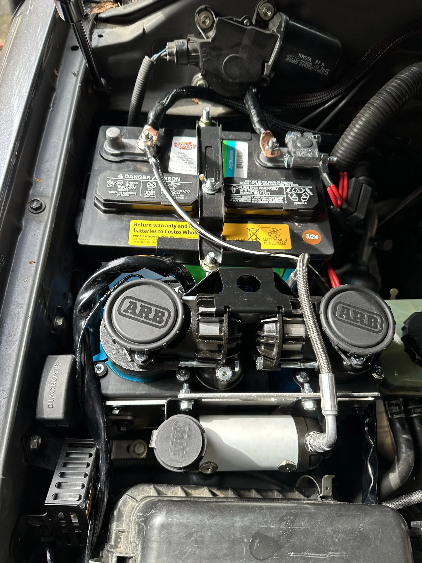

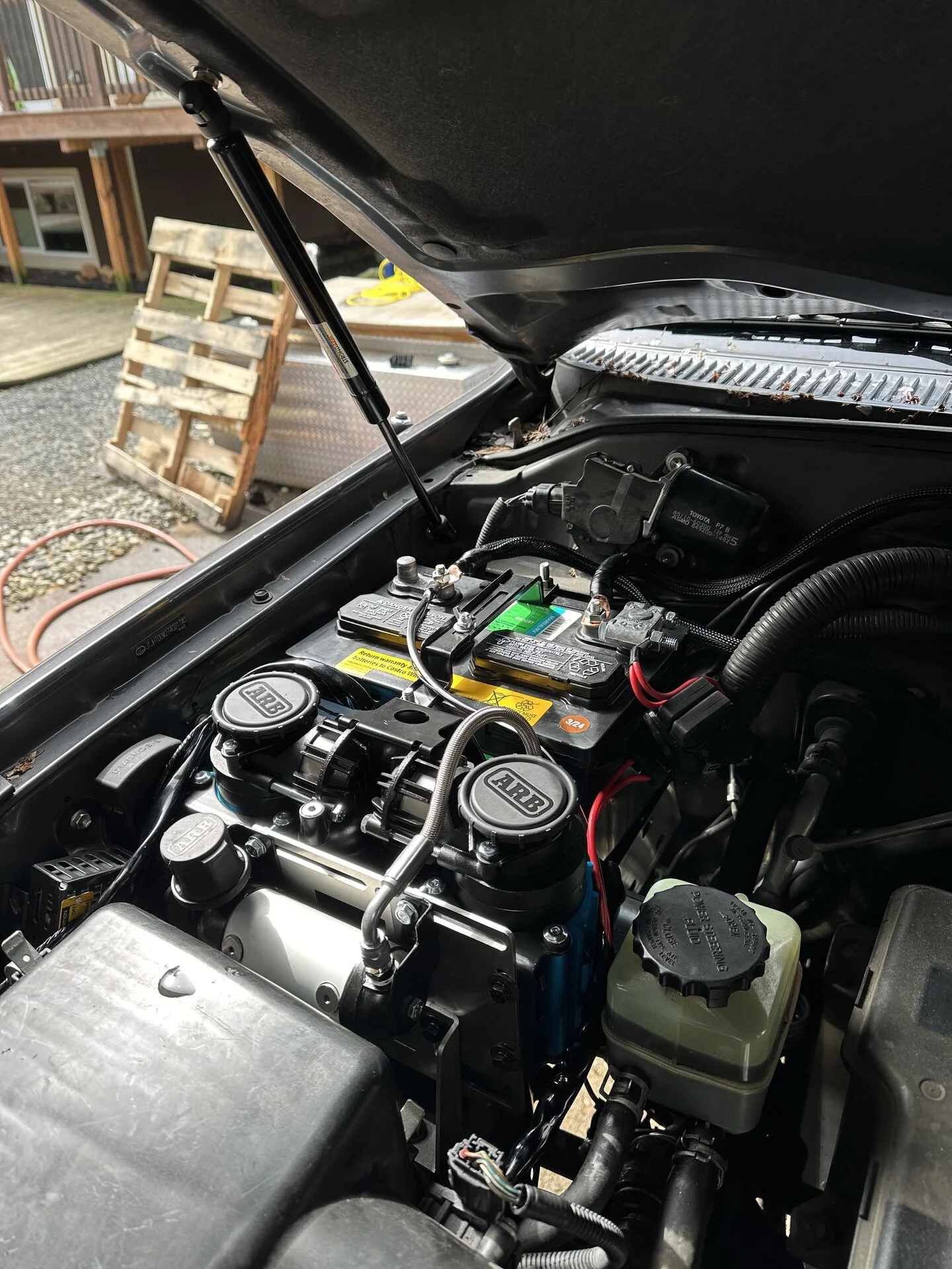

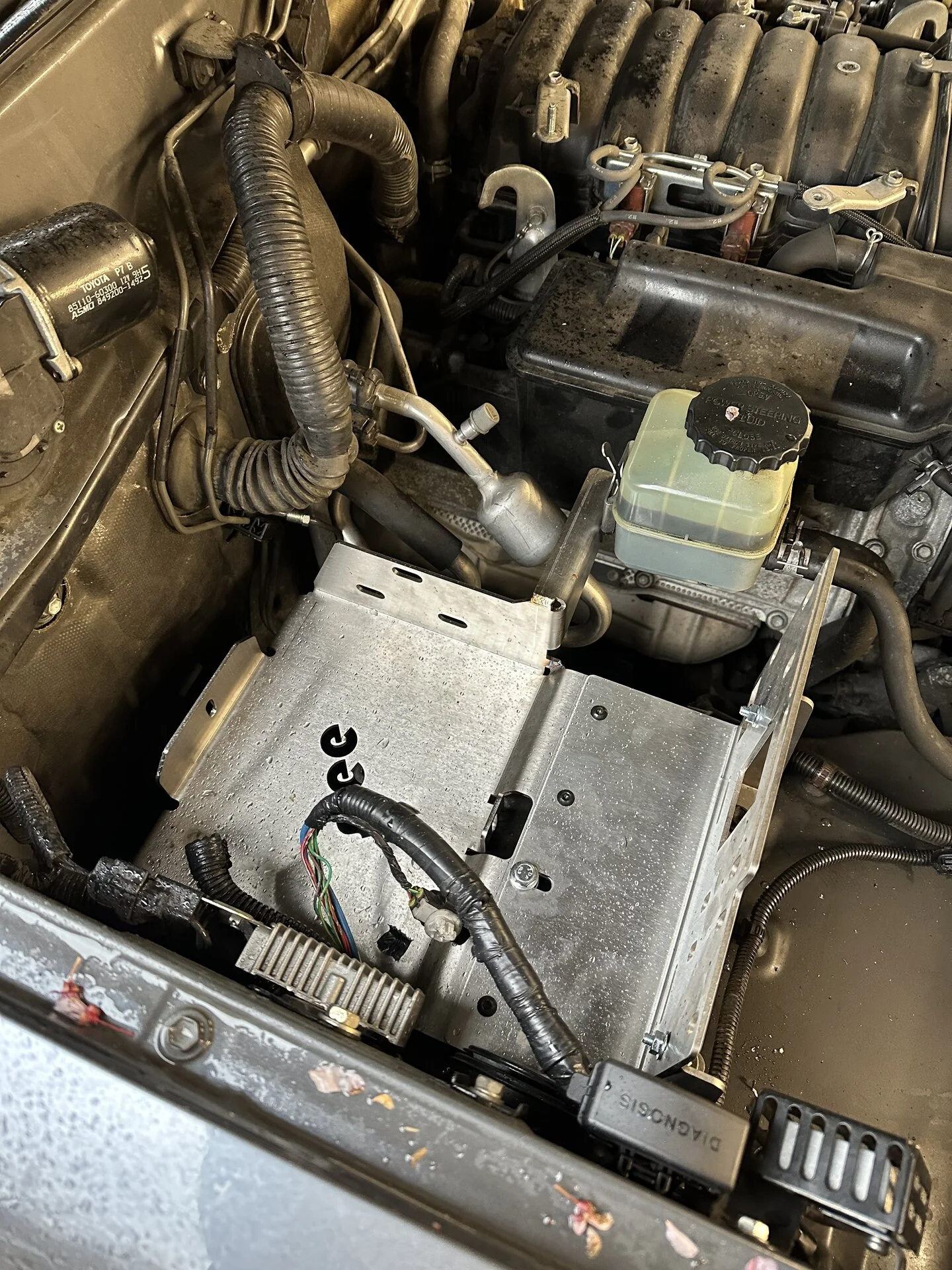

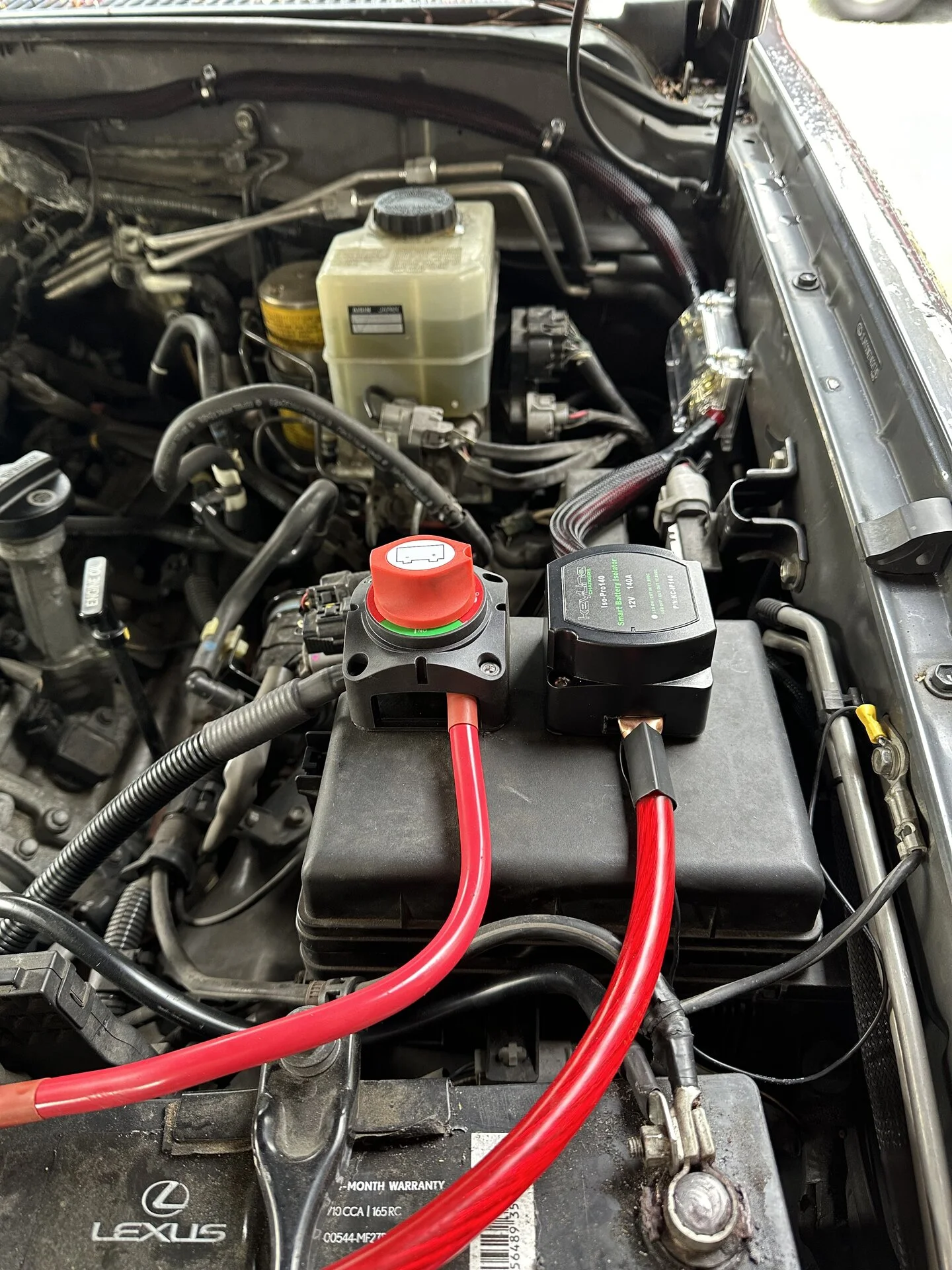

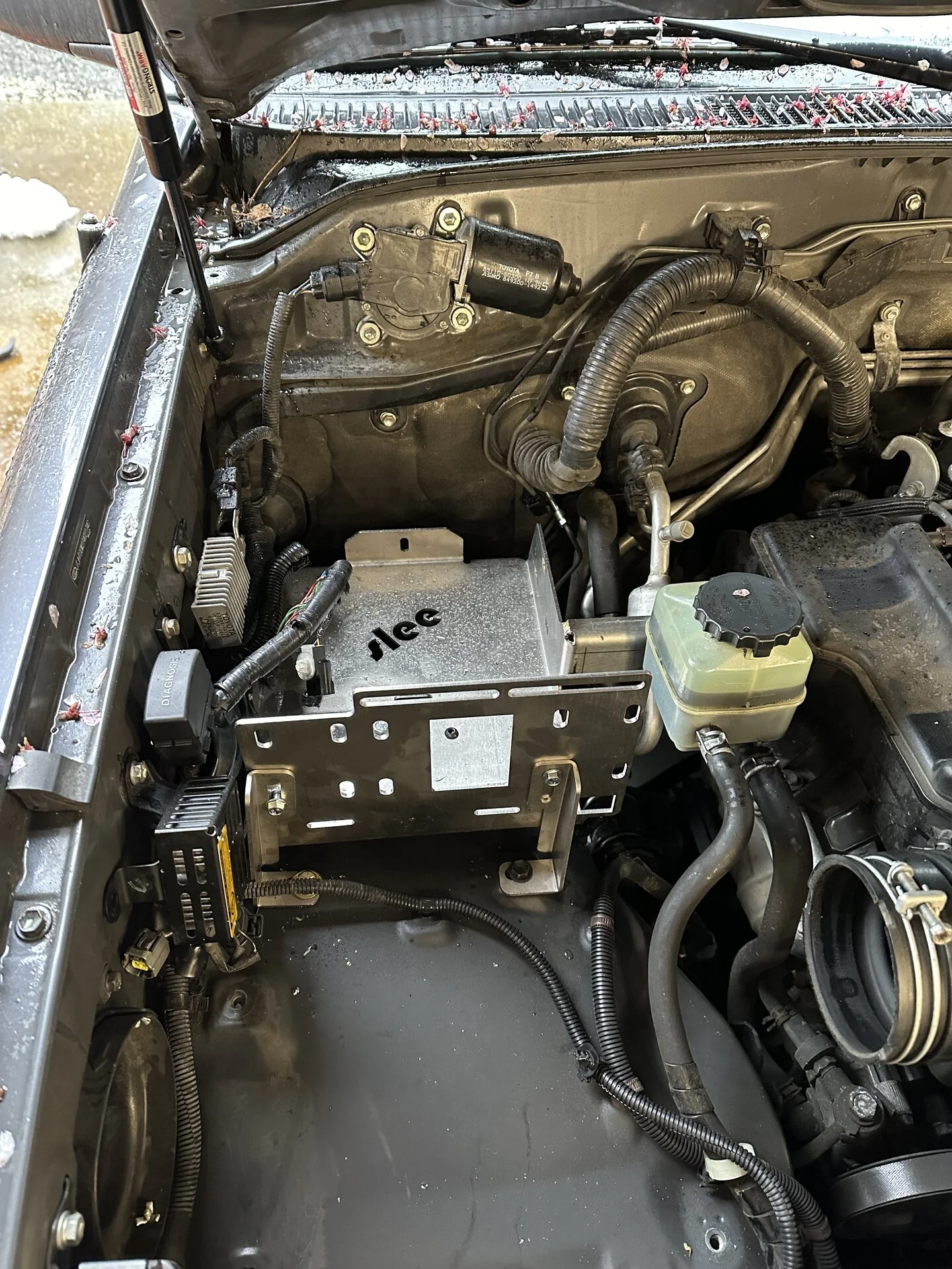

Got the slee dual battery tray and ARB twin compressor and manifold all wired up.
For dual battery: 0 guage positive wire from main pos to a 140a isolator to a fuse to second battery. Second battery grounded on engine lift point.
the battery was about 0.5cm too wide so had to trim off tab on slee battery tray and then get new tie down kit from amazon. The slee battery hold down is rad, but won’t work with the battery caps. Would be great for those lithium folks….but couldn’t justify that for a battery just running a winch and compressor at the moment
Twin compressor working and just ran test to fill the 35’s with ARB fill up kit… works great. Just need to route wiring into cab when the OEM locker switch arrives tomorrow.
