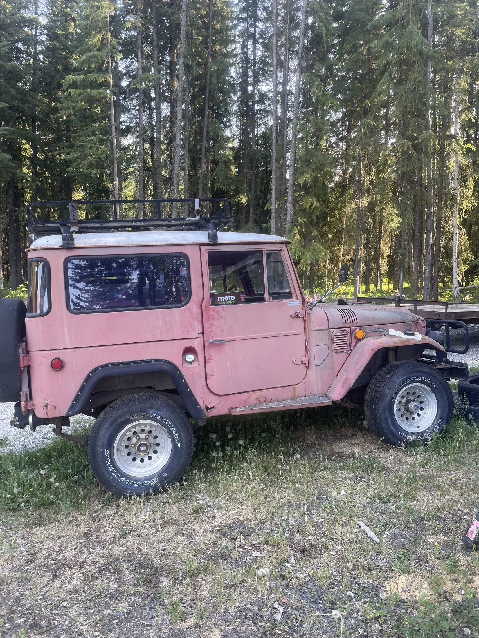

Here she is!!
Nice early 40. It looks pretty complete, with some period correct extras. That should clean up nicely!
Welcome! Nice 40 you inherited
I was expecting way more rust than it shows based on location.

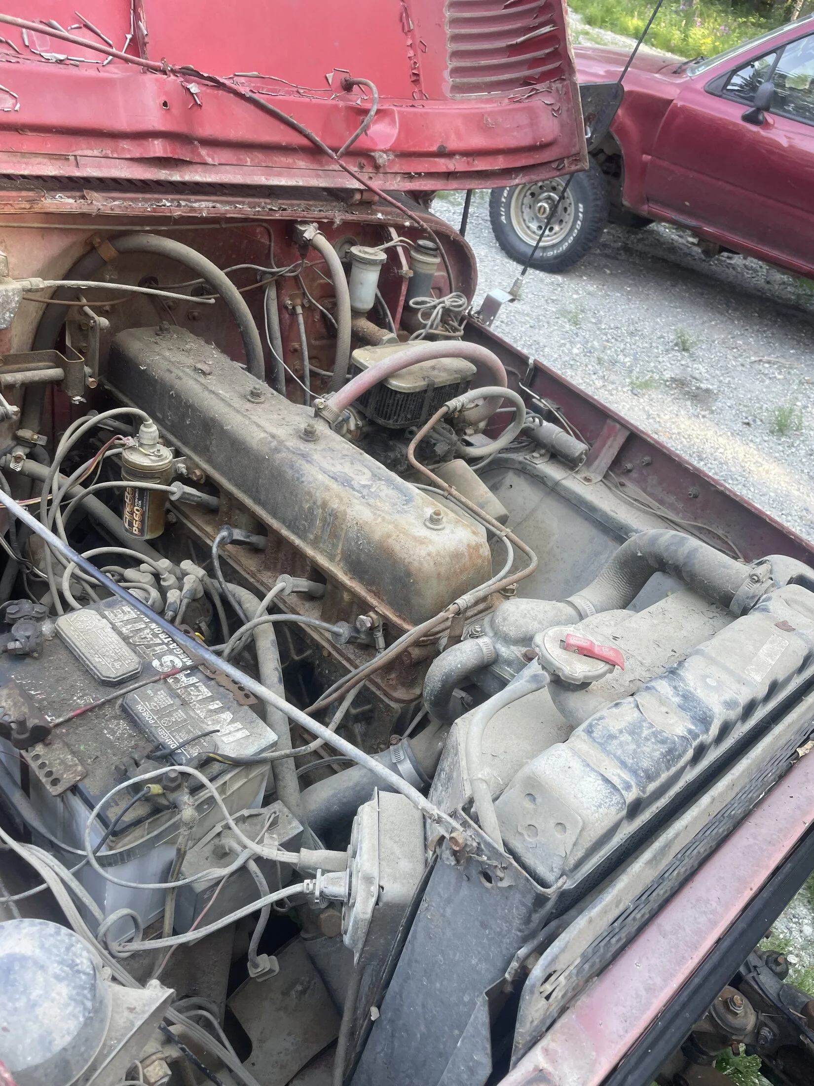

Very intriguing electrical setup next to the radiator :hmm:
Keep us posted on the progress!
Thats for the block heater, oil pan heater and a trickle charger. The previous owner used it all winter up here which sometimes means -45+. Granted he did bundle up!
Congrats on the new to you rig! Doesn't look like a stock Aisan carb - maybe a Weber? You're a few steps away from that though, follow what's been said first and see if it'll run for a second before moving on.
I do enjoy the 110v plugs next to the radiator. Good for all kinds of things - small appliances, alarm clock, TV, you name it.
