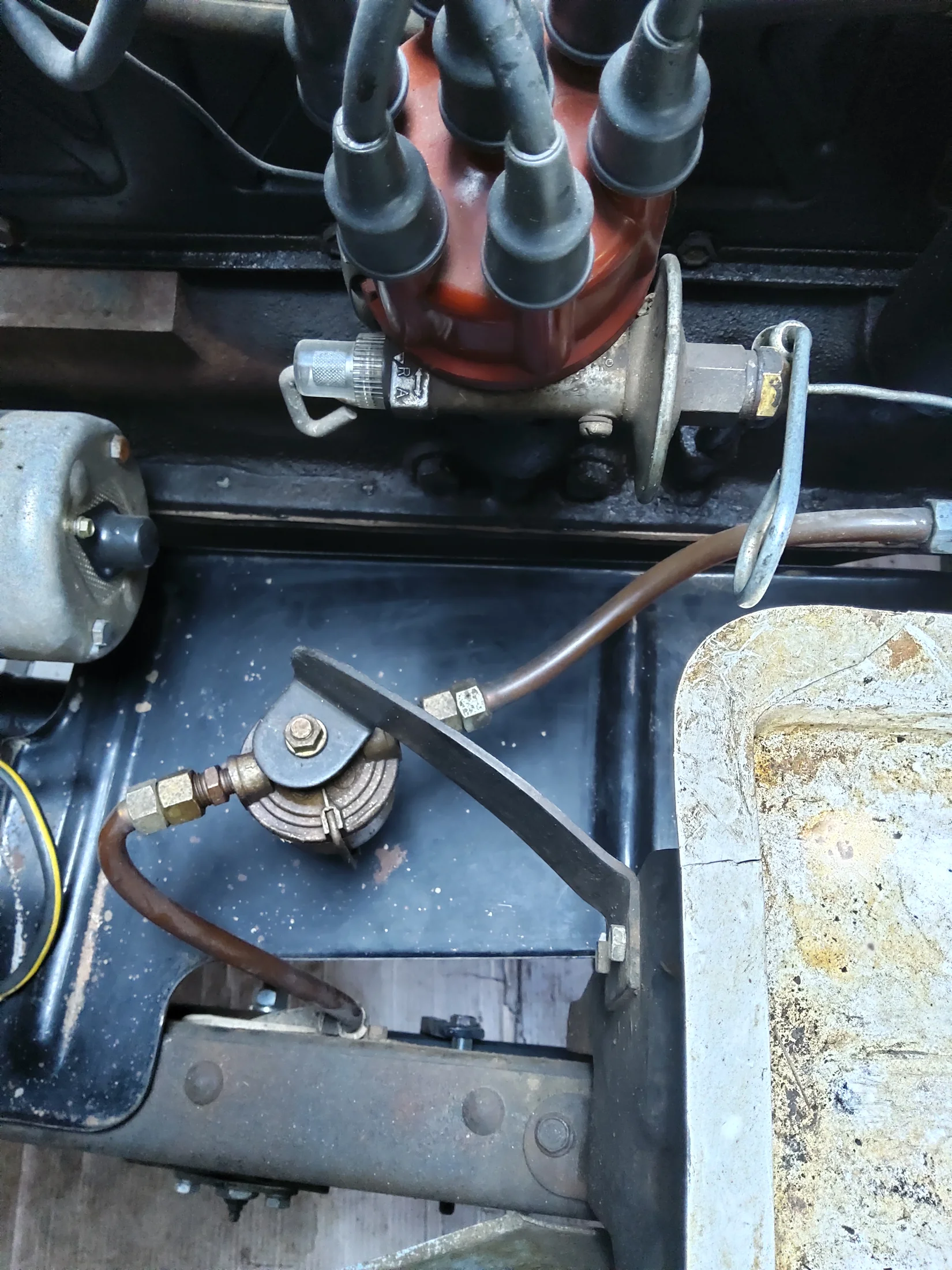

Can anyone show me a picture of how the glass fuel filter mount in the engine compartment? To the engine? Fender wall? I can’t find any pictures or documents showing it. Thanks!
I put mine on the high fire wall so I could see and clean it out easily when needed. Mine came off J3 Cub -so it was use to flying :)
^^^ beat me to it, but got you a pic from my '69
Mounts to the battery tray support.

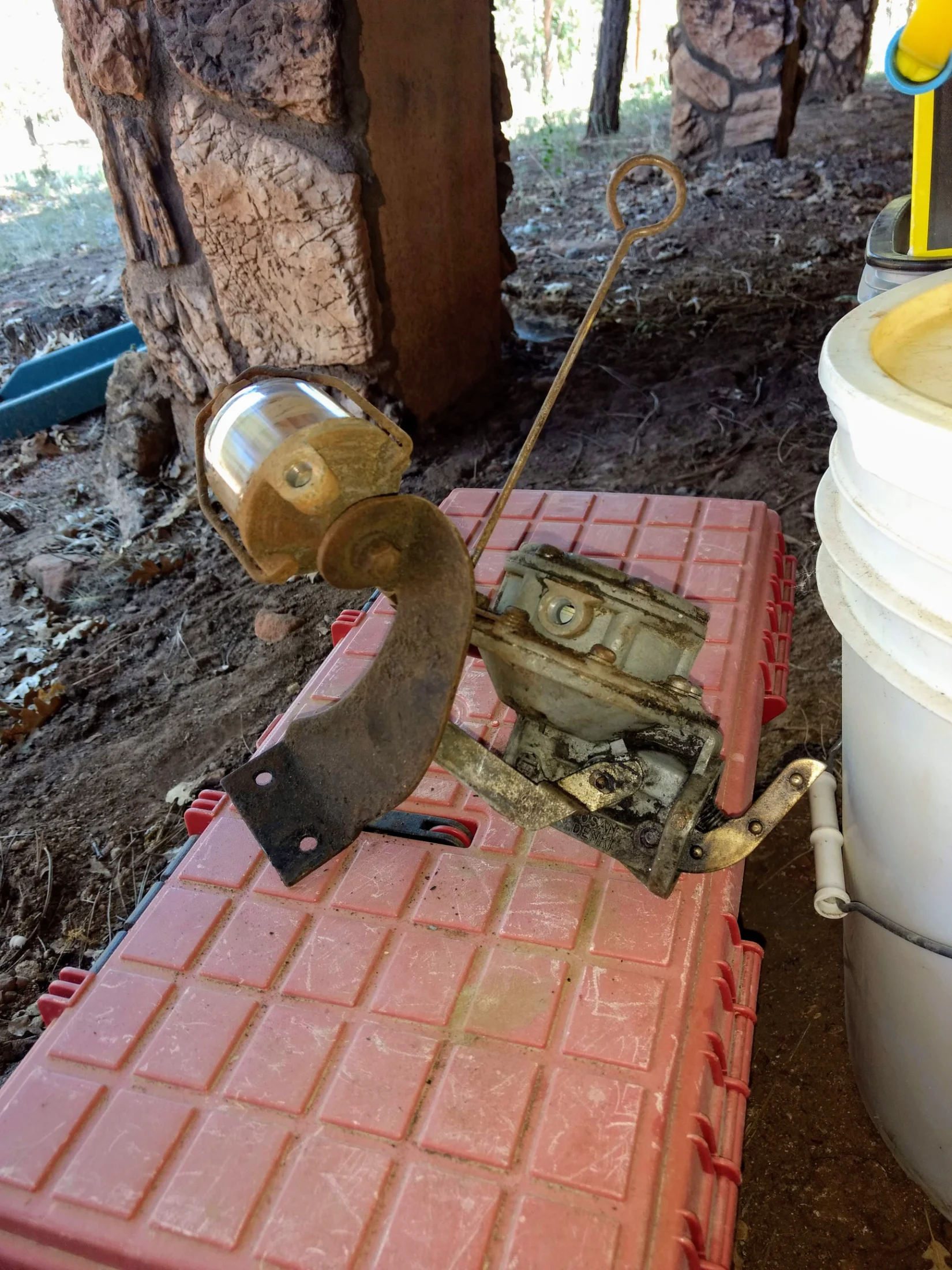

Bought this setup off eBay many years around.

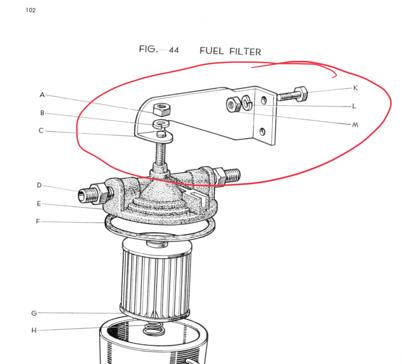

Not sure if there was a thread is in the 40/55 section or the 25 section on the differences in the brackets used over years. The one I pictured was mostly mid 1960s or earlier. Anything pre 3/69 is hard to date. Believe the fuel pump with the hand primer ended around 1965.
