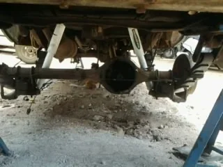

hi friends installed suspension IRON MAN 2.5" lift shortage of 2 greaseable shackle will get it installed next week meanwhile some pictures for you all to enjoy:bounce2::bounce: image.jpeg
beofre and after suspension install- height difference
before install
after

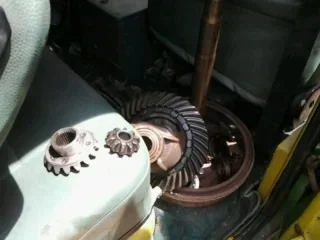

my rear differential spider gear are worn out and is creating high wobble so need replacement, where to parts for the same need reference part no and is it a better idea to go for rear lockers at this moment since i'm going to replace them why not switch to rear lockers? are shall i just get whatever needed to fix rear differential and forget lockers? image_11.jpeg

please direct me from where i can get spider gear for my rear differential please someone help me. saw a full rebuilt third from Marlin Crawlers was pretty interested but they are asking for the old one to be shipped first which will end up expensive as i'm from India and it will end up way more expensive. so is there any other way i could get a fully rebuilt open differential from them without returning my old differential? :bang::bang::bang:
you could just install a spartan/aussie/lockright locker ($300US + shipping). they take the place of the spider gears and are really simple to install.

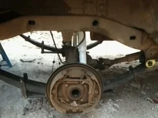

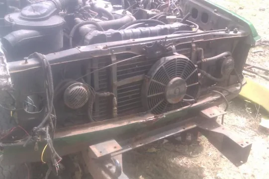

mechanical s done with front and rear axial service, brakes serviced, starter motor, alternator fixed, front differential serviced, started with body work. now it is tear down totally, please forgive for bad quality pictures will get some nice pict asap. IMAG0014.jpg
needs lot of attention to get things done as rust is at its worst, truck spent whole of its life near coastal region before reach my hands:bang::bang::bang:
END OF THE DAY WILL STILL GET THINGS DONE, NEVER GIVE UP ARE TURN BACK.:mad::mad:

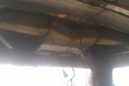

some more from interior
I'M NOT SURE HOW MUCH JUSTICE I CAN DO, BUT WILL PUT IN MY MAXIMUM EFFORT.:flamingo::flamingo:
