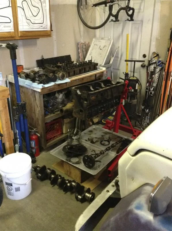

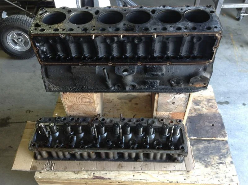

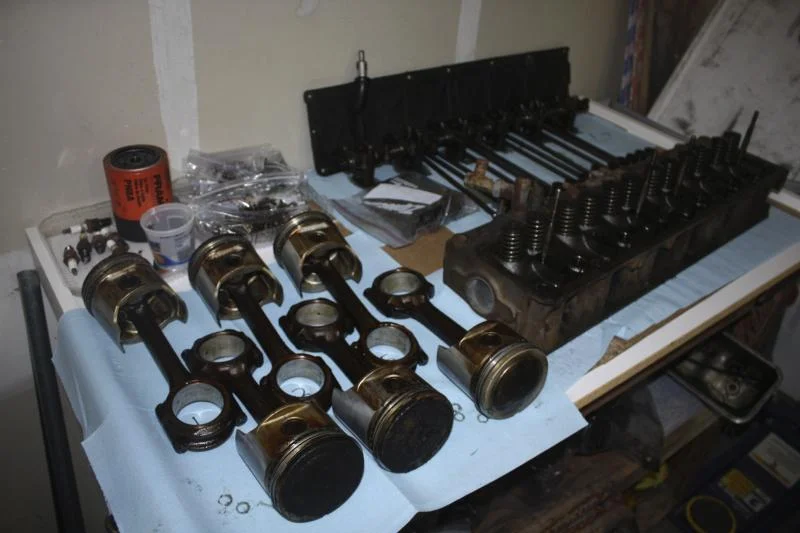

Quick update. . . The engine is now completely torn down (with the exception of the 2 timing gears which are still on the ends of the cam and crank shafts). It went smoothly for the most part and I am pleased that everything looks pretty good. I haven't closely inspected much yet, but there were zero broken rings and only some slight scoring on a few bearings throughout. . . not too bad. I was expecting much worse after seeing how much carbon was built up on the piston tops.
I've found a semi-local shop to help me with all the measuring, machine work and parts sourcing etc... I'm excited to get everything in their hands as they seem like good guys who know their stuff.
Thanks for all the tips on cleaning solutions - I think that'll be my next major task. . . my fingers already hurt just thinking about how much stuff I need to de-grime.
I'm doing the entire disassembly right in front of the '55. I often wonder if it appreciates that I'm building a new heart for it or if it'll resent me for it. . .

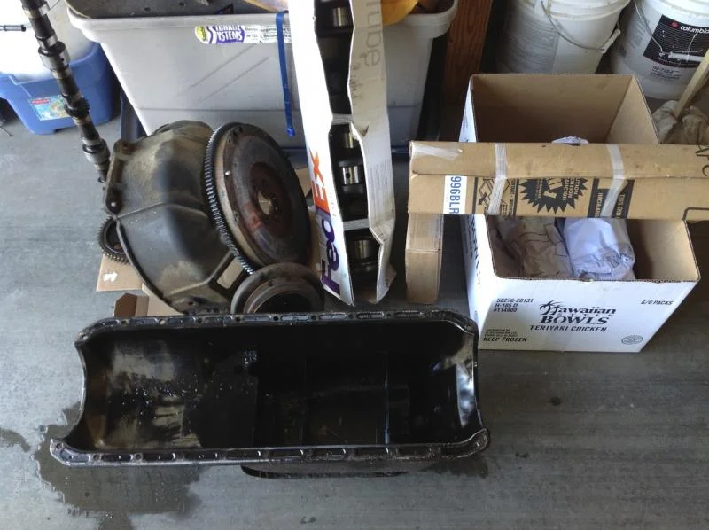

A few pics of 2F pieces. . .
Hopefully you don't need to get through that door too often! :eek:

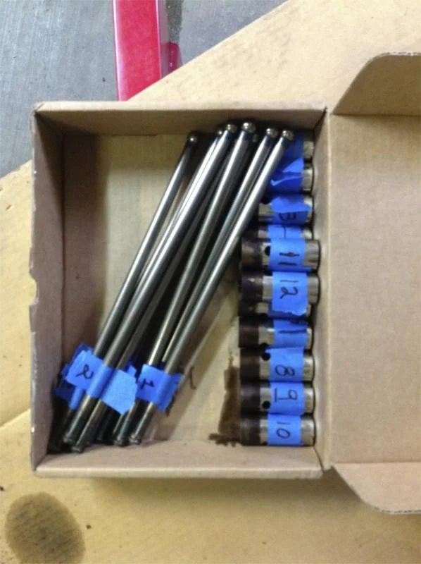

All the appropriate parts are at the machine shop. I got lucky as the owner decided to make a trip up here last Sat. to take his wife on a mini vacation so he did a special in-home pick-up for me. . . nice service! It's only 1 1/2 hrs. away, so not too bad but he saved me the trip down which was a nice thing for him to do.
I gave him a bunch of the tinware stuff too because he kept telling me about his hot tank and what a great job it does getting all the greasy grunge off. So hopefully he'll save me a bunch of cleaning work. I kept a few pieces as well as all the nuts and bolts etc... so I still have lots to do. I'm also in the middle of breaking down and cleaning up the dizzy, fuel pump, oil filter etc.... lots to do while waiting on the machining etc...
I'm sure I'll have a ton of questions once I hear back from the shop after they're done measuring and I know what I have to work with and what I'll need to buy for the rebuild etc...

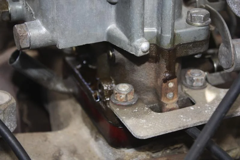

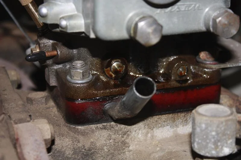

Thought I'd post about my latest issue - a sticky carb butterfly. See the pics below. What I think is happening is that the carb is leaking somehow around the two butterfly shafts. The fuel is then quickly getting gummy and making it hard for the butterflys to rotate open/closed smoothly. I initially thought it might be a worn throttle cable, which was getting hung up inside the housing. I replaced the cable w/a new one, but the problem persists.
It's most noticeable at cold startup when it can be hard to even press on the accelerator at all - it's stiff as a brick. Then until the engine warms up, the throttle is very sticky - kinda like cruise control when you lift your foot off the pedal. Not so bad on the hwy., but not so good during in town driving. Once the engine gets warm, the stickyness goes away and it's all good. . . until I let it sit for a while again etc....
This carb was recently rebuilt by "The Man". I mentioned to him that it looked like it was weeping from the butterfly shafts and he just kinda said, "hmmmm, it shouldn't do that". It started weeping there immediately after I installed it and got the engine running.
Could this be caused by having the fuel float level set incorrectly? The fuel level looks to be a little on the high side in the sight glass - more towards the top than the middle.
Is this normal? Is there and obvious fix?
