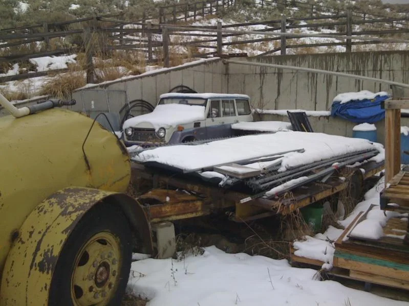

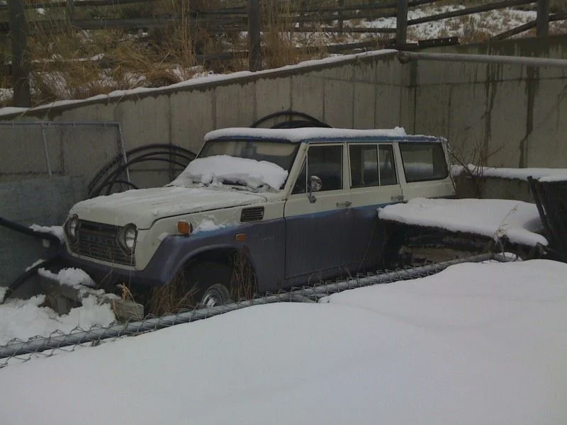

Just like all projects, there's some good, some bad etc.... It currently does not run but was driven to where it's currently "resting". It's been parked and non-running for a bunch of years - maybe 8+? I went to take a look at it today and have some pics to share - see below.
The roof is munched in, but it's still dry inside as far as I can tell. I honestly don't really know what I'm looking at or for, but it seems pretty stock and complete to me. Most of the "little things" seem to be present.
My main question is what do you think it'll take to get it drivable? I do realize that's a very open ended and hard to answer question as everyone has a different idea of what "drivable" is. Mine would start with safe. All the critical systems must work - brakes, lights, steering, tires etc... and be safe. Other than heat and defrost, creature comforts are not that important. Cosmetics, beyond being "safe" and not about to disintegrate due to rust, are not that important. Patina is good in my book.
I would be doing much if not all the work myself, so parts cost only, labor is free. How much might I need to put into it to get it on the road? $2K, $3K, $5K? and would I likely be able to sell it for what I'd have into it a year or two from now?

My primary concern is rust - aside from everywhere, are there some specific place I should look that might help determine if it's worth the effort to get it back on the road? I'm not scared of having to do some welding, but doing a frame off restoration is something I'm not looking to bite off at the moment. . .

Welcome sir. That pig looks to be in pretty good shape! Also looks like you'll have to move quite a bit of crap to get it out. More pictures please. Also explain the overdrive? Not stock. As far as a budget goes those things are rarely useful. Whatever number you set the pig will stray from it.

Worst place to have rust, IMO, would be the roof. They all rust in the front fender, behind the wheel. also the rocker panels under the doors. Tailgate corners, rear sill, just to name a few. Floor boards and body mounts can rust, these are replaceable. The type and amount of rust usually depends on what part of the country the Pig lived in. Sheetmetal in the earlier Pigs was thicker than the later Pigs and may withstand the rust better, then again, they're older.
Hard to tell by those pics of course, But I bet you could get it started and running pretty cheaply. You can do 4 wheel discs for about a grand ( does the '72 already have the dualcircuit M/C?) which would make you get new tie-rod ends. and stuff.
You could probably get a safe runner if you threw 2 grand at it, but budget for 3 to start. You will never be able to sell it for what you put into it. You makes your monthly car payment one way or another.
It doesn't look bad, need more pics.

I'd like to drag it out of where it's sitting to get a better look - the driver's door was the only one I could open as it's backed right up against the corner of a retaining wall.

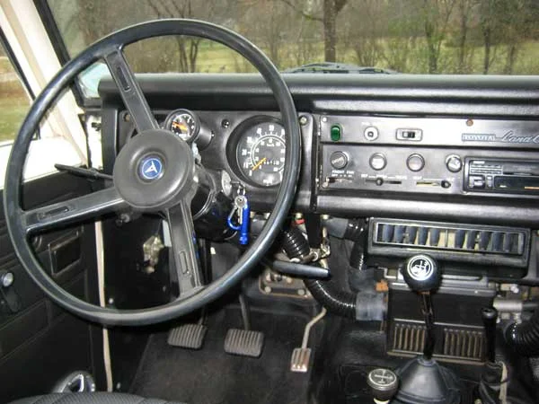

Pighead gave you some good info... I did not see the stick for the overdrive. Would you be able to post a photo of the shifters or the item that was said to be an overdrive.
Here's a photo with the Fairy OD shifter
Tom - nice find. Other than hard to come by sheetmetal parts the mechanicals are easy to find. Save her - you won't regret it. FWIW I don't see the shifter for the OD either but I DO see the A/C. Hell, it even has the stock AM radio.
