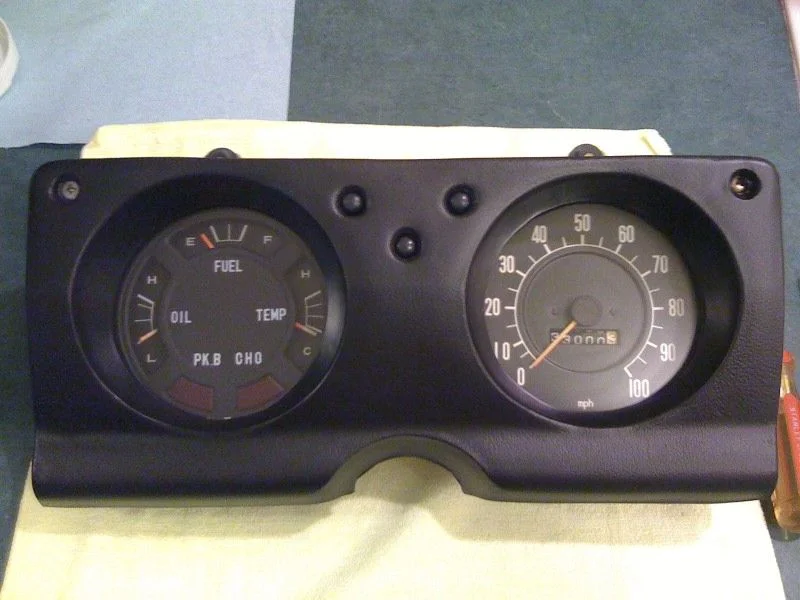

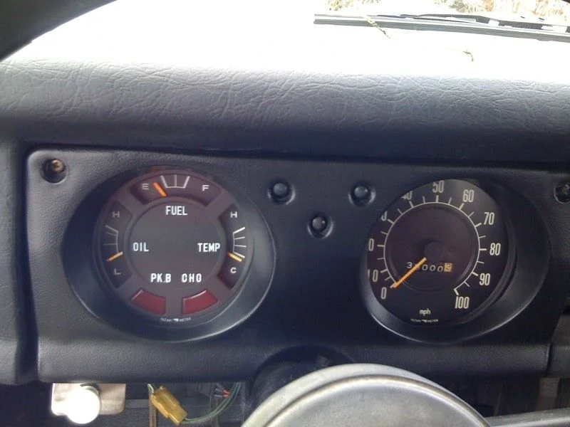

Now a few "after pics" of the dash - sorry about the crappy quality, they're just iPhone pics.
I'm excited because now ALL the gauges are working! The only thing that doesn't work is the odometer - it's stuck at 33,000. I took it all apart because the gears were completely frozen to the shaft they spin on. I thought that would solve the problem (also was a chance to reset the milage, but I decided not to!). It turns out that one of the plastic gears that turns the odometer is worn just to the point where it won't turn the numbers. . . so bummer, it doesn't work. Oh well. . .

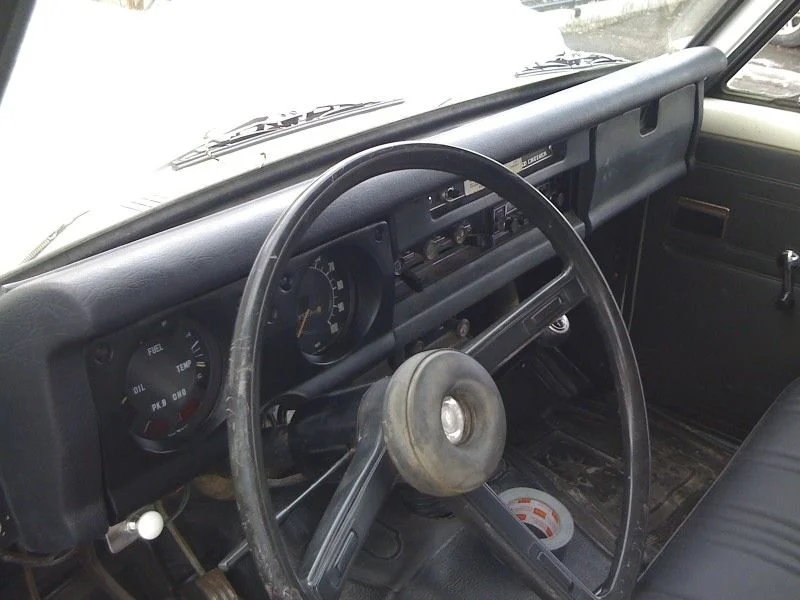

Notice the roll of duct tape (ie: coffee cup holder) on the trans. hump!

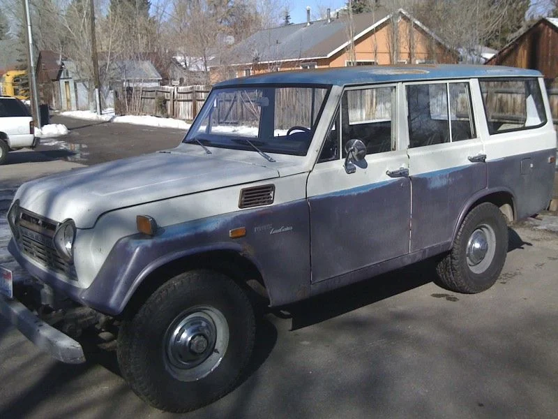

Been thinking about painting the purple - changing to matte black w/a red pinstripe between the white & matte black below. . .
My kids want to paint it pink. . . but I don't know if I could actually pull the trigger on that when it comes to doing it. . .
Tom...I'm interested in how you were able to pull the hard vinyl back into place around the speedo. Have the same issue with both sides of my dash panel gauges.
I should've taken pics of this as I was working on it - I thought about it, but was just ready to get-er-done at that point!
After pulling the whole panel from the dash and then taking the gauges and indicator lights off the back, I made little slices every 1/2" or so in the areas that had delaminated. The vinyl was too stiff/old to force back into place w/out the slices. I then used epoxy to glue the little sliced pieces back into position. Once I spooged some epoxy into the crack, I used really thin packing tape (the kind w/the stringy strips in it) to keep the pieces in place until the epoxy cured. After removing the tape, I mixed a thick batch of epoxy using some filler to fill in the gaps created by the slices. After that cured, I sanded it all down & finally used a few thin rounds of body filler/sanding/body filler/sanding to get it shaped and good to go. I definitely got impatient to get finished so if you look at my finished product closely, you can see the openings aren't perfectly round and there are a few scratches I didn't sand out etc.... it's good enough for me though. Give the whole thing (all the vinyl that is) a light sanding before a few coats of primer then a few coats of semi-flat black and you're done!
Yes!
Paint it pink baby! The only correct color for a Pig!
Chrysler has that sweet Panther Pink color code that was part of their "high impact" color line-up in 1970.
Go for it! You won't regret it...
blue baby
I think the original blue or red would look great too. . .

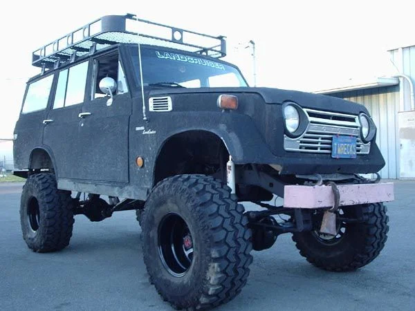

Are there any examples of other pink pigs? I haven't come across any pics yet. . . I will do my best to humor my kids on this one. . . we can always paint over it!

I think pink is a fine color for a Pig. I've run a pink front bumper before, will occasionally paint the drive shafts in the pink & black candy cane when they come back from from the driveshaft shop. If I could get cheap Herculiner in pink, I'd do it.
Or pink zebra stripes.
I've seen it in person
and I am going to lobby for staying w/ the weathered purple. Maybe tune up the top of the fenders & definitely re-paint the roof. Your Pig has one of the coolest vintage car patinas (damn iPad corrected that to "Latinas" twice) I have ever seen.
