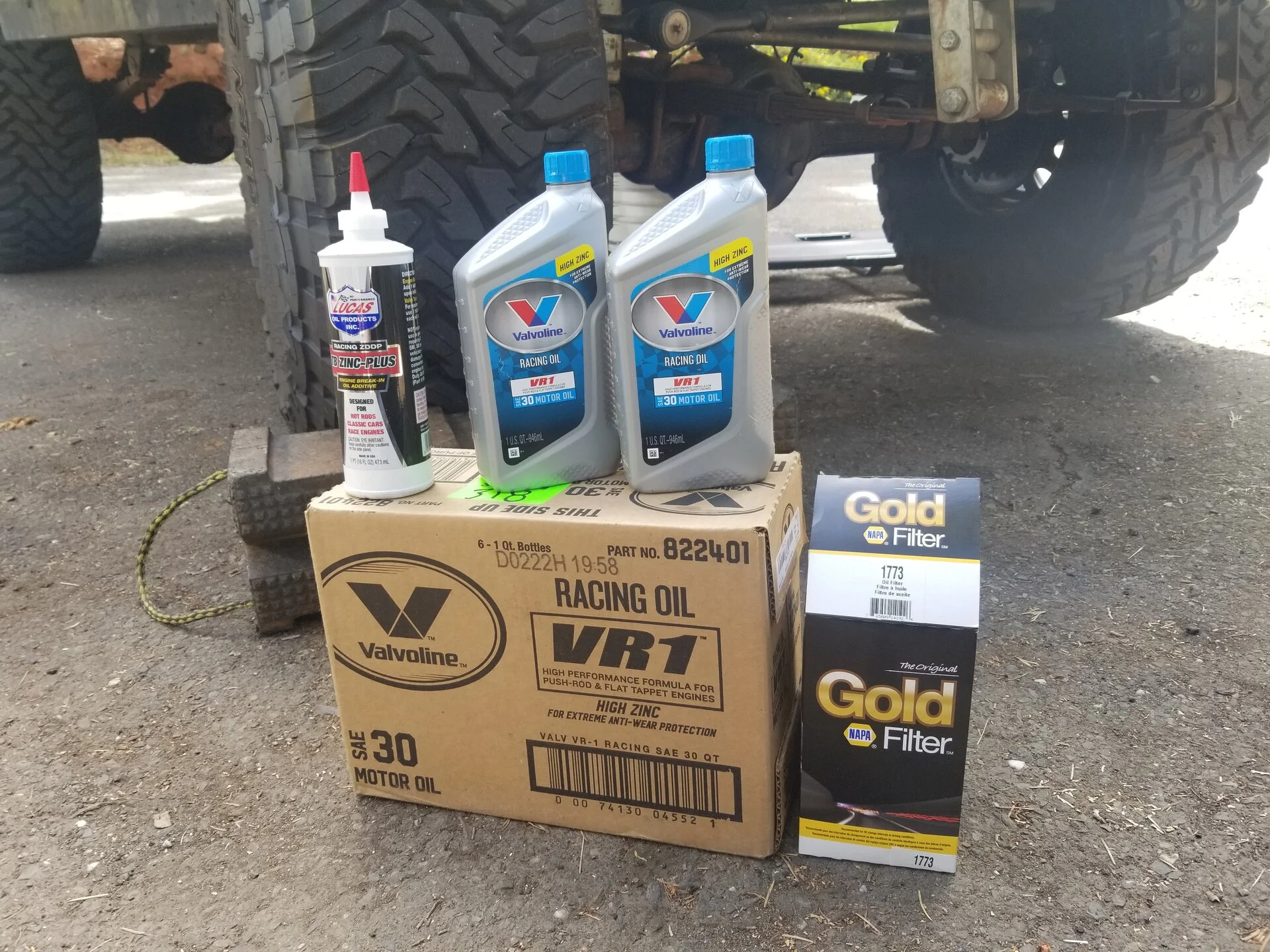

My recipe for a 2F oil change.
I used VR1 for a long time. It was really broken down after 2000 miles when I did a blackstone labs report. I don't think it has the longevity to go a full OCI. I noticed it just smelled really bad, and the report confirmed that it didn't have near the protection properties that it should.
I still feel that its primarily a sometimes drag racing, change it after a weekend of racing oil.
I think the diesel oil is the way to go. That just my opinion.
Straight weight oil doesn't seem like a good idea. Having a cold range that's not so thick is a lot better for wear on cold startups.

VR1 and other racing oils have little to no detergent because they're meant to run hard , then drain. You risk a lot of sludge running racing oil, exclusively.
