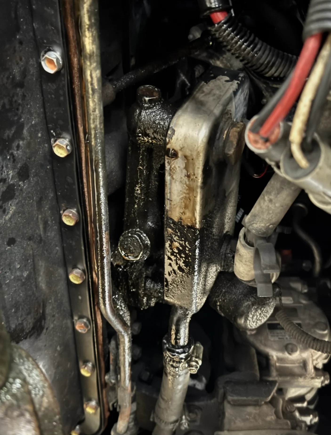

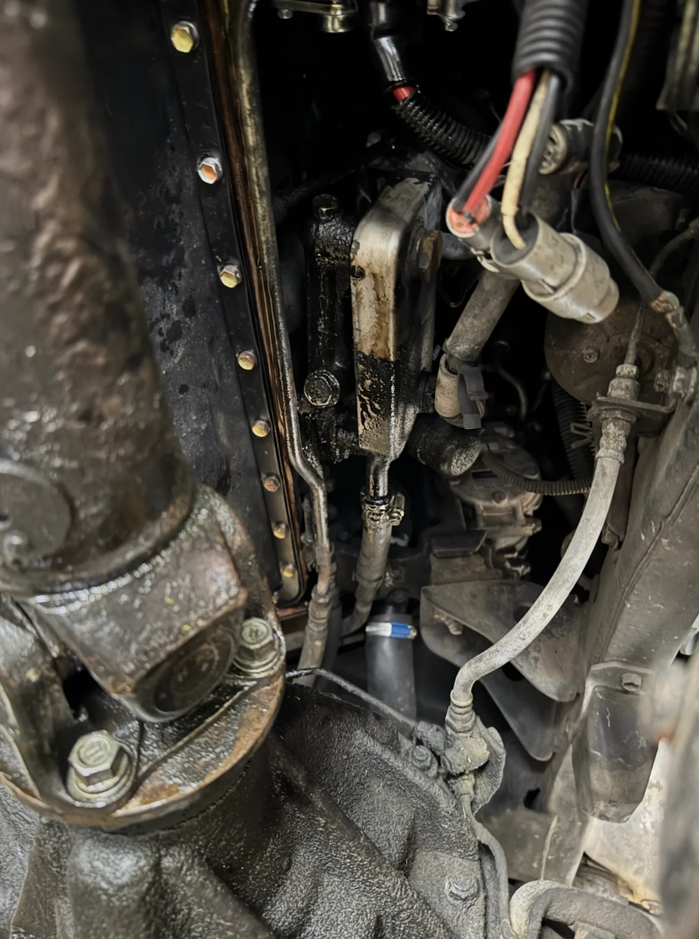

lol I just did an oil change and went with 5W-40 instead of 15W-40 since I'll be in cold weather (UT mountains) for a while. Cleaned it off after the change. Saw a drip on the driveway for the first time, and looks like I have a leak at the oil cooler. I guess the much thinner oil just seeped right past whatever seal is there. I'm wondering how much of my oil loss actually was coming from this. It's non-zero but probably the bulk of it is still engine wear & consumption.
