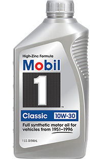

Mobil now also makes a 'Classic oil' 10w30 with high zinc for pre-1996 vehicles (1300 ppm which is where the old Rotella used to be). I haven't seen any tests on it, though.
