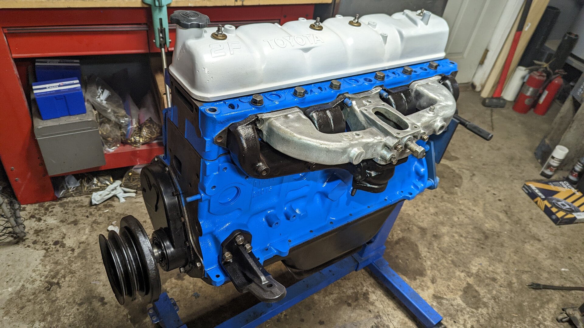

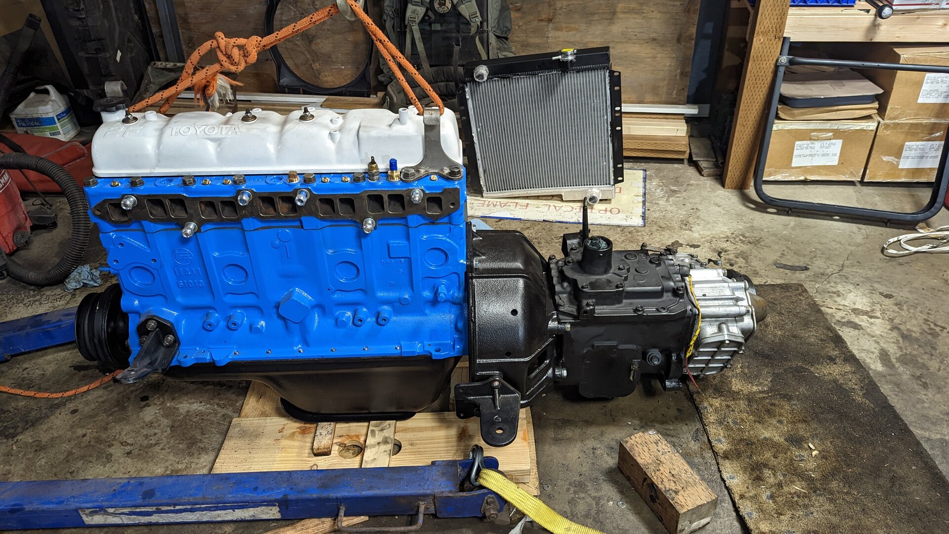

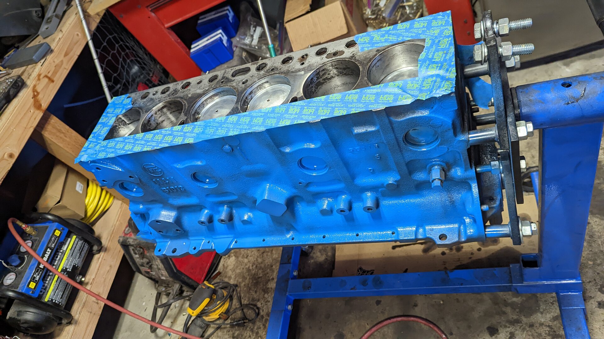

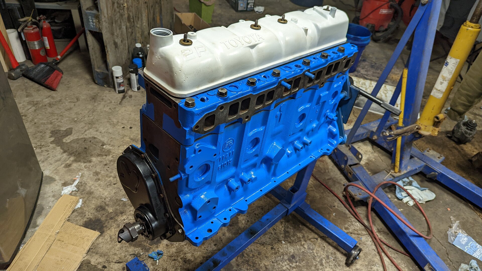

Brought the vehicle inside of the garage for the first time at the end of November 2022 and was able to install the freshly overhauled 2F engine.
Bored cylinders.
New piston rings.
New gaskets all around.
New crank shaft and con-rod bearings.
Fully cleaned, inspected and painted.
Head and Block checked for warping outside of spec.
New SS Oil pan bolts and manifold studs.
New clutch plate (old one was falling apart)
Reused old flywheel and clutch plate as they were in good condition still.
Valves and seats were cleaned, de-rusted, lapped and re-installed with new seals.
