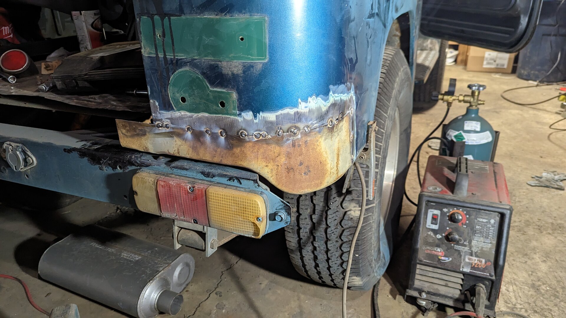

I finally broke down and cut into the rear drivers side quarter panel. The whole backend of the panel was rotten and has previously been "repaired" and the whole panel had a decent layer of filler on it. My patch panel has a bit of surface rust because it isn't brand new, and before I tacked it in place I painted the backside with POR-15.

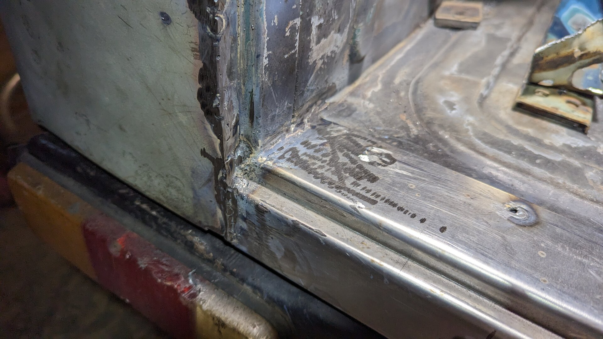

As I finished up the rear quarter panel work I also had to finish up the rear sill and sill cover metal work. I ordered the new sill cover from CCOT, but made the sill myself from 2"x2" steel tubing. I had to figure out how to attach the sill without making it a permanent attachment. I ended up welding the SS nuts as shown and then welding the sill cover over the top sealing it in. If, in the future someone needs to seperate the body and chassis they can still unbolt the sill from below. I guess its the engineer inside of me that makes me design for future use, and disassembly.

Getting the bolt holes for the spare tire mount aligned with the sill and sill plate was a bit of a frustration. I used the sill (1/8" thick side walls) and tapped them instead of welding nuts onto the inside of my sill tubing. In hindsight my diy sill was a great idea until it came time to attach anything to it. I ended up having to strip a corner of it off for the sill plate to fit correctly. And then I had to weld my nuts for chassis attachment inside of the tubing. And finally I had to find ways of welding makeshift nuts to the inside of my sill tubing to connect the spare tire mount to.

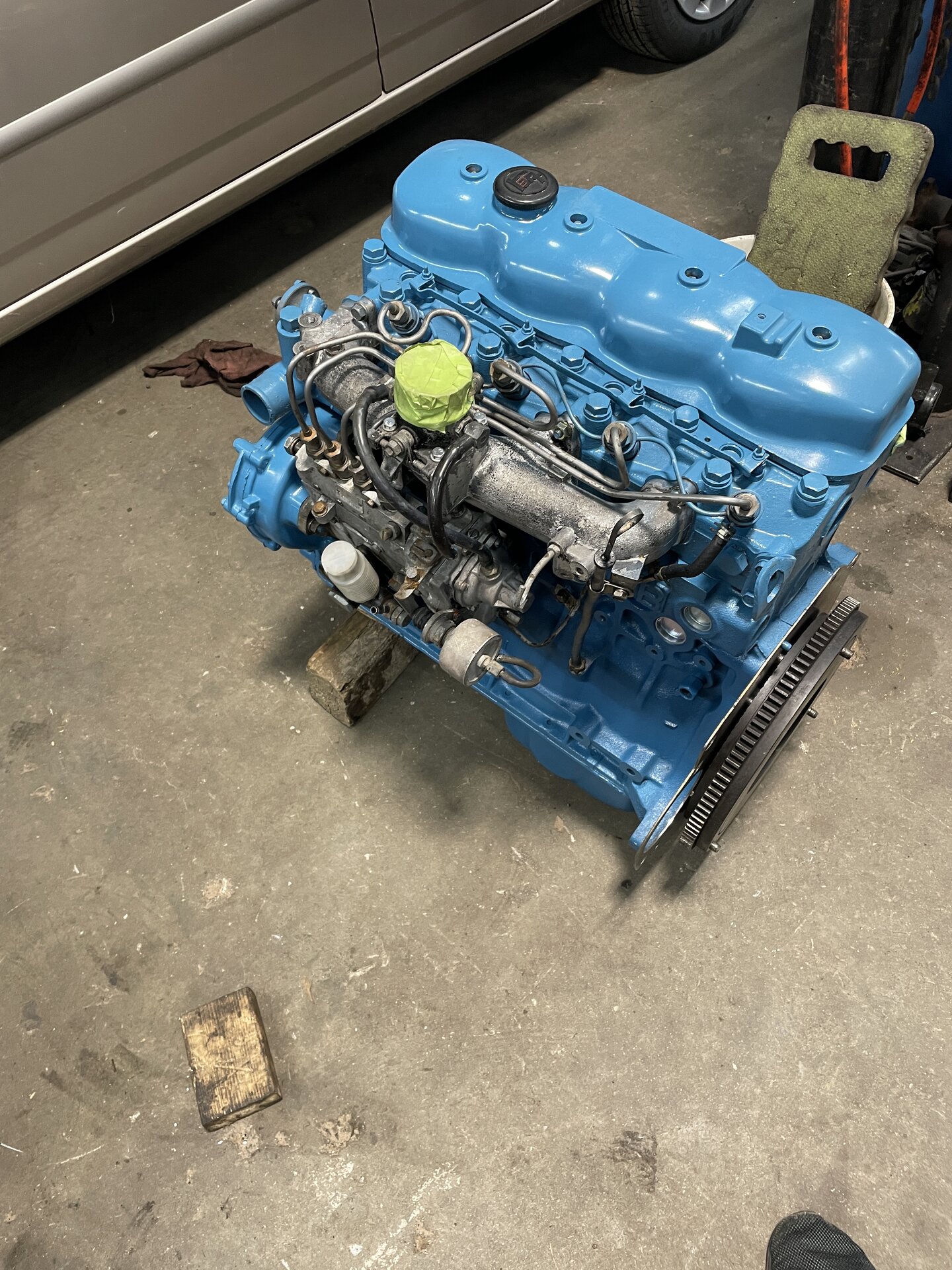

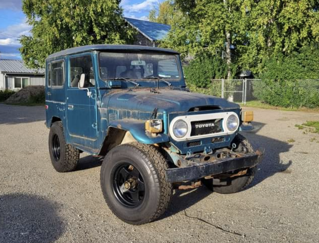

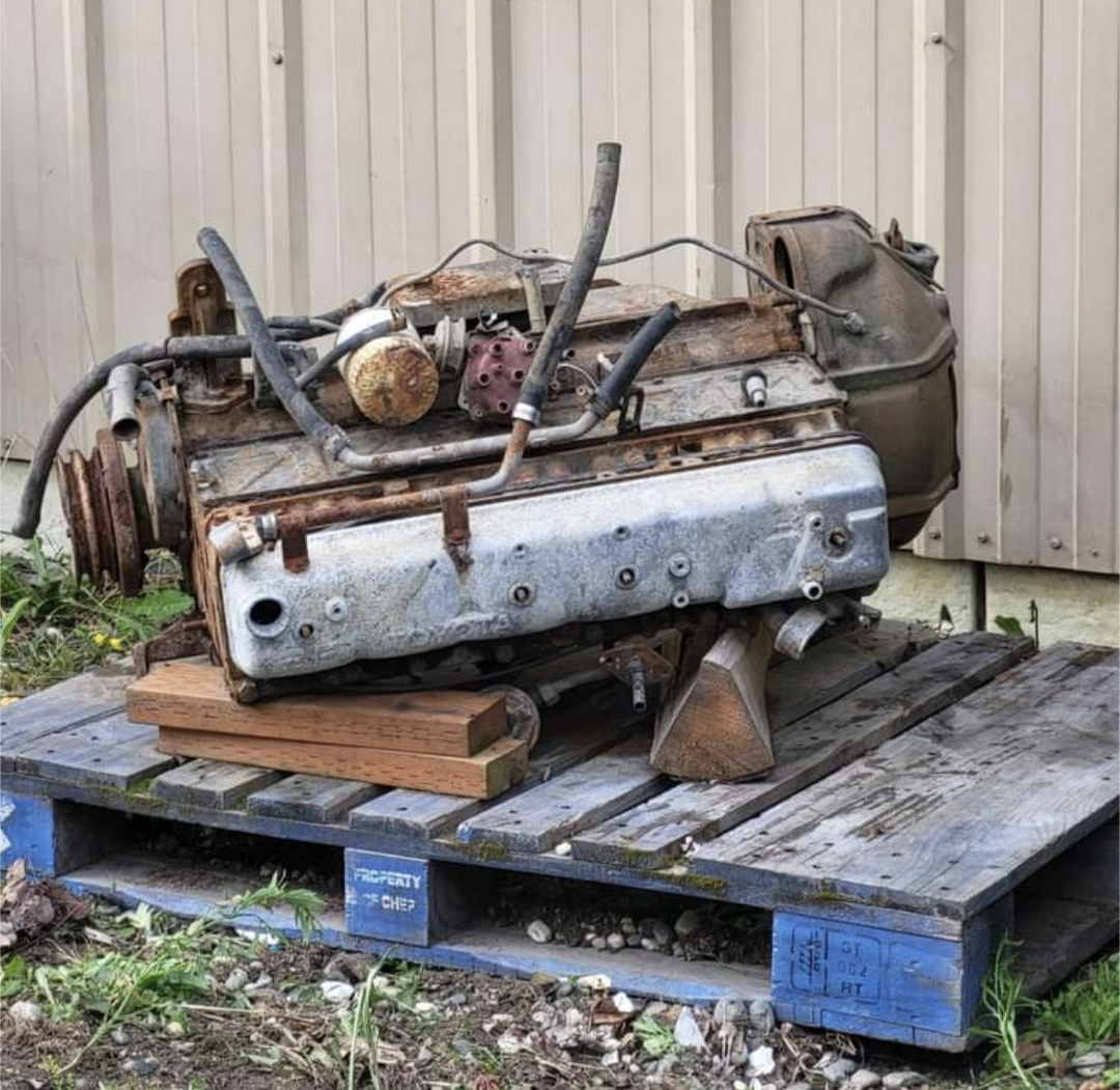

As far as an introduction goes, I'm a mechanical engineer in Alaska and just purchased a 1977 FJ40 with no engine. I also procured a 1979 2F seized junk "boat anchor" engine that was potentially able to be revived, but had been full of silt, snow, ice and more for potentially decades.
I'm not a purist, but more a operationalist and simply intend to get this rig up and running and then figure out the next step in this venture. Not necessarily opposed to a decent sized resto, but I'm definitely not planning on a collector level resto. I've been replacing old rusty OEM bolts/nuts with SS wherever appropriate (not a high stress location, like engine mounts). So that gives you a good idea of my lack of FJ40 OEM purity 😂.
I've added a couple pics of my new rig and the engine block I'm currently getting up and running. Wish me luck and I'm sure I'll be lurking/researching and asking many questions along the way!
I love the engine color. Mine is the same or at least very similar. I used POR15 blue color so it may be slightly different.

Matches your rig. I love the baby blue FJ40 color the most. Wish mine was blue. But I've got my eye on another blue project FJ40 so maybe I'll end up with a blue one eventually. What year is yours?

The engine shop that rebuilt my B went a little overboard with it. Doesn’t really match my red BJ40 at all lol. Whatever. I won’t open the engine up too much anyways

It's a 76.
Cut out and welded in patches for the opposite rear quarter panel. Overall it was in good shape and just had a couple of small bubbles that needed to be replaced. Liberal use of rust converter and POR-15 paint on the backside of my patches should mean it'll stay rust free for the rest of my lifetime.
