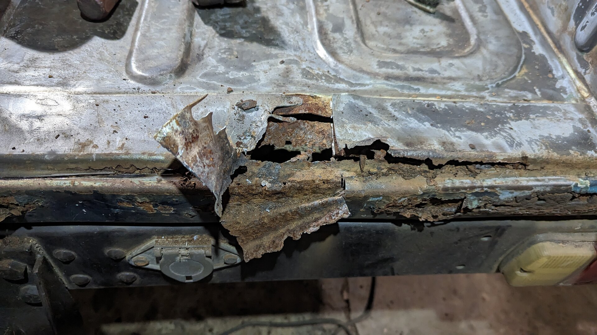

That thin stuff that's rusted is the worst. It's nearly impossible to weld. If you can, it helps to put some copper pipe behind it while you're welding.
Good advice. I made it work for now, but if I ever have to do this repair again I'll explore better ways to weld the thin plate. The P.O. simply wrapped the area in even thinner plate metal and applied a ton of caulking and bondo to seal it all in.
I tried to use that 22ga stuff 1st and gave up. I kept blowing holes thru it and found it to be too weak. I even tried loading my welder with 025 wire and it wouldn't push it thru the whip. I remade the hump mounting flange and a portion of the side out of 16ga.
I blew quite a few holes as well, but kept at it and never held the trigger down for more than a split second. Any longer and it would blow thru easily.
I didn’t see if you mentioned what size wire you are running, but In my experience running .024 wire makes a big difference in thin sheet welding capability. As @pb4ugo mentuined It is a little more finicky but my Miller 170 pushes it just fine.
All that said I don’t think I have ever gone to 22ga but if I was id want every advantage I could get.
My wire was .030". Not ideal, but it was what I had. I made it work. It just wasn't pretty, but after grinding, filler and paint, It'll look fine.

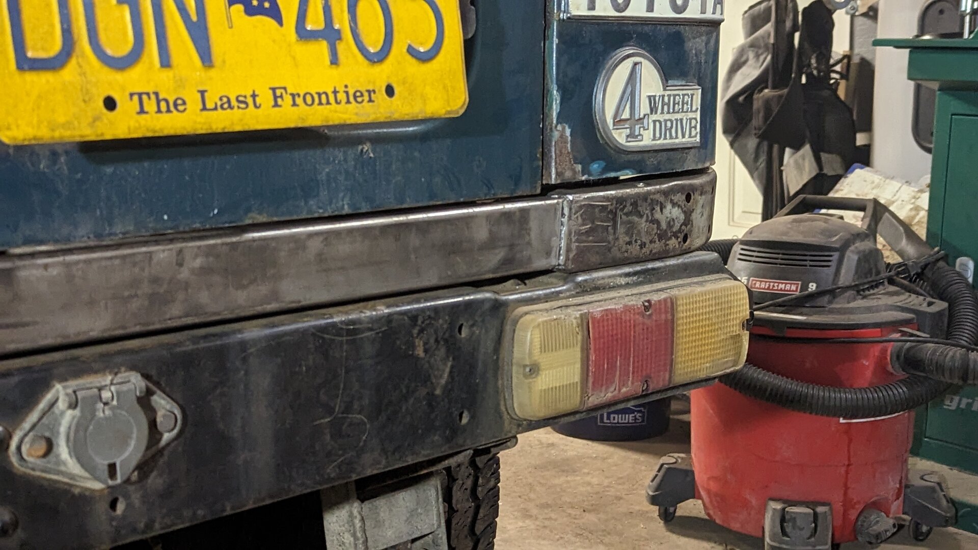

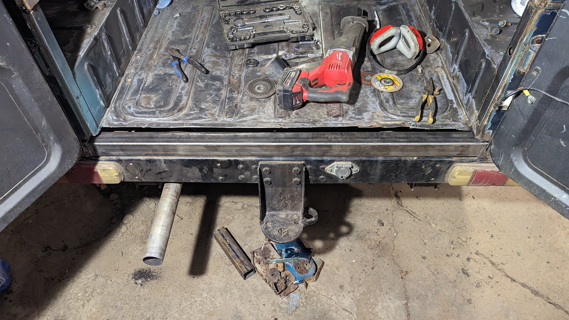

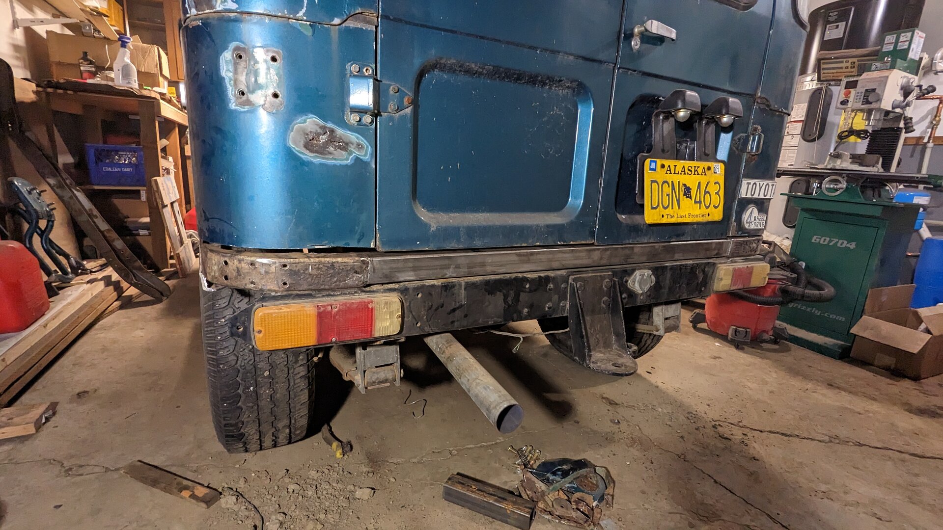

Pictures of my new sill:
2"x2" steel square tubing 1/8" thick with original sill end horns welded to it. Turned out pretty good after alot of careful measurements. Not sure how the sill plate will fit over it and it may need some adjustment, but I'll see how it goes when the new sill finally makes it up to Alaska.
I did exactly the same thing with my 77--you did a better job than i did!!
How did you bolt it on? Once I weld the sill plate in place there will be no way to undo my bolts. I'm still not sure how to make the bolts accessible in the future. Unless I drill holes in the sill plate much like I've drilled the holes in the new 2"x2" sill. But then those holes will be wide open to the elements and all sorts of junk will fall into the sill.

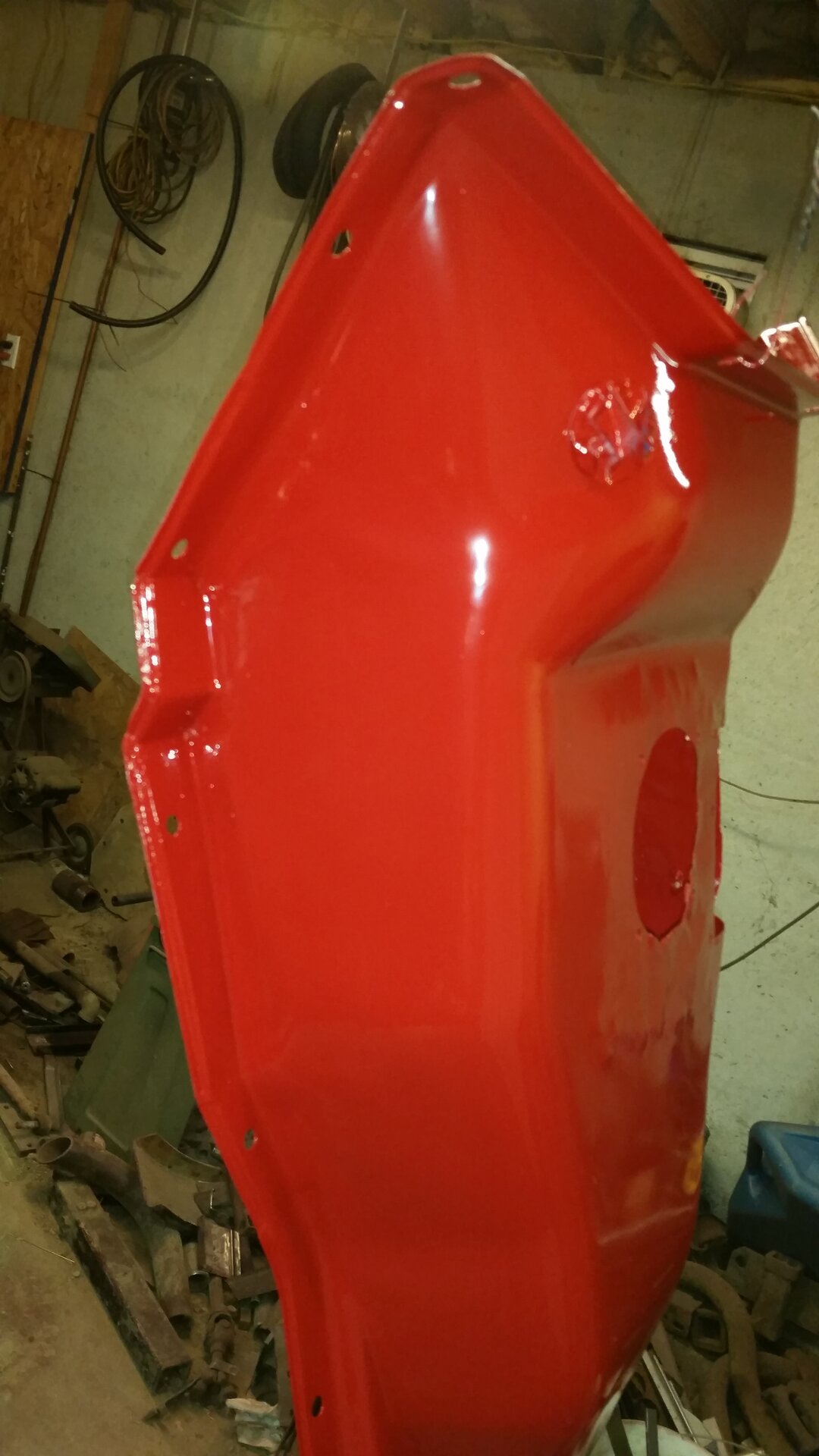

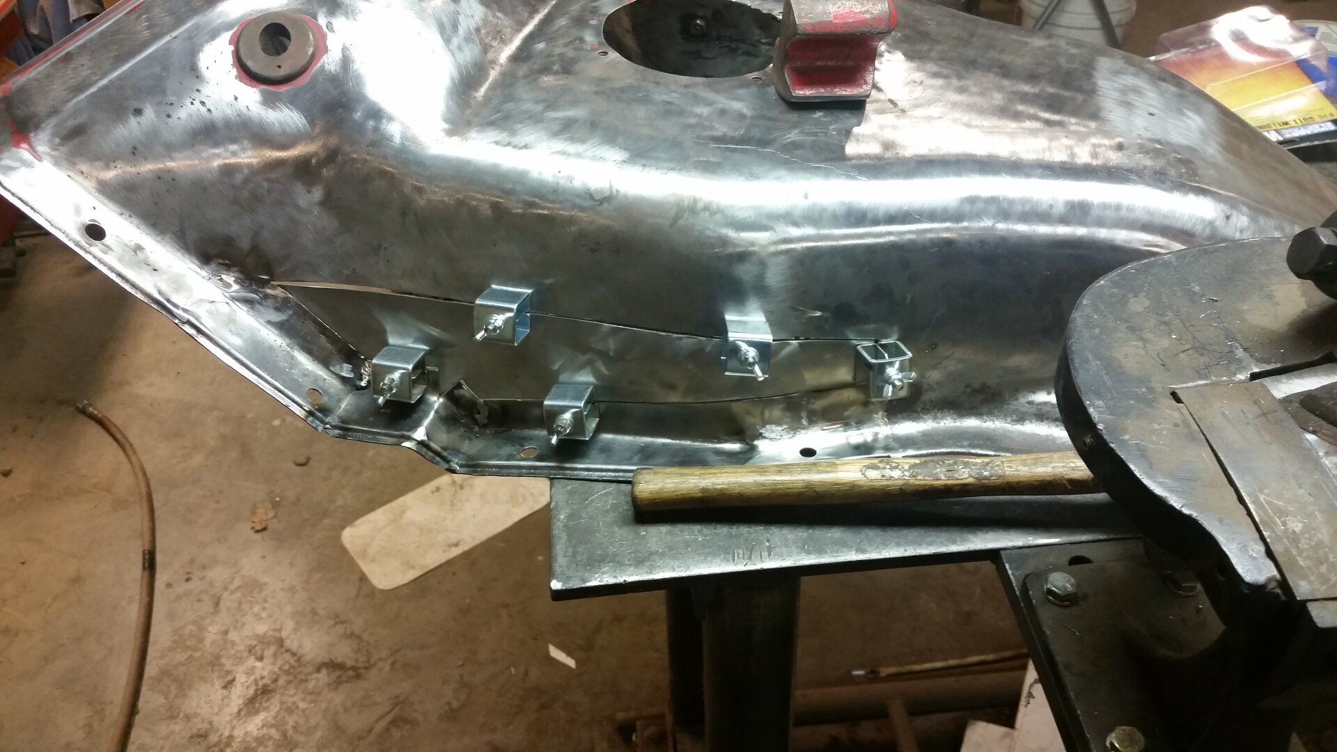

Did you turn the little wheel inside the welder around? (the one that guides the wire into the stinger lead) Most of those wheels on the wire welders have 2 grooves. One for larger wire, and one for smaller wire. You also might have to tighten the pressure that pushes down on it a little.
If you are using a MIG-- use the hard wire .023" (stainless if possible)--no flux core--use 75/25 argon/co2 gas--works way better--unless you are an accomplished welder--I am not, but this comb works good for me--I am not a fan of having to sand/grind off all the splatter the flux-core stuff produces--.30 is way too large to weld the thin sheet metal of a 40-needs too much heat and too much feed-I replaced both front fenders/hood/rocker pnls/rear clips using this--seems to have turned out well--you have done a great job here--well done!--I would offer that the Rustic green is a good color--I would keep it--please keep the updates coming

My welder is a Miller 250 which is a fairly large unit. Miller set it up to run 030 and 035 with the corresponding drive drive wheels and liner and only uses the large diameter wire spools. When I started the Hump project I made the panels with 22 ga sheetmetal. I knew I needed to try and run 023-025 from experimenting with 030, so I purchase 023 drive wheels and tips. I found the wire would birdnest between the drive wheels and where the wire enters the whip. I think there was too much resistance in the whip to push the 025 wire, because the liner is for 030/035 wire. I tried to straighten the whip as much as possible, but still had the same problems. I had no interest in changing the liner, so I remade the panels in 16ga which was more work but, in the end it made for a better repair. IMO 22ga is just too thin. I cut all the rusted out and but welded my panels. I'm not a body guy.
My welder is a Miller 250 which is a fairly large unit. Miller set it up to run 030 and 035 with the corresponding drive drive wheels and liner and only uses the large diameter wire spools. When I started the Hump project I made the panels with 22 ga sheetmetal. I knew I needed to try and run 023-025 from experimenting with 030, so I purchase 023 drive wheels and tips. I found the wire would birdnest between the drive wheels and where the wire enters the whip. I think there was too much resistance in the whip to push the 025 wire, because the liner is for 030/035 wire. I tried to straighten the whip as much as possible, but still had the same problems. I had no interest in changing the liner, so I remade the panels in 16ga which was more work but, in the end it made for a better repair. IMO 22ga is just too thin. I cut all the rusted out and but welded my panels. I'm not a body guy.View attachment 3227393
I agree, I used 18 ga. for most of my repairs, matches the original material. I used 16 ga. for the tub corners at the sill horns just for good measure.
