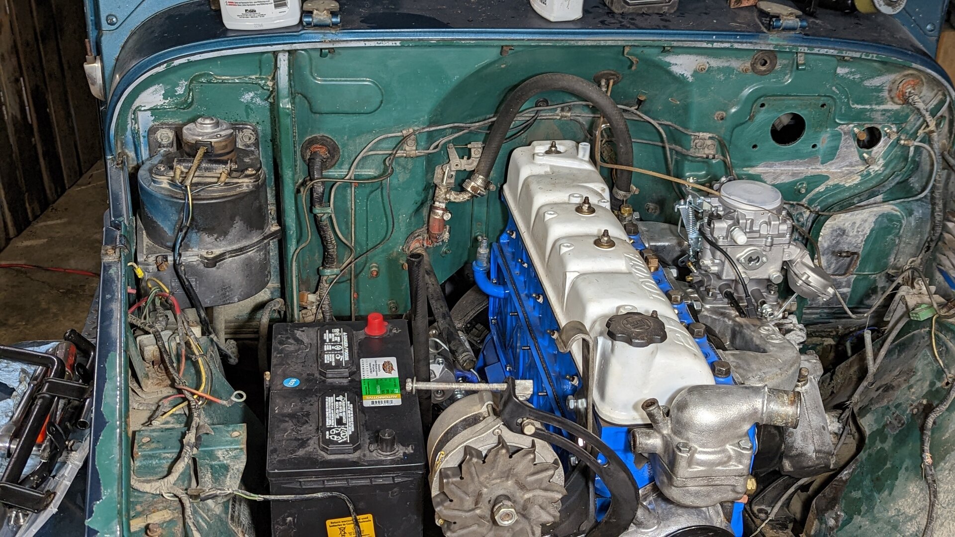

I've added a couple pics of my new rig and the engine block I'm currently getting up and running. Wish me luck and I'm sure I'll be lurking/researching and asking many questions along the way!

Figured, Id post up a bunch of progress pics. I've owned this FJ40 for about 15 weeks, have completely rebuilt the engine, installed the newly rebuilt engine, started it up and have taken it for about a 5 minute run around the block. Not yet registered or titled for that matter so I can't run it much farther and harder than that currently. Carb is a brand new Taiwanese copy of the Aisan carb, and I'm working the kinks out of it. The idle circuit was clogged, and it took me a lot of hair pulling frustration to figure out why it wasn't starting easily and why it wouldn't idle below 1200 rpm without dying on me. Now, it seems to start ok, but still struggles sometimes, especially when its below 0 F.

Brought the vehicle inside of the garage for the first time at the end of November 2022 and was able to install the freshly overhauled 2F engine.
Bored cylinders.
New piston rings.
New gaskets all around.
New crank shaft and con-rod bearings.
Fully cleaned, inspected and painted.
Head and Block checked for warping outside of spec.
New SS Oil pan bolts and manifold studs.
New clutch plate (old one was falling apart)
Reused old flywheel and clutch plate as they were in good condition still.
Valves and seats were cleaned, de-rusted, lapped and re-installed with new seals.
Before dropping the engine into the engine bay, I wire wheeled the frame that would be more difficult to restore with the engine in the way. I then coated the frame with POR-15 rust inhibiting paint.
After engine installation, I slowly began to acquire, restore and install all the ancillary items to the engine. Water pump, fan, pulley, alternator, alternator bracket, radiator, oil cooler, battery... All that stuff.
I also upgraded the original points distributor to an electronic ignition distributor that is a plug and play upgrade to the original system, but still looks original. All ancillary parts to the engine were all meticulously hand restored and painted with POR-15. POR-15 seems to be the standard for restoring rusted or potentially rusted items, and even though it can be spendy, I figured it was worth it to do it "right."
I then bounced back and forth between the engine bay and the interior. You can see in these pics that the engine bay also needed some new paint, so I ordered a single can of matching paint from Cruiser Corp and after removing any rust on the firewall and priming, I painted it to make it look pretty again. I did this behind the brake and clutch master cylinders and also behind the blower motor housing. It turned out nice, and looks brand new. It was at that point when the possibility of bringing the entire truck back to the Toyota OEM Rustic Green first began to nibble at my mind.
