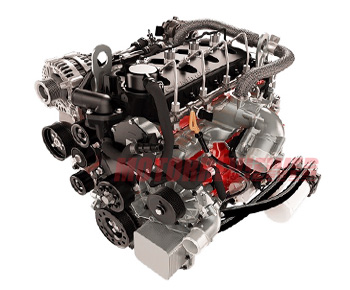

Otherwise, why not Cummins 2.8? Slap a brand new one in, $7,699 straight off of Cummins website. Conversion bellhousing/flywheel and parts are $875 from Quickdraw Cummins R2.8 Toyota H42 diesel engine swap adapter kits

From what I have read about the 2.8 it has head cracking issues around the valves especially .. I read about a guy to put a double squeeze / turbo on his R2.8 which then developed problems .. The engines are made in China and the metallurgy / steel composition is not up to par .. The 4BT engines survive a double squeeze but are crappy on millage so I have read .. I read that you can already buy a new head for the R2.8 that fixes this problem and the new heads use was for the aforementioned double squeeze / turbo .. The pistons would also naturally need to be replaced with a double squeeze but that shouldn't be an issue .. I would like to see a Kitted 2.8 Engine with the upgrades and then yes I would definitely purchase one ..

In the video Cummins R2.8 is a real winner .. They say "that is if you pump up the engine they hint that there could be issues" .. They also said that without the EGR and Catalytic Converter that the Hp gets a bump which is "Noice" .. The Biggest takeaway is the unsprung / over axle weight reduction .. With Cat / EGR its 161 Hp but without they don't specify (for obvious reasons) .. The stock turbo runs up to 22 lbs and peaks about 27 ..

Cummins R2.8, ISF2.8 Engine Problems and Reliability
The ISF2.8 is built and assembled in China. Cummins says what the ISF2.8 engine has 300,000 miles (500,000 km) longevity. But in reality, this engine has a terrible reputation on the Asian market because of low-quality assembling and materials. The most common failure of this engine is a quick wearing of cylinder walls. As a result, increased oil consumption. The next problem is bad connecting rod bearings damaging a crankshaft. Besides that, the engine easily overheats. There is a high risk of coolant penetration inside cylinders. The list goes on and on. The ISF 2.8 engine meets Euro 3, Euro 4 emission standards, depending on modifications.
The R2.8 is built in the Cummins factory in Columbus, Indiana (500 engines in 2017) and carries a 90-day warranty only. They use engine blocks machined at Cummins's Chinese plant. The crate R2.8 engine meets EPA's Tier 0 (LDT 1 and 2) and Tier 1 emissions standards. In this case, it is suitable only for vehicles produced until 1999.
So a crate motor to improve reliability it would need better alloy head & piston sleeves, and stronger pistons .. I think that addressing Cummins with a person email quoting this might get them to respond .. It's not like China doesn't have better alloy materials .. They do ..
I don't want to have to put money into what appears to be a "Great Solution" only to find that Cummins hasn't made their China Builder use materials necessary for the longevity of their motors .. We all expect R2.8 to stand up to the wear and tear or why else would we put that much money in an engine swap if in 5 years the engine is going to have to be rebuilt .. Cummins reputation as a provider of "Long Life" Diesel engines is now tarnished in my humble opinion in regards to the R2.8 ..
