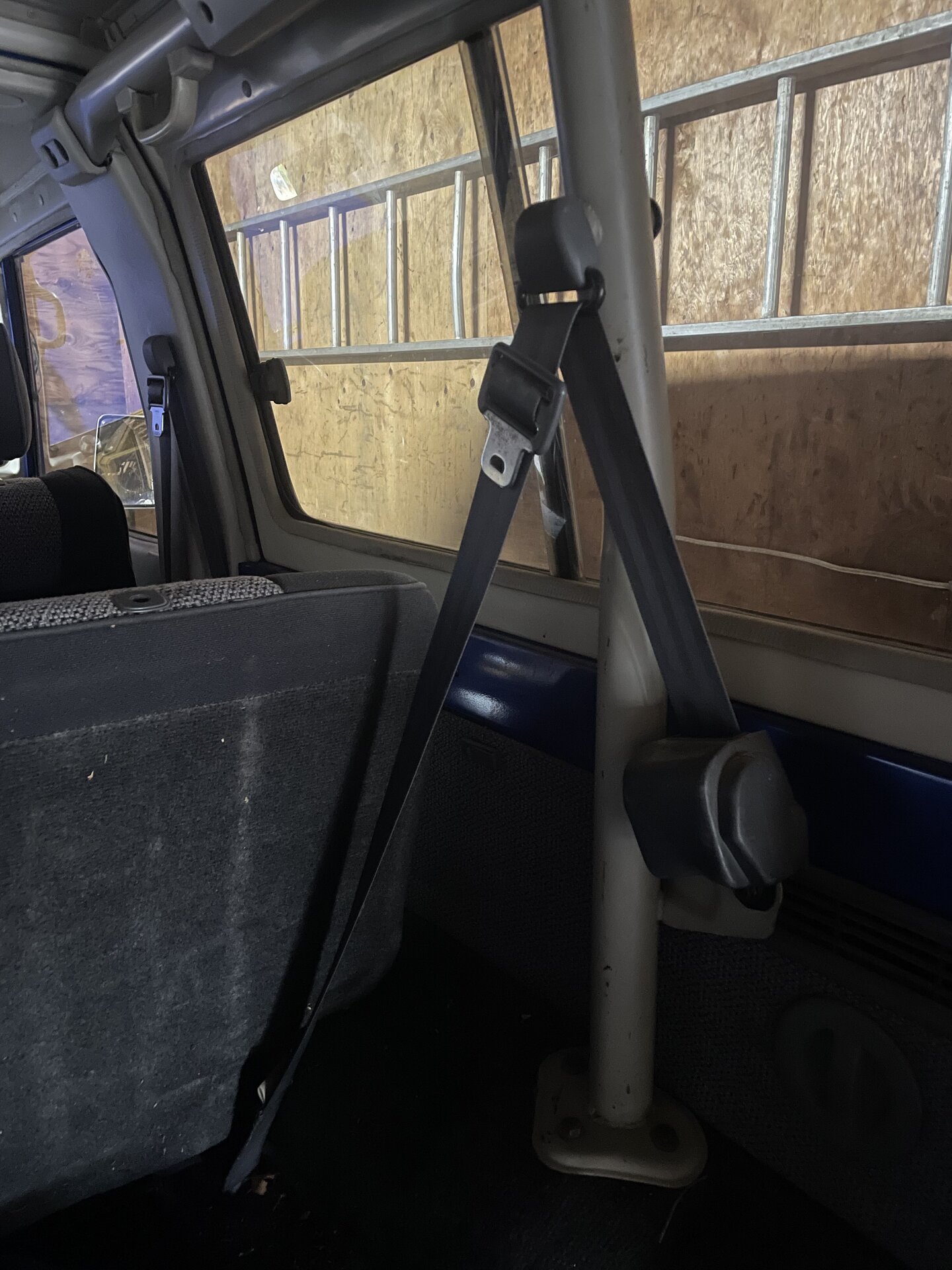

My HZJ73 has rear shoulder belts. But it may depend on the area the truck is from, I have a Spanish (Canary Islands) market truck.
Prados came with rear seatbelts on the 3rd row jumpseats. I don't know about your 73.
I added rear seatbelts to my truck. I have a 77, which is the 4 door version of your 73. Here's some more information for you:
Thanks @Bblair and @ATL Cruiser ill go over that post. In some photos of seats I can indeed now see shoulder belts. I’ll just have to make sure it will have them. Nice to know that they can be added as well.

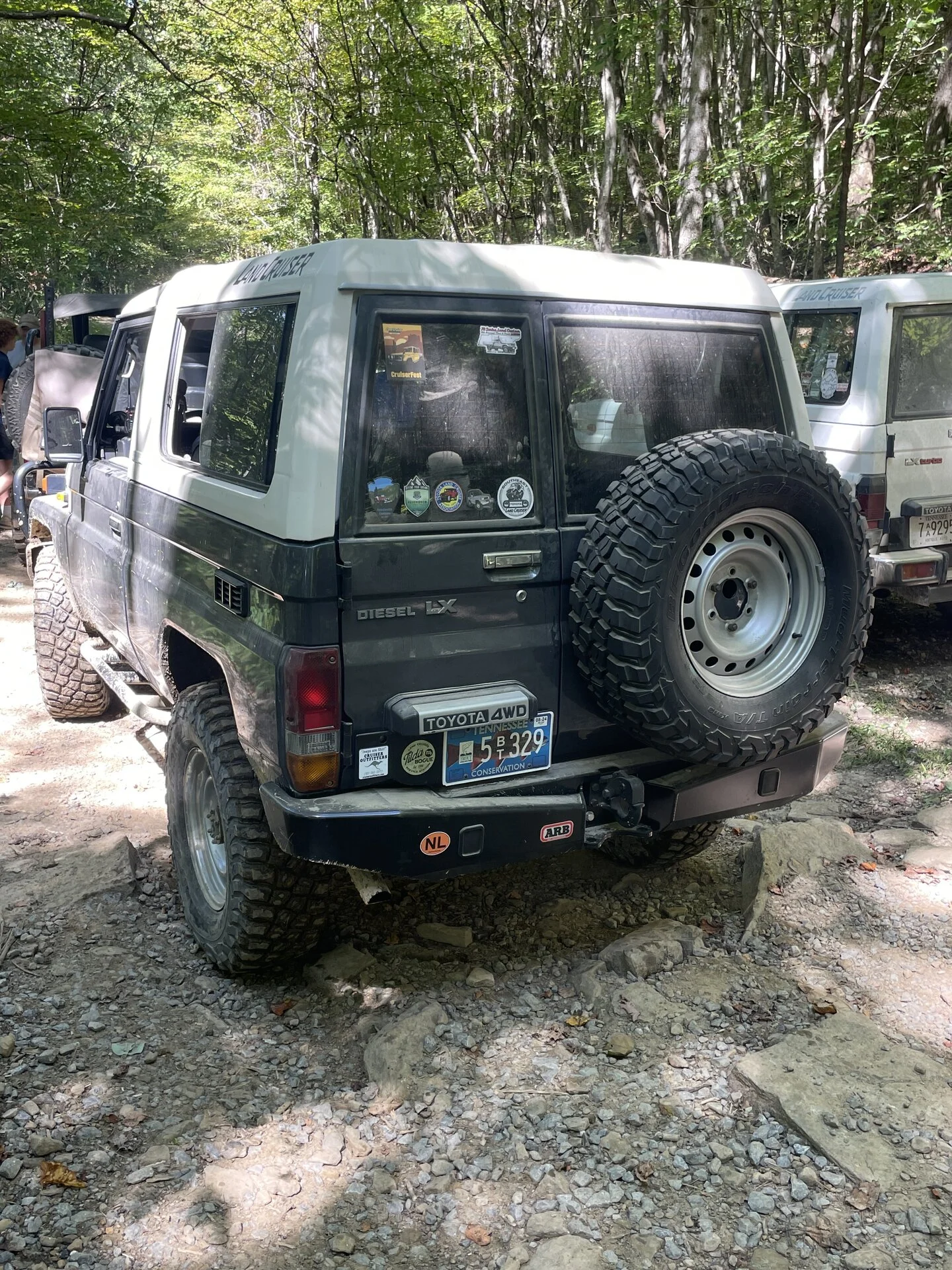

I have a 90’ HZJ73 from the Netherlands that Joe originally sourced and it does not have a rear seat.
My understanding that most, if not all?, European spec LHD 73’s did not have a rear seat from the factory. Some folks add jump seats to the rear and you can see in the parts schematics both were available in some markets/models. Also, the Japan spec rear facing seats have little leg room from my understanding, maybe not an issue for kids but due to limited legroom and challenging ingress and egress, I am not sure how functional a forward facing seat would be for adults.
Good luck in your search, I enjoy mine!

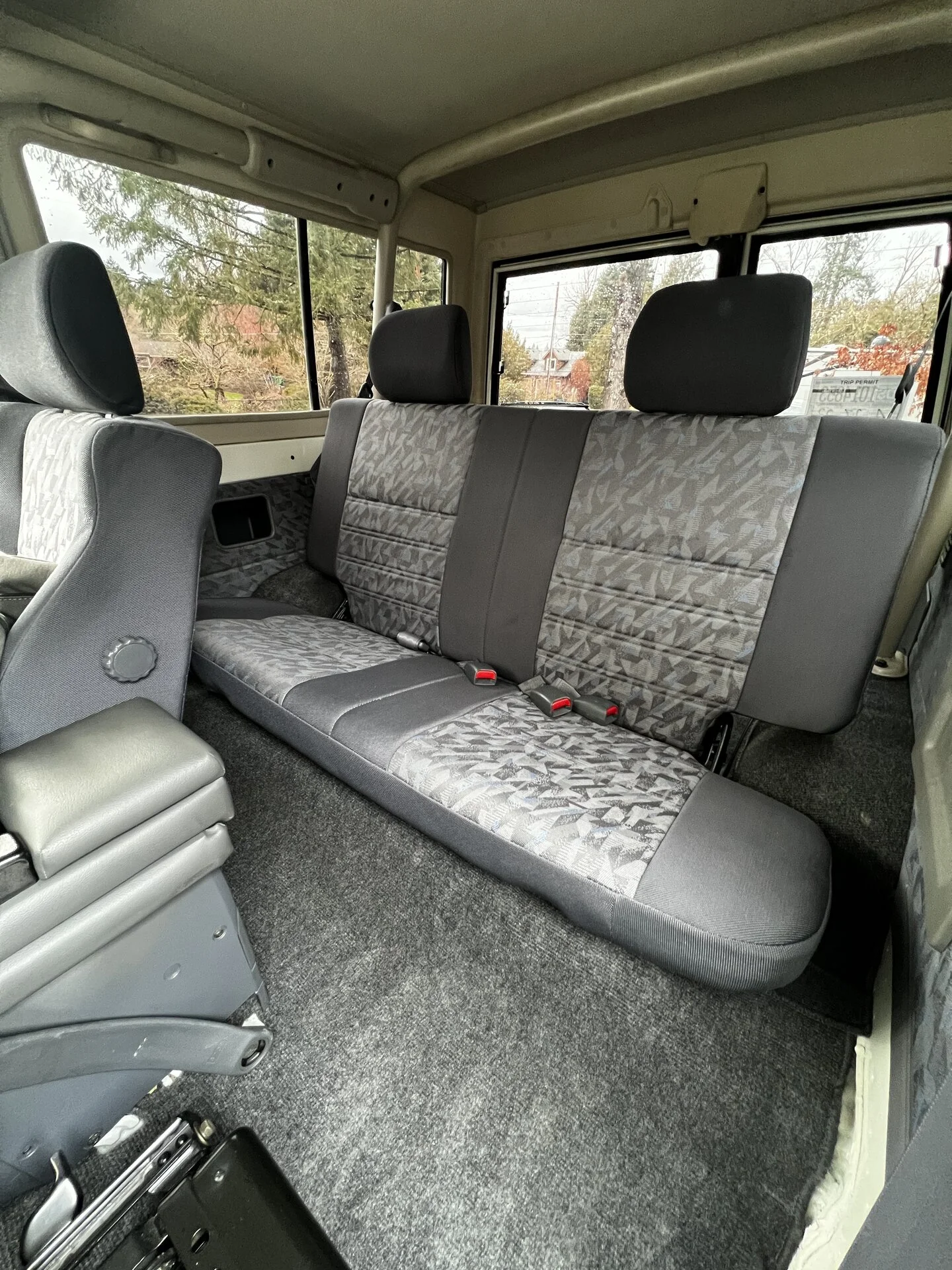

My BJ74 lacks rear seat belts because it is an '88.
Leg room back there is minimal.
The passenger seat does have a semi-auto sliding-folding feature which allows good access to the rear.
Should be able to get kids in and out just fine.

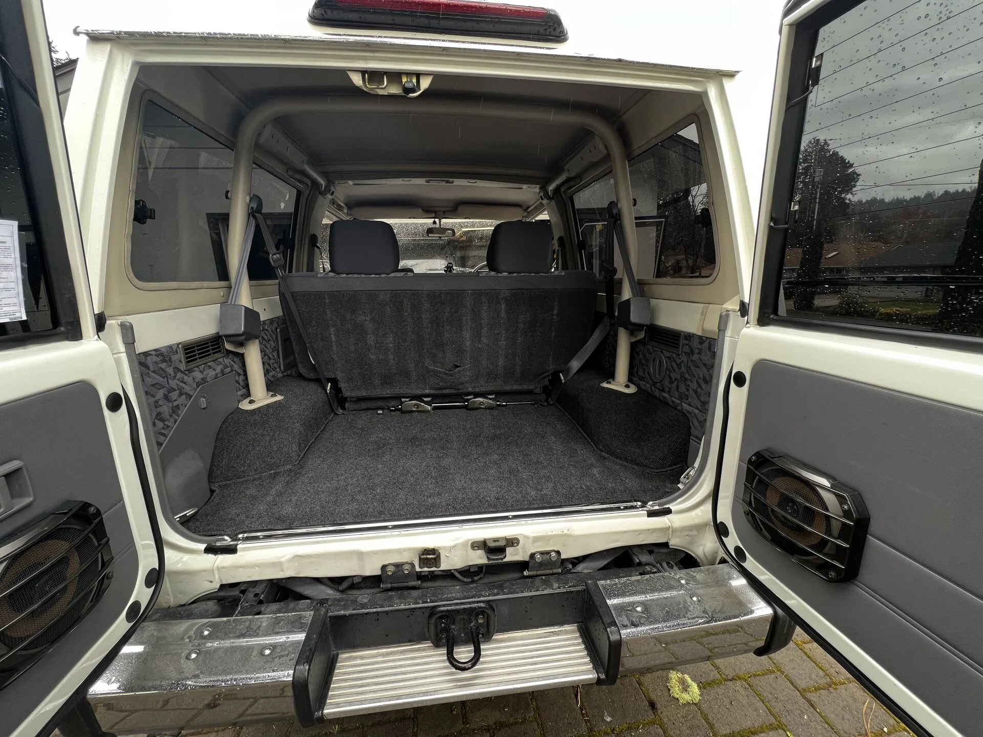

As for seat belts, try and find a rear roll cage. They are sometimes for sale and will bolt in and then you have your upper mounts. If not you could always build a custom full cage and out seatbelts to that.

That is great information on the Roll Bar attached seat belts, makes adding them more straightforward!

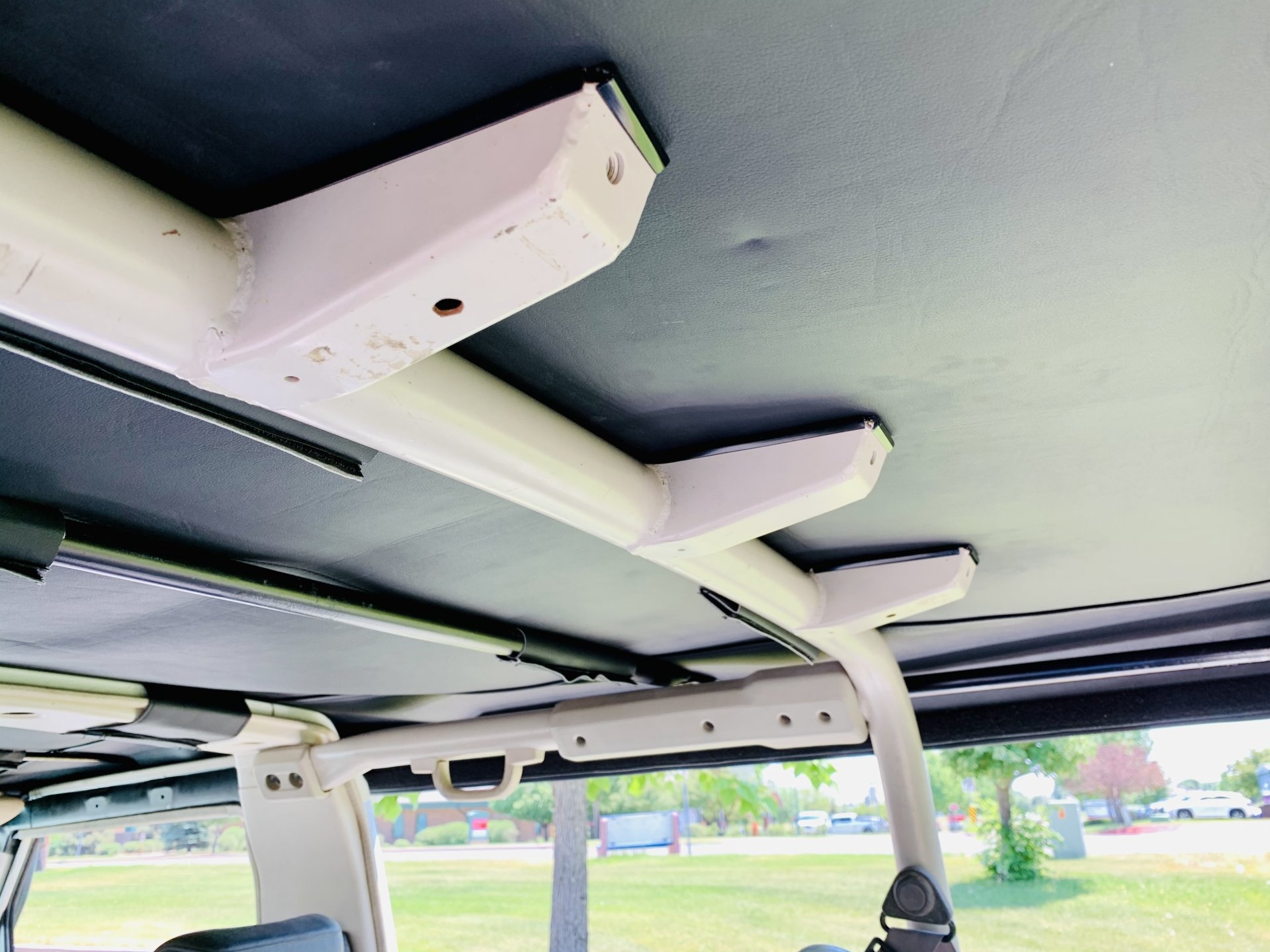

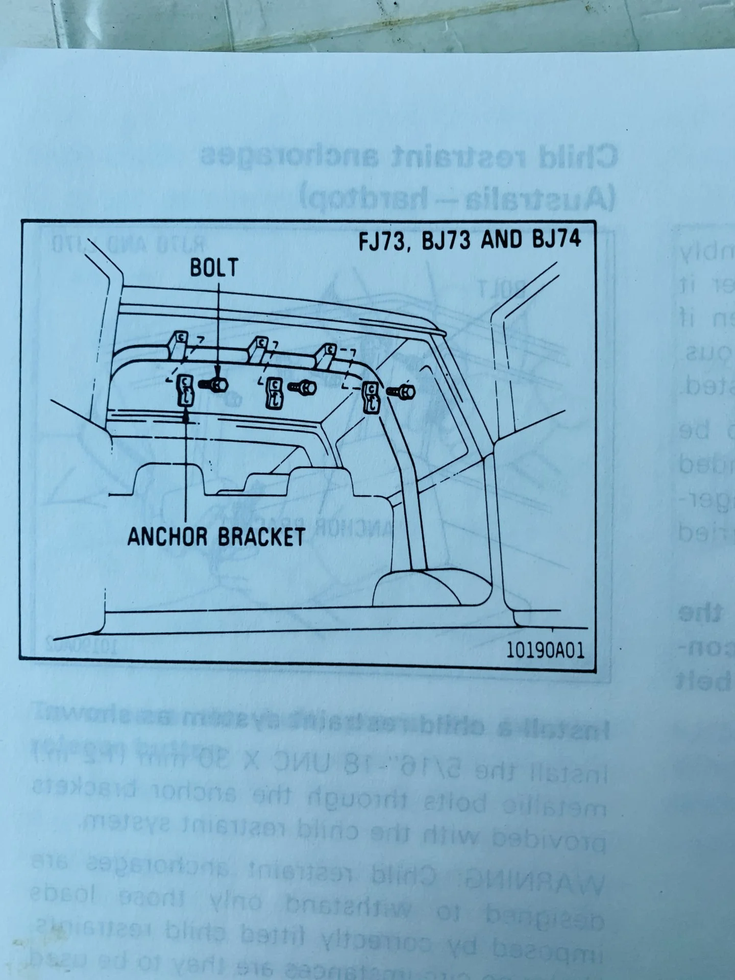

My Australian BJ74 rollbar has the child tether built in. I’ll try to get a better picture of the owners manual describing that later

Also, @FJBen, I am seriously digging that roll bar. It seems like that would be an excellent base for a center-mounted, under-the-top roof rack support.

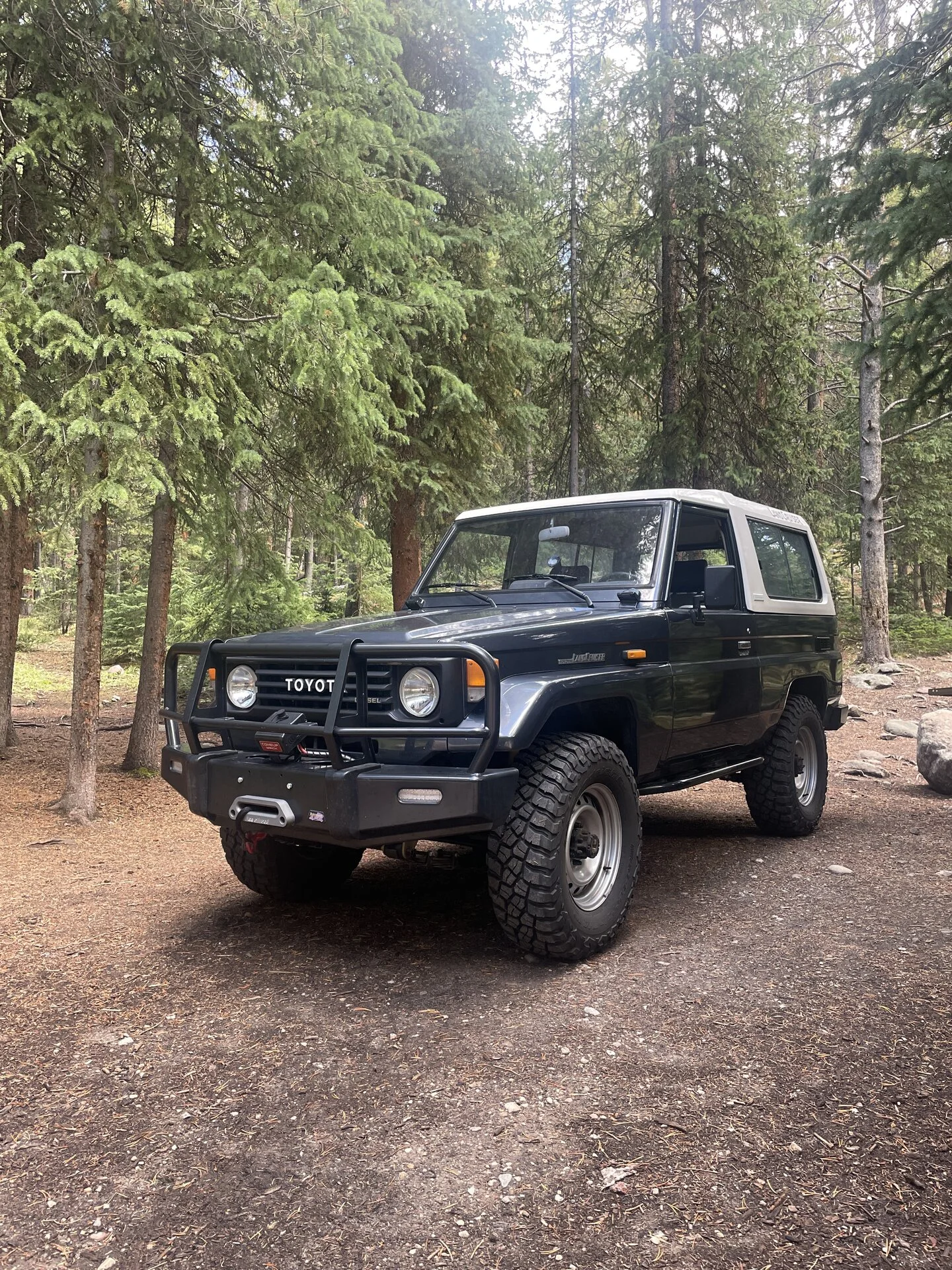

Lastly, @desmocruiser, you might have just altered my front bumper plans; that looks killer on your rig. Dobinsons, yes?

Yes Thank you!
It is the Dobinsons, there are days I love it, others, the 2 I have been trail riding, I plan on making a change!
It has a pretty low overhang and approach, but I agree, it looks great and the quality is excellent !

A tether point looks like an easy thing to add. Use factory points and hardware like @FJBen pointed out, or, build your own.
