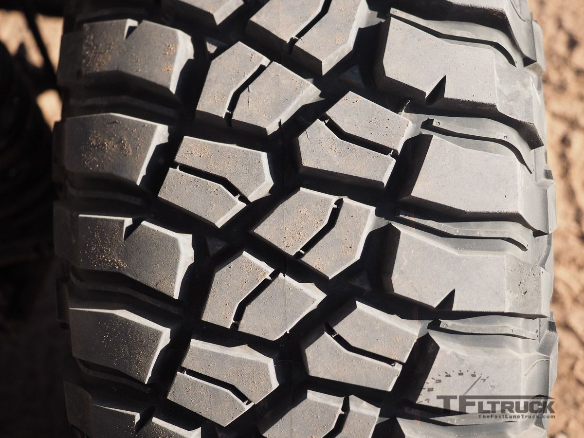

BFG announced the new KM3. With a release date of June, looks like I will be waiting till next month to get some new and matching tires for the LC.
Here are some pictures that I grabbed, yes they are on an LC.
