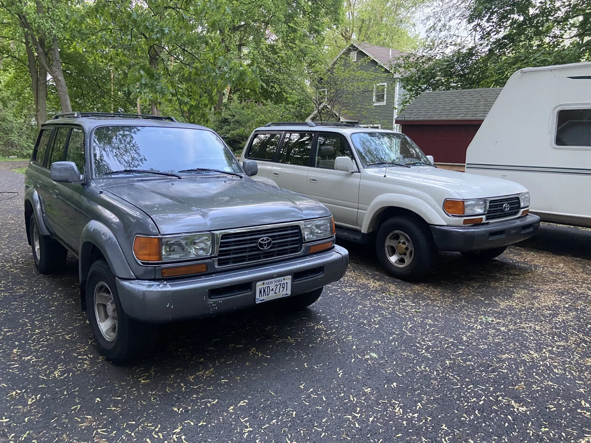

I don' know where to begin searching for an answer in past threads, so I'll just present my dilemma here.
I own two TLCs 80 series. A 96 GRAY in very good, original shape, with no lockers, and a 95 WHITE with a bit of rust and issues, and factory lockers. I am not interested in keeping both, my goal is to assemble a nice 80 pretty much in original shape for long-term ownership. With the exception of a slight lift and lockers which are a must since I do off road every chance I can and more importantly, I am planning my third Pan American (USA-Argentina) trip to take place in a couple of years.
So...do I sell the nice one (gray) and build the rough one with the factory lockers even though it has some rust issues (non structural)? That was my original plan, but after last Saturday off roading and confirming what an excellent vehicle the gray one is (and it has the nice interior, mechanically great, etc.) I am tending to keep the gray, and sell the white one. I would just add aftermarket lockers. What's wrong with aftermarket lockers? Are the original so superior?
I feel I will never make up my mind. Any opinions to help me go either way? TIA, Chris

The mention of rust could point to the deciding factor for me, were I in your situation. Where is this rust? Is it in body panels, rockers or just a bit of surface rust on rear undercarriage hardware? If it's in the body or very extensive in any area I'd likely pass it along to someone more motivated to deal with it than I would be. If it's just some undercarriage surface rust I'd look to clean, convert/treat and then fluid film asap to stop it before it becomes a bigger problem.
The single stage white paint will be easier to maintain and live with, compared to the two stage gray, and if it's acceptable now an occasional polish/wax should be all it takes to keep it looking good for a long time. The gray paint looks like it already has failing clear coat which will only get worse. Is that something that bothers you? If it bothers you the cost of addressing the paint is likely multiple times larger than any other item being discussed including adding lockers, paying for rust treatment, baselining, etc. If the gray paint is acceptable to you now I'd look to keep it covered with something that protects it from further degradation (uv protector/wax of some sort) so that it doesn't get any worse.
I generally prefer newer ODB2 1FZFE 80s and I think that '94 - '95 was when the transition happened with most (all?) of the '95s being ODB2. Does your '95 have an A343 transmission and ODB2? If it does not this would be a big motivator for keeping the '96 and selling the '95 in my opinion as I'm sure the '96 is ODB2/etc.
