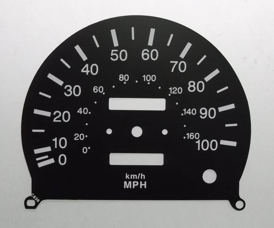

There are a number of different clusters for the 70 series and as mentioned, you need the older metal cluster face and not the plastic one that lets light through for the magnetic paper overlay to work. There are at least two UK companies that offer overlays that are supposed work with the newer plastic clusters that allow light through. I have no personal experience using those overlays but they look like they would do the job
Land Cruiser. KMH to MPH Conversion Dial for imported vehicle. Part No. C836 – Lockwood International - https://lockwoodinternational.co.uk/product/land-cruiser-mph-dial-part-no-c836/
I'm really happy with the overlay I have. It can be slightly rotated around the needle to dial in the accuracy according to a gps. Mine is accurate from 0 to about 60 mph, above that it is off by a couple mph. I have 35" tires, so I consider that a solid win. I'm sure I could fiddle with it more, to get a better balance across the entire range of speed but it's not worth the effort to me. I'm more concerned about knowing my speed at lower speeds than on roads where the speed limit is 60 and above. A dial speedo on a 35+ year old truck is not a precise instrument in any case. Yes the odometer and trip are still in kms, and I don't care. If I need accurate distance, then I have a gps or a phone.
