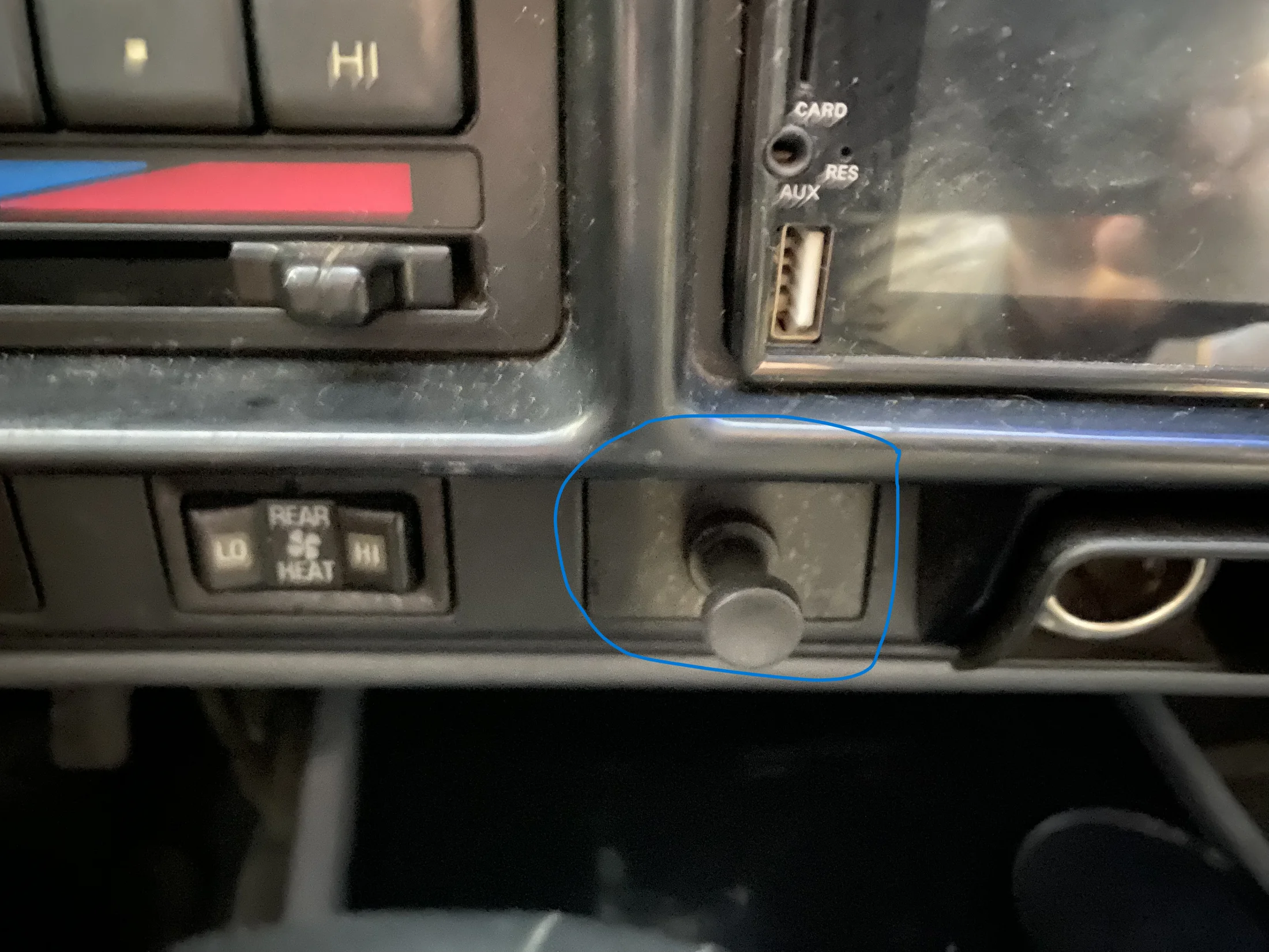

Just picked up an LC80 two weeks ago, and noticed a few pull knobs and ports on the dash that I'm not familiar with (see photos). Can anyone help identify what these are originally for? Appreciate any insights!
First is throttle.
Second is parachute
Third is choke.
First one is an OEM Toyota hand throttle, or throttle lock. For winching, or PTO use etc.
Press gas pedal down until revs are where you want them.
Gently pull the throttle lock out to hold the gas pedal in place, then twist to lock it.
Twist the other way to release it.
Can be used as a poor man's cruiser control.
Just stay alert!
The second is not toyota, it's been added
Just stay alert!
Sounds like very scary function to me....
I am not sure if you are joking but I am going to believe what you said...
First one is throttle.
Second one: Who knows? Pull it and find out. (That's what I tell my :princess: )
Third one is the location for the choke.....on a petrol model. Yours is a diesel, so no choke.

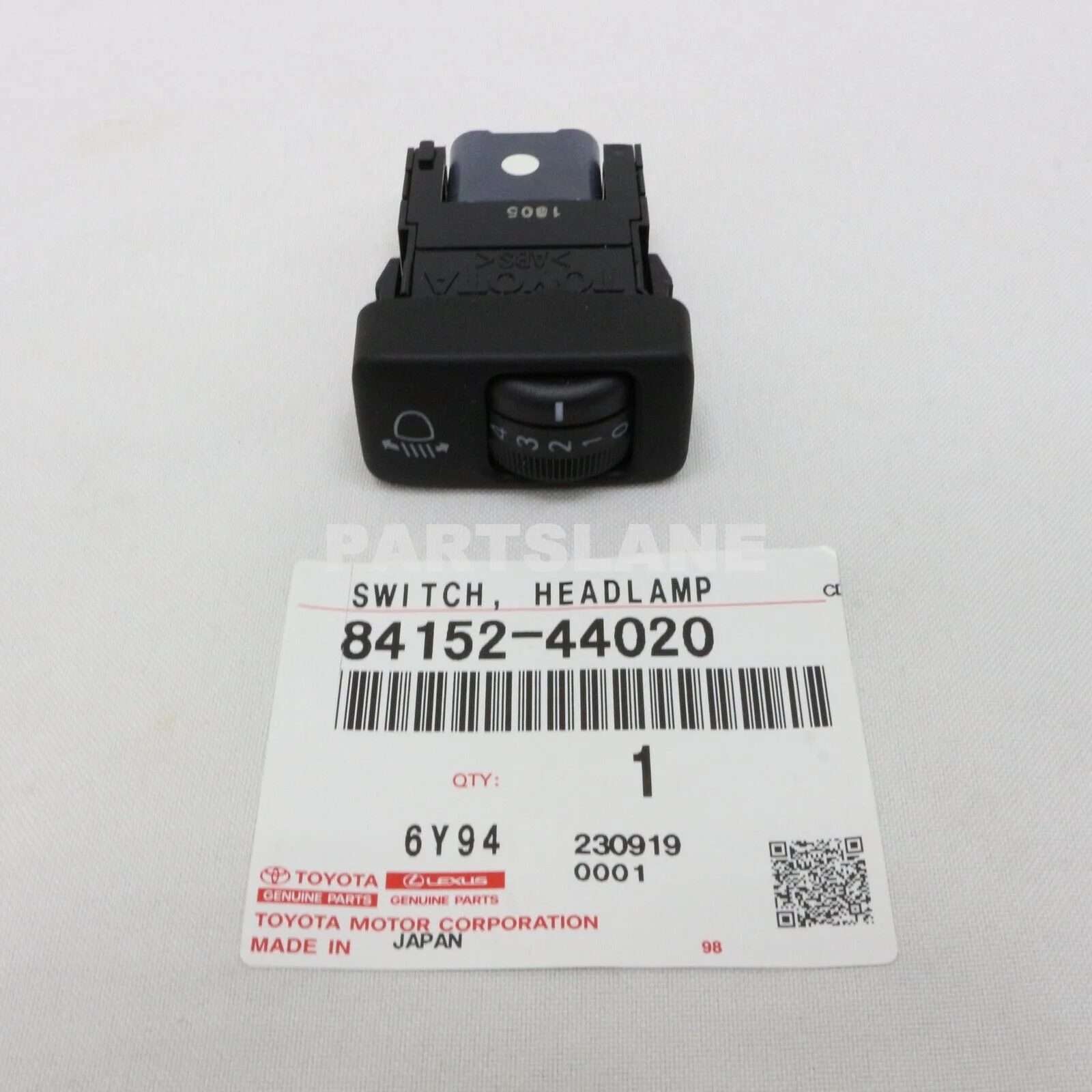

Is that a Headlamp position (up-down) adjustment dial (dial closest to the Diff Lock rotary dial)??
I have not used it yet but I believe you are right
Is there such an option ? Seems quite advanced.

The headlight dial does sound intriguing, I only asked because I would like to know.
I wasn’t sure if you were guessing or had factual knowledge of such an option.
Hopefully the OP will let us know.

From another model, Headlamp (leveling) switch FWIW:

Totally a guess at how it operates, but it definitely sounds cool. I was mostly kidding about the FU mode, but I can think of several situations where it would be nice to turn the beams down lower - say late night creeping through campsites for example. or packing a heavy load that is pointing the nose up.
I have to assume it would require more than just the switch, unless there are some components in the headlight buckets that no-one has noticed before. Seems like you'd need some sort of servo or something. Obviously, we need our OP to get in there and get us some part numbers! 😆
The headlight beam level control was required in some countries since the early 90s. To retrofit it you'd need the leveling switch, the correct headlights (with leveling actuators) and wire it all up. Part numbers are easy to find in Toyodiy, just select a Euro LHD variant.
@mot did a write on install of the Euro specs lights and adjuster.
I now remember that thread. Way back.
