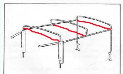

I have a set of OEM soft top bows and one of the top cross pieces is bent up. I would like to repair/replace that piece (I have a stock piece to scavenge so I have the right pipe diameter and arch). I need to know the installed measurement of the width of the "side" pipe (inside to inside or out to out, makes no difference to me) at each of the cross bars:

Thanks... I THINK I'm good with the measurements posted here... I MAY even build the replacement with a sleeve and set screws so I can adjust in place. Plus being able to take the rear bow apart will make storage easier.
Pls document and post up the ingenuity Pls. I like that idea and would like to see how you approach it. I like how @cruiserjunkie did the adjustable spreader side bow in @Pin_Head 's thread at the very end... Wish I could see a pic of the bow setup without the top on, so that I could understand the placement etc.
