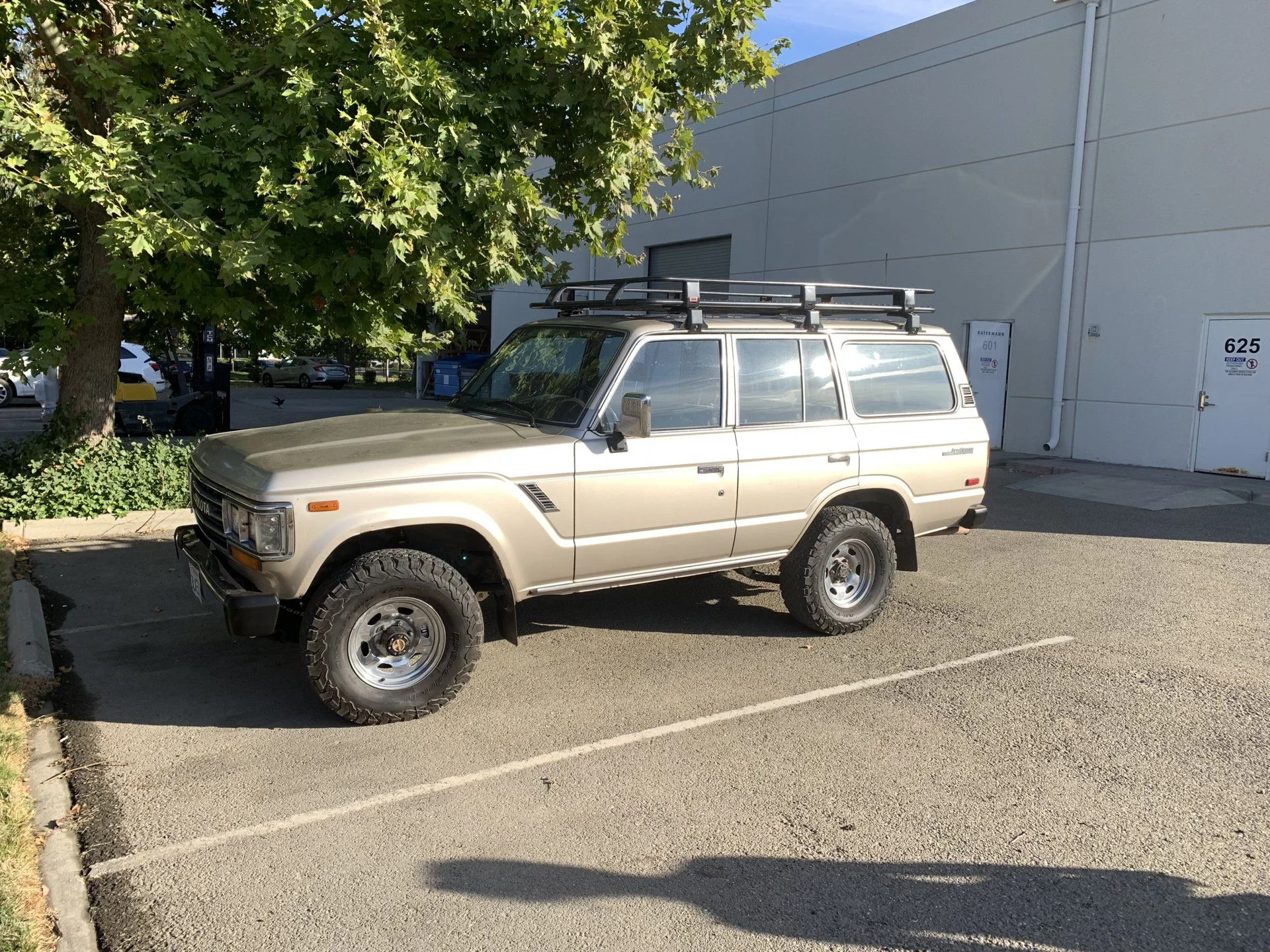

thanks for the replies! I am going stick with the 31's.
your 31's look good to me. seems like they fill the wheel opening just fine.
