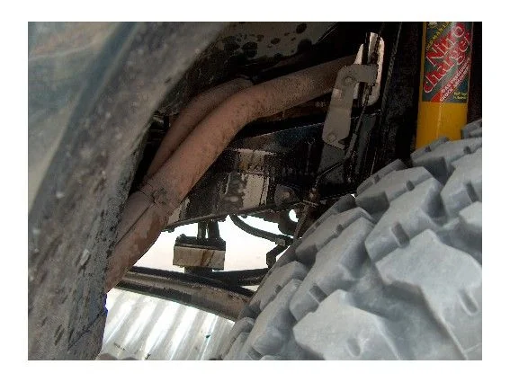

Well, headded up to Los Alamos for the last match of the year early this morning and I got about 30 miles up the freeway when I smelled burning oil :eek: . I pulled off at the closest exit to take a look and dang, there was oil everywhere. :eek: It was about a quart low and dripping profusly from the RH side of the engine. I put a quart in and pointed it home and off I limped. It took 2 quarts to get it home and I have a BIG MESS on my hands.

This does not look good for Homestarrunner...
Why are the springs and shocks spotless Dan?

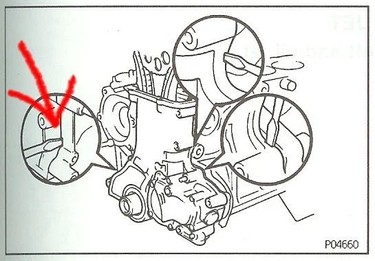

I can watch it come out. It is coming out at the lower RH corner of the timing cover, right where there is a screwdriver slot milled in the cover to allow a screwdriver blade to be inserted to pry the cover off. It is between the two lowermost bolts, about even with the lower middle of the A/C compressor. It starts to come out about 10-15 seconds after engine start-up and is a steady flow. It pushed out about 2 quarts in around 30 miles of driving to get it home.

Dan, I was really bummed when I read your first post, so I went out to look under my hood. The reason I then asked the question was that in the picture, the top of the AC compressor bracket looks wet and that's a ways from the timing cover.
So armed with a blowup of your photo and the diagram (and a flashlight) I took another look. Now I'm doubly bummed. My screwdriver slot has oil around it.
I get down to a quart low just about the time for an oil change. So that's a quart in 3000 miles. You must have a mini-geyser and I apparantly have one brewing.
I had no idea that much oil could be lost from a timing cover gasket leak. I wonder if what happened to yours is in the future for the rest of us.
