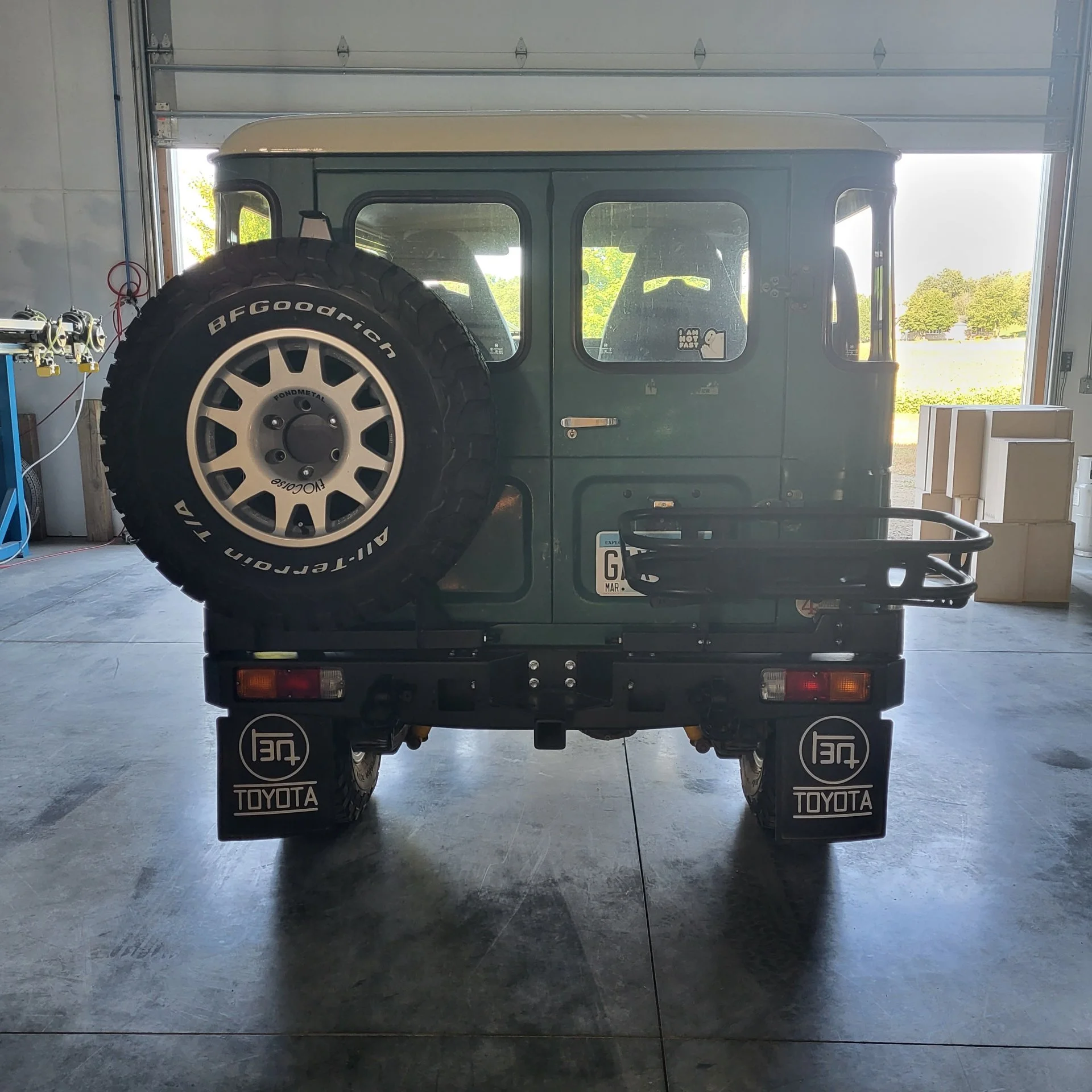

Not a great picture, but the removable basket installed on the passenger side.
And with it removed. (And the reason why it gets removed sitting there...)
I won't be running with the basket very often. Basically camping and other trips. That's about it. I don't see the point in carrying around an empty rack either.
The goal has always to be able to open the one door without having to open the arm. The dog gets in and out four times a day, and the rear door is the easiest option for her.

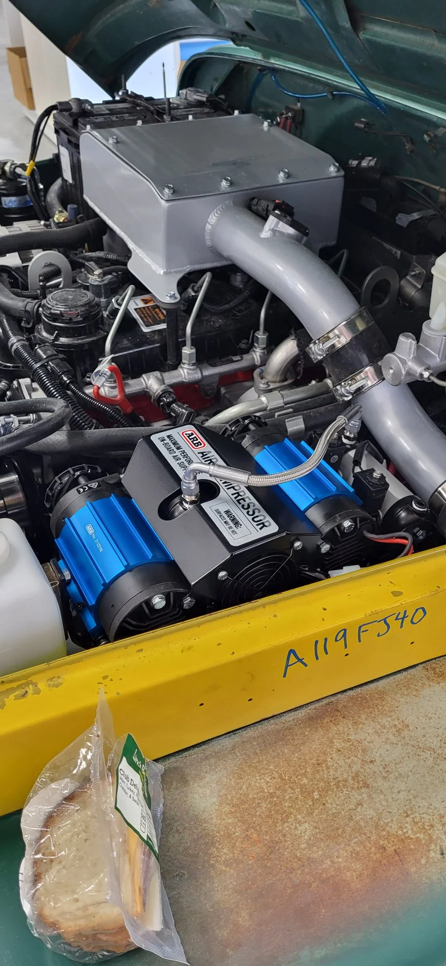

I got the compressor bolted in place, I need to get it wired up yet, and get the wires ran in the cabin. I also need to dig through the boxes and see if any air line was included.
I think I'm going to move the hazard switch to the hole just to the right of the cluster, and the pull switches for the lockers will go in the hole that was for the hazards, and for the choke. I think that is my cleanest no drill option.
The power switch for the compressor will be going in my console.
I made my basket removable as well, as time passed I don’t think I’ve removed it yet. I thought I’d build a bike rack, but i found a deal on a hitch mount. The cooler is good optional storage from time to time. Occasionally for consumables…

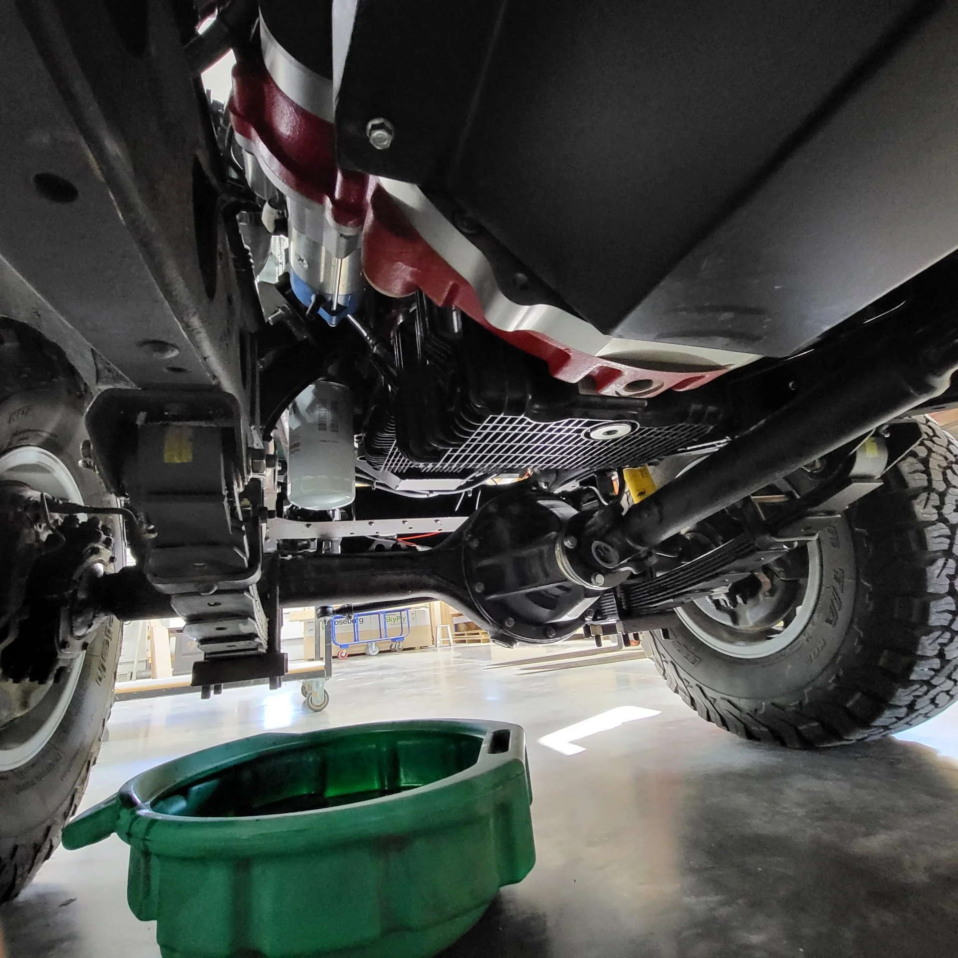

Just did my first oil change with about 1100 miles on the engine. Maybe a bit more. I'm not sure how many miles Proffitt put on.
It runs super clean, I haven't seen a hint of smoke. Maybe just a fuzz of hazing after engine braking, then getting into the throttle hard. Like decelerating to make a turn onto another road, then accelerating aggressively. But very short lived, and not much.
I am surprised at how dark the oil is after so few miles with how clean it runs. There was some ferrous goop on the magnet. Nothing out of line in my opinion, and no glitter. I don't have a way to cleanly cut the filter open to inspect that. I also couldn't get it loose by hand, and went for the trusty "stab a screw driver" method. So it wouldn't have been a great one to cut open anyways.
I really should invest in some filter wrenches.
In normal Cummins fashion, the drain plug just requires a 3/8" ratchet. It is o-ringed, versus a crush washer, I like that as well. Plug is right in the bottom of the pan. My stupid Ford pickup, it's mounted on the side, and I get oil everywhere when I change that.
PRLC puts the filter in a great spot. Super easy to access. It's vertical, and won't make a giant mess when changed normally. Stabbing a hole in the bottom doesn't count as normally.... 😬

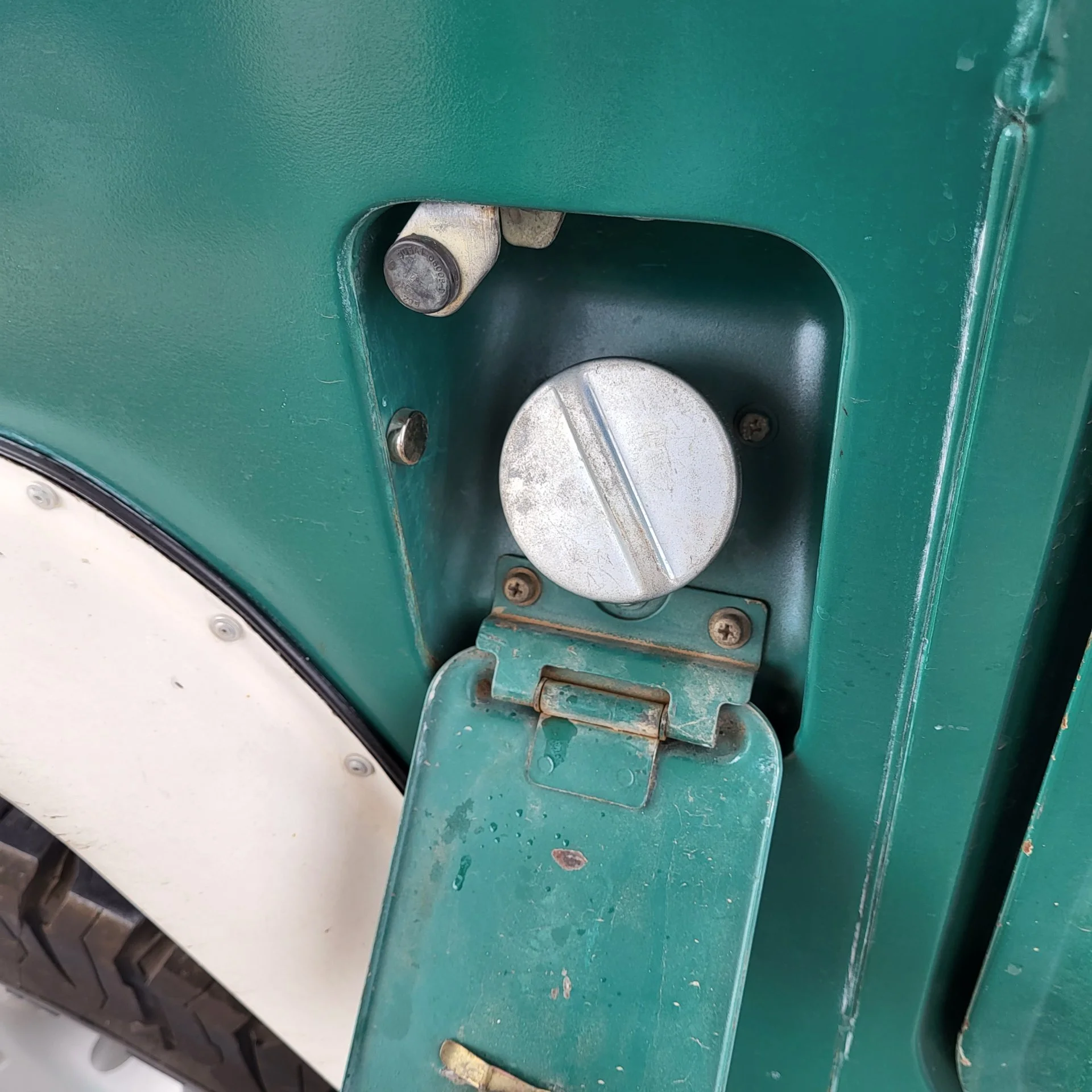

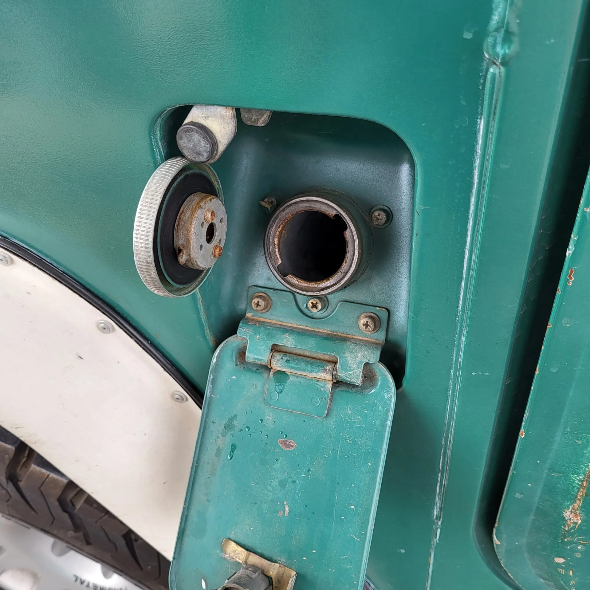

Pro tip: neodymium magnet on the side of the fuel filler well holds the cap nicely.
I was setting it on the gutter, but I don't care for setting anything on paint.
If it doesn't work on your Aqualu tub, try contacting a sorcerer. 😋

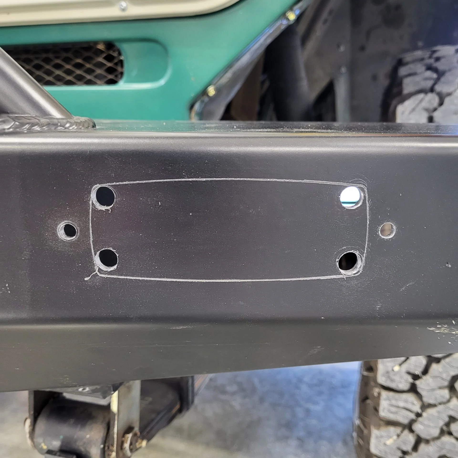

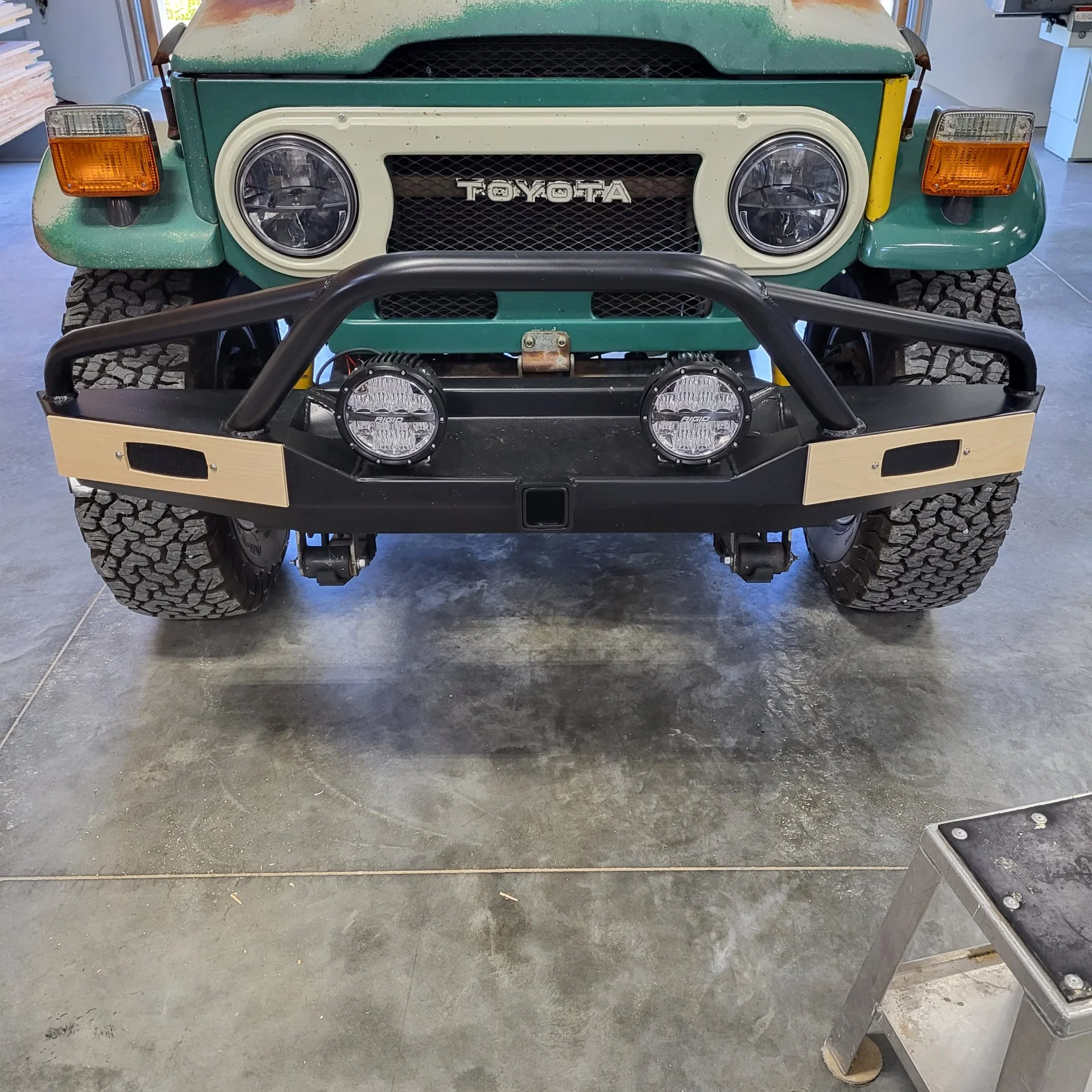

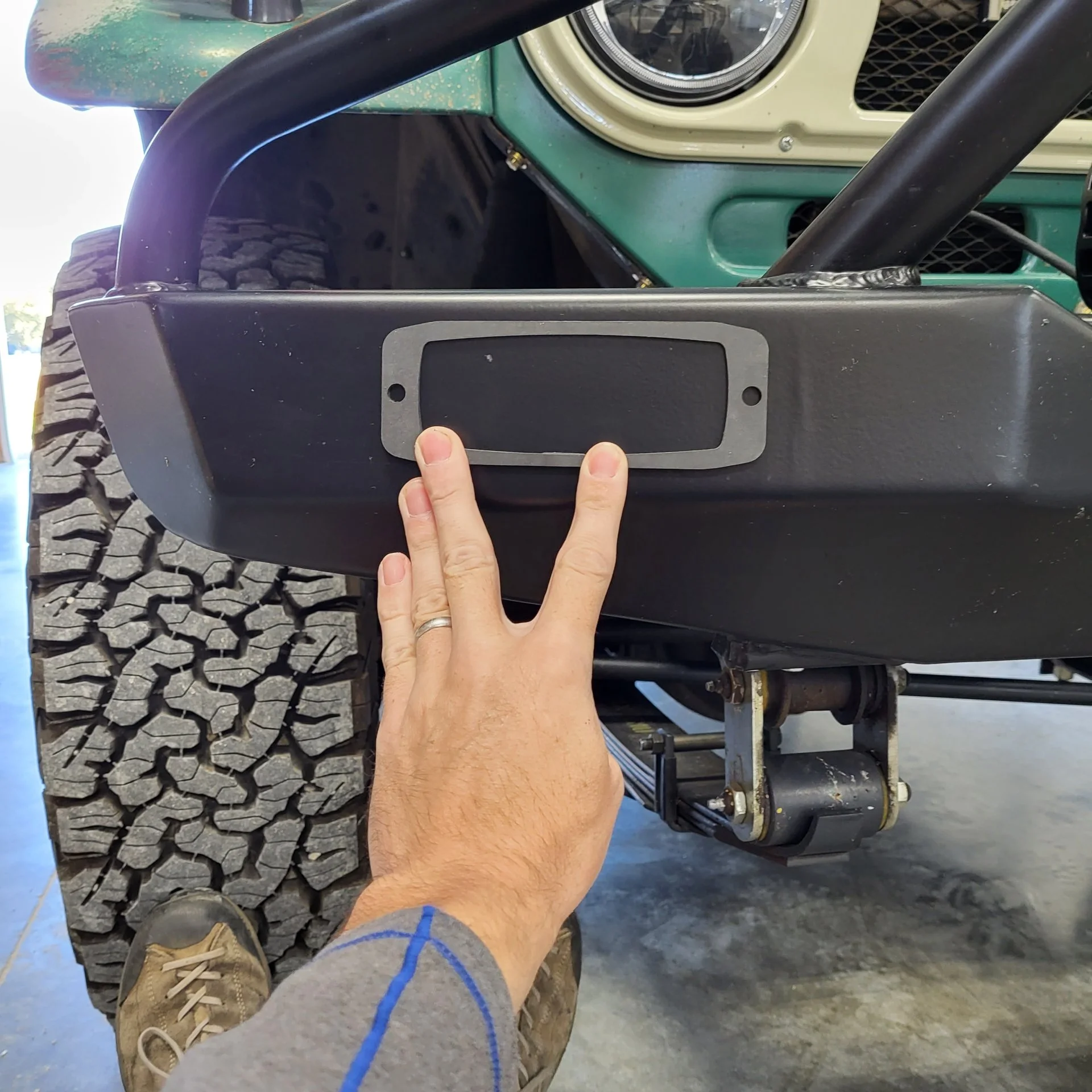

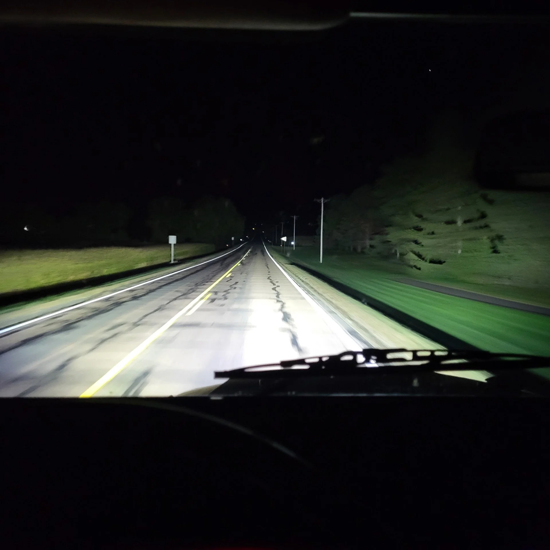

Got the bar lights mounted in the wings of the front bumper today.
Started out by figuring out where I wanted them to be. I decided to center them between the long points on that facet.
Used the cnc to make a template. I made the hole in the template quite a while ago, but didn't know the overall size, or where I wanted them to be placed until now.
My template had the mounting holes on it. I drilled the holes, then bolted them to the bumper to make scratching the hole placement into the paint easier.
After scratching in the holes, I th removed the templates, and drilled holes in the corners. Didn't do that particularly well, but close enough.
I cut the light holes with an angle grinder and with a metal blade in a jigsaw for what I couldn't reach with the death wheel. Cleaned up the holes with a die grinder, using two sizes of carbide burr tools, and an abrasive drum. I failed to get a picture of the holes. They weren't terrible, but certainly not cut by a robot. Passable. 😆
And all four lights mounted.
You're ganna have a cooked meal next time you decide to clap a deer :rofl:
I'm just hoping the little prairie maggot bursts into flames before I actually hit it.
Pictures don't do it justice. It is stupid bright.

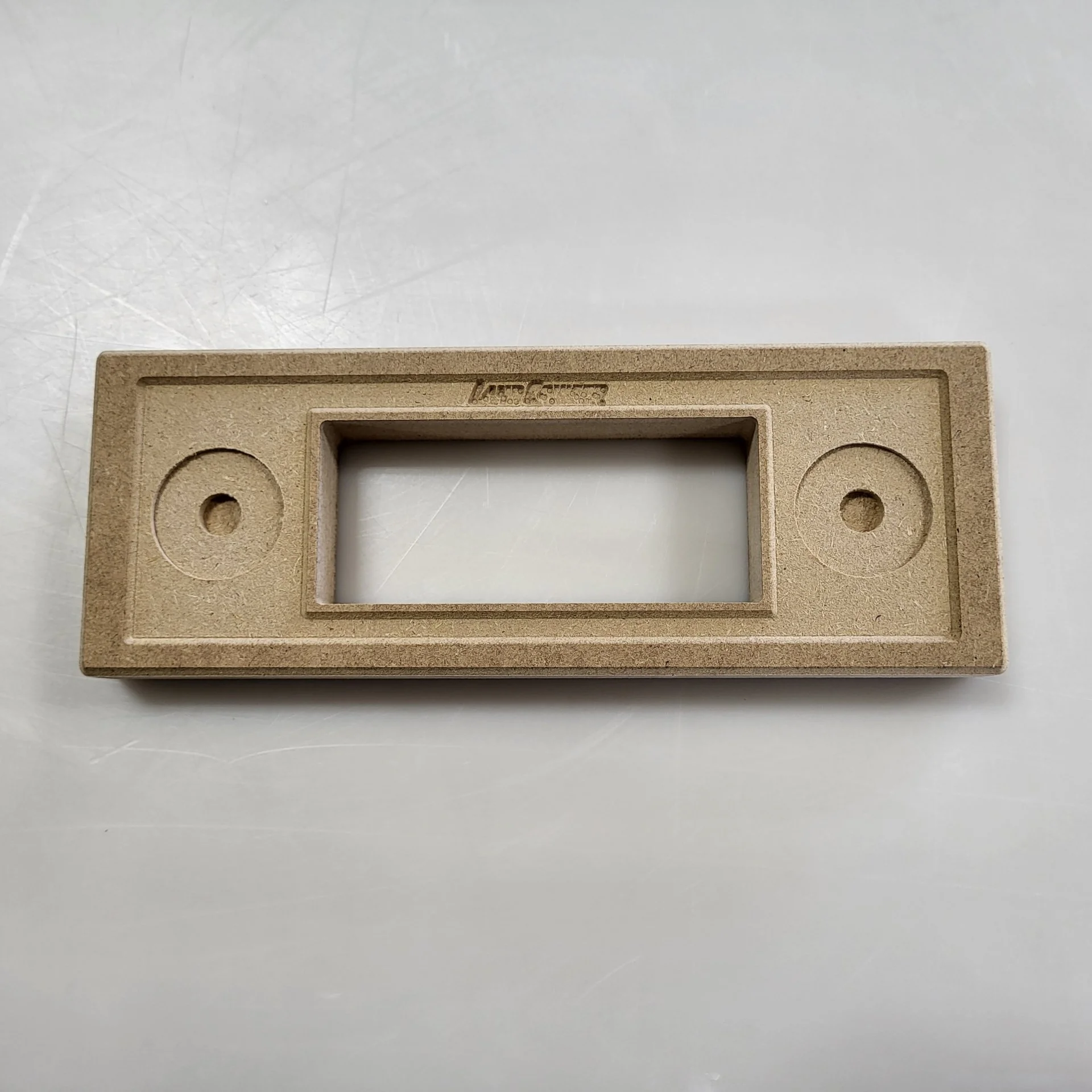

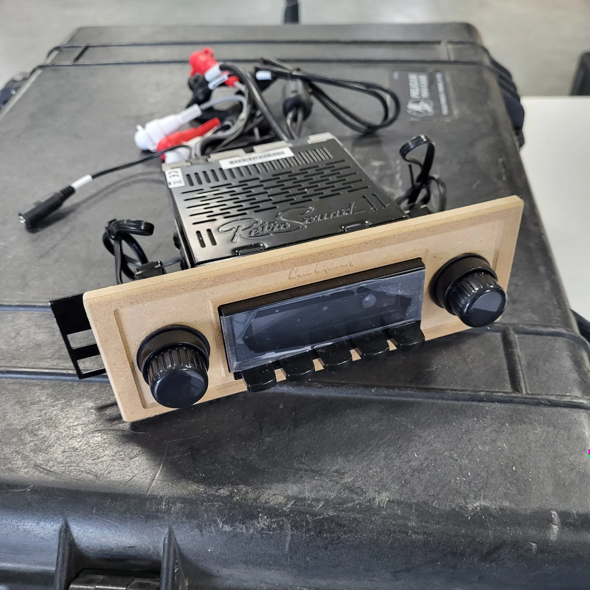

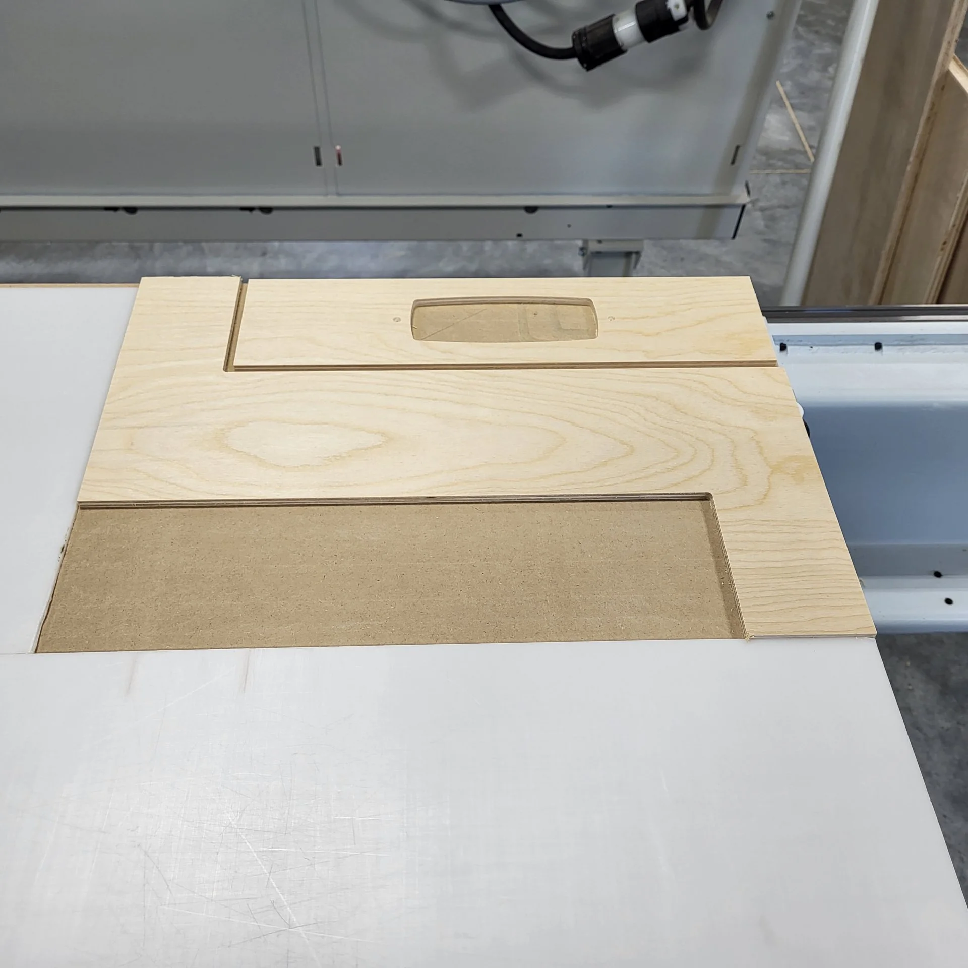

Trying to come up with a remedy for the giant hole hacked into my dash for the radio.
I cut a prototype face plate from mdf on the cnc today. Still needs done tweaks, but I think the idea is sound.
It is a lot bigger than I want it to be.
I engraved LandCruiser just above the radio and I'm struggling to get that looking correct. It's so small, getting the depth correct is a challenge. Both of my test runs were failures on that. I might have to abandon that idea, or possibly get smaller tooling. Or, test run the depth of cut until I get it right.
Might be nice to add "Volume" and "Tune" above or below the knobs to eat up some of that real estate too.
Mounting the radio itself is going to be a big ol' bag of suck. I have one mounting spot on the bottom remaining. The sides have been cut away. I think my plan is to make a tray that bolts to that mount. Then some little brackets on the sides to bolt to the head unit and the tray. I'll have to bolt the tray in, attach the head unit with the brackets attached to that, then the face plate last, which the way the Retrosound is setup, should be easy..... I think.... 😆🤔😑🙄😔
Looking pretty good! What if you left a little more space between the letters so they would stand out more?
Thinking on it a bit, I think I can shallow up the depth a bit and get there. I need to test it to find out. I've never tried doing letters that small.
Maybe source some rub-down decals for that logo.
I just need to monkey with it a bit. I'm sure I can get something acceptable to work.

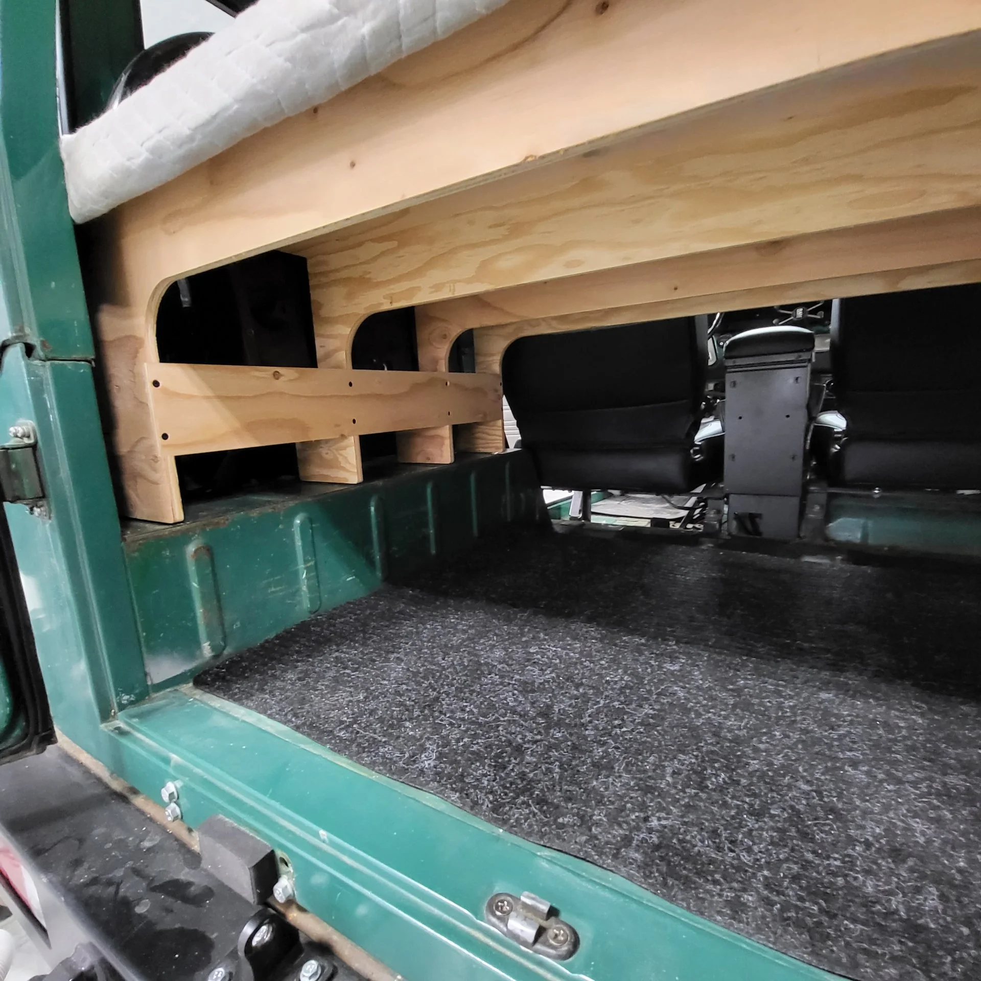

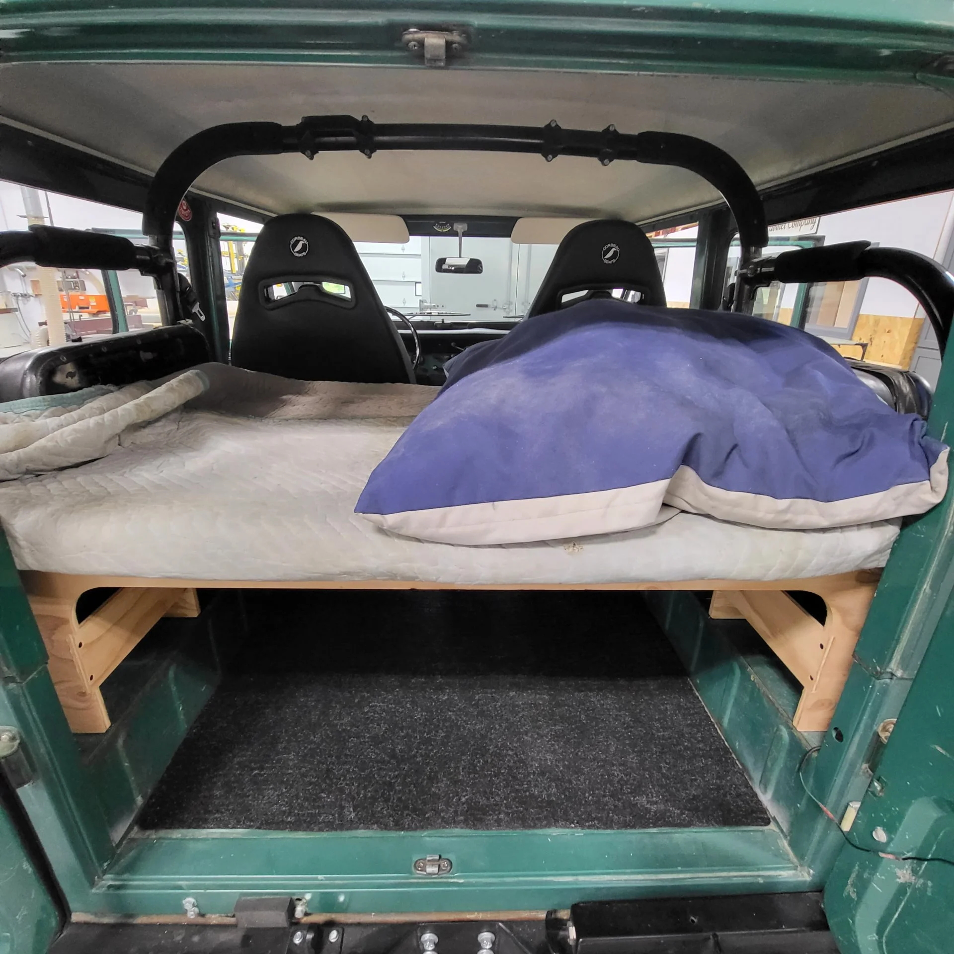

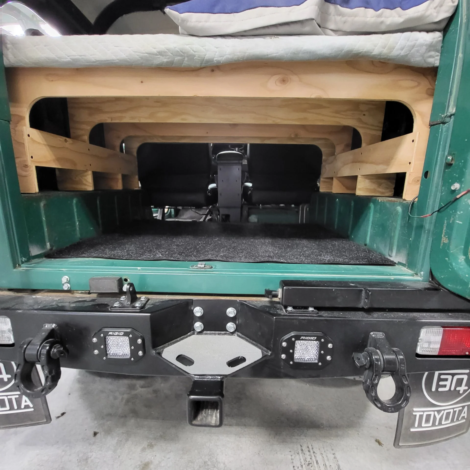

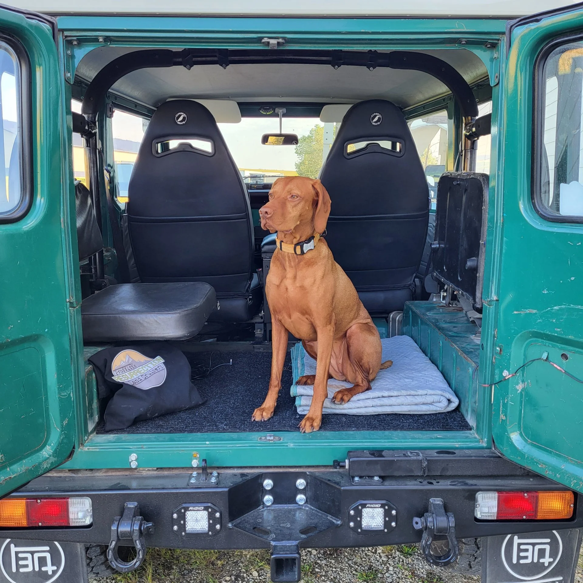

Going to do some trails in northern Minnesota this weekend. I quick built a little platform for the dog so she can see out the window. Basically just ½" plywood sheets that come as padding for other more expensive materials, is what it's made from.
I love robots.
If I were to make it again, I would make it shorter in height. I made it tall enough to clear the door opener handle for the driver's side ambulance door. I think that is much taller than necessary. Doing it again, I'd drop it down so it was underneath that handle. It would go down in height about 4½" doing that.
My top shelf was too wide. I couldn't get it through the back door at all. I trimmed an inch off of either side, and it slid right in at an angle.
The section between the jump seats needs to be narrowed up about ¼" just to give a little more wiggle room.
The whole thing had to be assembled in the vehicle. I'm not a huge guy, but making it shorter would make that more difficult

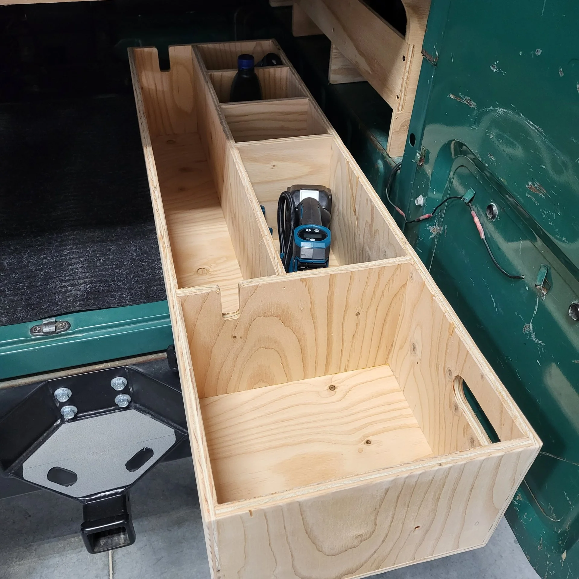

I also made a little box quick to throw miscellaneous crap in.
Neither one of these is well made. I just blasted them together for the weekend. 😆
I'm betting both are in the dumpster soon.
Finally got my ARB compressor wired up today. Super simple, just hadn't gotten around to it. My switch for the compressor is in the console. The switches for the lockers are in the dash. I'm going to get some smaller gauge SO cord to extend the locker switch wires back up to the dash.
A complete waste of time, but I extended the wires for the front lights so I could use the switches in the console. It's a waste of time because I'm just going to rip it all out again, but I hated the way I had it ran before.
This is the best way to run the dog.
Oh man, adding that shelf in the back has made riding with the dog so much better. She can see and isn't driving me crazy jumping from the back to the front every five minutes.
She just hangs out cool as a cucumber watching the world go by.
There is a nice amount of room underneath as well. I don't think I'd change the height now
