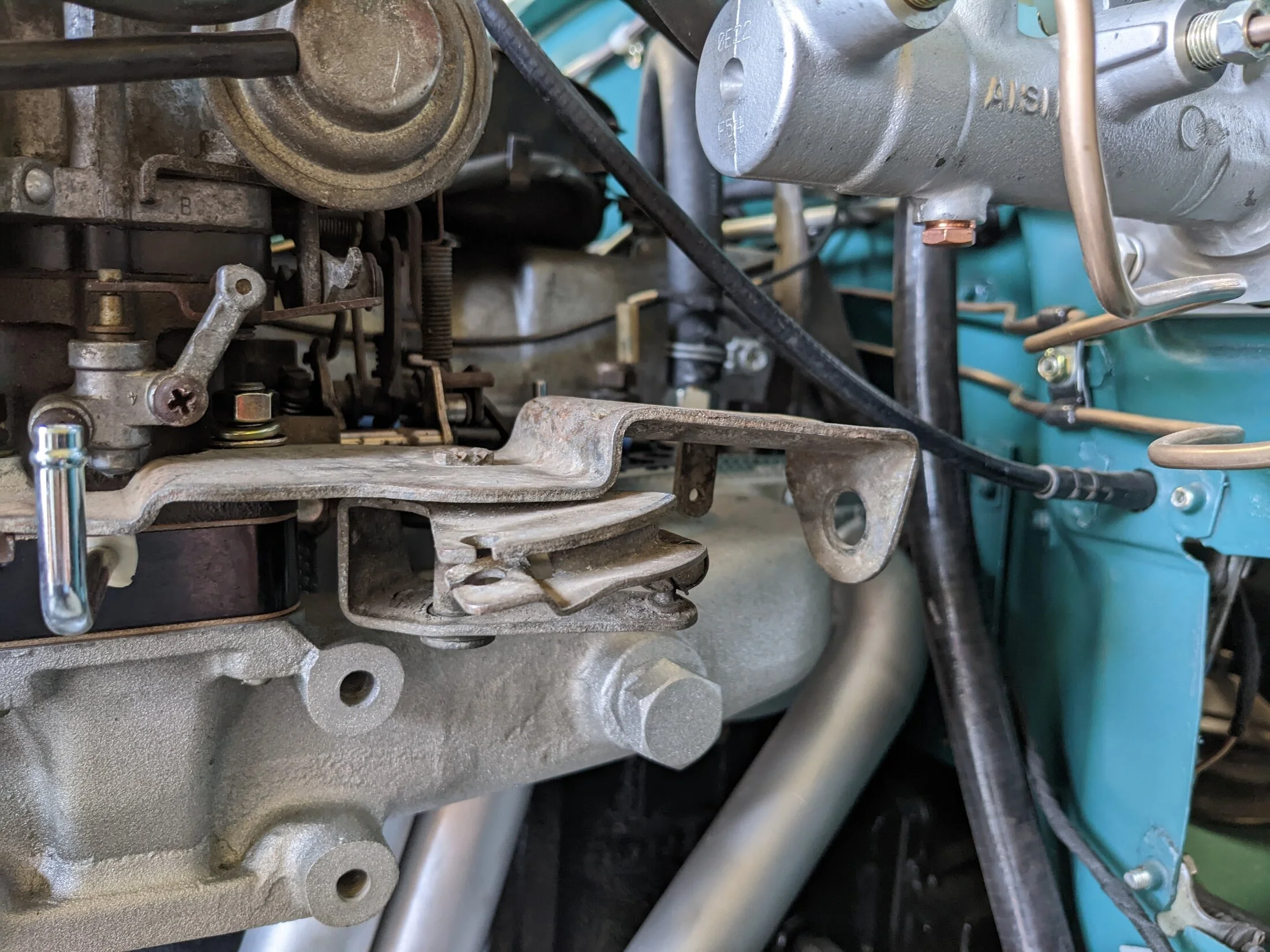

I dredge up some pictures and get some new one with good lighting. I agree seems like a bad, weak or missing return spring might be the issue I'll double check those at pedal and carb and perhaps add one at the bellcrank....
Here's a picture of the bellcrank in place (came a little bent) before restoration and one of it not installed and painted. It looks like there is a place a spring could go, I'll give that a try as well as some carb cleaner to try and free things up.
Well there you go added a couple springs and issue resolved!
Guess since I'm running the cable to linkage the linkage needs a way to be pulled back otherwise the mighty 2F just sucks the butterfly valves open. :p
Thanks for the reality check guys, check the simple stuff first. I'll figure out how to route the spring nicely since it appears to be a critical component and move on to the next challenges.
