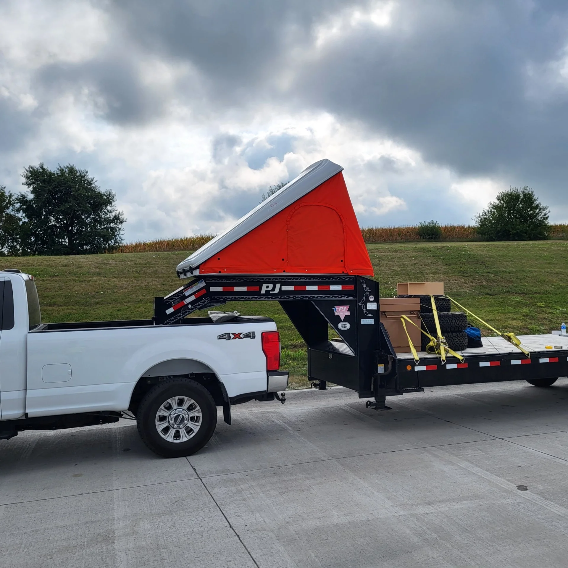

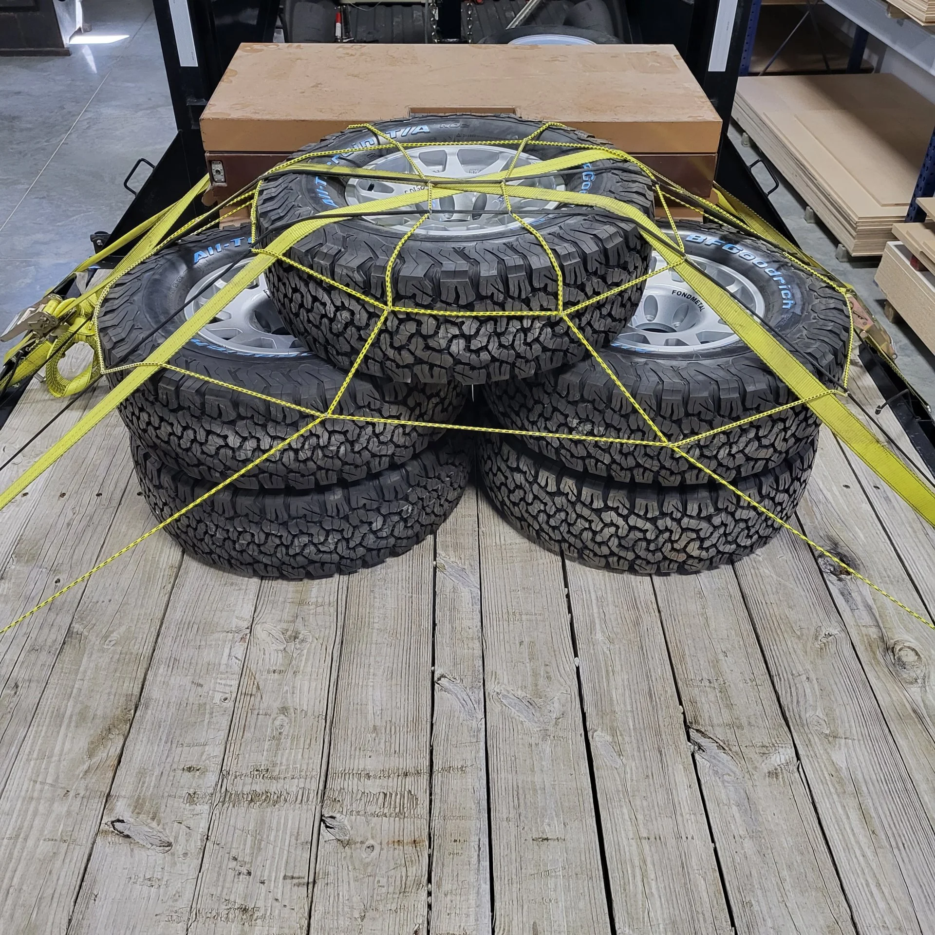

Anyone see fault in transporting the tires this way? They're strapped down hard, but I've been retarded before. I'm not impatiently waiting for the next time I do the dumb.
I could put them in the back of the pickup forward of the ball, but it'll be a massive pain in the dingus to get them in and out.
I added the bungee net. Mostly because I've owned it for a really long time, and have only used it a handful of times. I need to justify storing it for so long.

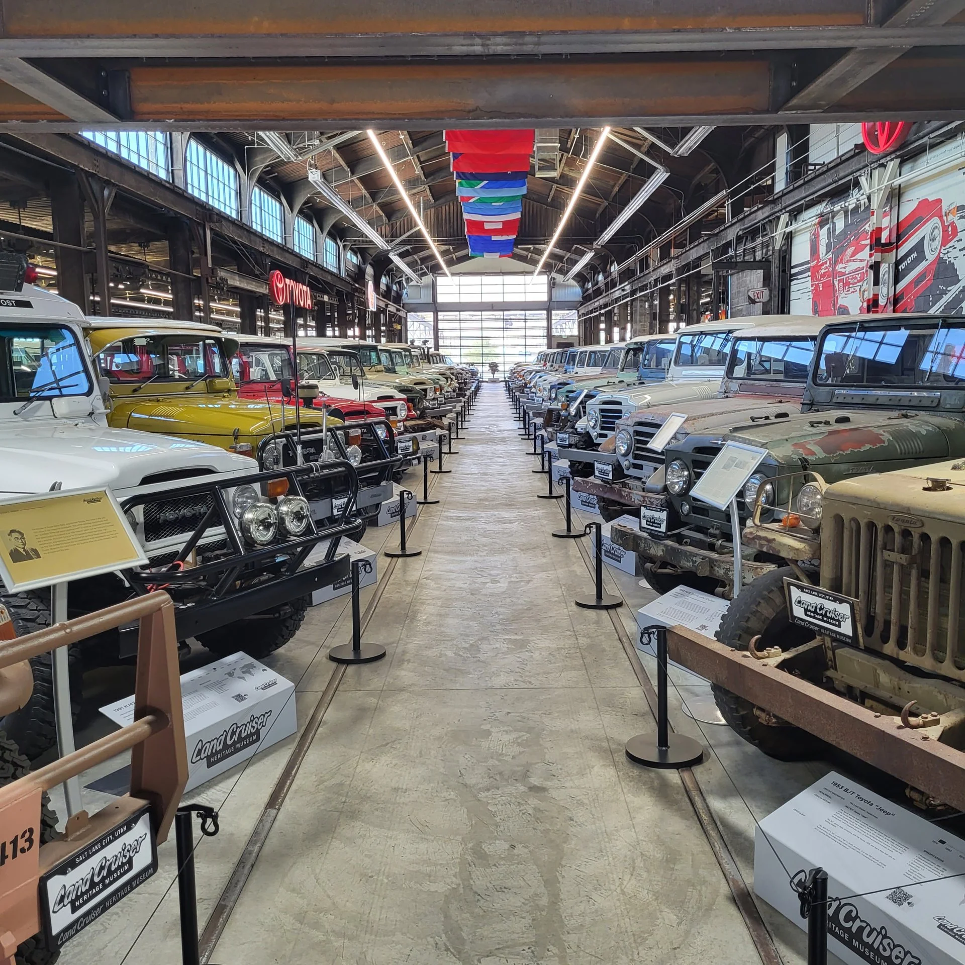

Hit the Land Cruiser Heritage Museum. Makes me want a 70 that much more.

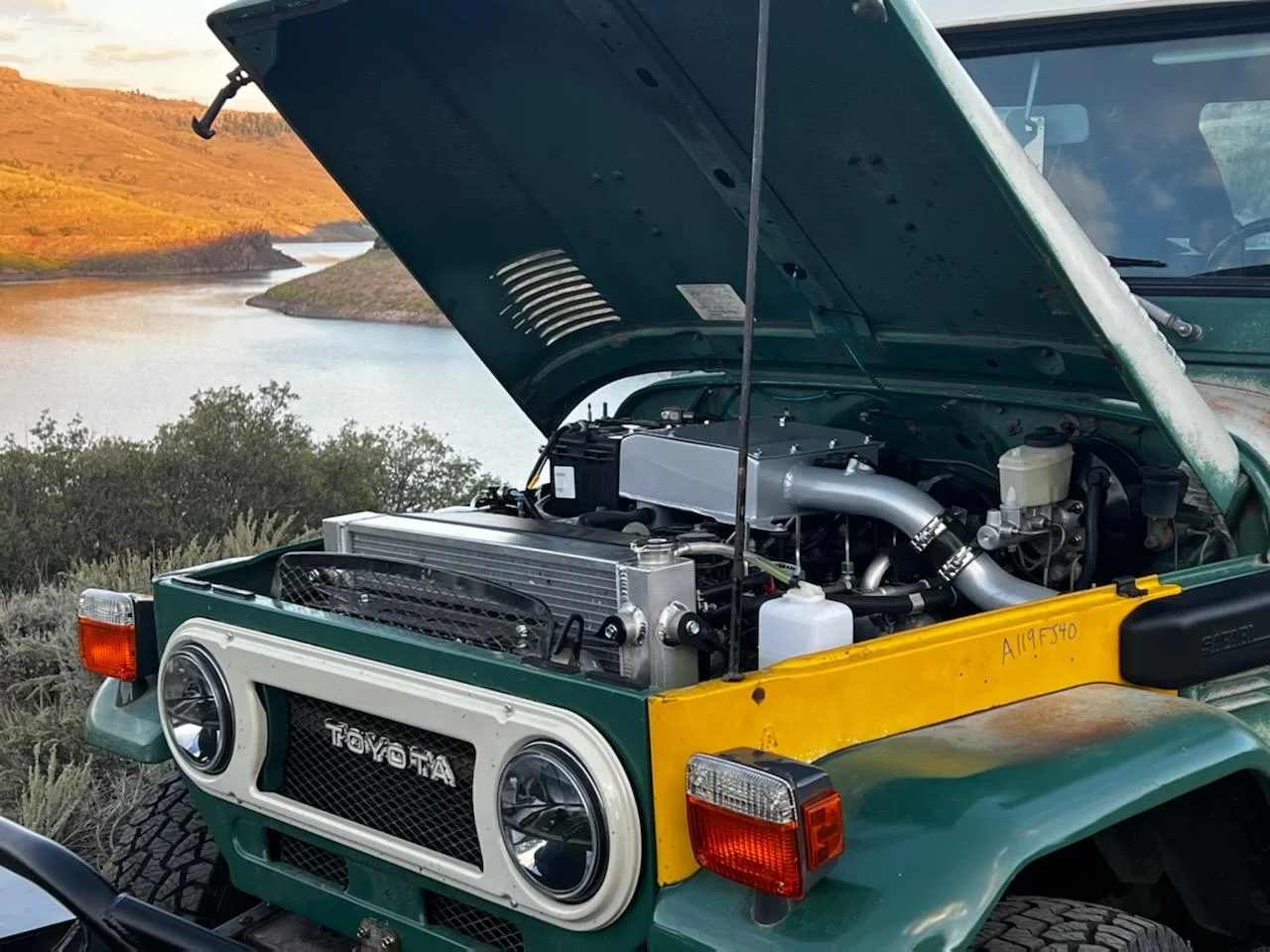

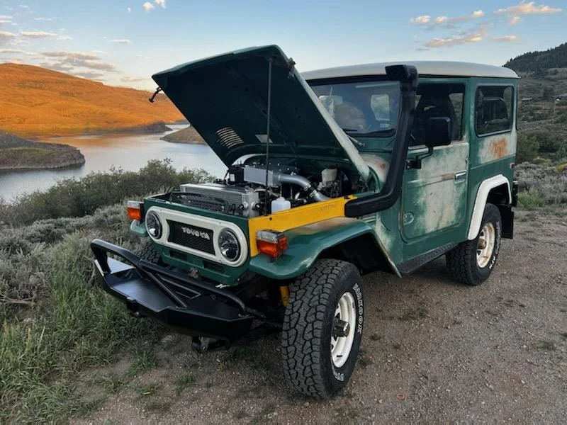

Initial impressions of the 2.8. Narrower powerband than I was expecting. If you don't drag out the previous gear long enough, and it falls off the turbo, yer screwed. I just need to learn how to drive the thing. On boost, plenty of go.
It vibrates at idle more than I anticipated. I've already started to ignore that, so it can't be that bad. LOL
Those are the only negatives I have to say, so not too bad.
-Highway speeds aren't an issue. My 2F was tired and struggled to hold 60mph.
-It ran super cool today. I think the highest temp I saw was 186º. It was 106° in SLC today, and I didn't leave town. So that's super impressive. I think PRLC has the cooling dialed in really well.
-Noise is really good. Loud enough it's there, but not too loud. It sounds like a mean Jetta TDI to me with the larger displacement.
-I only held it WFO a couple of times and not for long pulls or higher rpm. Once it spools, it's got great go.
Great upgrade. I'm curious what I get for mileage, but I won't have a good indicator of that until the engine is broken in, and I get home.
My trailer is just a web of straps and crap being held down.

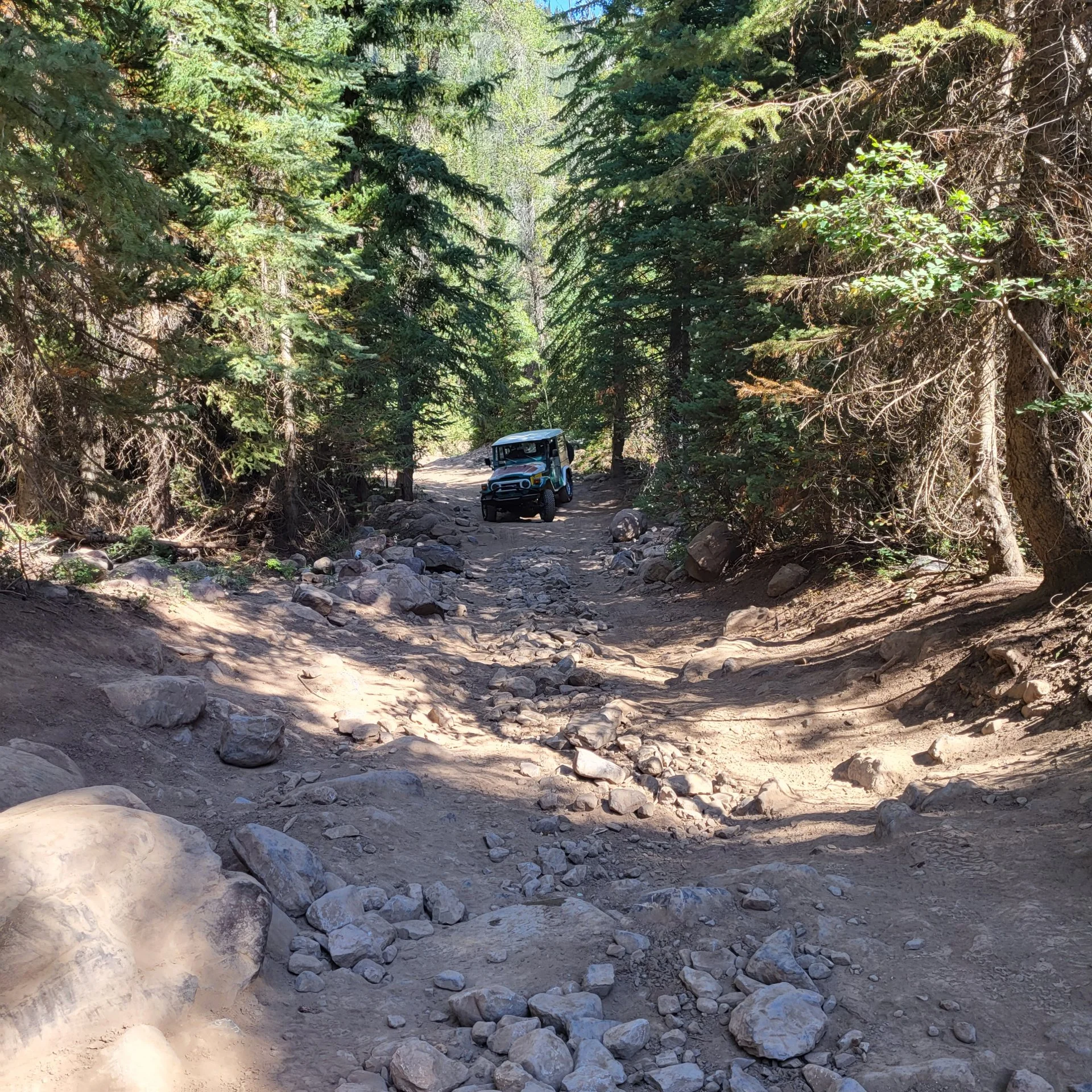

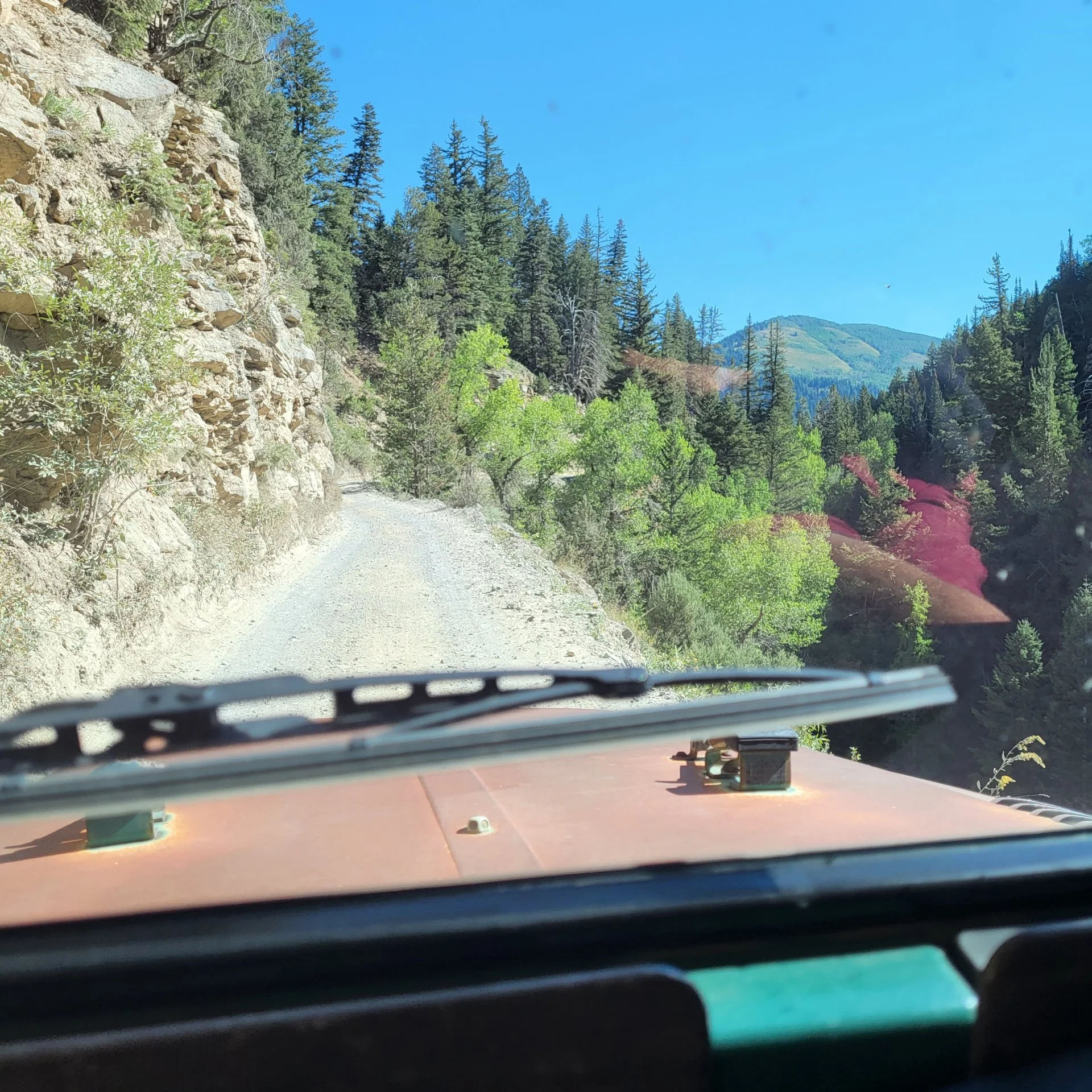

Thursday was fun. Had a small power steering leak which cut things a little short, then it magically stopped. Which is way worse, it'll be that much harder to figure out the leak now.
Got scared on one trail and turned around. I don't have the crawling skills to not bash the crap out of my cruiser. I want challenge, not repairs. Also one vehicle, so I didn't have much of a safety net. Better safe than sorry.
After finding out we were leaking, went back down the mountain, got some power steering fluid, topped it off, and it wasn't leaking any more. Decided to drive up to an overlook west of SLC where you can look down into the world's largest copper mine. Freaking crazy. I thought my ex girlfriend had a big hole, turns out she's second place.

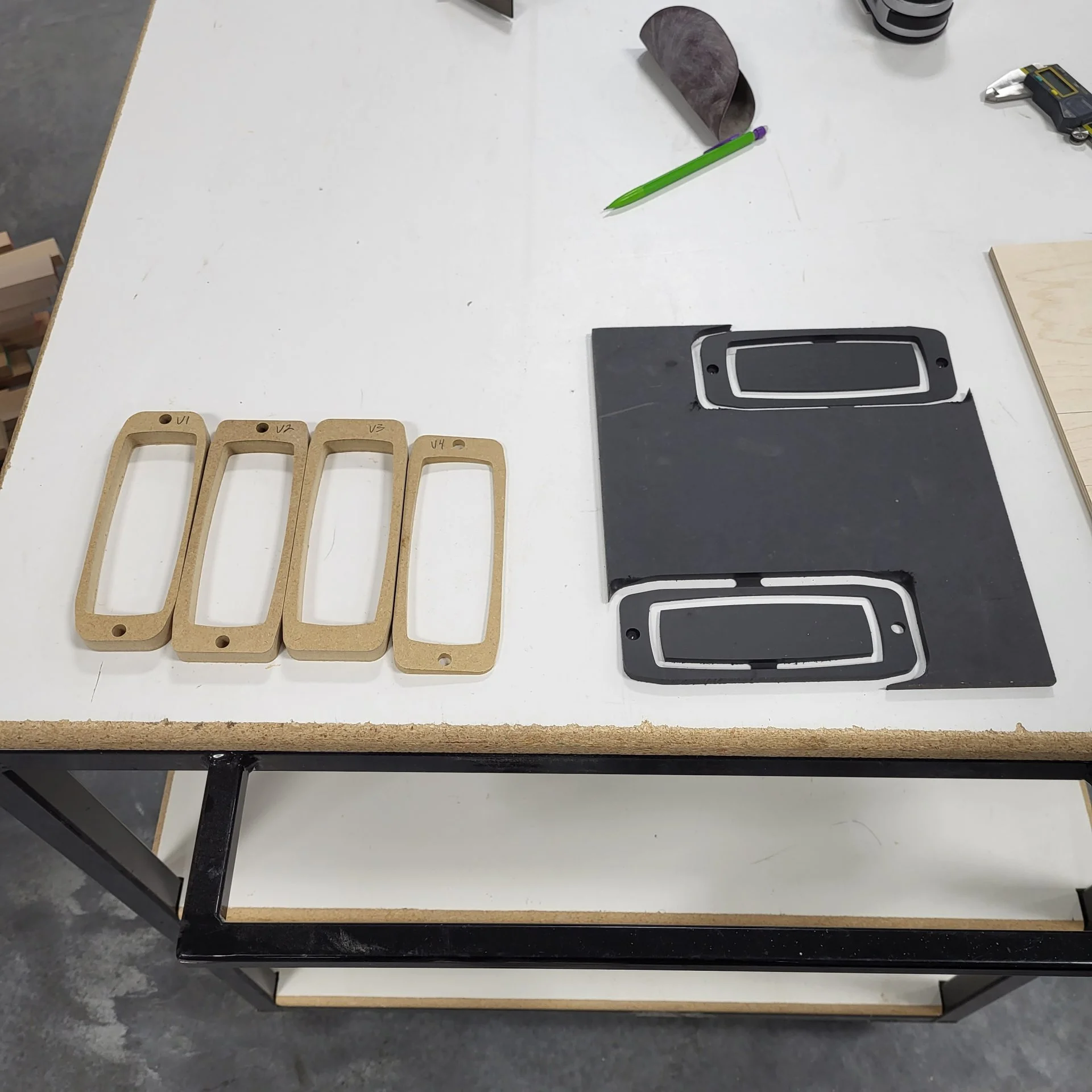

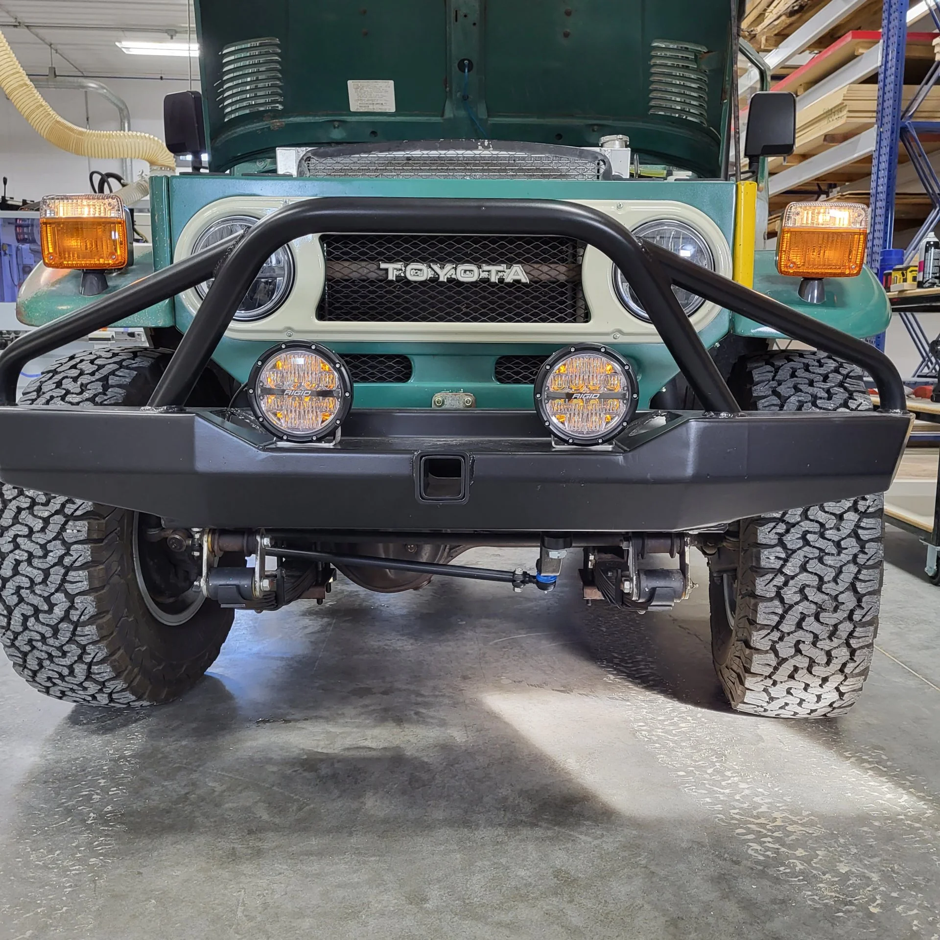

Got the Rigid 6" lights mounted on the front bumper.

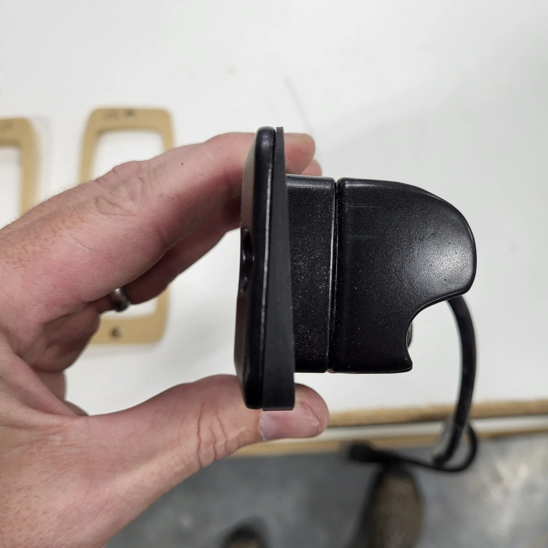

Made a template on the cnc to drill the six holes for the lights. Rigid has 3 mounting holes in the mounting bracket, but they only supply 1 bolt each. That seems stupid. Plus they're odd ball carriage bolts.
They need some adjustment, and proper wiring. They are stupid bright.

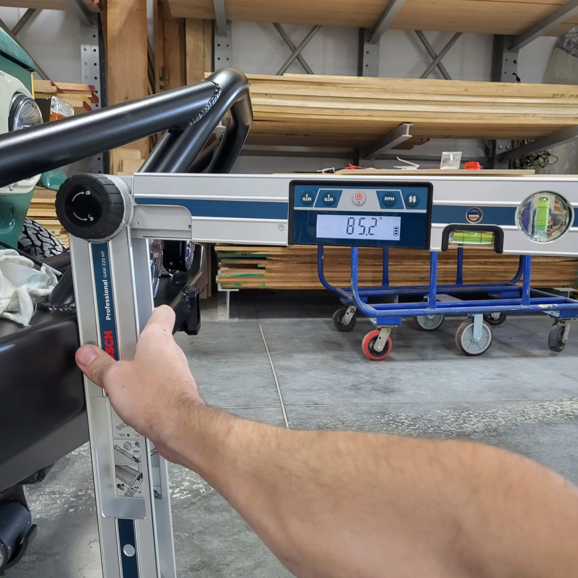

The front bumper face is raked back 4.8º.
According to the internet, driving lights should be aimed down 1½ inches at 25', (or 300")
With a little trigonometry, we can know that in degrees. ATAN(1.5/300)=.286º
So I need a shim. One that is basically 5.1º
After four test cuts to get the shape right, I cut a final.
Turned out tits.
I need to whack a couple of holes yet, and I'll be able to get these mounted. I'm hoping the next deer bursts into flames before I actually hit it. 😆
CRAP!
I just realized, I added the two angles, I needed to subtract. 😡
That's alright, I'm not in love with the material I cut these from. I think plastic will be better. I'll get some black UHMW. I need to order some up anyways to make some bushings for my swing out pins.

Flip the spacer over?
It needed to be 4.8º minus the .29º. I added it.
We'll see what happens when I get them mounted. Chances are it'll be too high though.
Easy enough to cut another one
