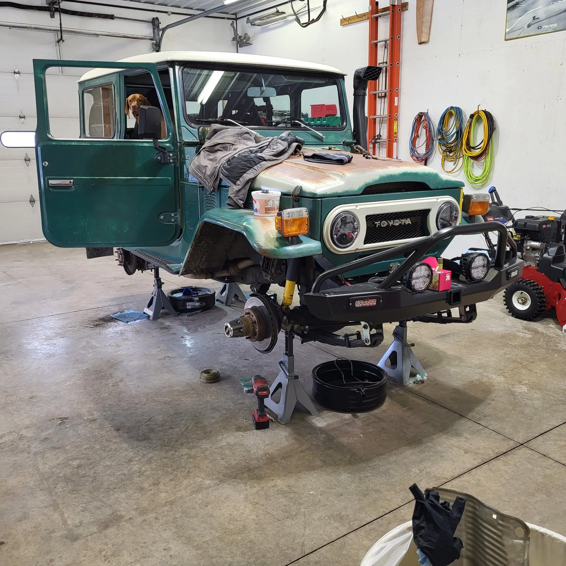

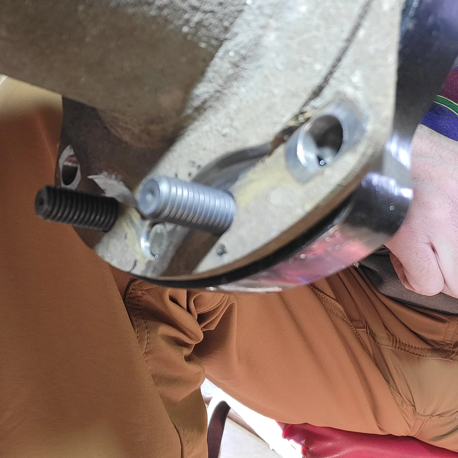

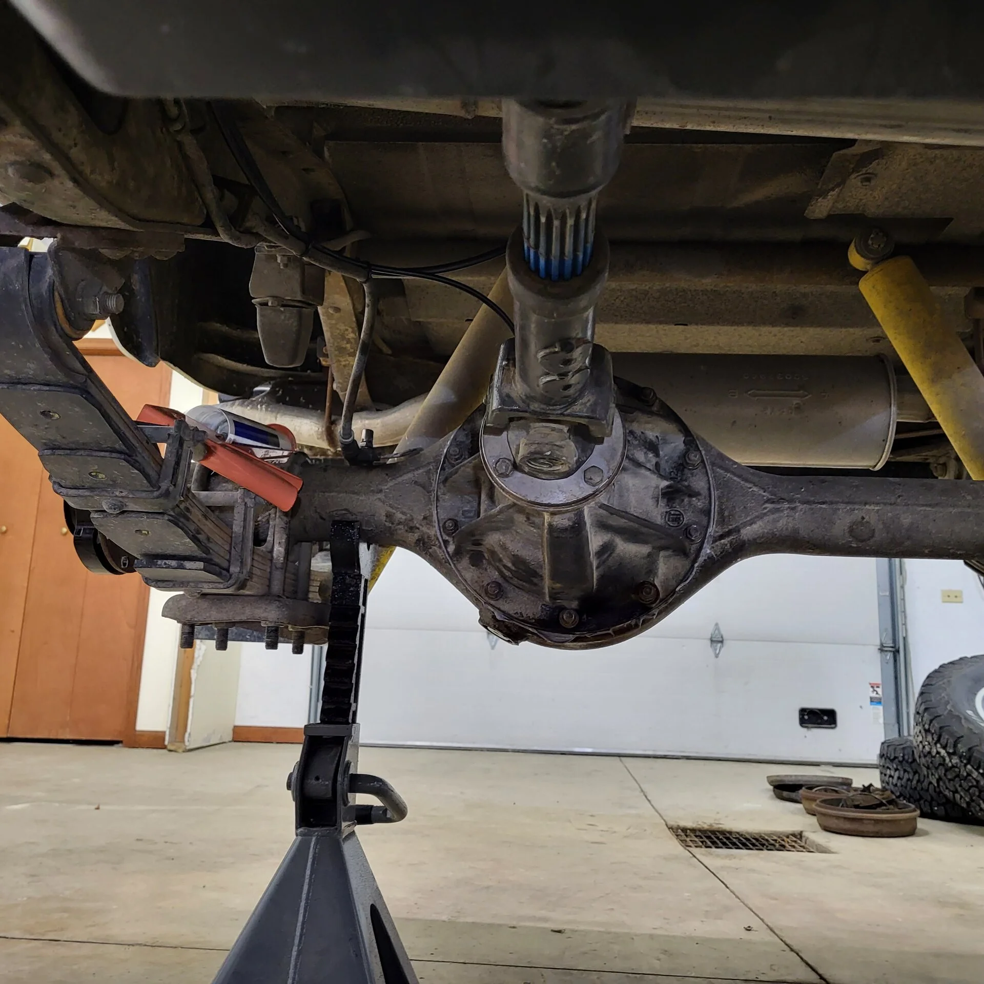

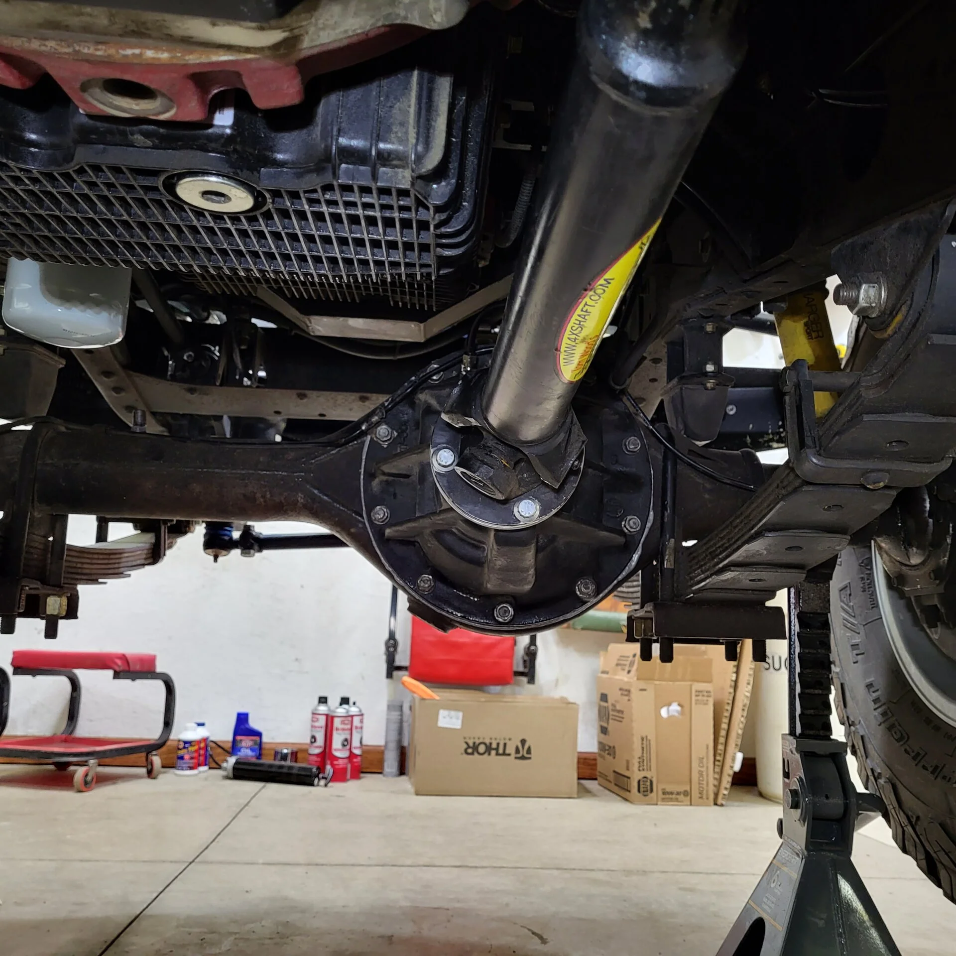

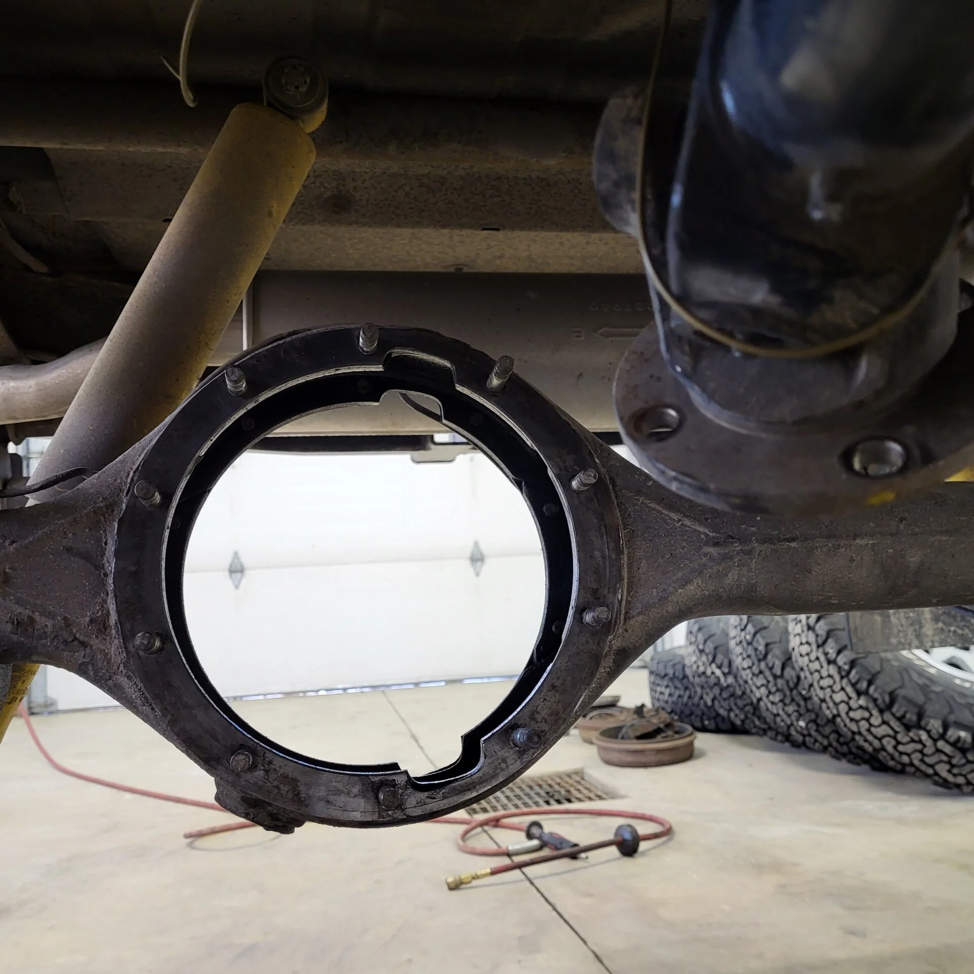

Yesterday, got everything ripped apart, and got the diff installed in the third member.

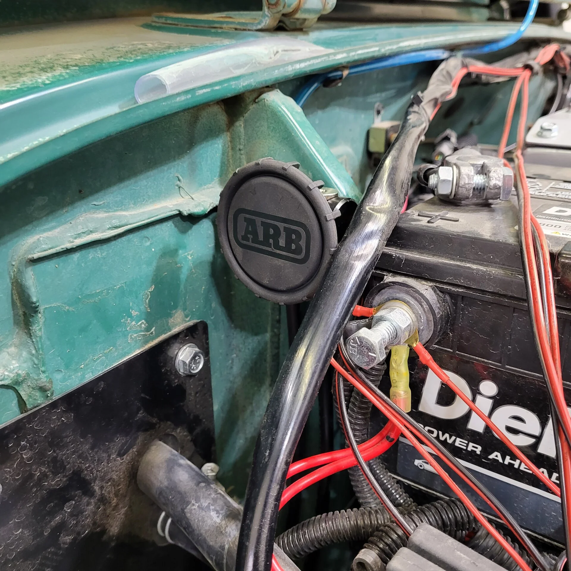

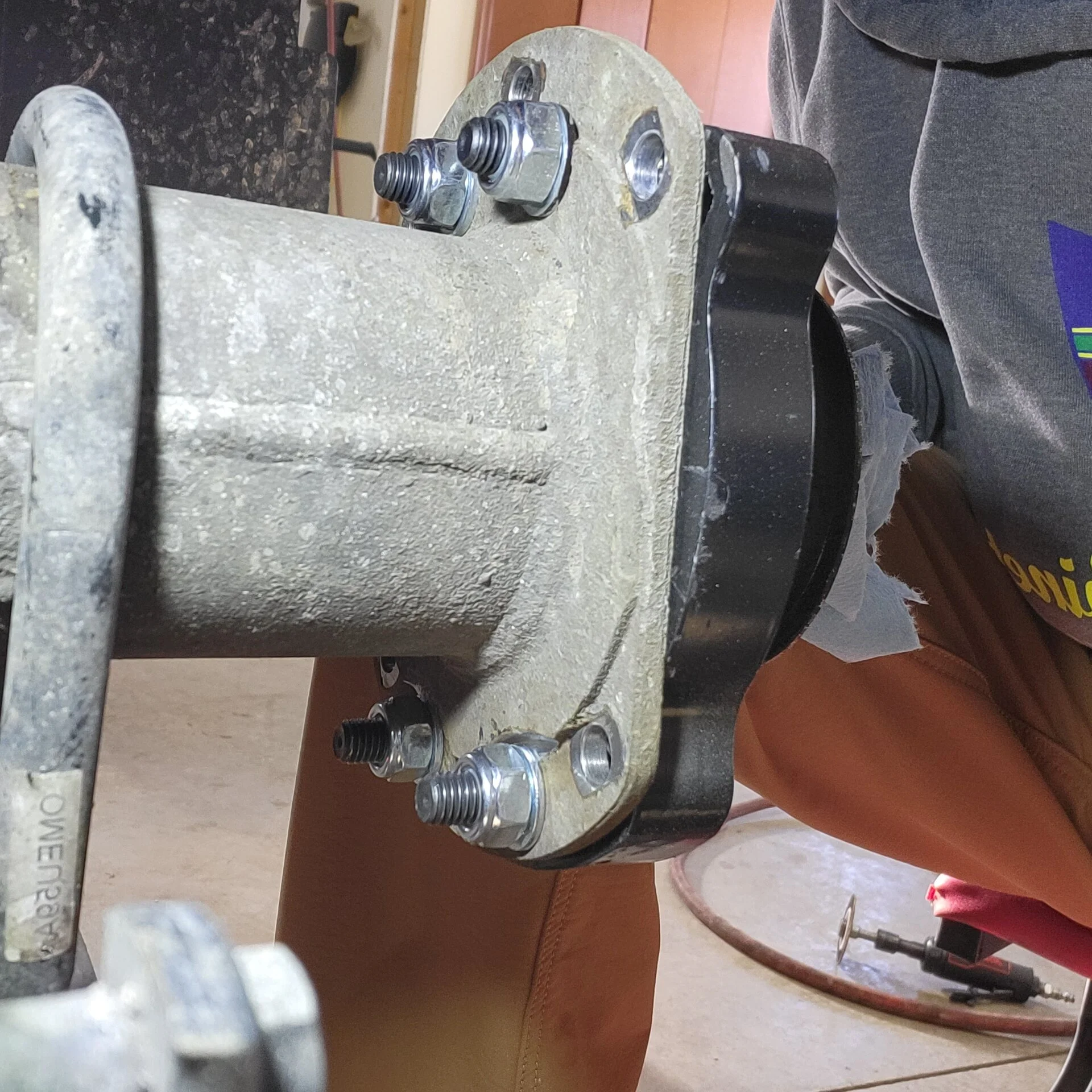

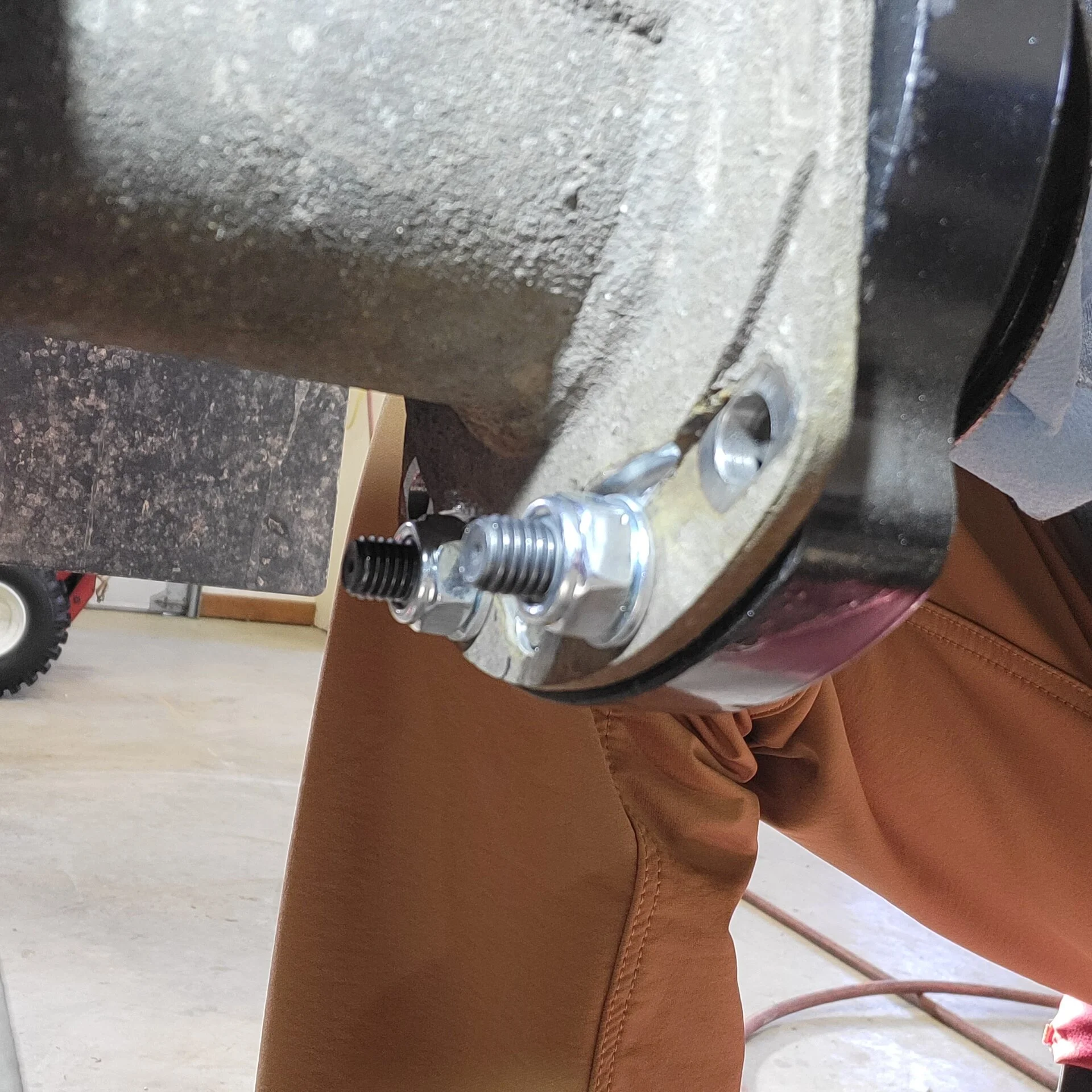

Putting in an ARB breather kit for the axles. I'm told it's not when the lockers will leak, but when. If the breather is clogged, it'll push all the fluid out of the pinion seal.
Good to know.I've seen oil come out of the air lines a lot as well. Mine do it sometimes. Just be aware if the solenoids puke oil or the breather does. Pretty common thing as I have seen.

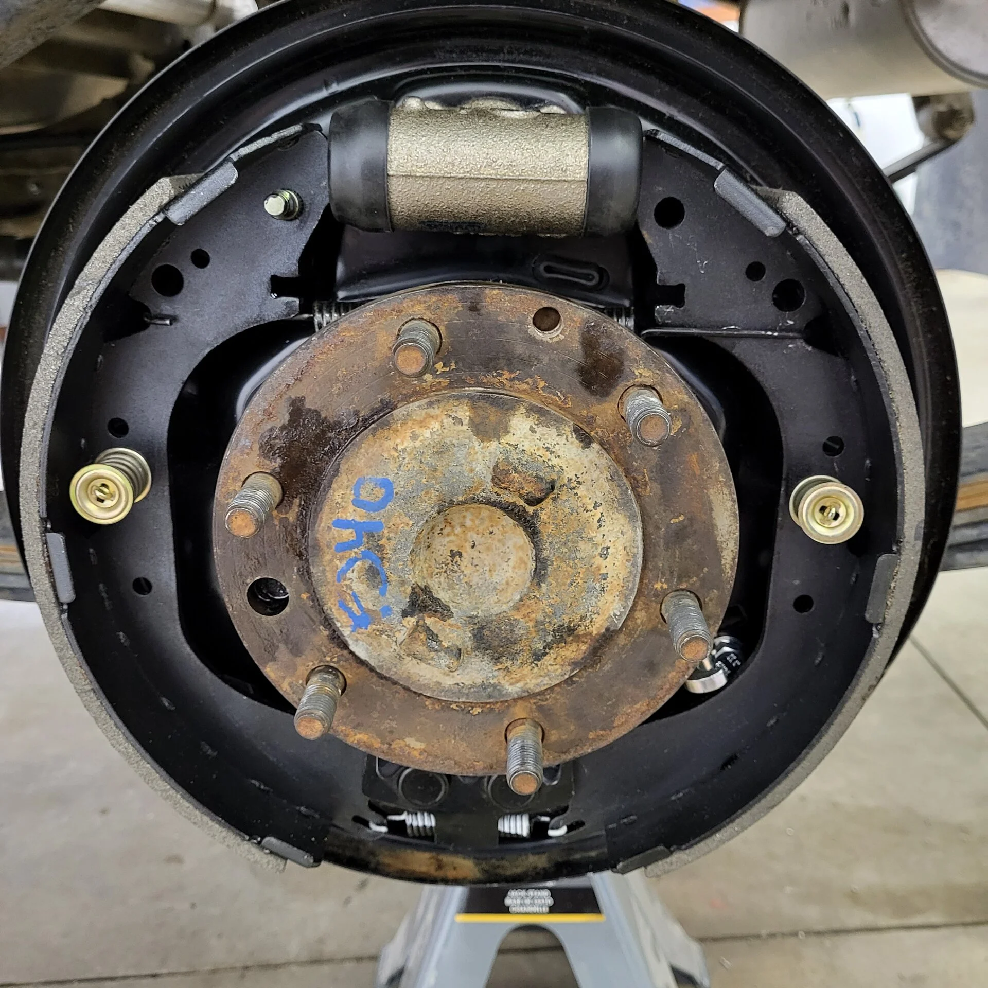

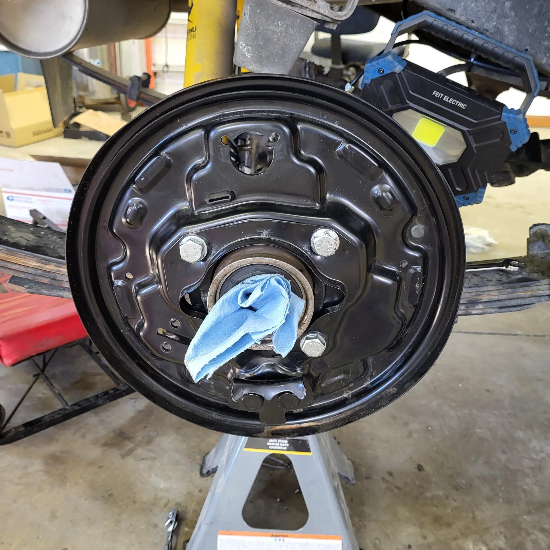

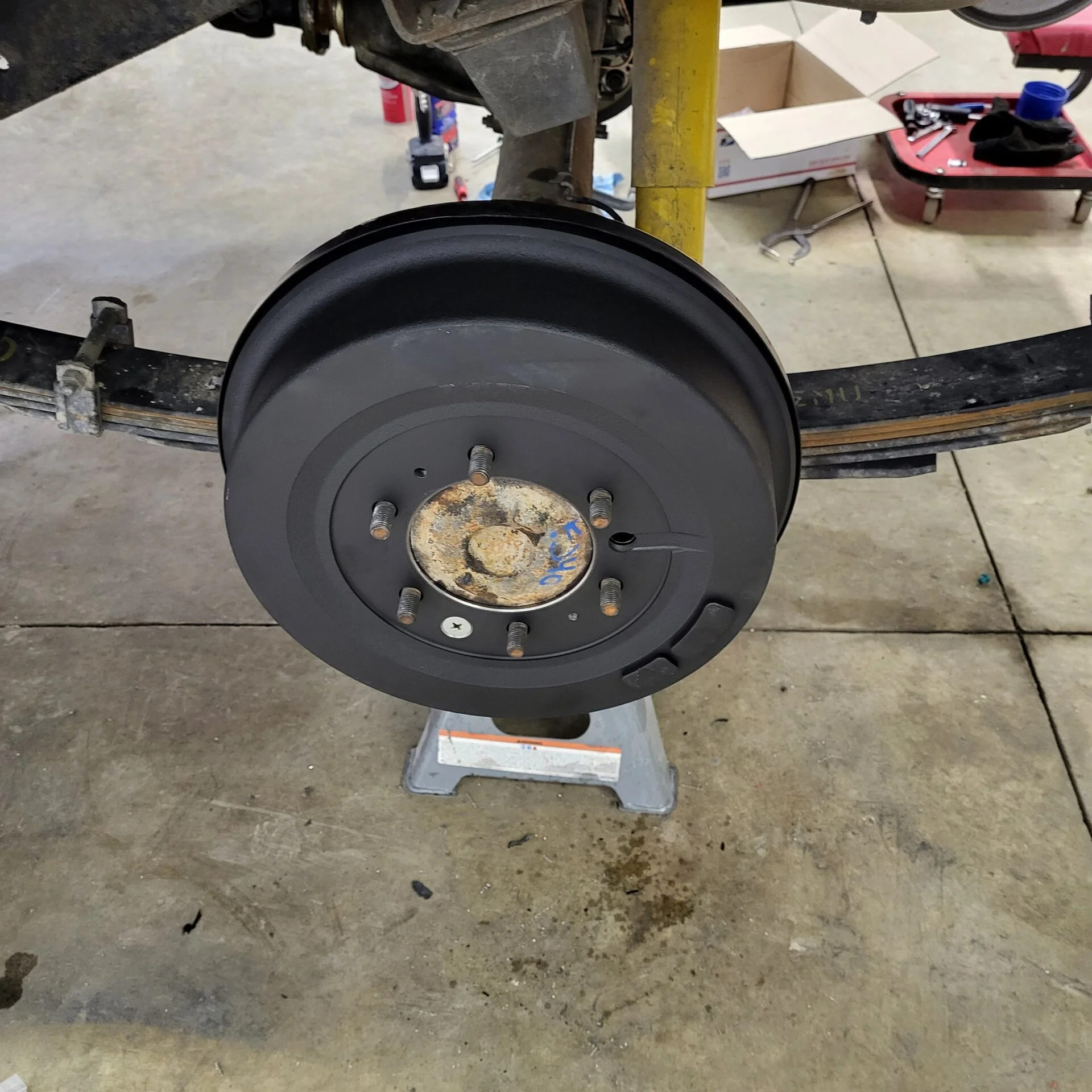

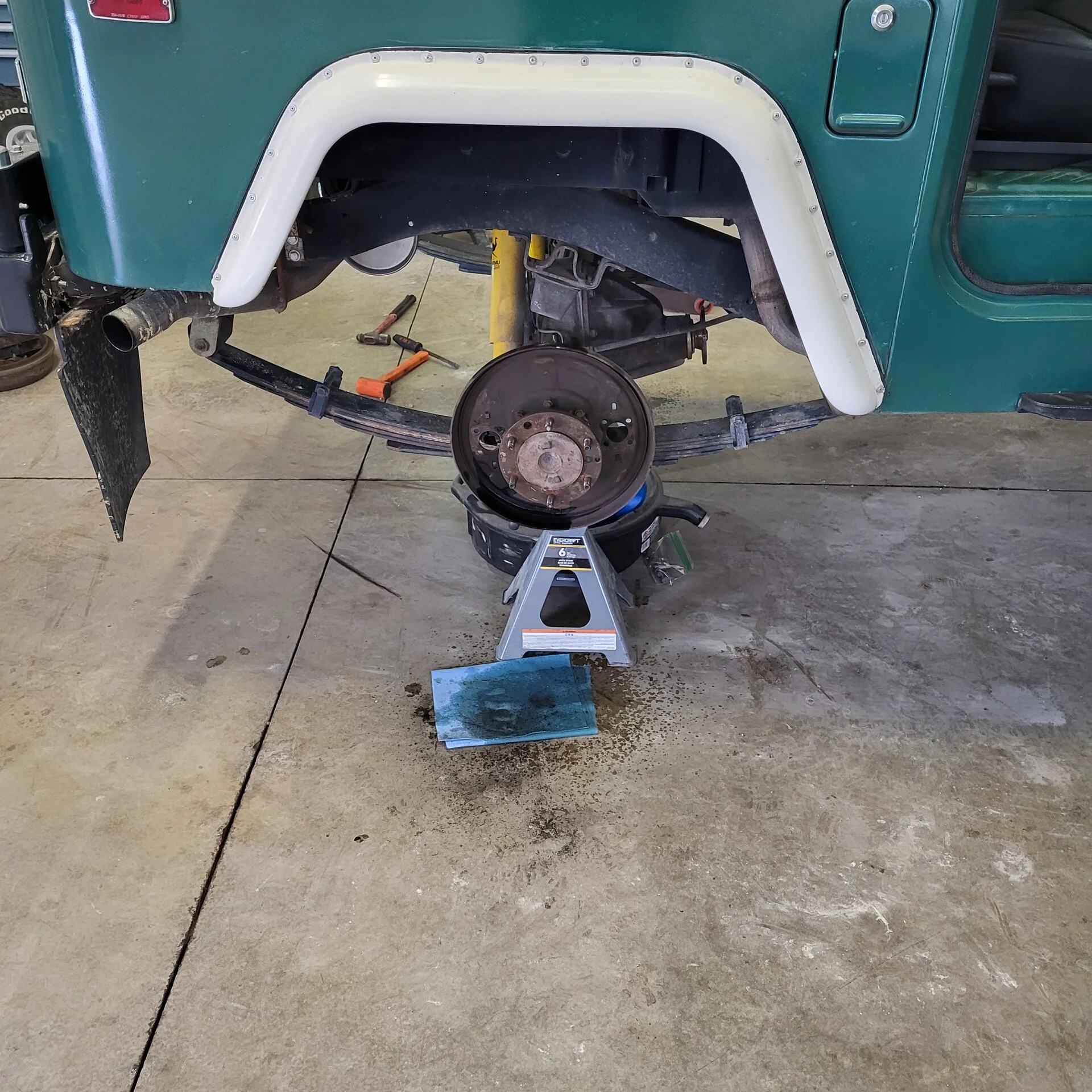

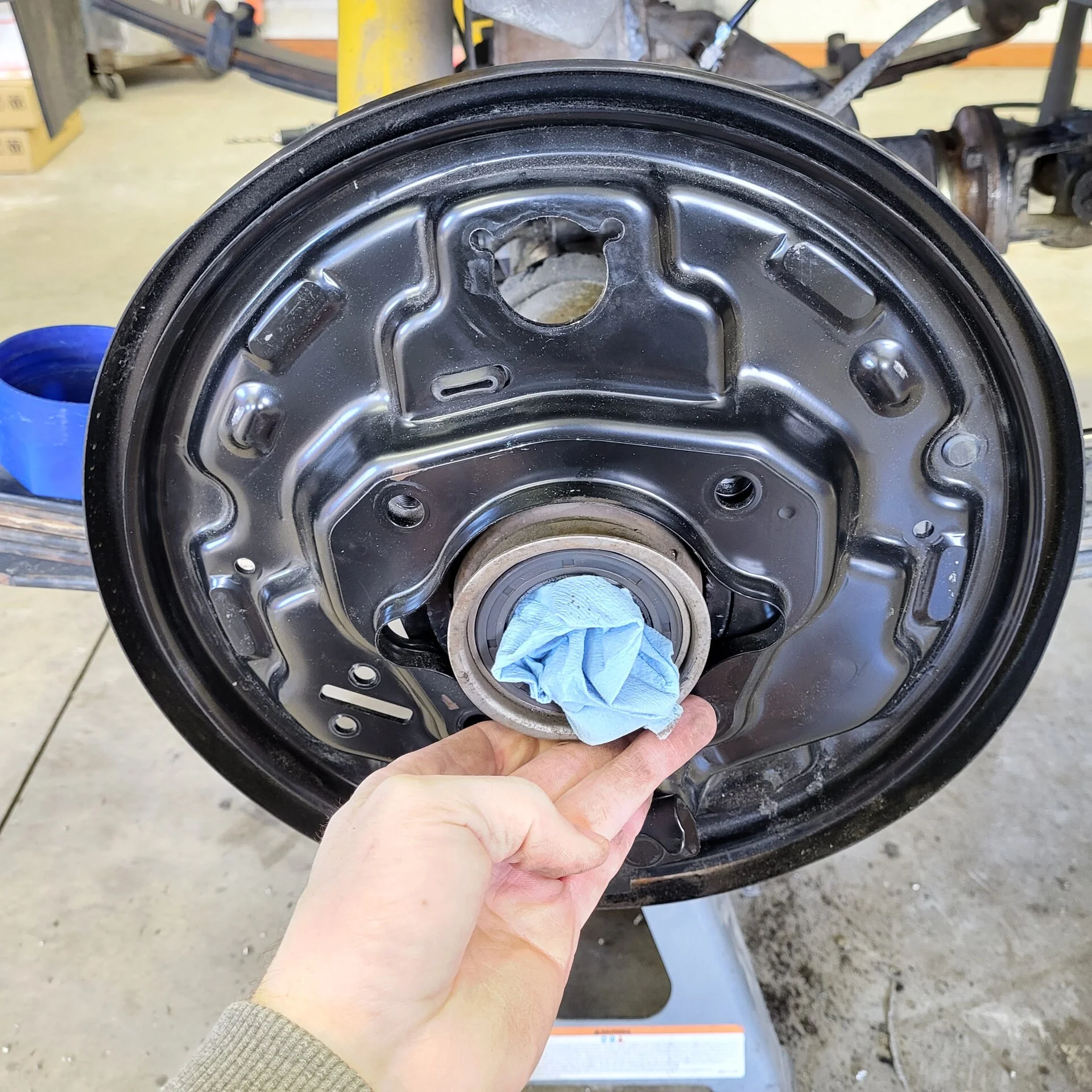

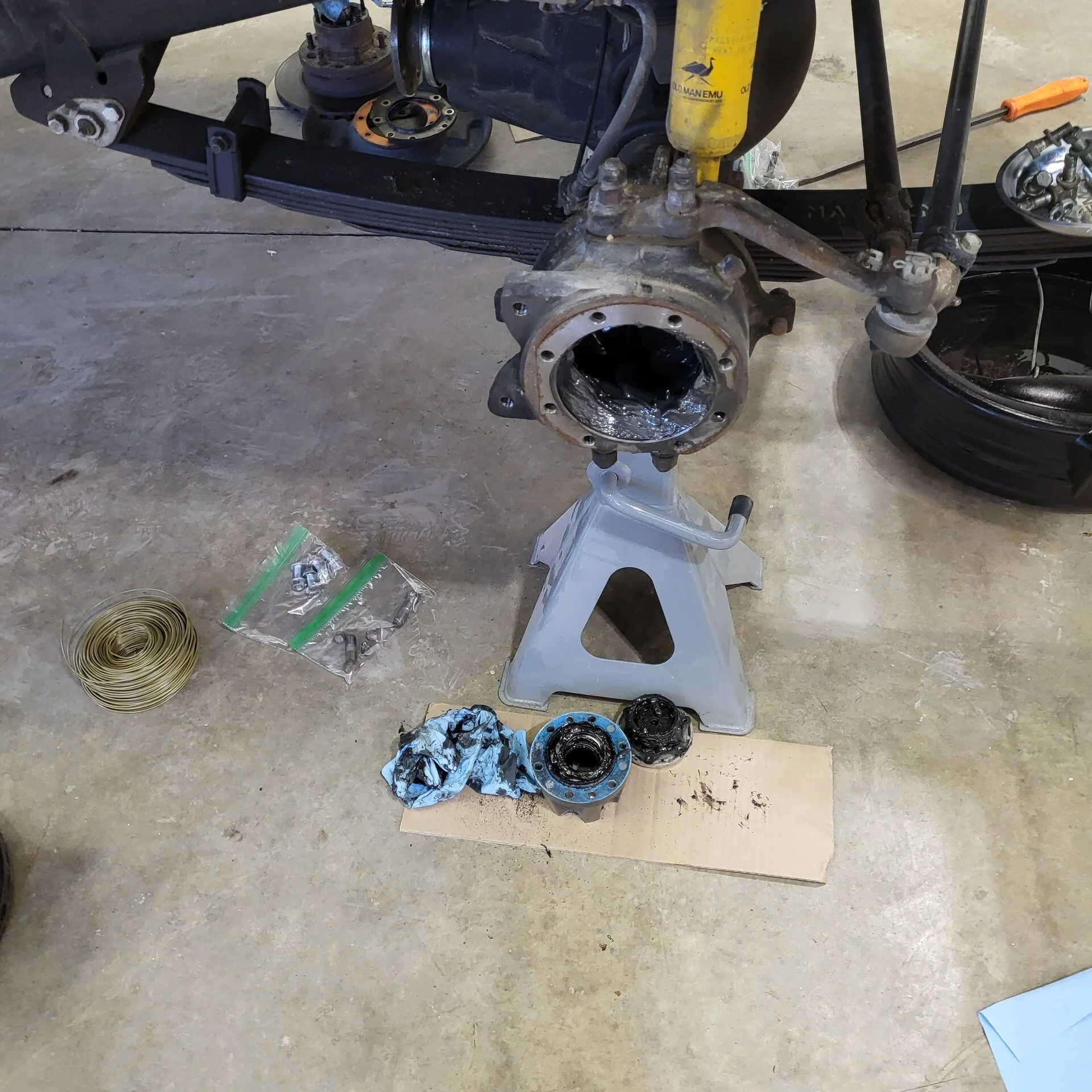

What’s the brand name of the tool?Wheel cylinders mounted. Shoes sorta on. I'm missing the automatic adjusting levers, that parking brake levers, and it looks like the pulleys yet. Grrr....

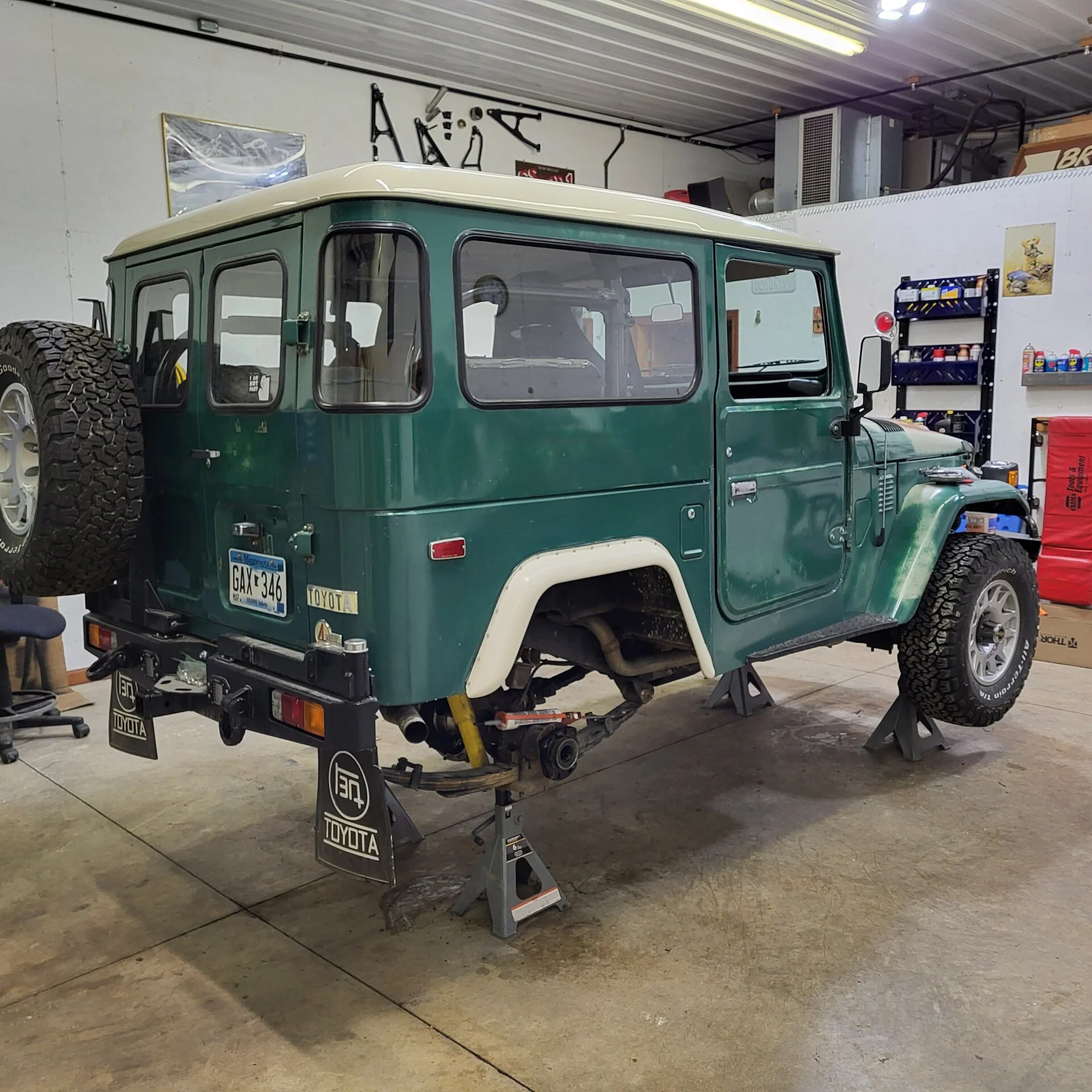

I can at least put it back on it's wheels like this.
I had to bend up a new line for the passenger's side. I doesn't look horrible, but it ain't good.
I was able to make the driver's side work with what was there. Also, very ugly.
When the body comes off, I'll redo both and blow through a few hundred feet of tube getting it nice....

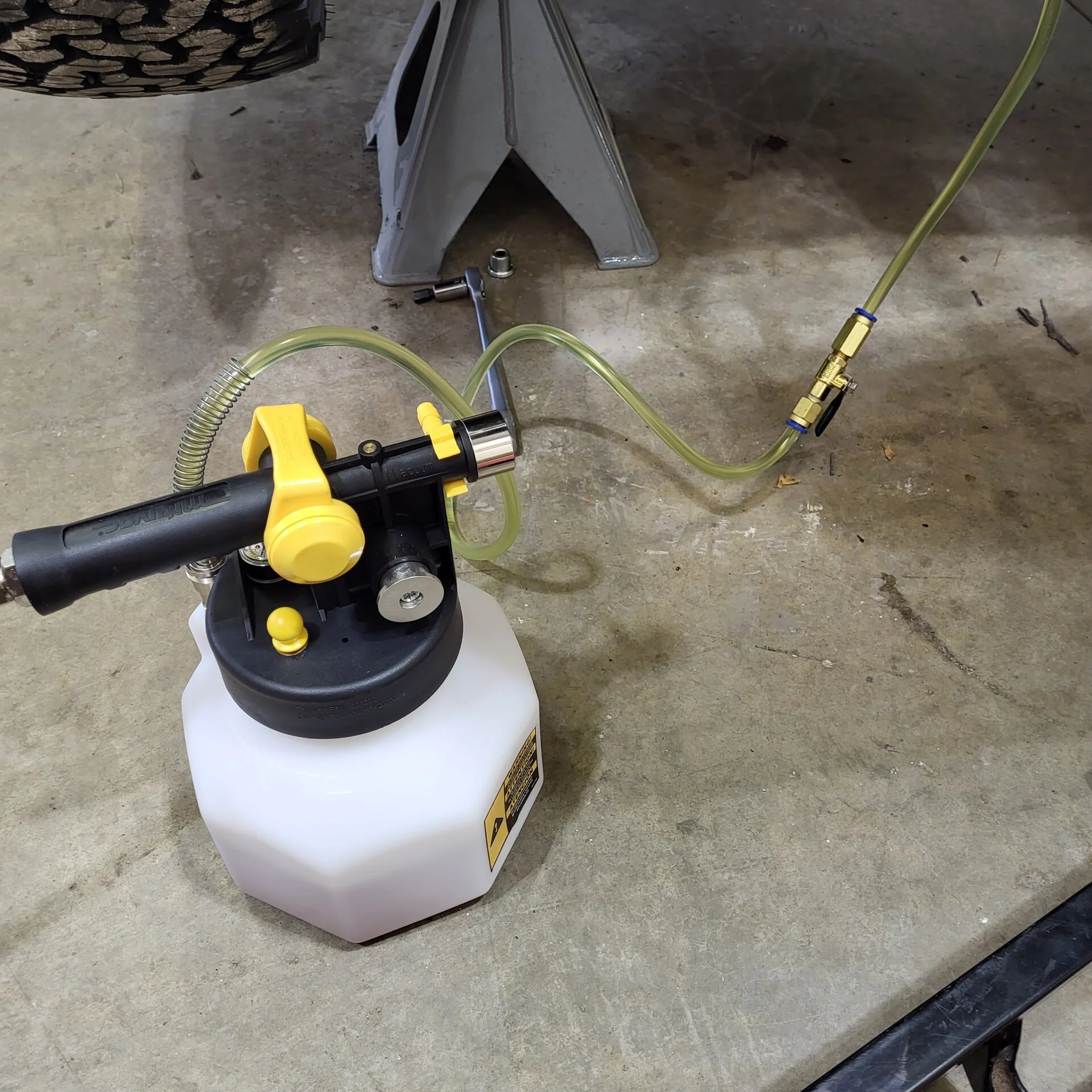

This thing is the tits. Still takes a while to fill a differential, but you aren't spending it giving yourself a hemorrhoid squeezing a bottle with a piece of tubing poorly wedged on the end.
I spilled one drop on the floor.

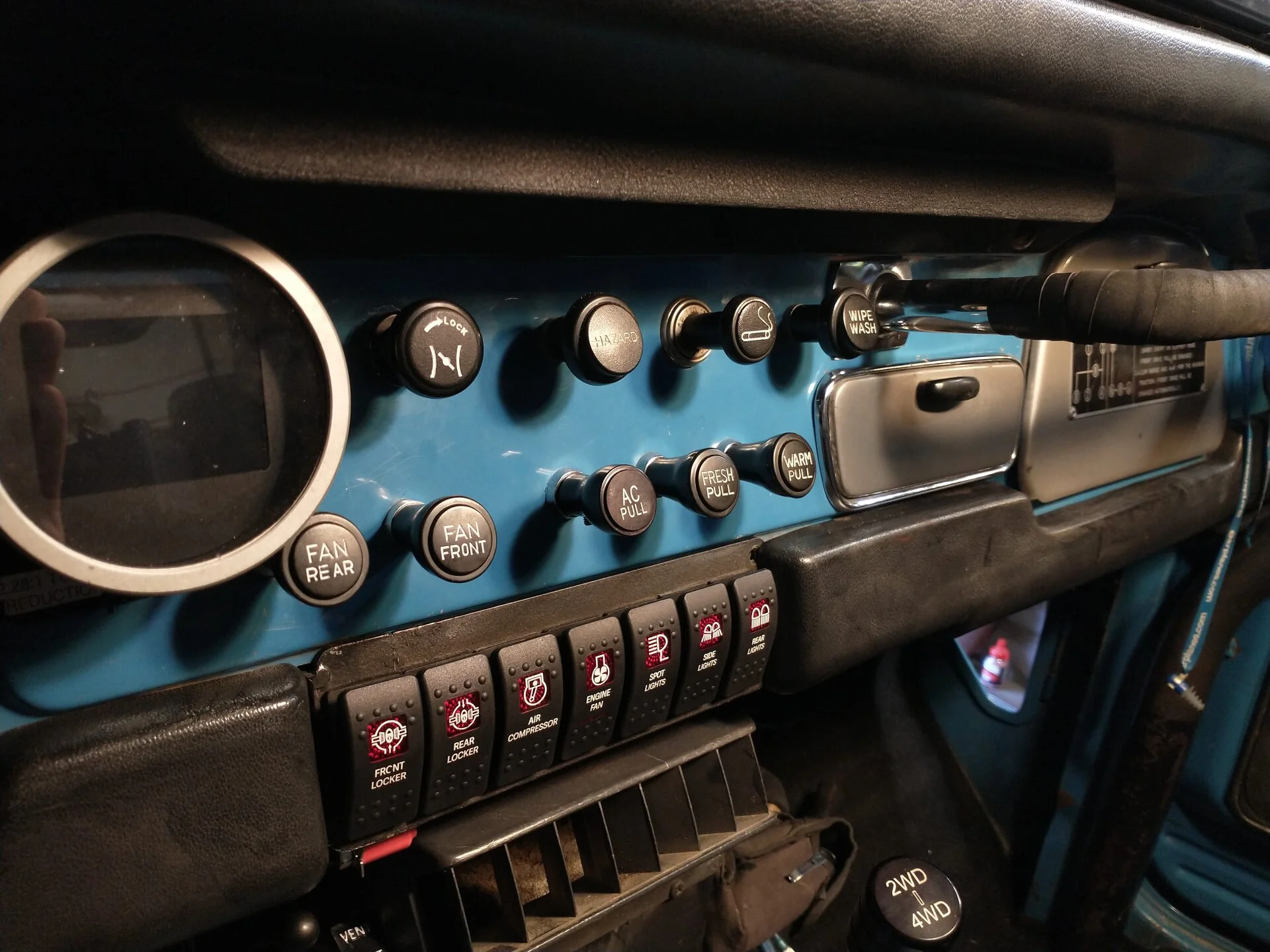

In my 78 there was plenty of slack to move the wiper switch all the way to the top right corner. Maybe you can move the wiper switch and then either move the front one there, or the rear one there?In the hole that was apparently created by an angry beaver.
Face plate in place.View attachment 3153295
I also got all of the aluminum knobs from Redline Landcruisers put on. I want to flip the rear locker switch with the hazard switch, but it'll require hacking up the harness to make that happen, and I'm not interested in doing that.
And powered up. I ran the USB inputs to the glove box. Seemed like an easy solution. I'd like to find something similar to the USB port I have already, but be able to plug into head unit that way. I'm struggling with the correct search term to find one though.
