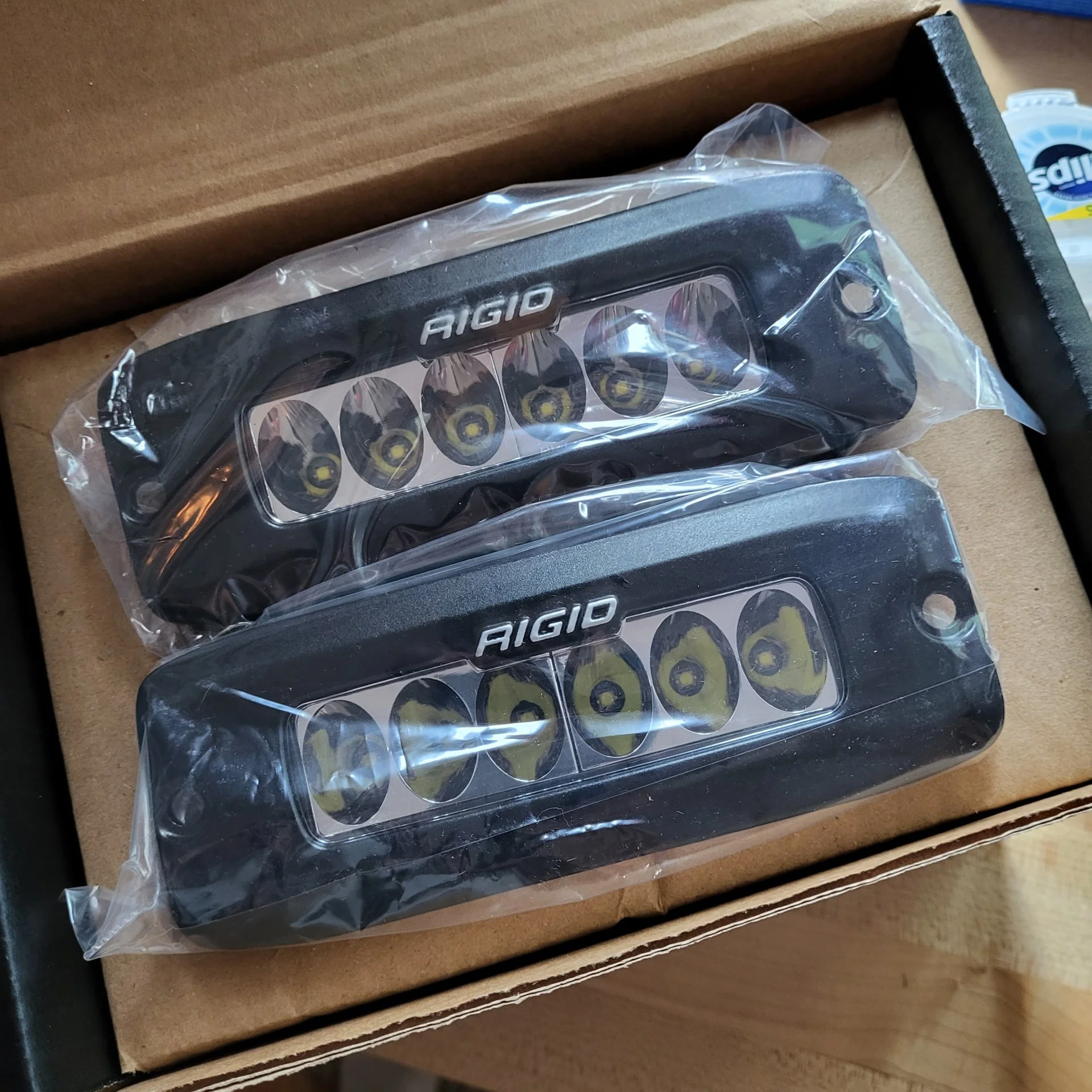

These two will get mounted in the wings. 4752 lumens. I don't know if that's for the pair, or individually.
I'm putting two 6" round Rigid lights in the middle. Those are 8670 lumens. I also don't know if that is for the pair or not.
Should be daylight in front of me at night if I have the road to myself.

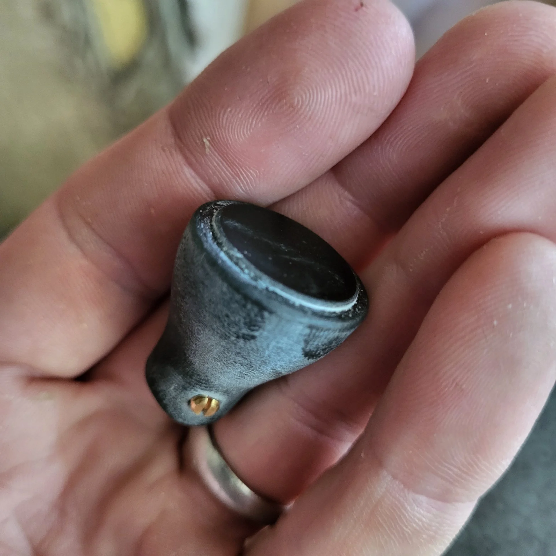

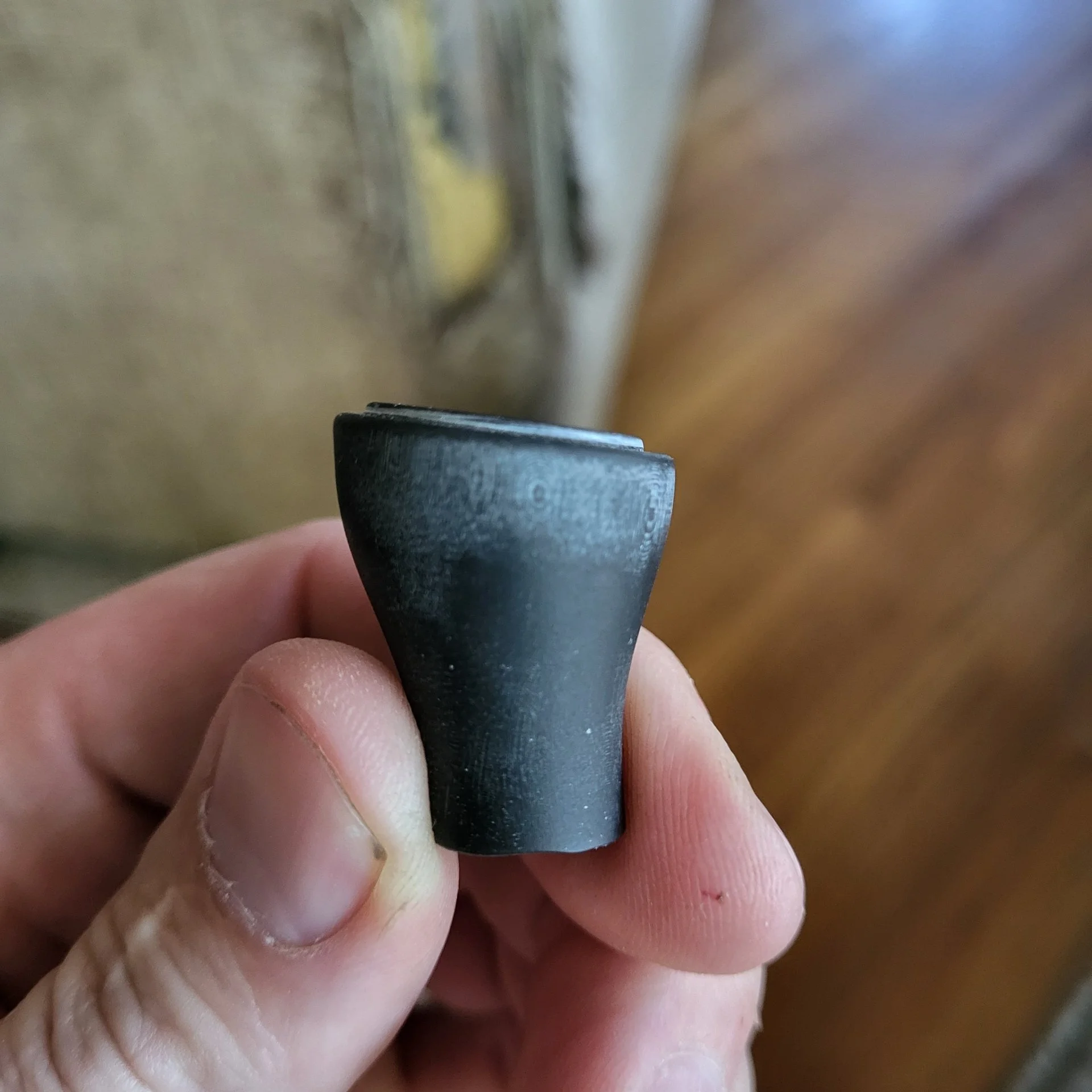

I ordered some pull switches from Jegs or summit. Not bad switches, but they don't feel right. You know what feels just like a Toyota switch? Oddly enough, a Toyota switch.... 😁 I ordered a couple of 84162-60010 fog light pull switches from Cruiser Cult. I accidentally received a pair of blank knobs.
I'm going to call this a happy accident. I had a friend print a set of these for me, but these will require a bit less work to get to final, and I'm lazy. I contacted Cruiser Cult, they're getting the proper switches to me, I still need to order a set of these knobs so I can square up on that. He said don't worry about it, but that's not how I operate.

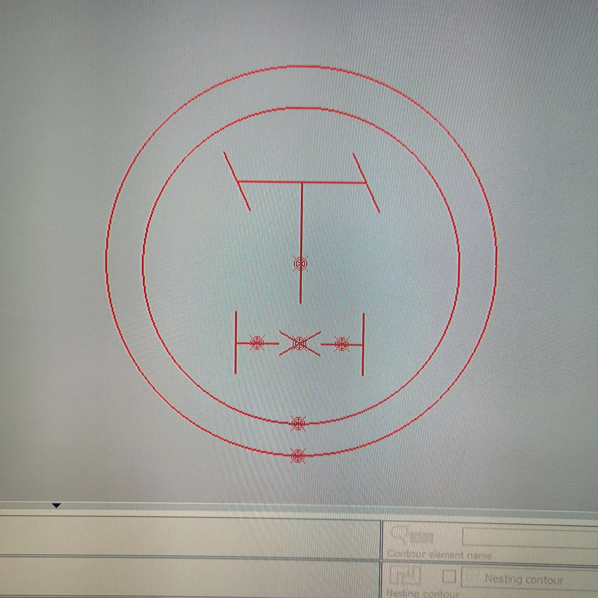

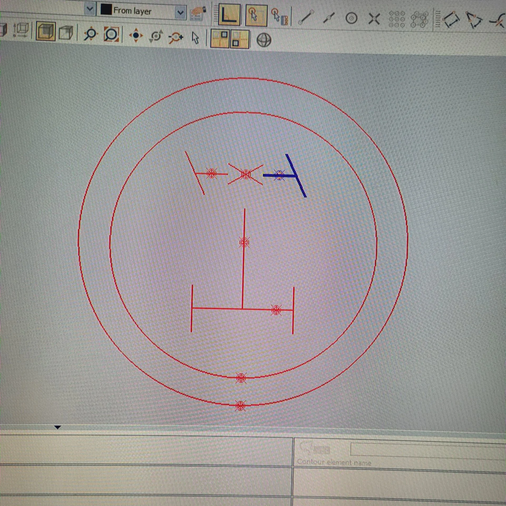

The end goal is to use the switches to engage both lockers. I spent an hour or so yesterday after work coming up with a design/program to engrave in the end. I also ordered some .0625" tapered ball nose tools to do the engraving. I'll have to come up with some sort of fixture to hold the knob in Das German CNC. I've got some ideas, but the simpler the better.
The outside circles are just for me and a visual reference, there's no tooling associated with those lines. I don't think these are the final that I came up with either. I'm thinking I want to be a 1/16" into the knob to make painting as easy as possible.

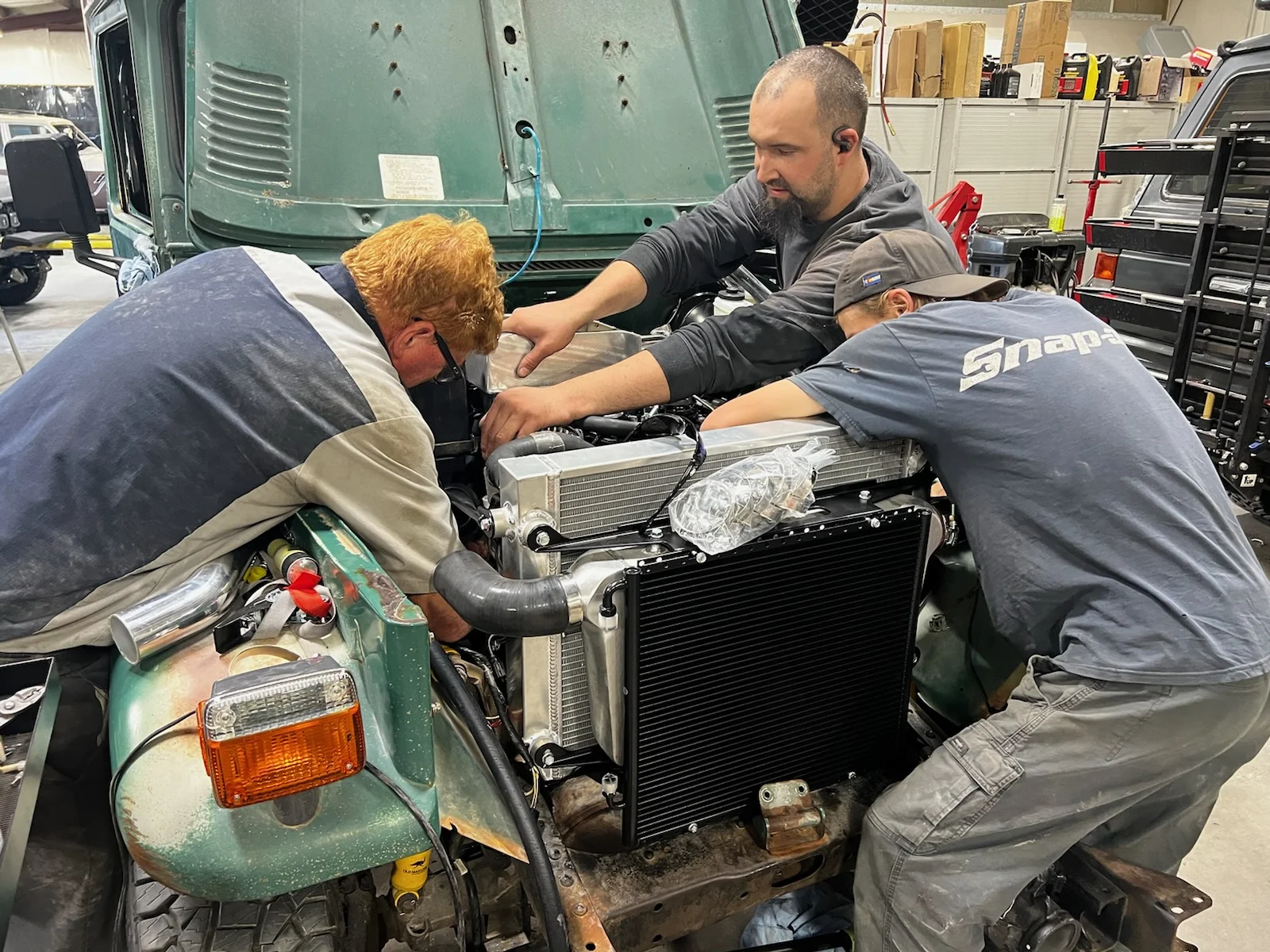

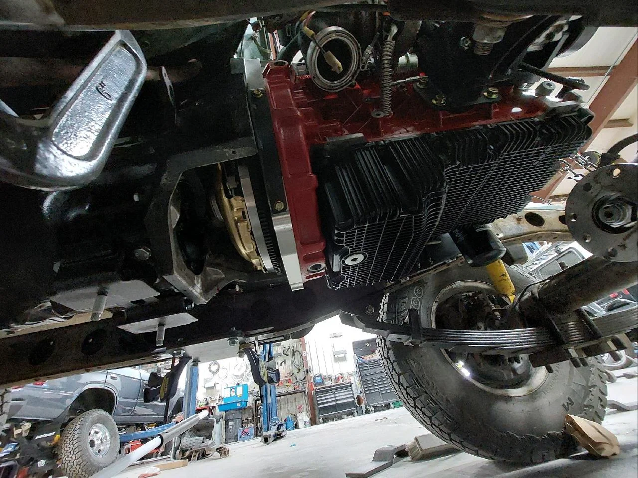

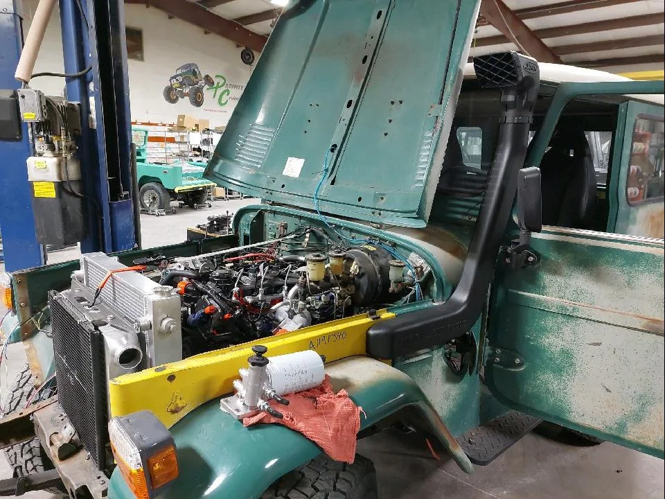

I'm not sure where my project is at this week. DJ sent me these two pictures last weekend. Looks like the condenser, intercooler, and radiator are in. With plumbing and wiring left. The last 5% is 95% of the effort.
Looks like steering is not connected either.
The snorkel looks pretty cool. I decided on the snorkel for a handful of reasons.
1. It does look neat (I think anyways)
2. It's drawing cooler air from outside the engine bay.
3. It's drawing air from higher up which should help with dust.
I have zero intent on fording anything hood deep.
I bought a used apron from Classic Cruisers. The original will remain unmolested. When paint happens, I'll have it painted to match just in case the next owner decides they don't like being awesome or they decide sucking hot air from the engine bay is a good idea. 😆

I think we're getting down to the short strokes now. It runs and lives. Still short the radiator shroud, and the top support for the condenser, intercooler, and the radiator.

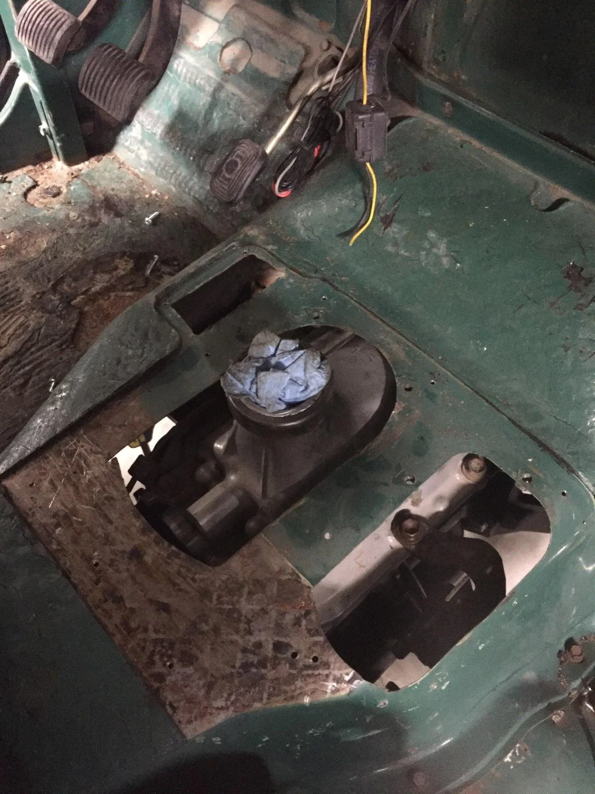

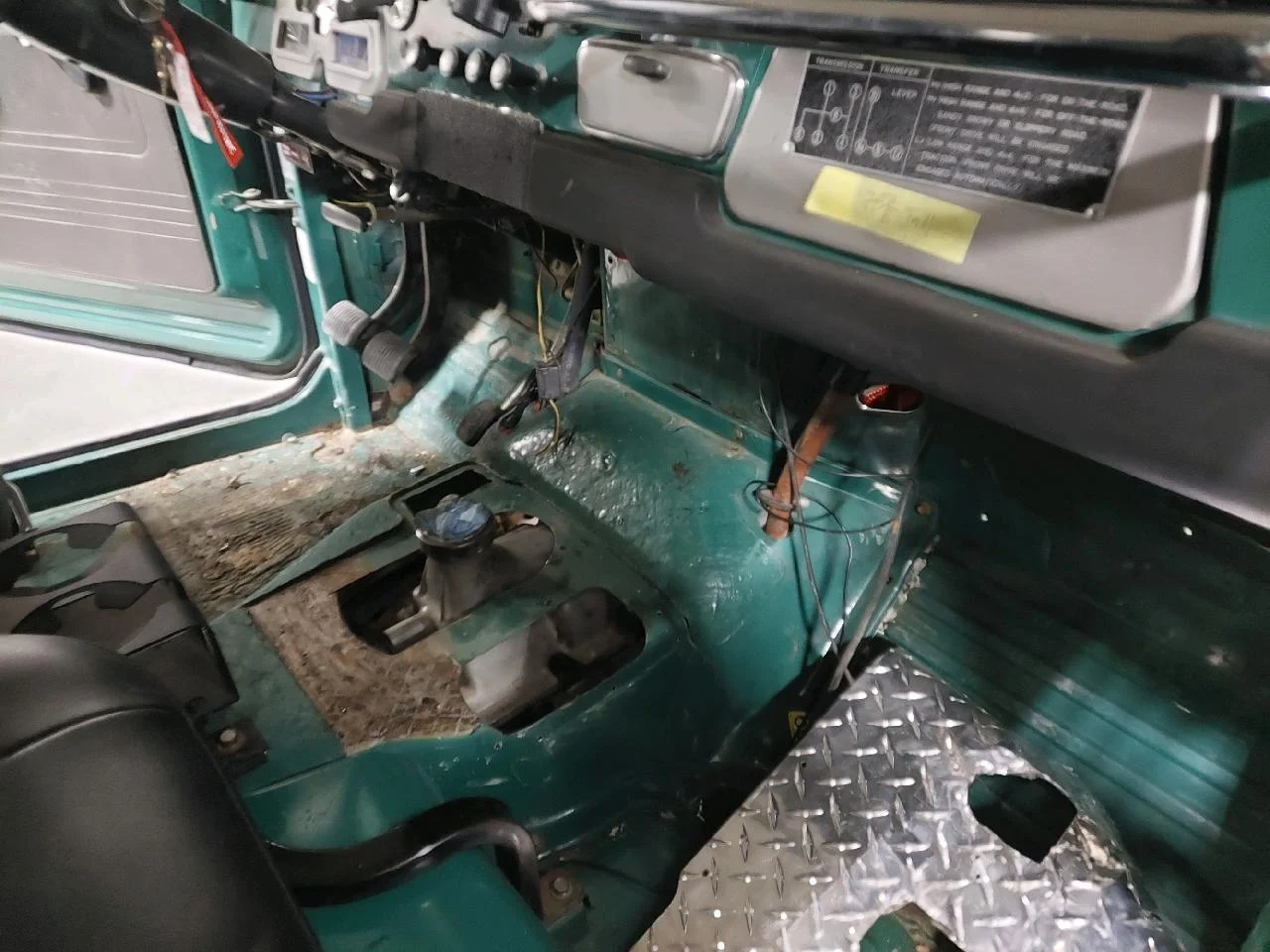

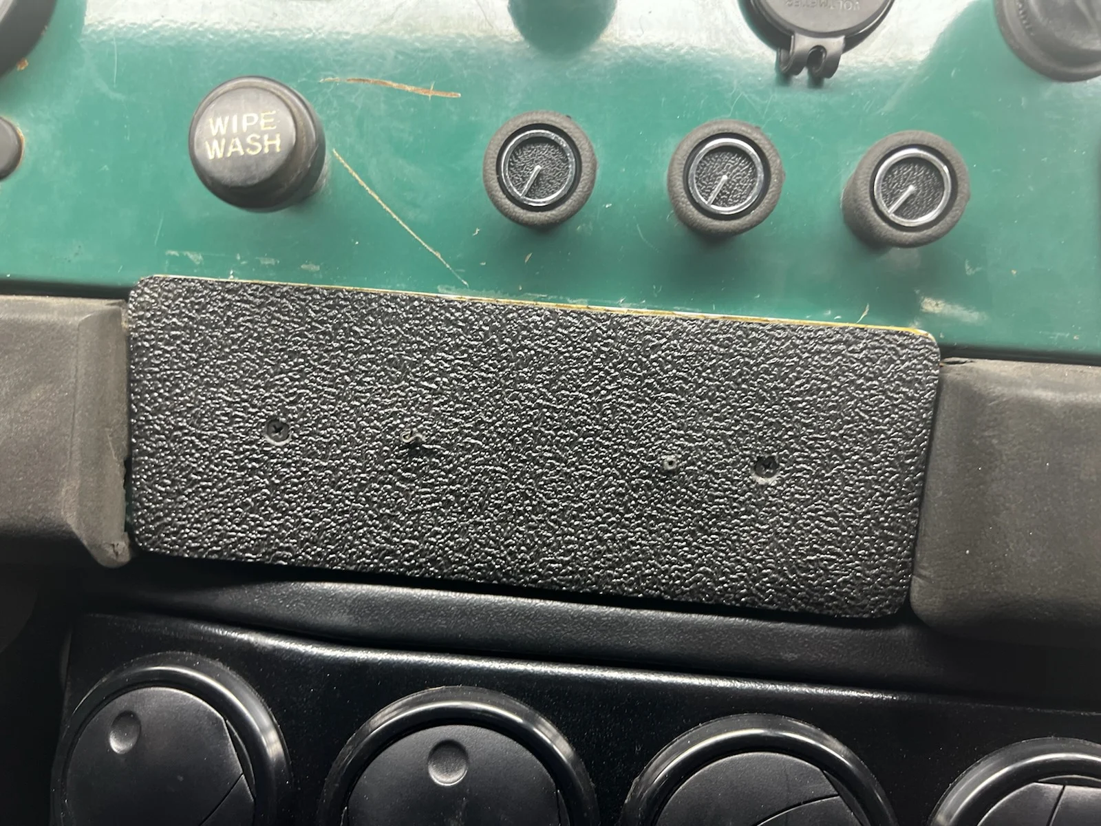

Some previous owner, whacked a hole in the dash to the right of the cluster. The Murphy gauge for the little Cummins was able to go there, and that makes me happy.

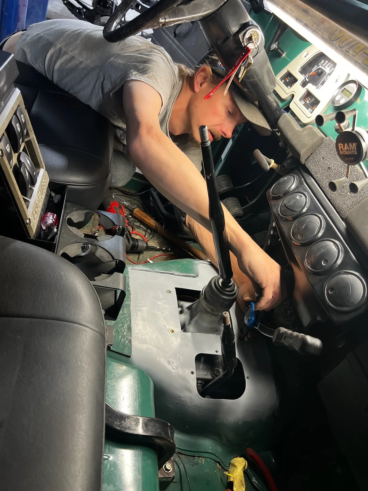

Being I don't have any use for the choke cable any longer, and there is a hole below that Murphy gauge, I'm thinking about moving the pull switch for the hazards to that hole. Removing the choke cable. That leaves me with two unmolested holes to put the two Toyota fog light switches I just got that I intend to activate the air lockers with. Thoughts?
Penis owner whacked.... errr, I mean previous owner hack job on the tunnel remediated.

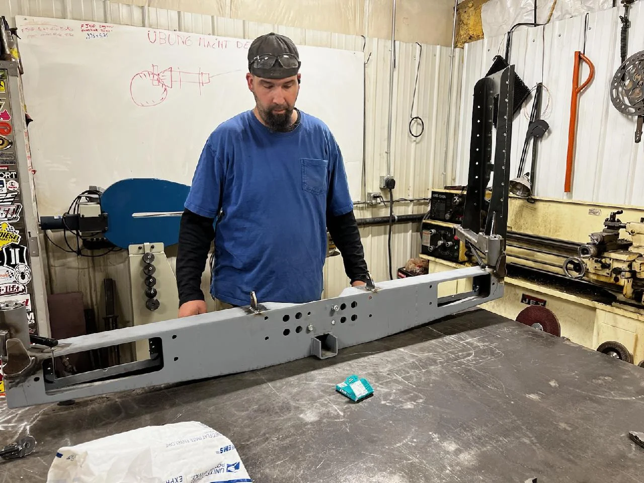

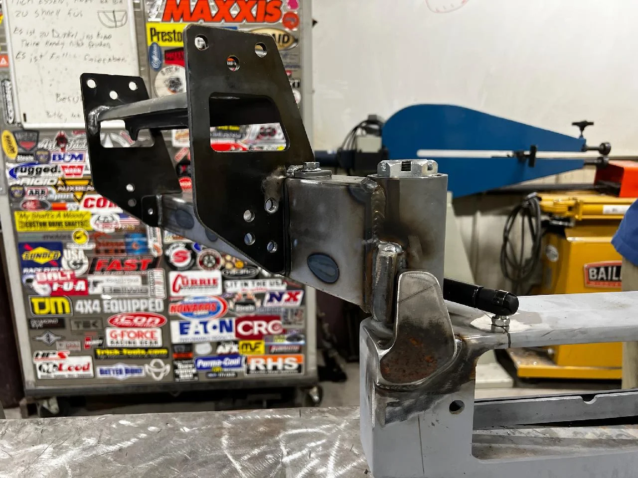

And the rear swing outs coming to fruition. I'm excited in general, but I'm really looking forward to seeing this finalized. I'm hoping my idea of how the latches work isn't a total failure. I've got a far more complicated and expensive idea if it is. Might be cheaper for me to pick up a lathe than to pay for the prototyping of that idea though....😄😮🤔😬

Redline Land Cruisers (I think?) makes a machined aluminum knob. You can get blanks. They're anodized black and they do sell blanks. A buddy has a small cnc with a laser on it. Apparently it'll chew/burn through anodizing no sweat.
I bought the switches from Cruiser Cult. He posts here. There was a mix up and I got the knobs. No worries, I was debating about buying his replica knobs anyways, so it just forced my hand is all.
FYI, the print quality is REALLY good. I emailed him asking about material to do some research on using the laser on that. It looks like it's the type that prints in goop (technical term....). I have very little exposure to 3D printing, and zero with the submerged printing.

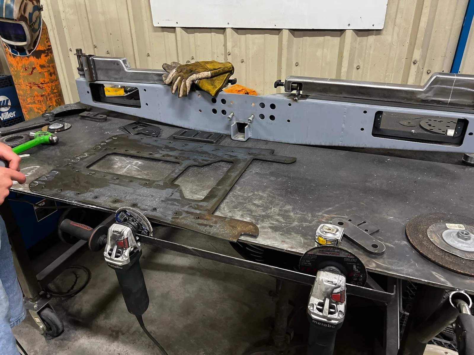

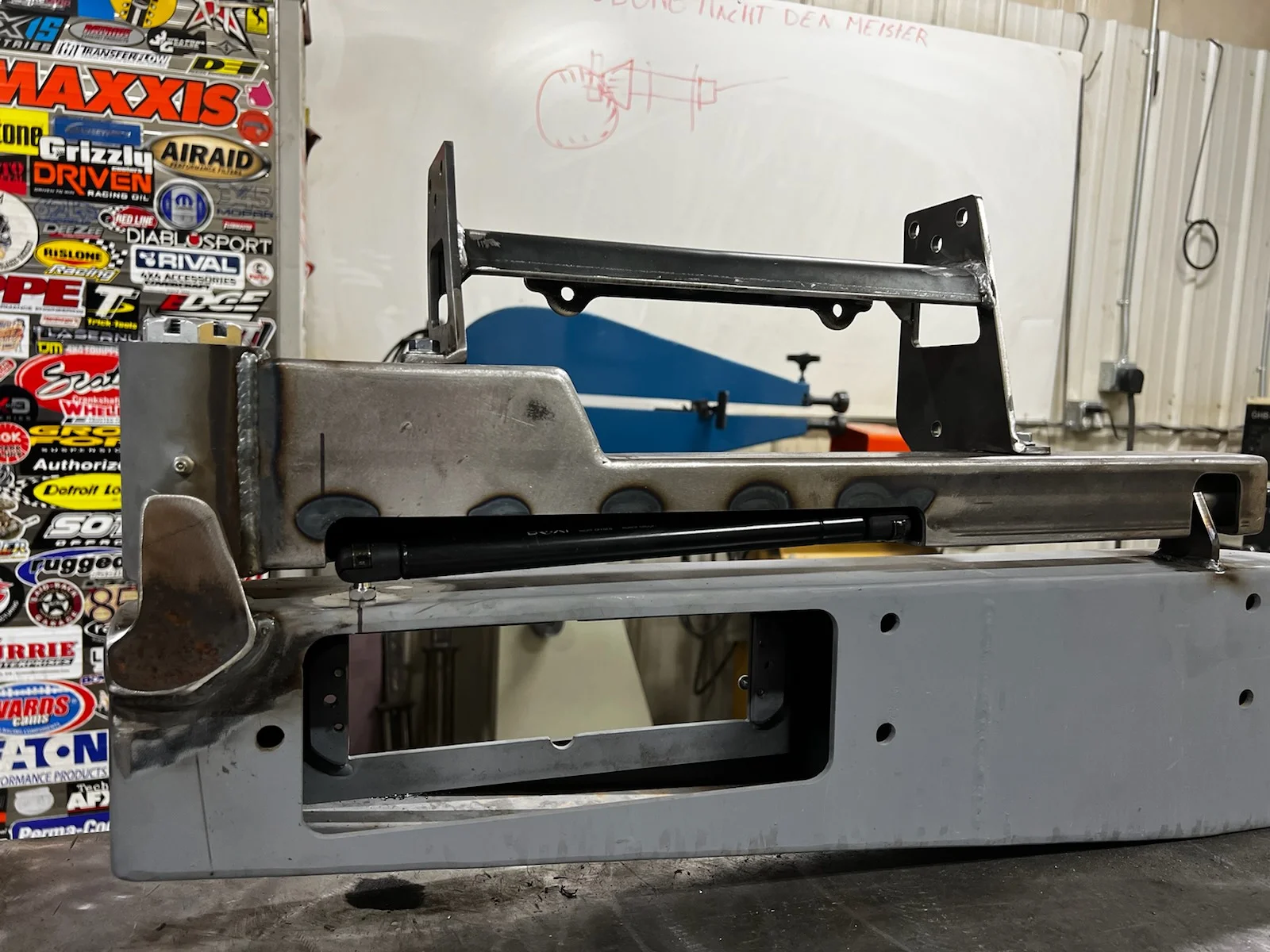

Swing outs and both bumpers should be headed out for powder coating. I can't wait to see these done.
I'm also very much looking forward to not being able bounce anything off of the tub, and having them hold themselves open with the strut.

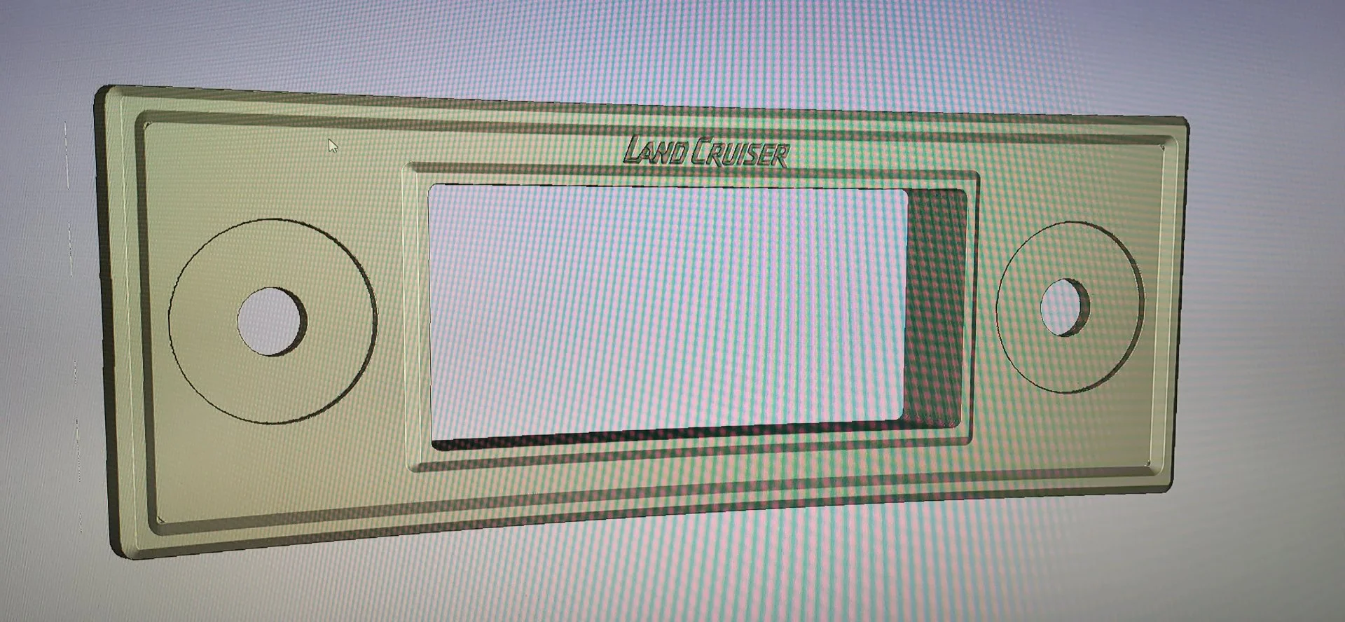

Also started working up a model for a stereo faceplate. It'll need a whole mess of tweaking, and a few cut from mdf before I do the final.
I also have zero clue how I'm going to mount the head unit. There's some threads here that'll help, but I don't EXACTLY know what has been butchered on mine, and what kind of work around I'll have to come up with.
