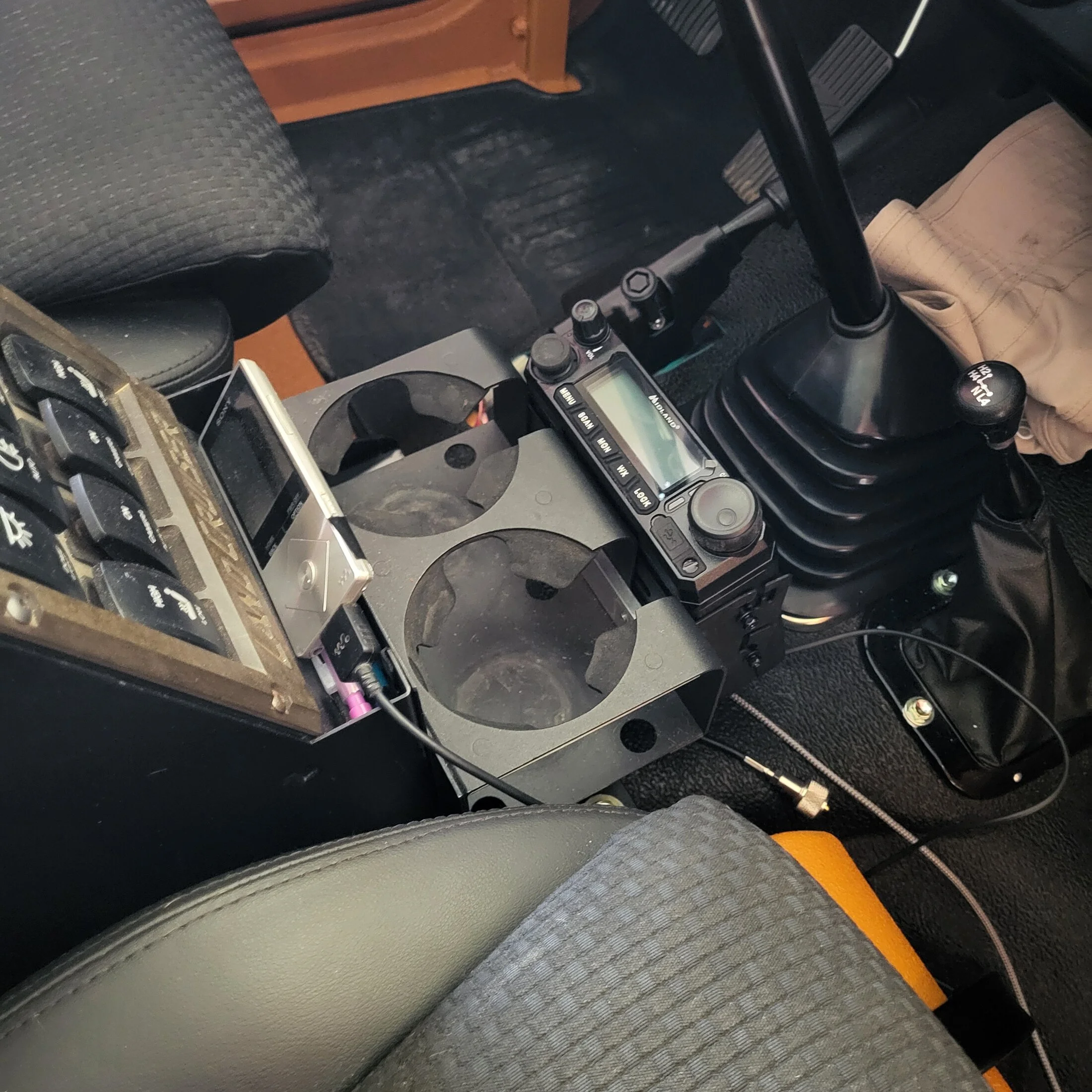

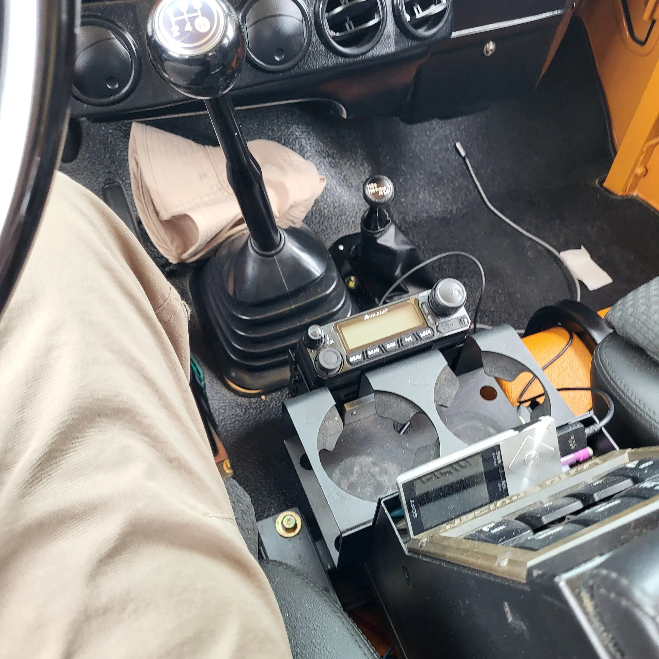

Upgraded my communication radio.
Reason being, when we were in South Dakota, the group got a few miles ahead of me.
Chris has a slightly older version of this radio, and runs a bigger antenna.
I also have a bigger antenna, but 15w of transmitter power. Most were breaking up except Chris. He was crystal clear. So I upgraded.
It barely clears the shifter. I need a 90º adapter to turn the antenna so it's not packed against the floor.
Fits in the space nicely though.

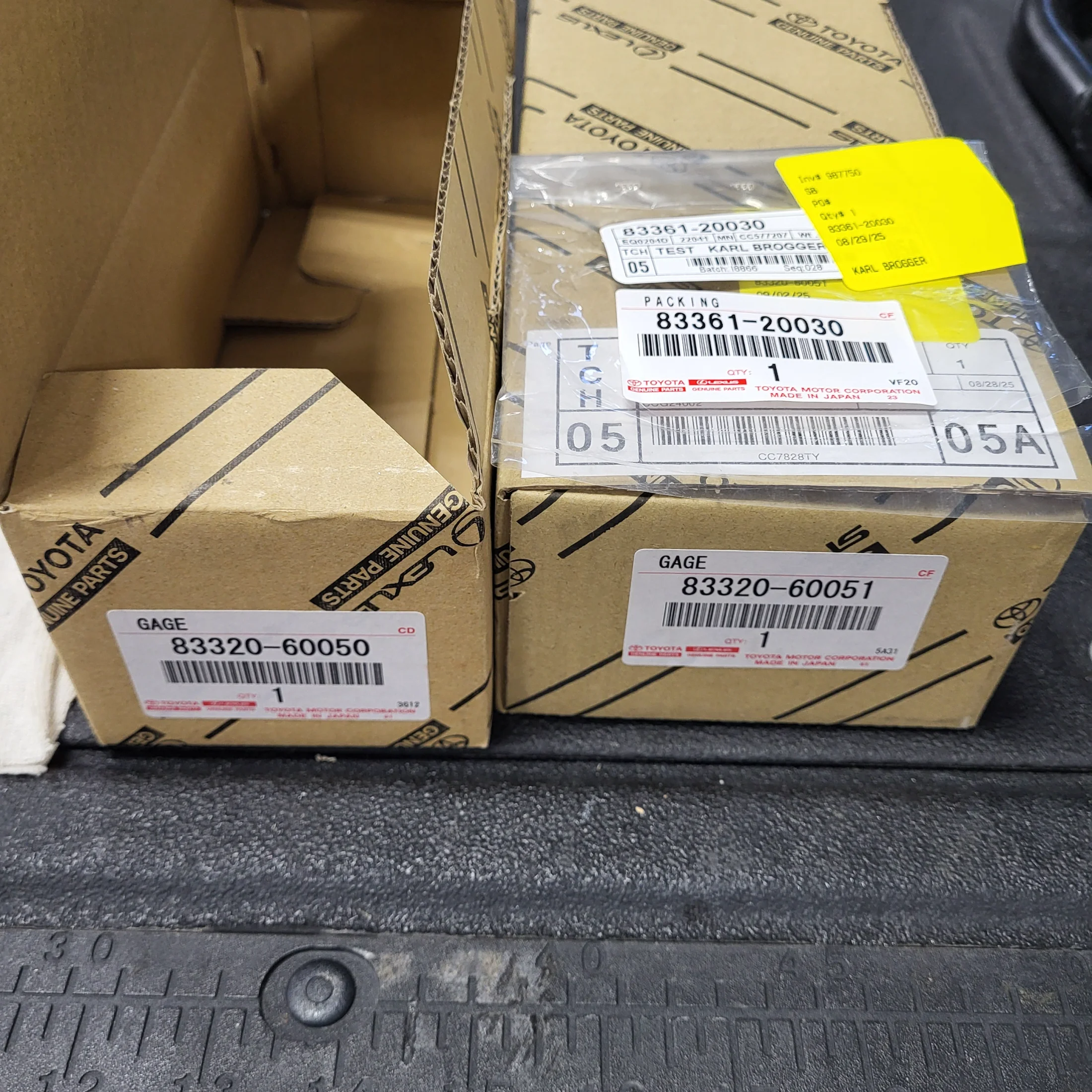

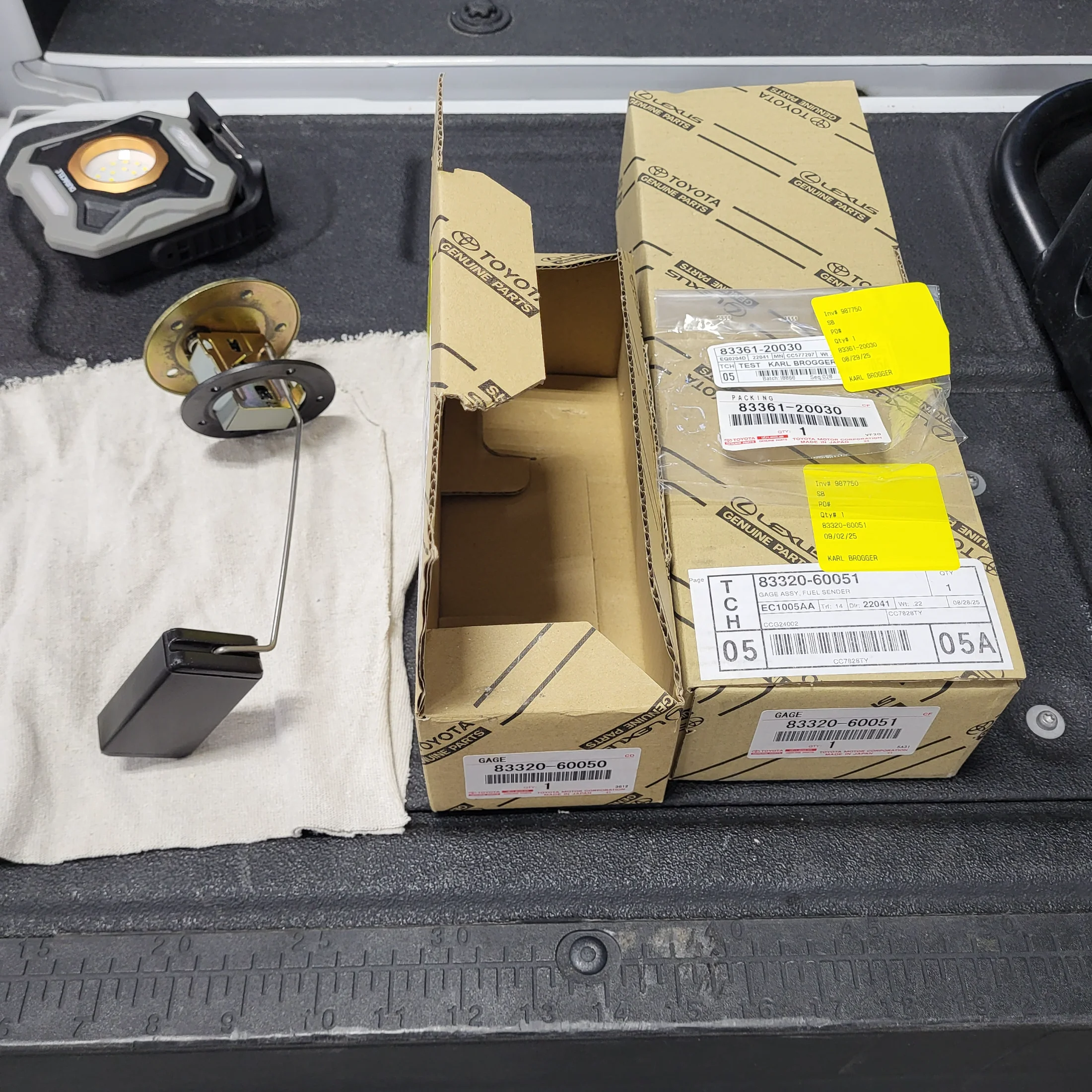

Toyota says there's two different fuel level sender for 1976.
Anybody know the difference? I ordered both. Just seemed easier.
I checked the signal wire from the tank to the cluster. It ohm'd out. So that's good. Tested the cluster by grounding or the signal wire, so it's good.
That just leaves the float level sender screwing up.
And the difference is, how long the arm is.
Why the difference? No clue...
I used the box on the left.
The old sender is sitting next to that box.
The one that was in the tank was some knock off. I assume it came with the Cool Cruisers tank I got a few years ago. It looked new(ish)
I just changed out what matched. Maybe it was supposed to be the longer arm version.
