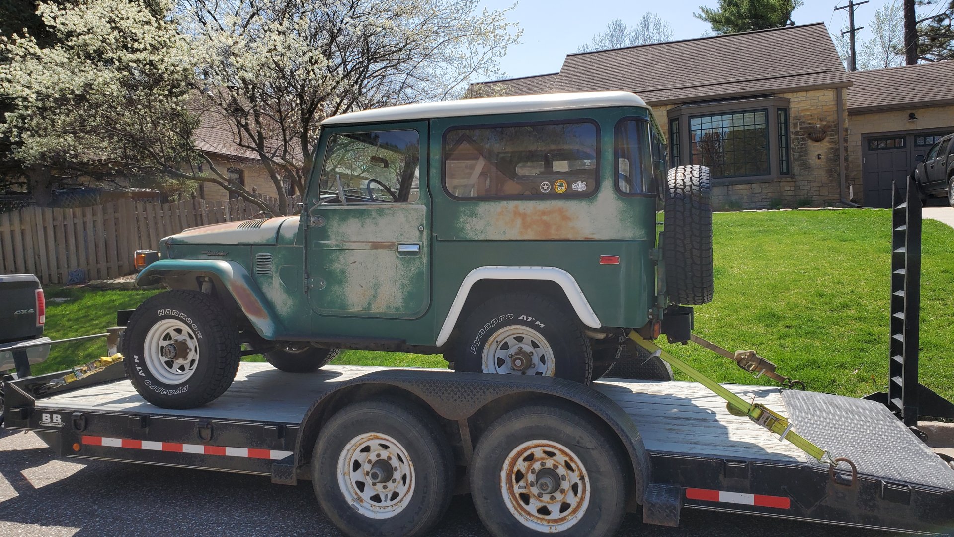

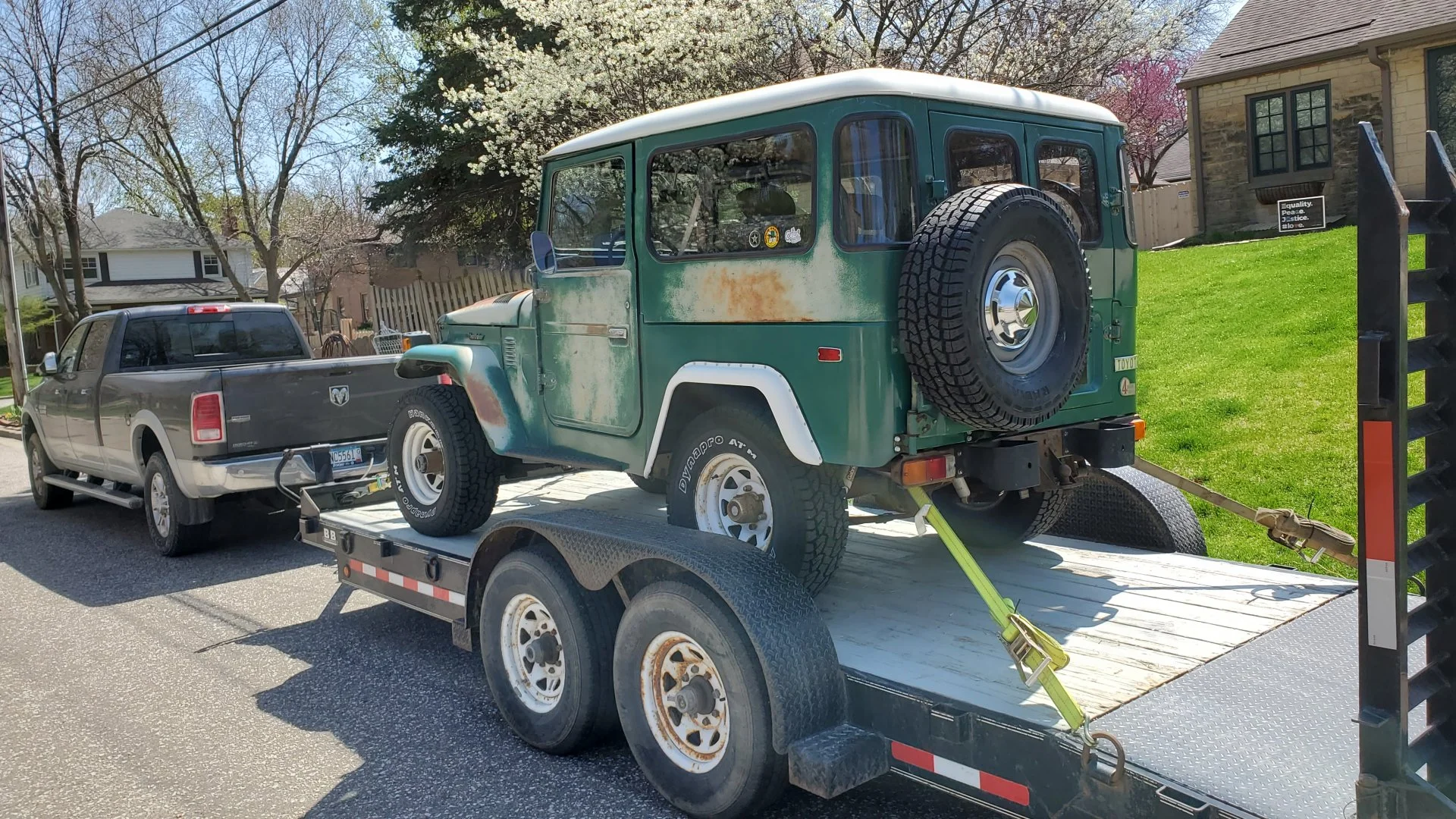

I had been scouring Craigslist, Hemmings, and a few other places when recently somebody turned me onto this forum, and I found this 1976 FJ40. It was, for me, the perfect project. It needs very little sheet metal repair. It's mostly there. So I grabbed the skidloader trailer, a fist full of Franklins, and headed to the Nebraskan prairie.
My plan for this is to make it into a nice daily driver. (As nice as a 45 year old more or less tractor can get for a driver) Not in the winter though, it's Minnesota, the chemicals that get used will rot this thing out pretty much instantaneously.

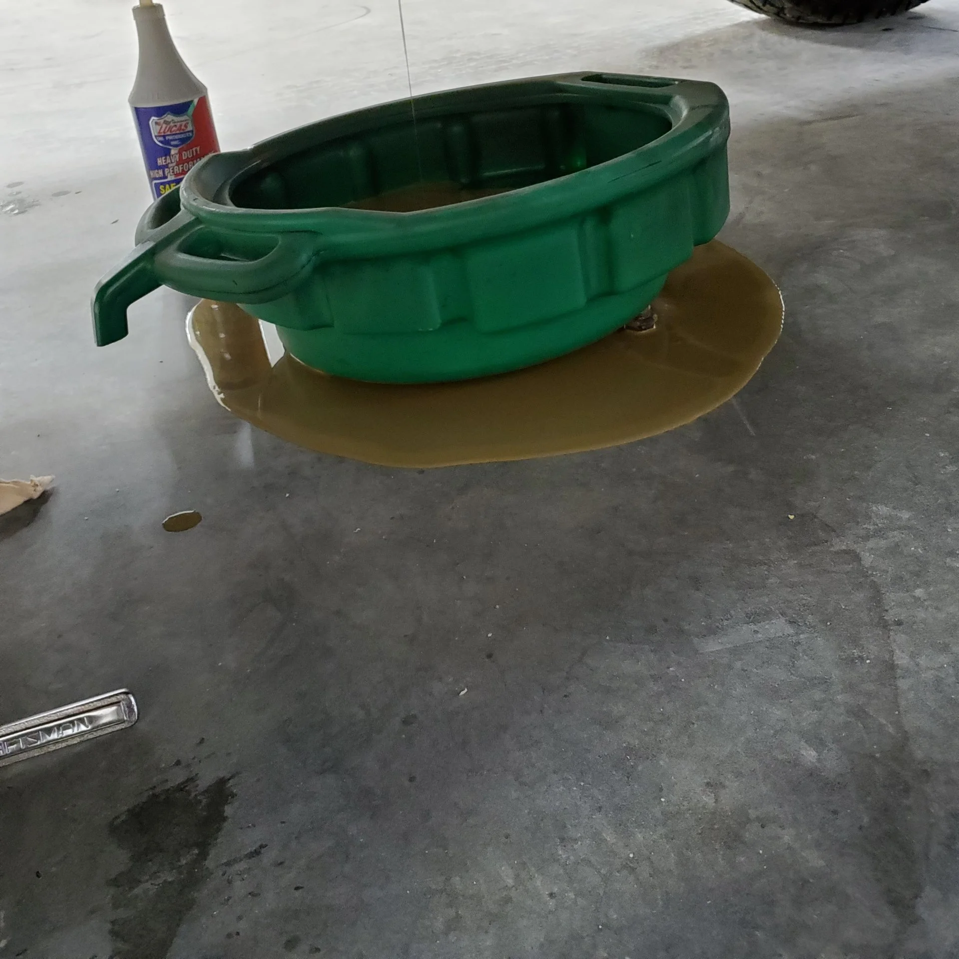

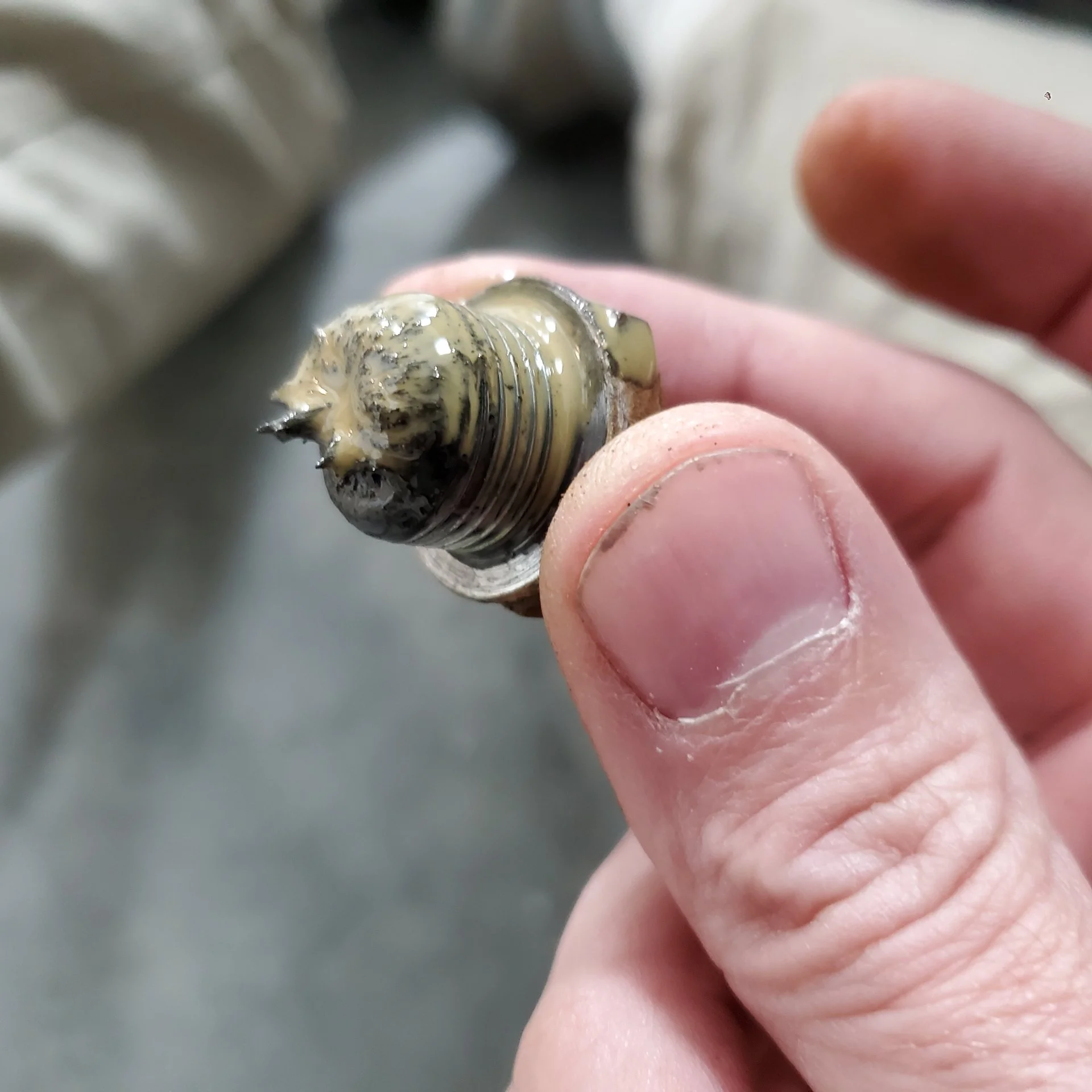

My first "phase" will be to go through the driveline. I pulled the fill plug on the transmission, and immediately I got the treat of being full of water.
So I pulled the plug, full of metal.
At least the oil wasn't orange because it was full of rust along with the water. The inside of the cases were actually pretty clean.

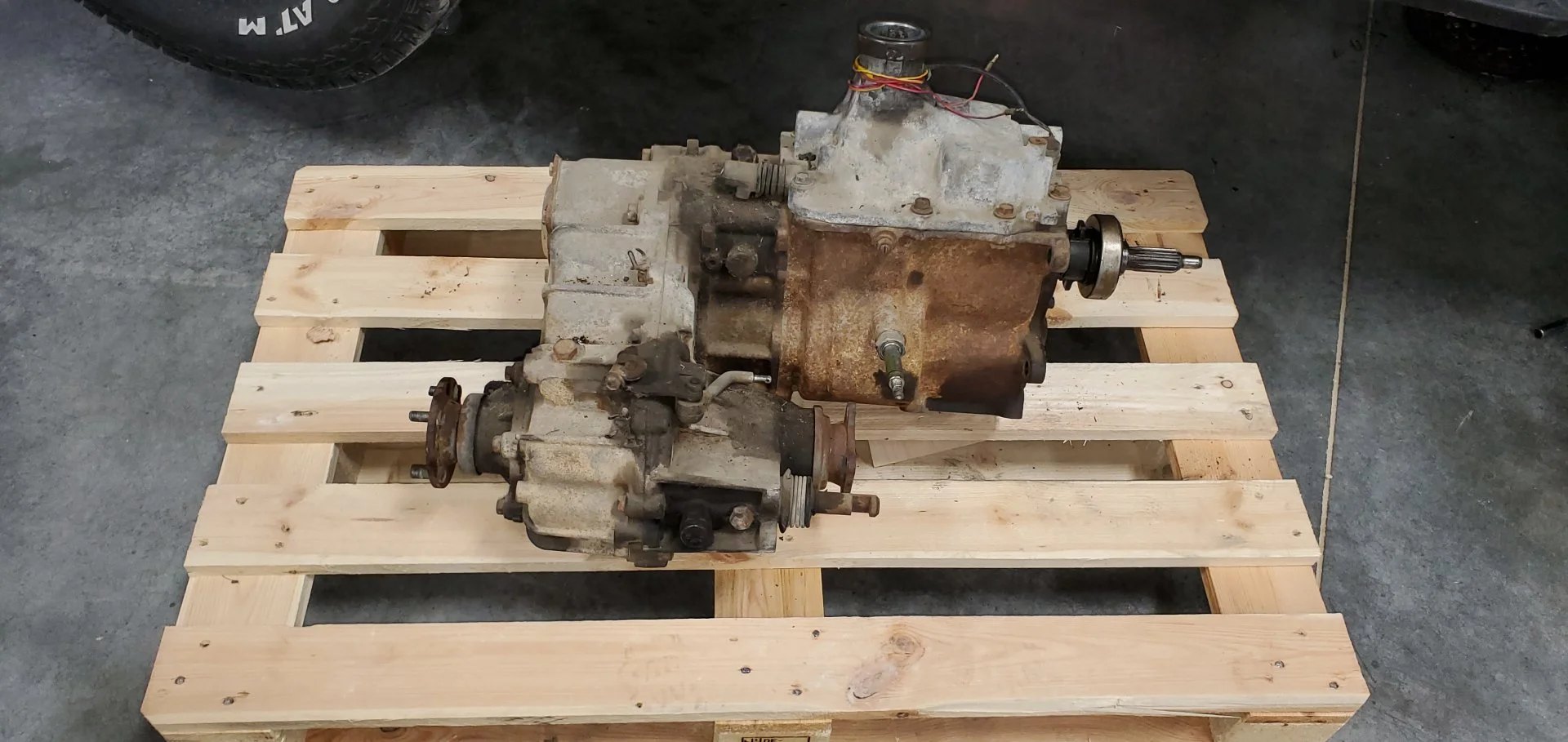

I don't know what I'm doing inside a tranny or transfer case, but a local does, and he's got the tranny and t-case right now.
Tranny dude got the rebuild kit for both, but is waiting on a replacement 5th gear. From Australia..... It'll be here between May 12th, and June 25th. Allegedly.... The idler shaft in the t-case was freaking chowdered, flat spots at the needle bearings, and a small chunk missing. I'm hoping I'm shocked how much quieter it will be going down the road.
Oh yeah, fun note, it has an H55F transmission, and a split case. I'm super happy about that, because the long term goal is a diesel swap.

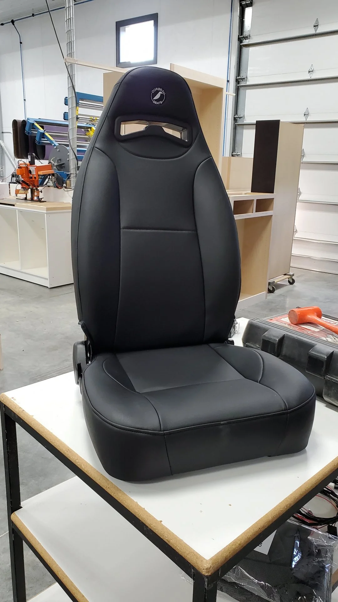

I ordered new fronts seats, but I'm waiting on the seat brackets. I have new covers for the jump seats. I think I'm going to pull the frames and have those powder coated before recovering them.
