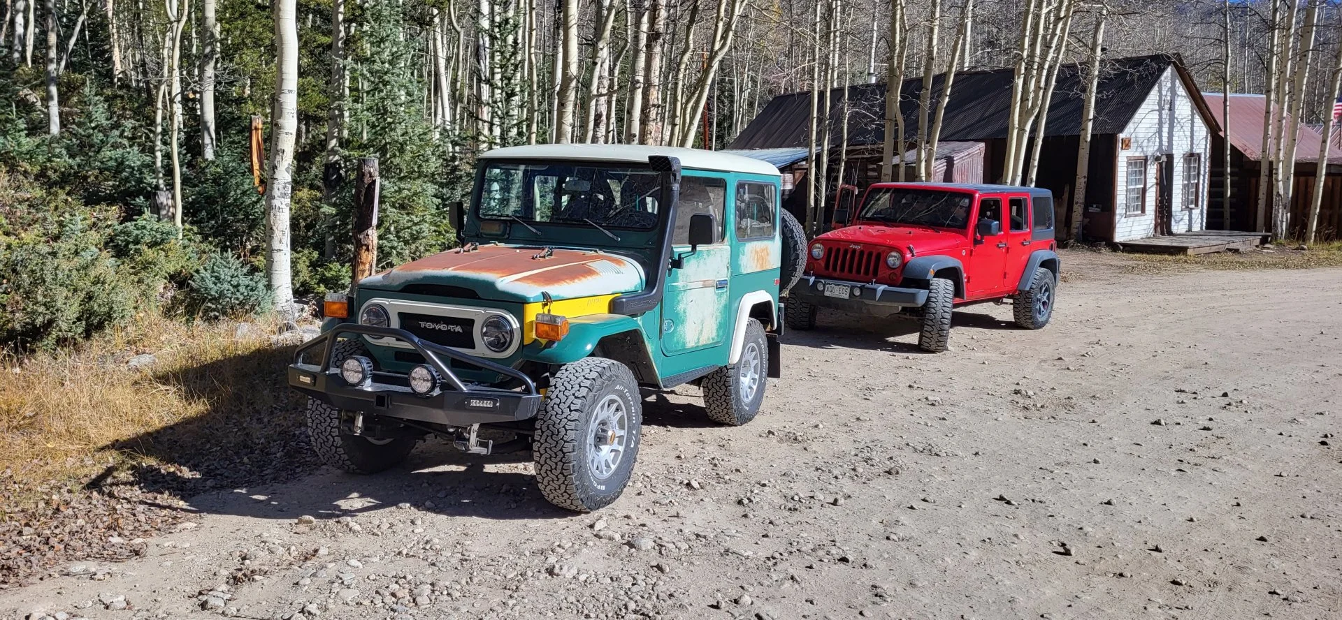

That was fun. Rough. Great views. Good times. Even found a fire wielding monkey.

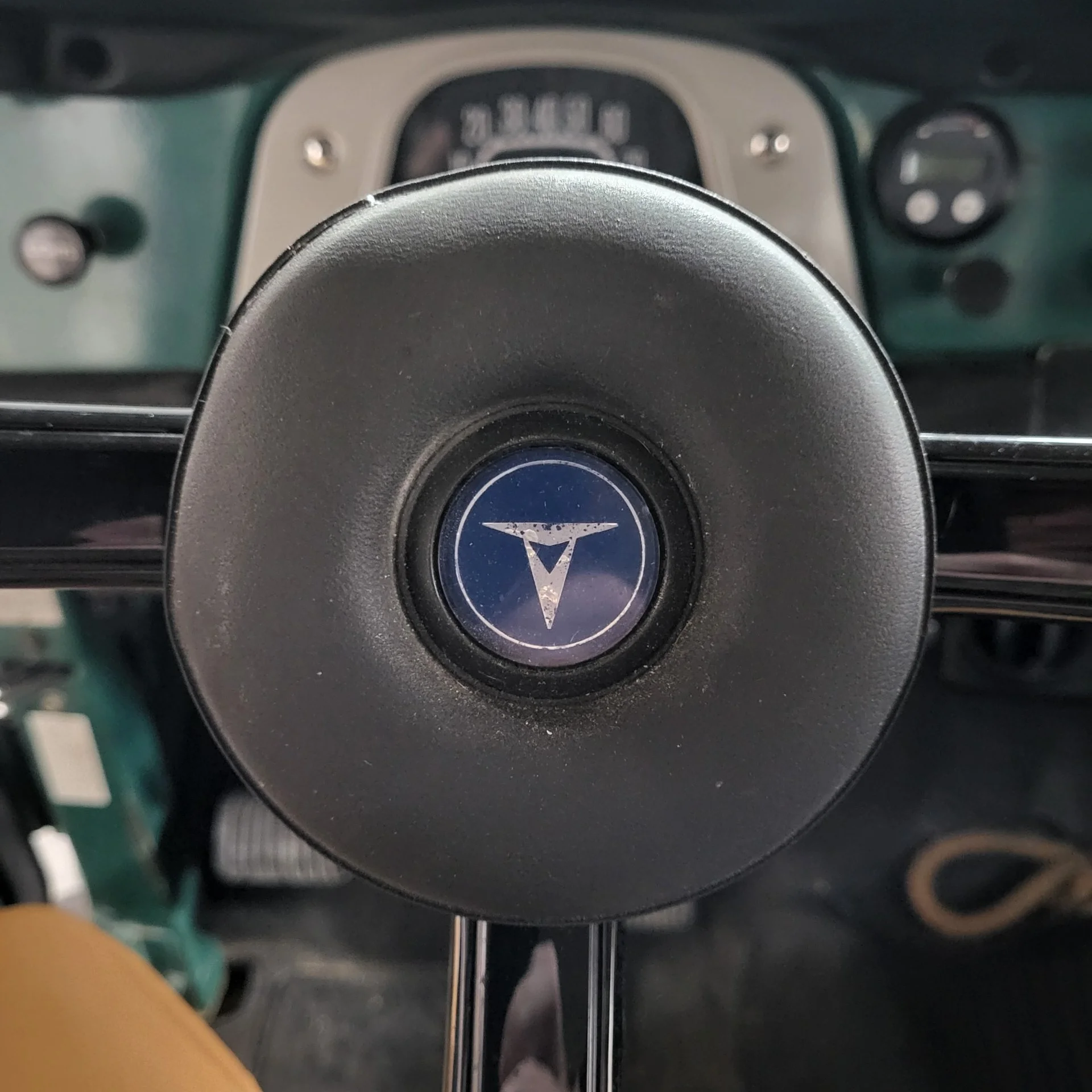

Swapped out my old steering wheel pad that was deformed and cracked for a used replacement in much better condition.
Old
Still old, but in better shape. 😆
I removed the column cover before actually looking how it attached. Not necessary to do that.

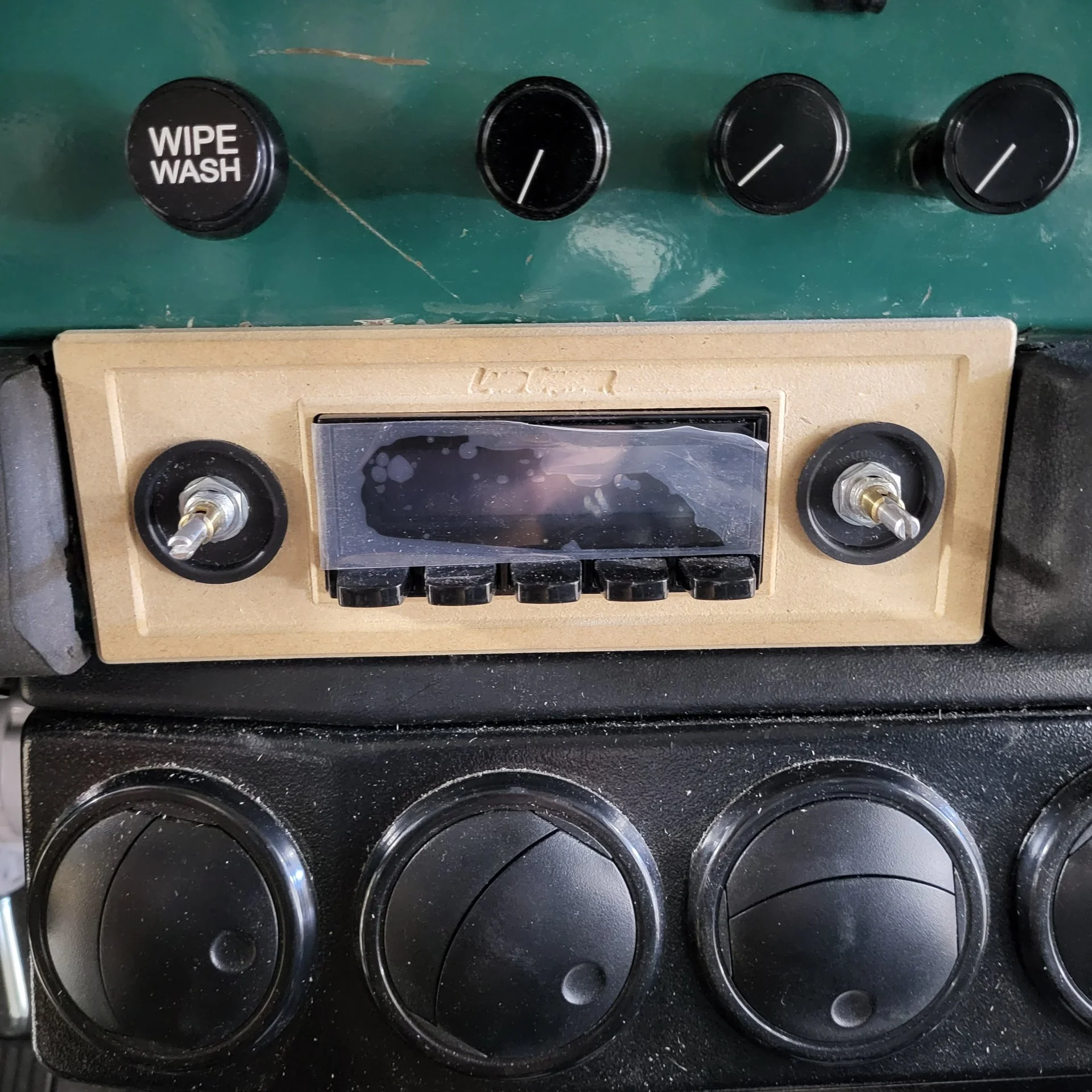

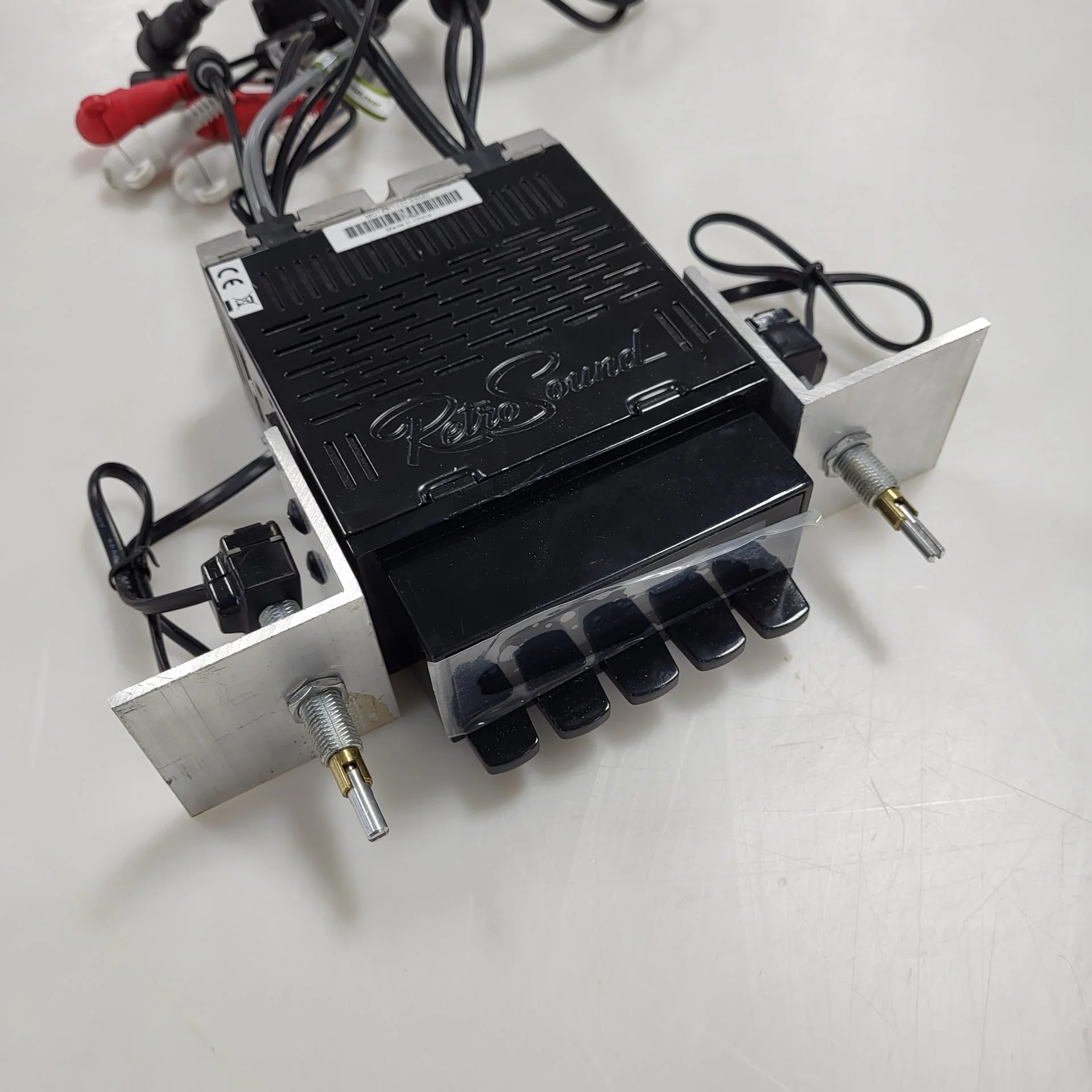

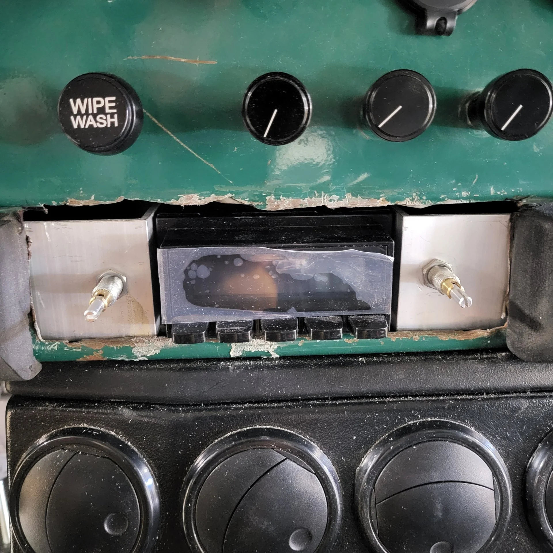

I think I came up with a workable plan for mounting the head unit. The bracket under the radio is still there, and I think will give adequate support. I cut a couple of pieces of angled aluminum and attached them to the sides of the head unit. Those will press up against the backside of the dash with the faceplate pulling it tight.
In the hole that was apparently created by an angry beaver.
Face plate in place.

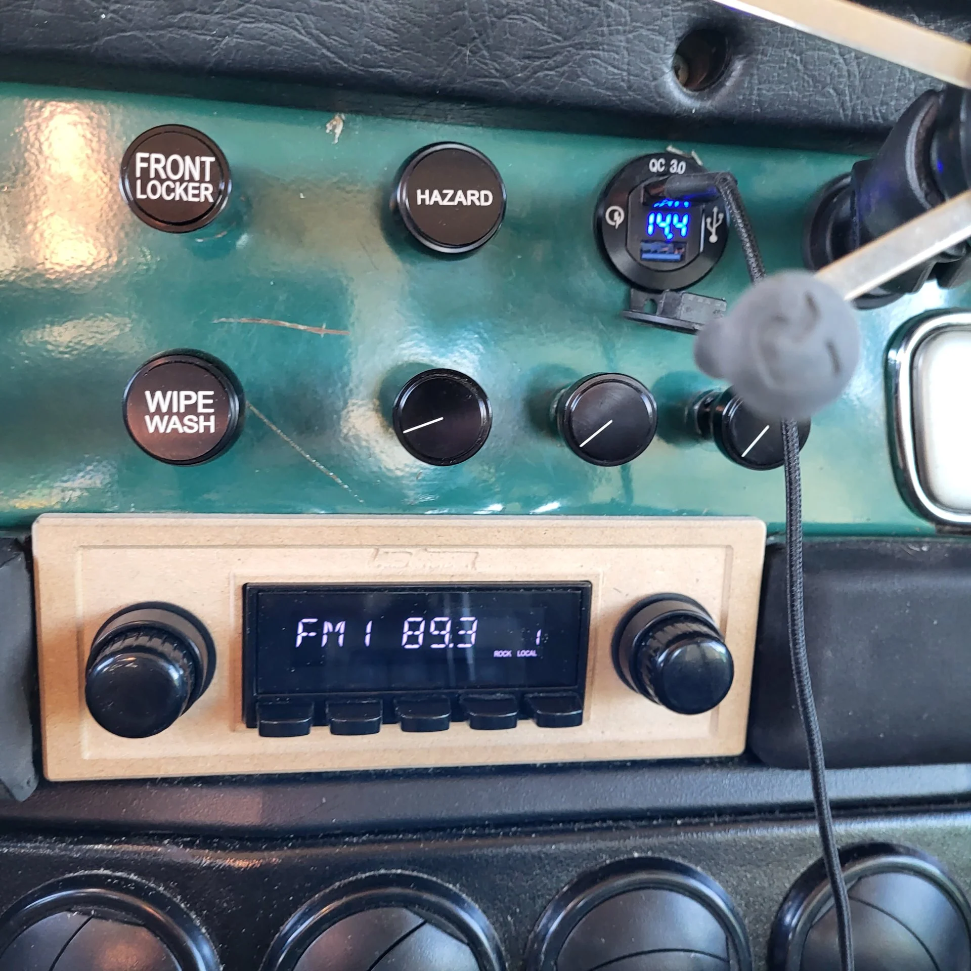

I also got all of the aluminum knobs from Redline Landcruisers put on. I want to flip the rear locker switch with the hazard switch, but it'll require hacking up the harness to make that happen, and I'm not interested in doing that.
And powered up. I ran the USB inputs to the glove box. Seemed like an easy solution. I'd like to find something similar to the USB port I have already, but be able to plug into head unit that way. I'm struggling with the correct search term to find one though.
I still don't have any speakers mounted.
Any tips or good examples of how to get wires into the doors?

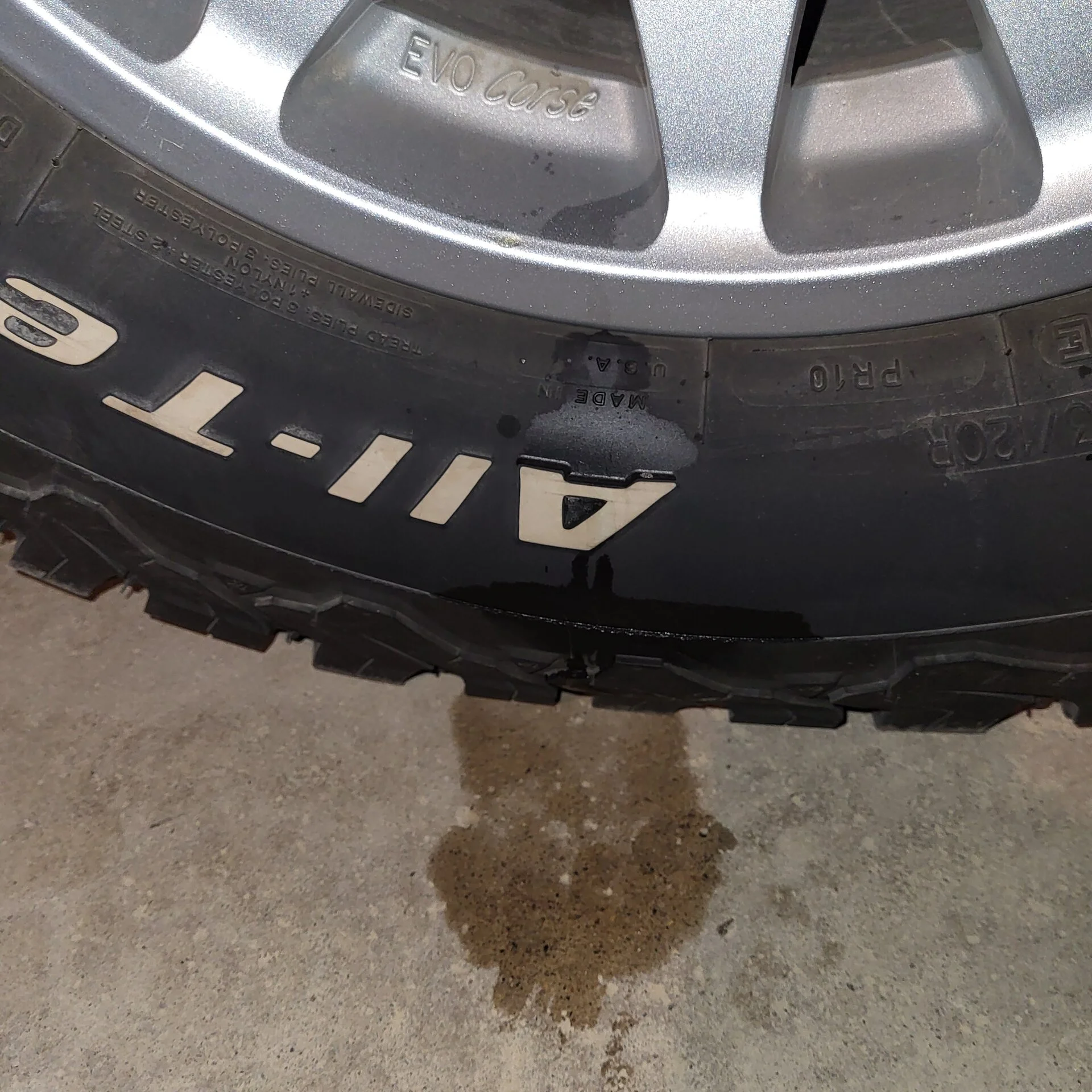

Good thing it's getting all new rear brakes with the rear locker in a couple of weeks. With zero investigation, I'm betting I've got a leaky wheel cylinder.
@Poser for the win on rear disc. I had one or more frozen cylinders and it was comparable in price to upgrade to poser’s kit. Super easy since you are pulling the third anyways.
I'm actually going to the newer style drums so I can recoup my parking brake.
The fluid might be cat piss. And I have cats living in the garage of the place I'm living.
Somebody on IG pointed out that, and it should be leaking down the inside of the wheel. Which makes total sense.
