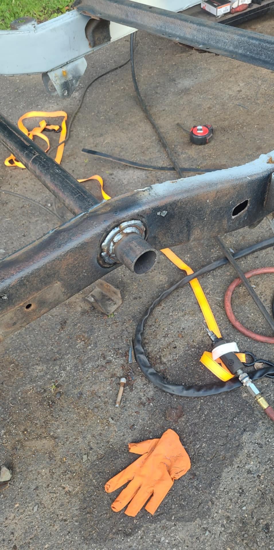

Finally got a bit of time to put on the frame ... replaced the shock tube and the inner frame rails . Definetly not OEM but better than rust I guess 😅

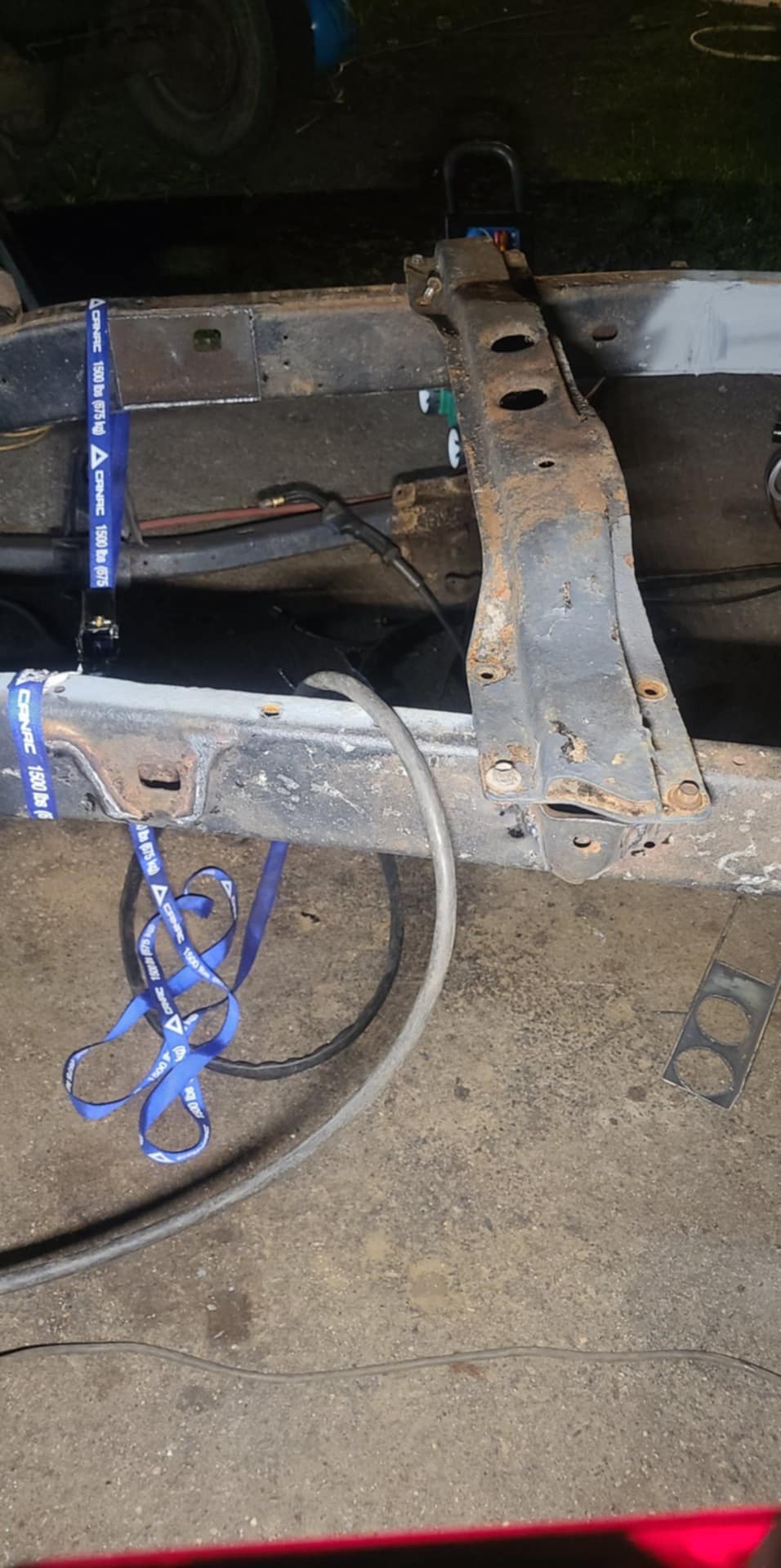

Relocated transmission crossmember on the replacement frame for the automatic .
No big deal but its done now :)

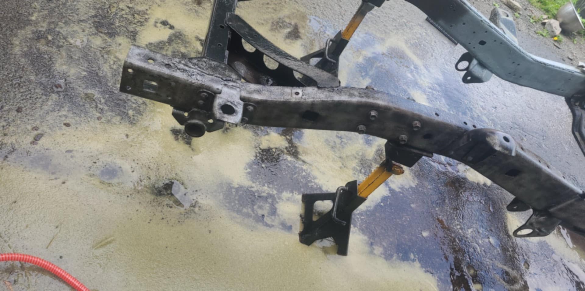

Wet blasted the frame , found a few morr little spot to patch.
Then applied the very thick epoxy primer 🙃
And finally 2 coats of black urethane. 🤌🤌

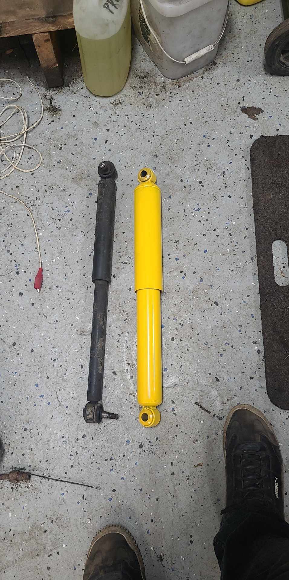

My front shocks dont fit tho... I need something longer ... what do you use with a 2-3in lift? Cant seem to find anything as a direct number for a 23...24in shock 🤷‍♂️
Will try to add pictures 😃

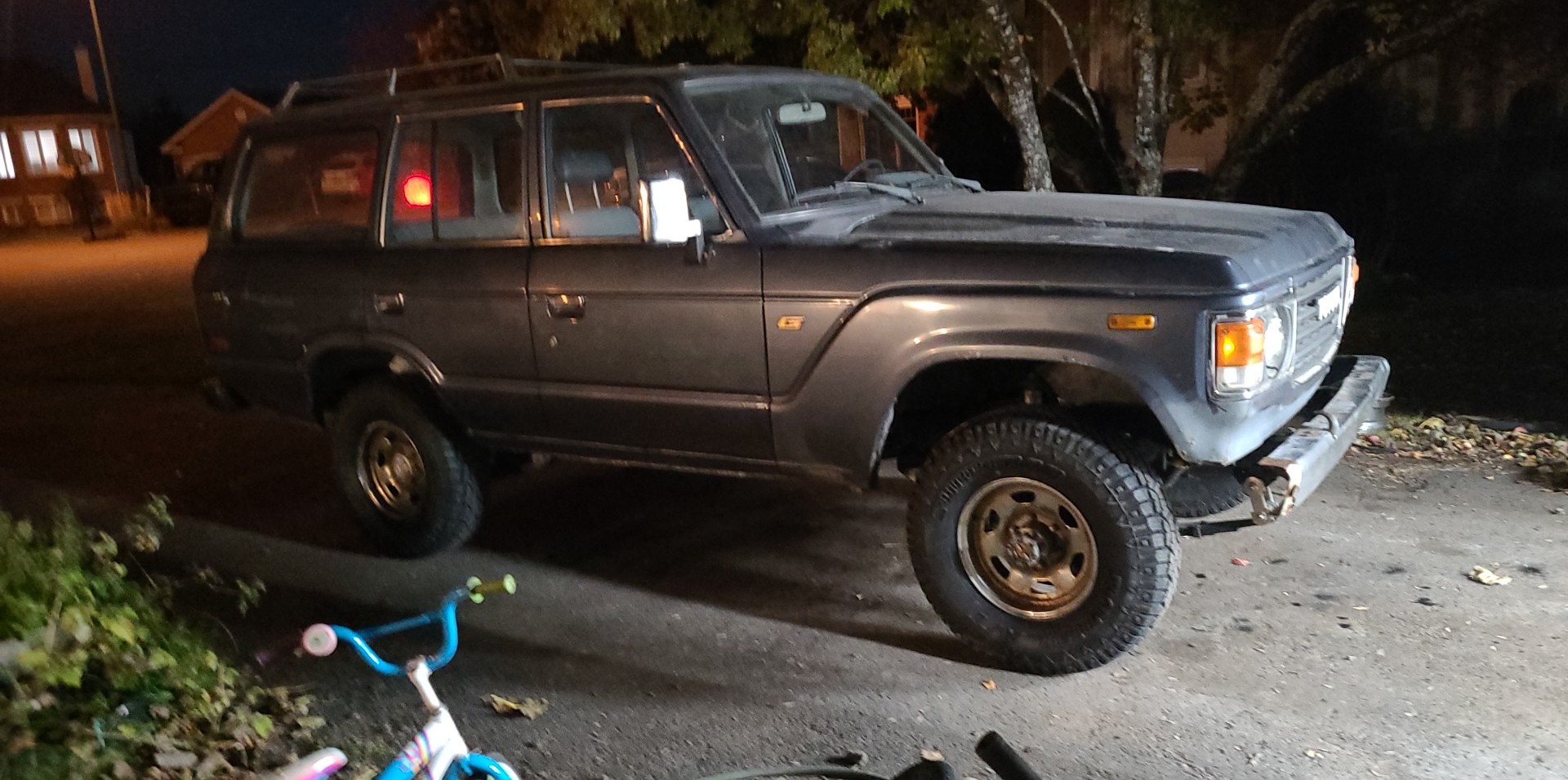

Hav'nt updated in a while ... had a few setbacks and success , but the truck is up and running. Its my daily driver since 1 month 👌.
Had a blocked injector .... belt keep coming loose ... and fuel pickup rusted out ... after that unvented fuel cap...
Few noise bugging me ... but it run fine 🫡
that was from the first real drive around , was very exited ! But it was not perfect .. had to repair all of the above 😅

Great progress!!! What is your wet blasting set up? Also what do you use to crease/ bend edges on panels?
You mean like wheel wells edges ? Might seem unreal but its 90% flat pan hammer and a bit of shrinker stretcher tools that I got from eastwood.
Wet blasting is a cheap attachement I got on amazon for like 50$, worked very well ! its not very fast... but 6 sand bags for the whole frame wasn't bad at all so im glad I bougt it
