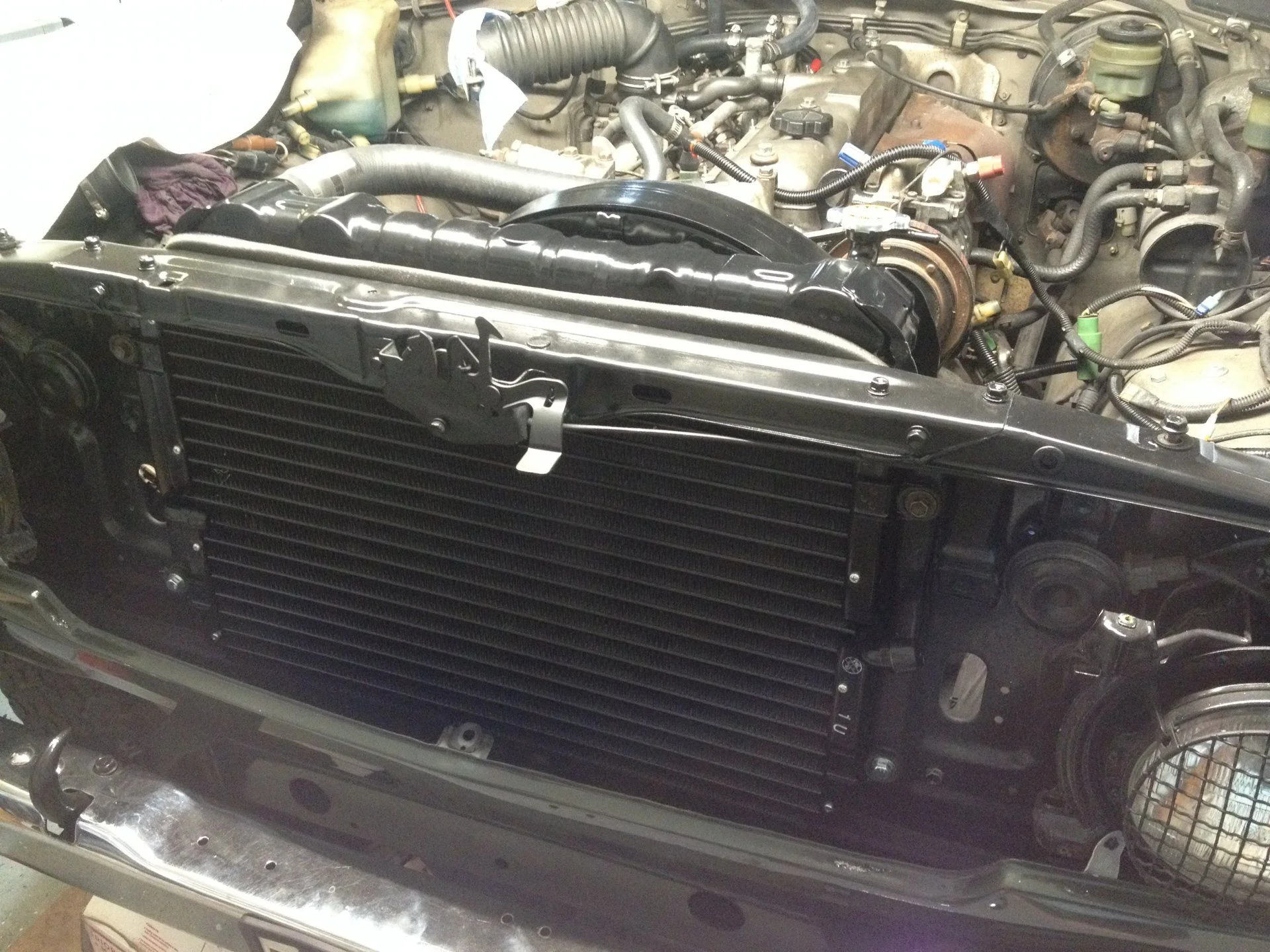

To get the new denso condenser installed, some minor tweaking had to be done to make the fj60 condenser fit into my hj60.
The AC hose coming off the compressor to the condenser needed to be reshaped to fit the new angle of the condenser fitting.

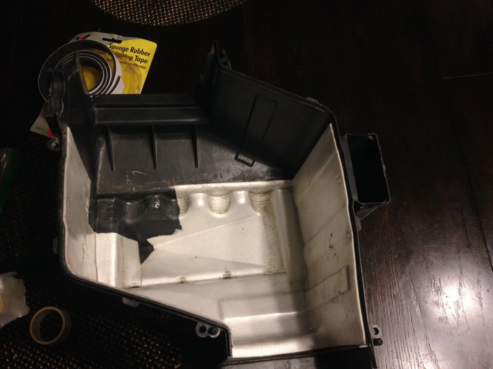

Also needed to address some issues with the evaporator box under the dash. The one we bought had some cracks down in the bottom near the drain hole. Since we didn't want AC water dripping on our new interior, we epoxied over the cracks on both sides of the box. All sealed up!

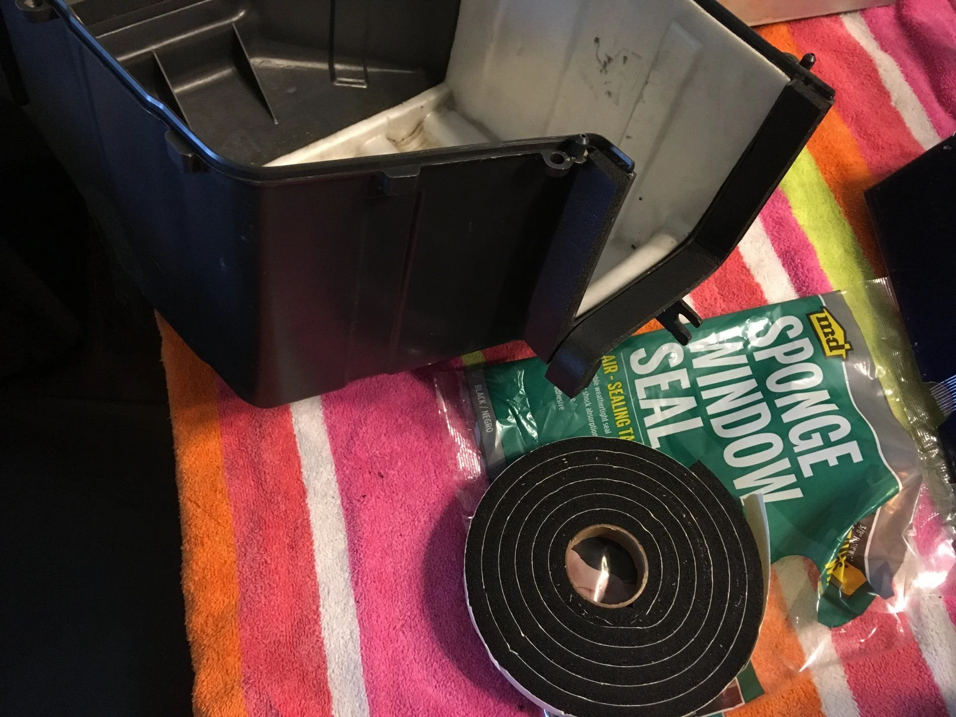

Then the crumbling weatherstripping on the evap box needed some replacing. Used adhesive backed rubber sponge window weatherstripping to replace the old stuff. It's pretty dense and just the right size for a nice tight fit.

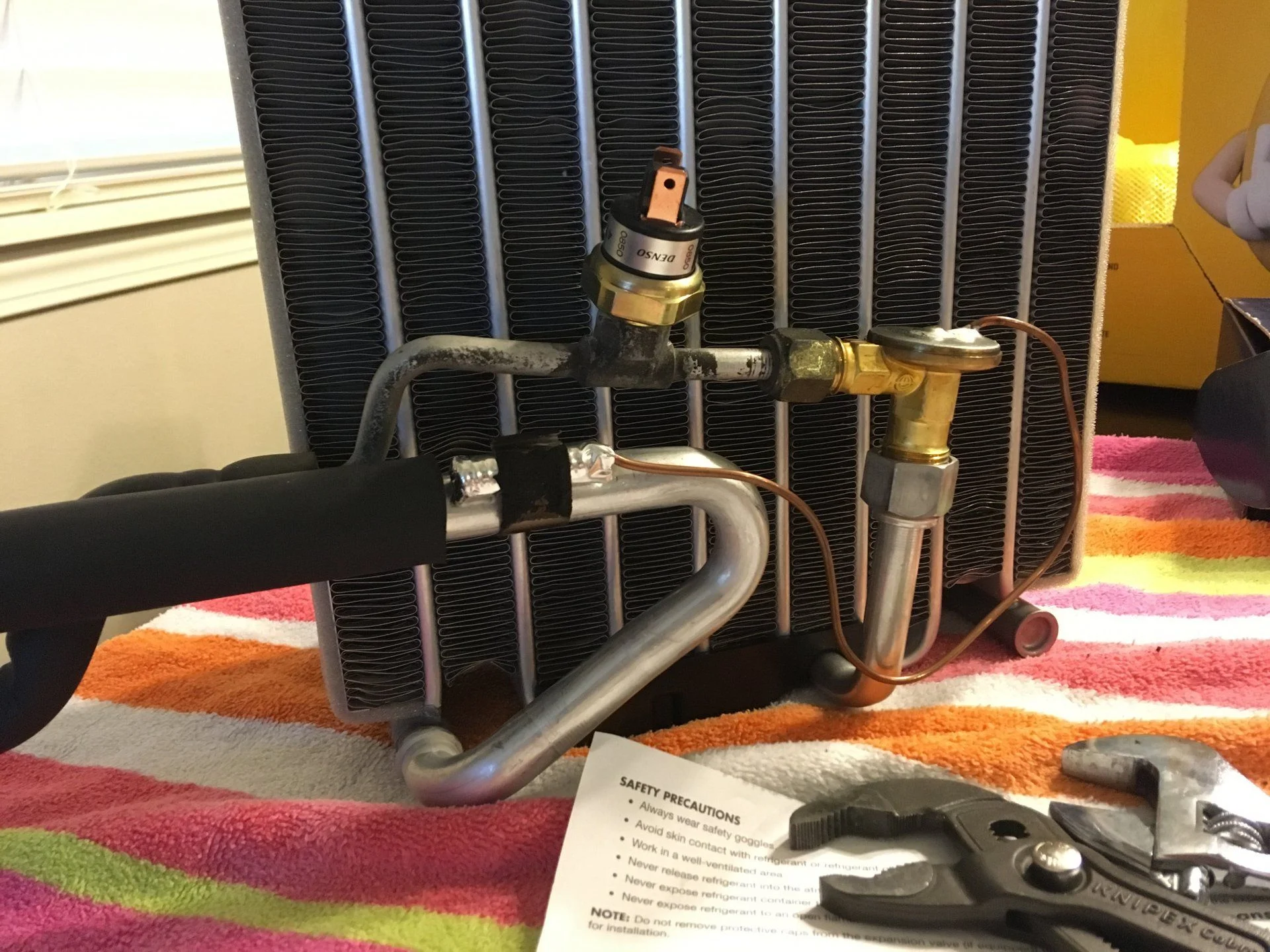

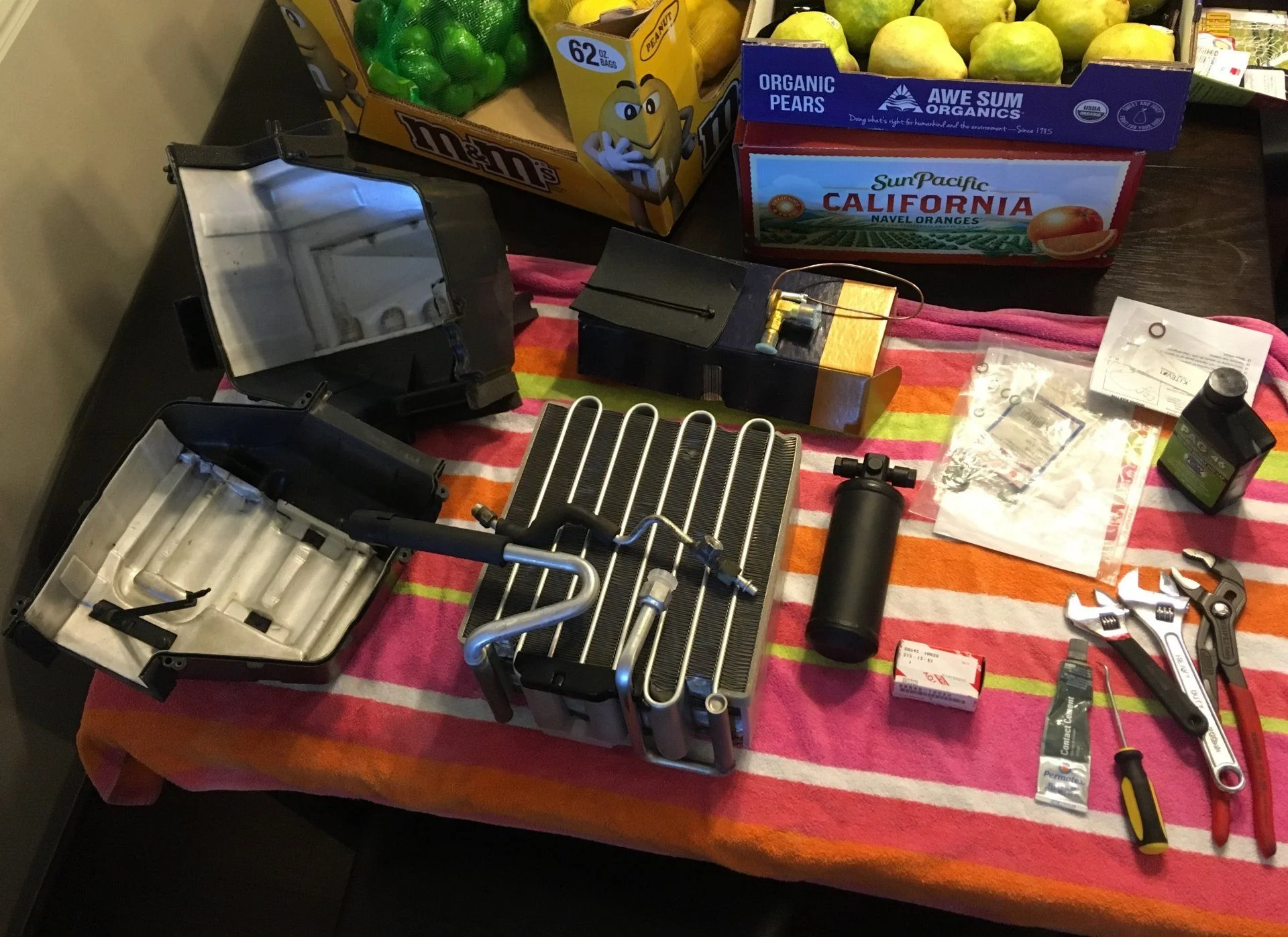

Then it was on to rebuilding the evaporator box contents. A new denso evaporator core, and new denso expansion valve and 24v pressure switch were put in along with all new r134 compatible o-rings.
All put together and ready to be boxed up.
