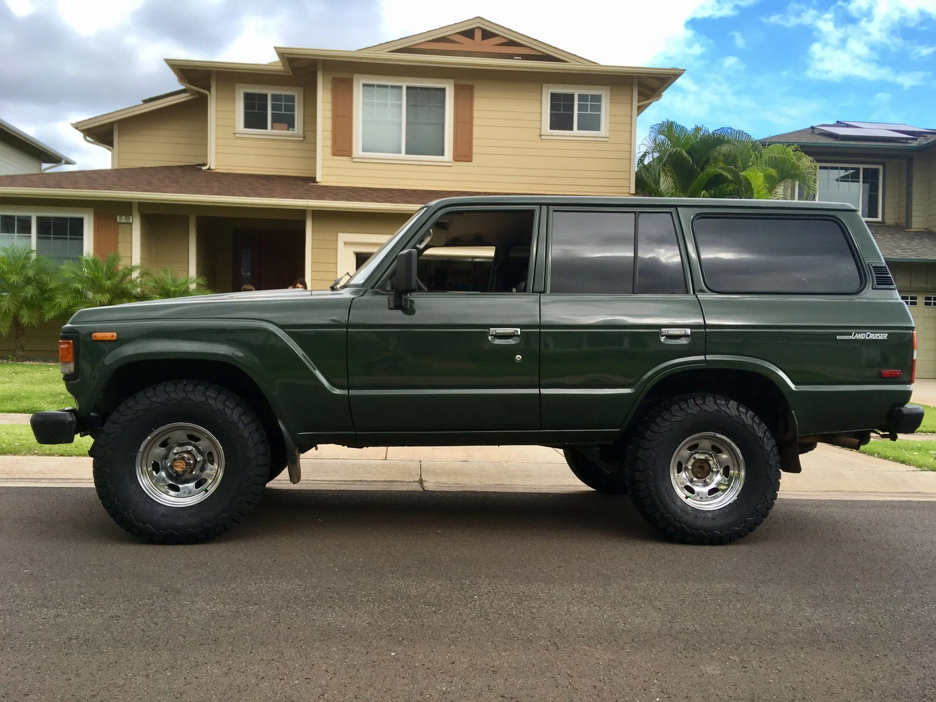

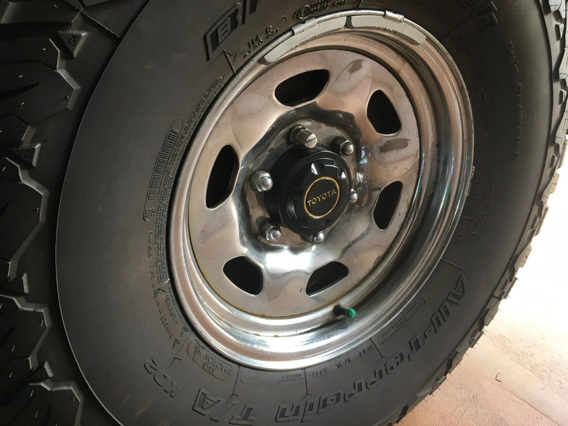

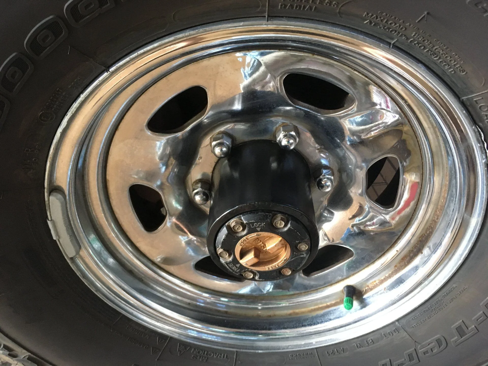

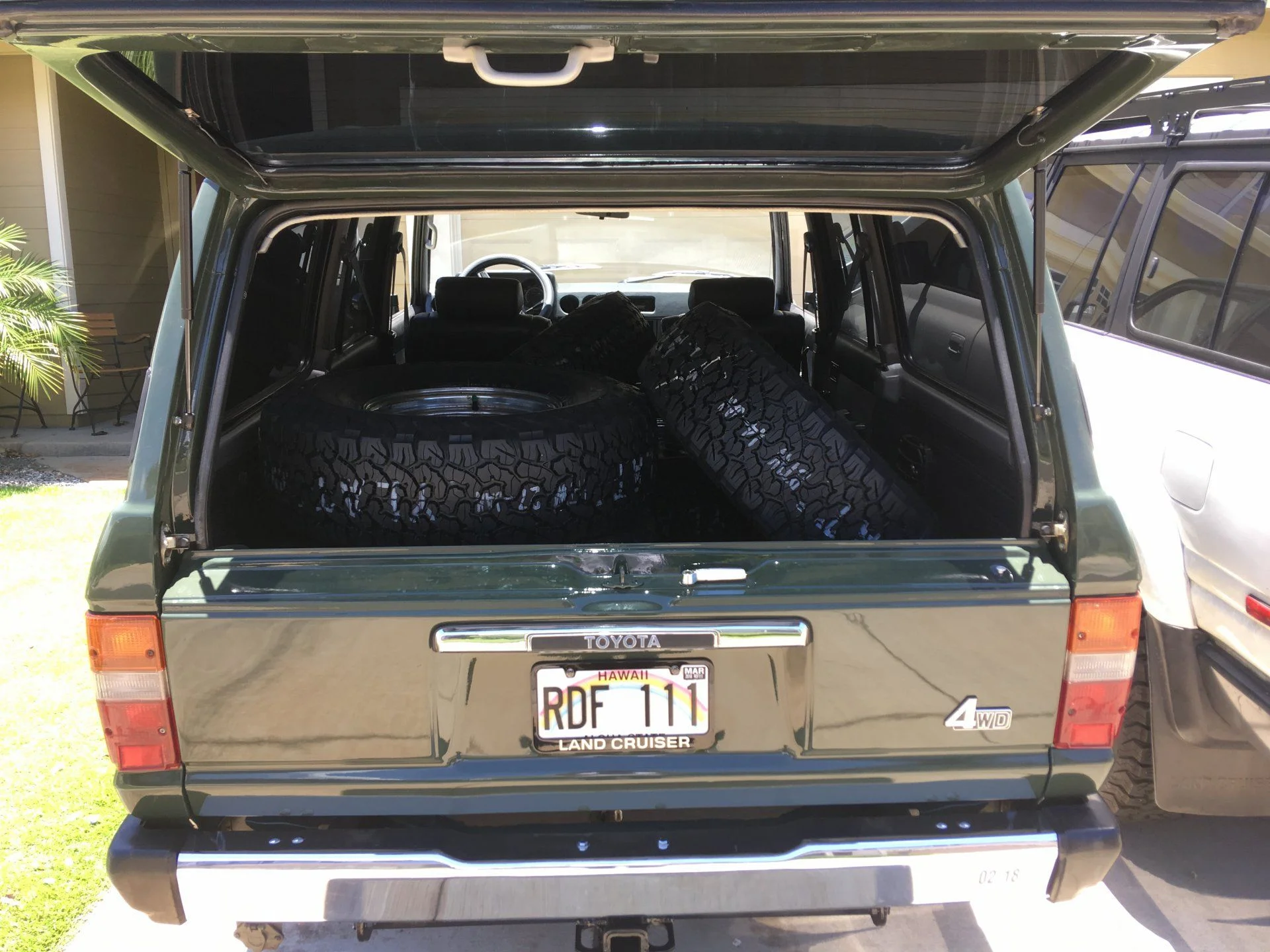

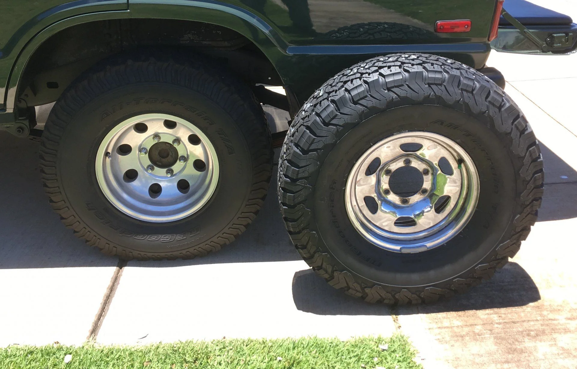

For new tires, we opted to go with the BFG AT 33x10.5x15. We special ordered them through Costco tire center on the msinland. I bring this up because Costco tire center here in Hawaii said they cannot put on those tires because they exceed the factory recommended size. To get around this, some small white lies were utilized for the good of our 60's exterior beauty!
We brought the OEM chrome wheels we recently acquired down to Costco in my lifted 80 series with existing 33" tires. Told them they were going on the 80, but just needed them on the rims. They agreed to do it because the 80 already had 33's. We went back to pick them up in the 60, secretly hoping they knew exactly where they were going to be installed.
We installed all 4 and the spare at home. Also cleaned up and greased the spare tire chain and gear while we had it down.
They look great! Such an improvement over the old aftermarket wheels.
A before and some afters:

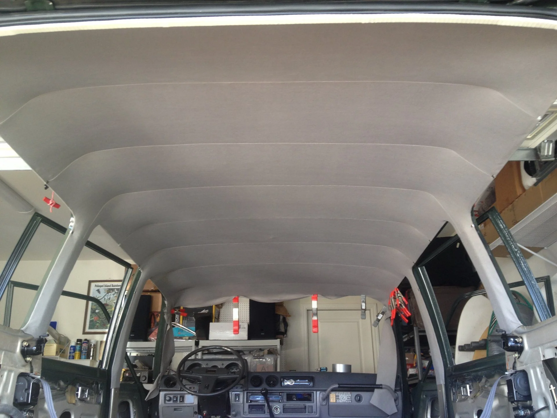

- I am supremely impressed with the headliner work you guys did. THat is a notoriously difficult project and it looks fantastic

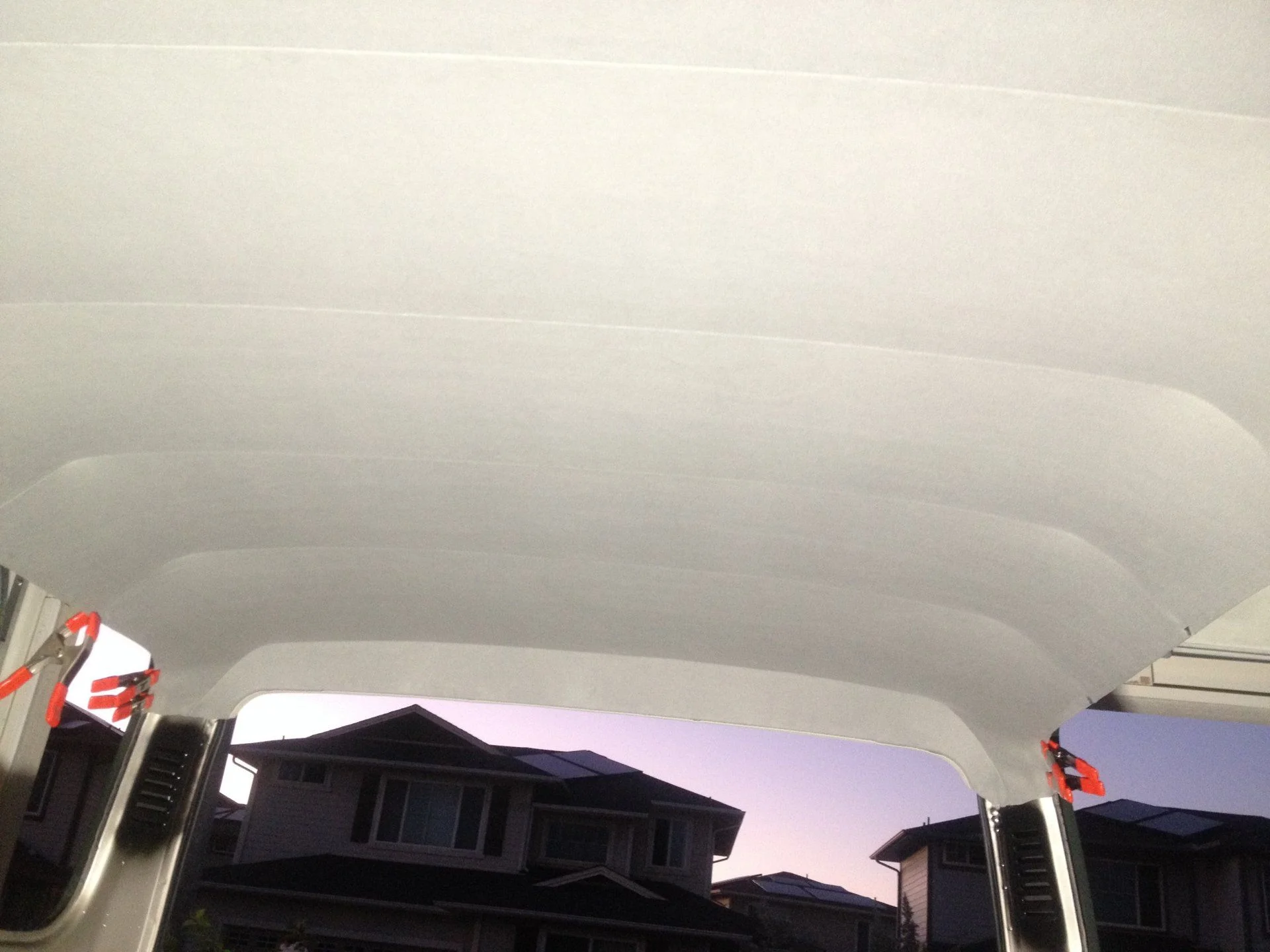

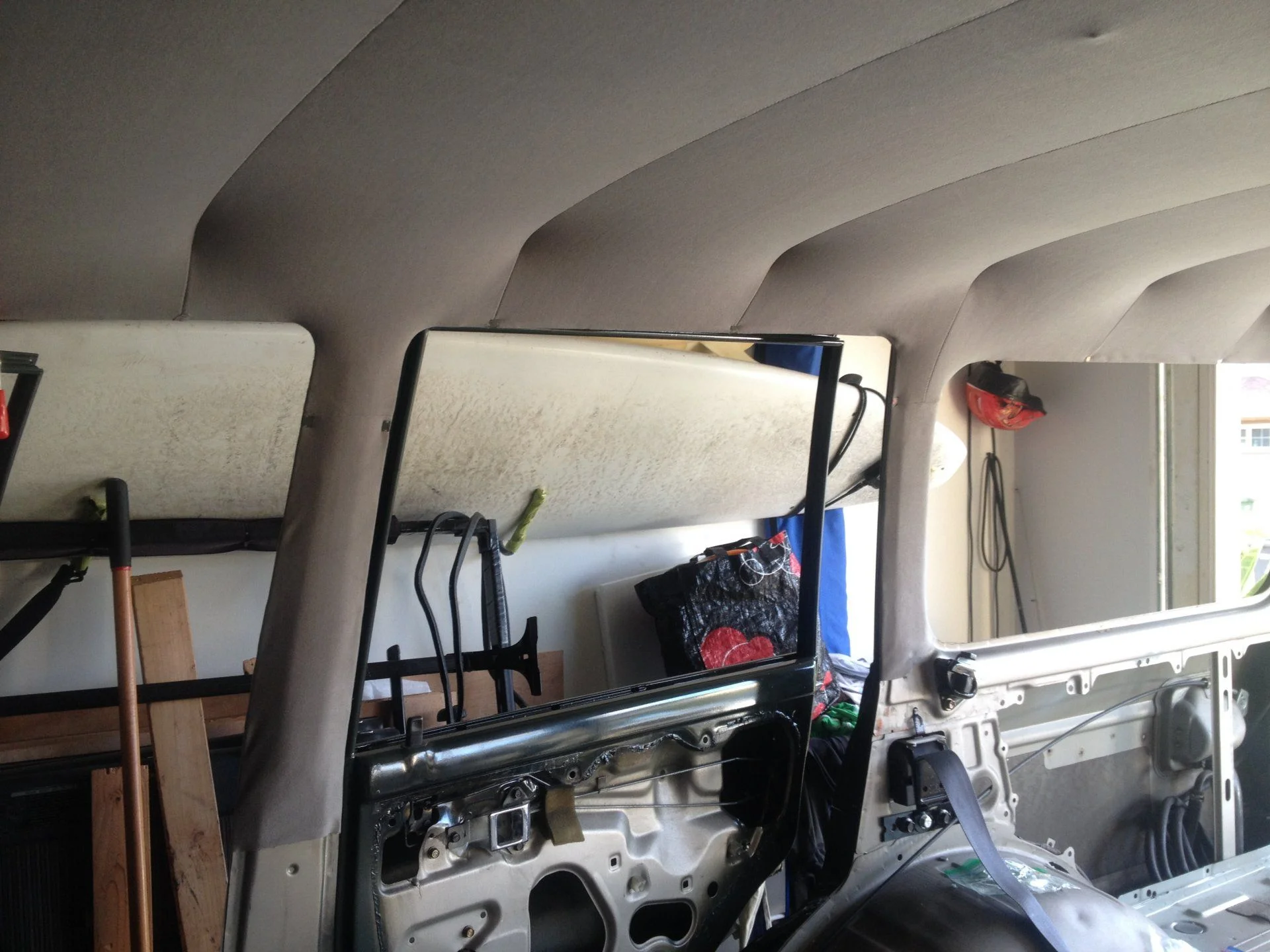

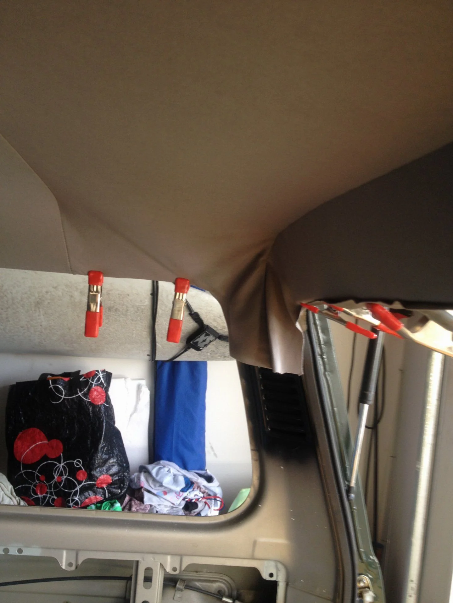

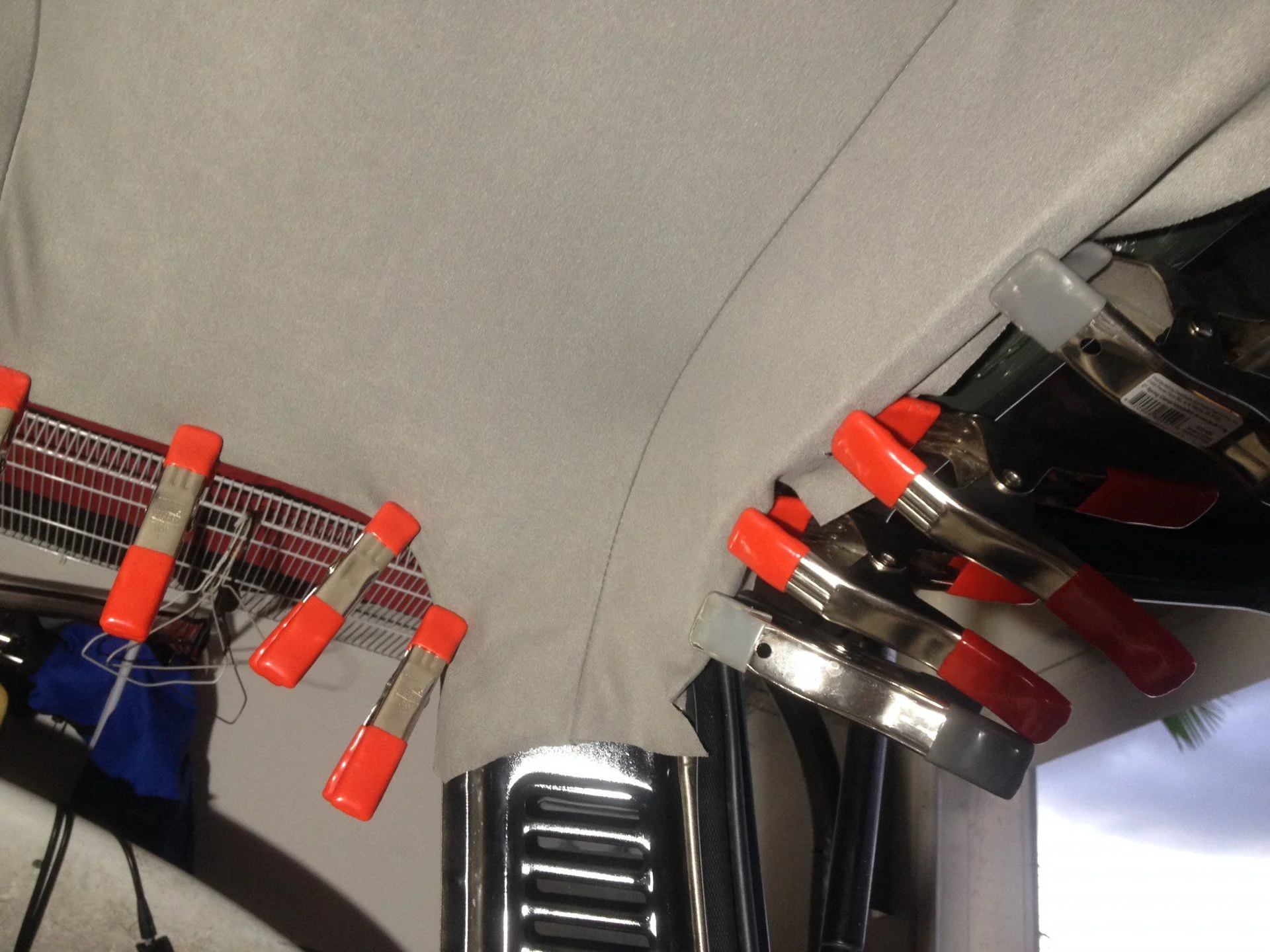

Pull, stretch, repeat....times a thousand! It needs to be worked and worked until all the wrinkles are out.
View attachment 1408527 View attachment 1408528
Success, once the glue sets, it's solid.
View attachment 1408529 View attachment 1408530
Tight like a drum.

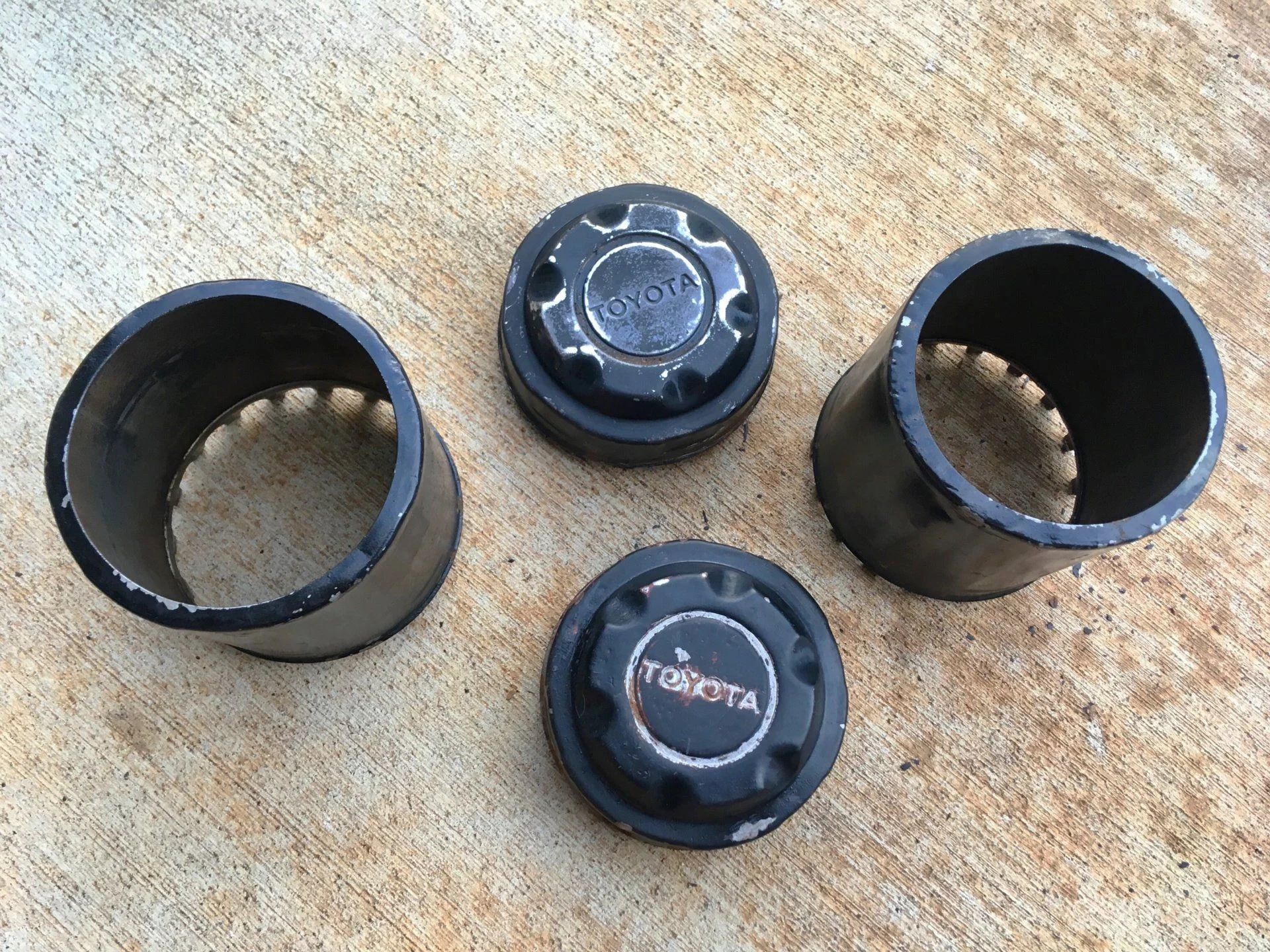

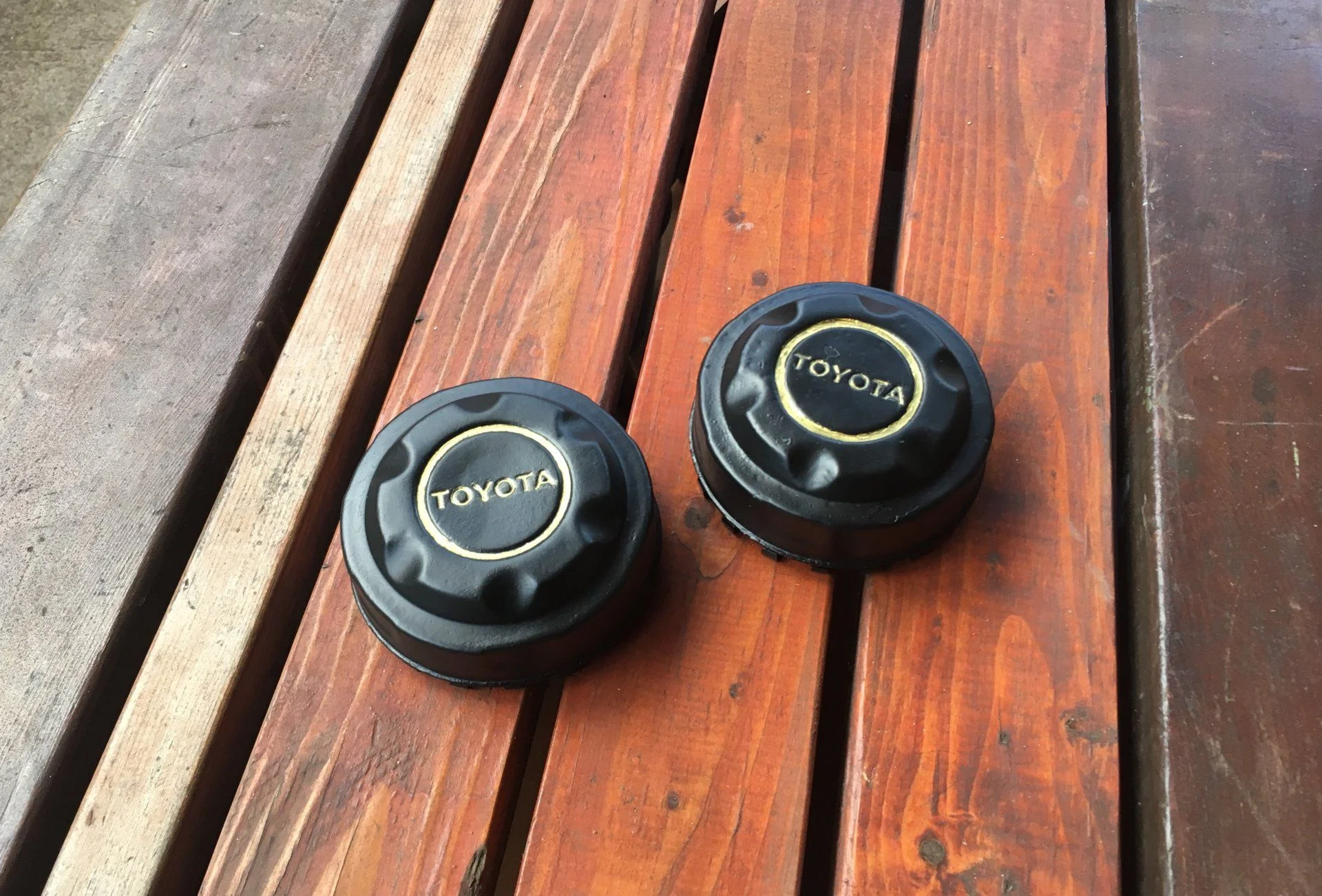

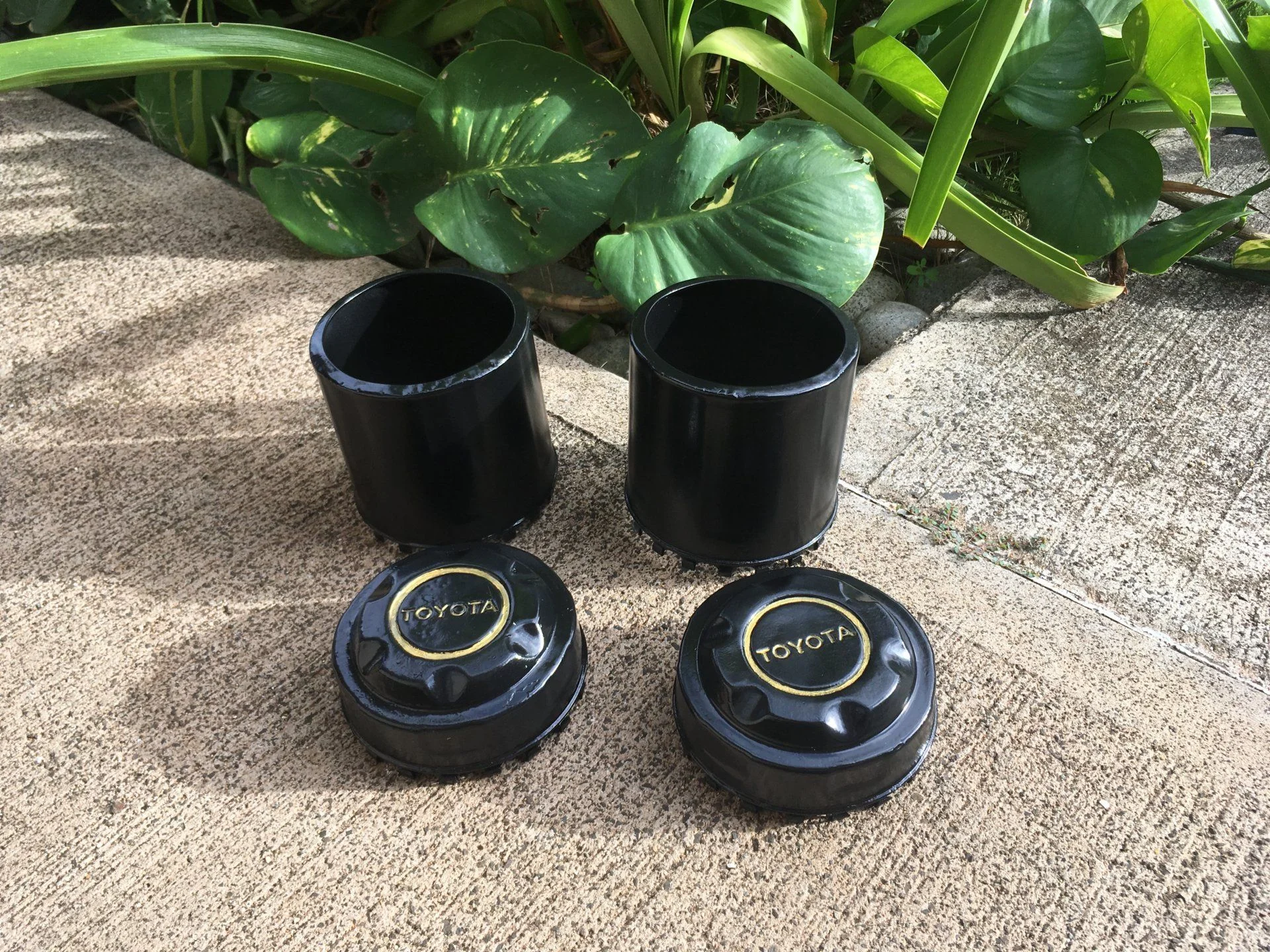

It’s been a while since updating. We recently got to rehabbing the old OEM center wheel caps. They were first cleaned and degreased. Then a couple applications of Navy jelly to remove the rust.
Then they were primed and painted a semigloss black. Followed by a somewhat tedious process of multiple coats hand painted with a tiny brush with gold paint. And then top coated with a matte clear to help protect it all.
They turned out pretty good, but they were pretty beat up to begin with and it proved to be pretty hard to keep a steady hand with the tiny gold letters! But pretty happy with the end result.

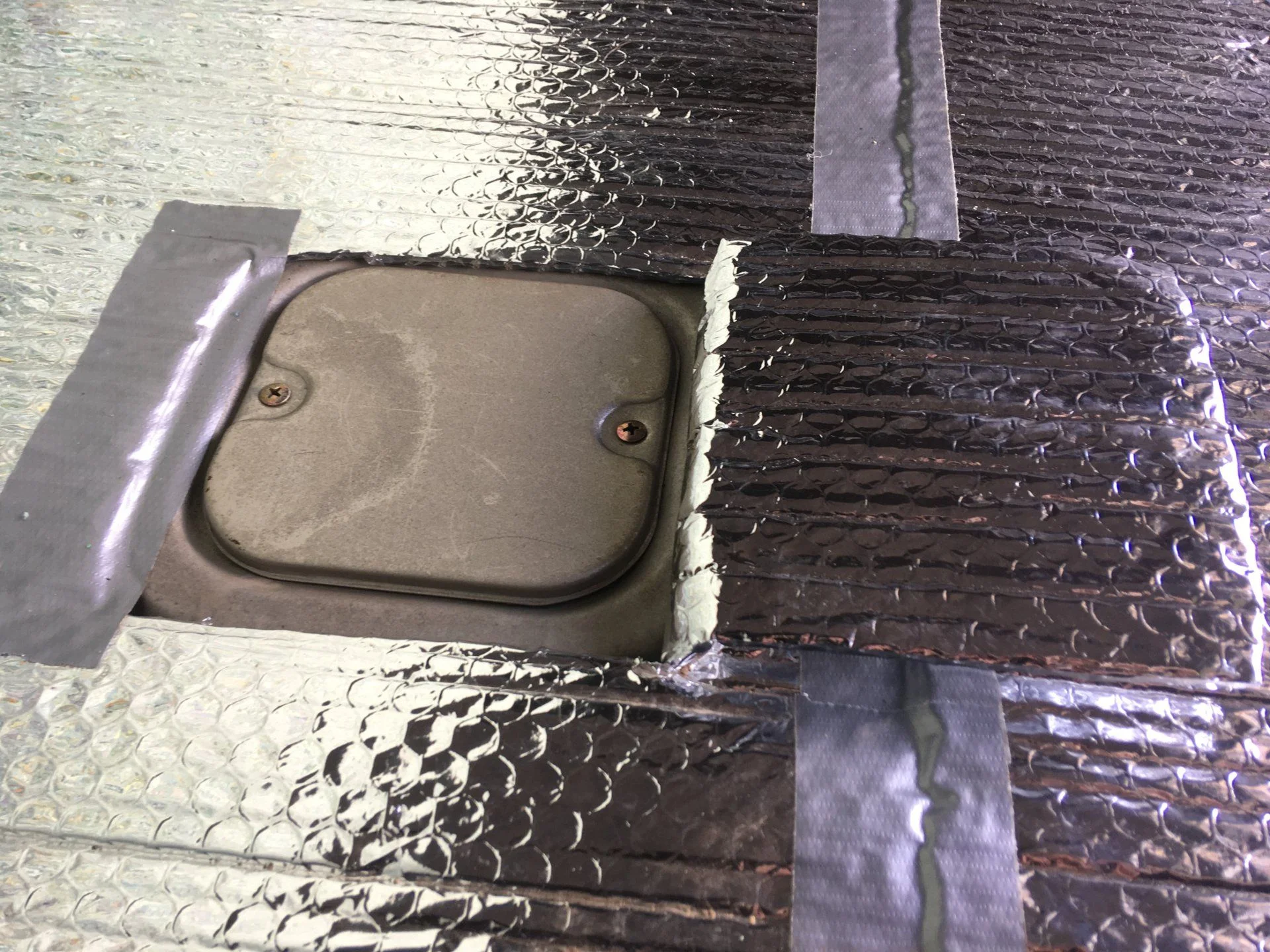

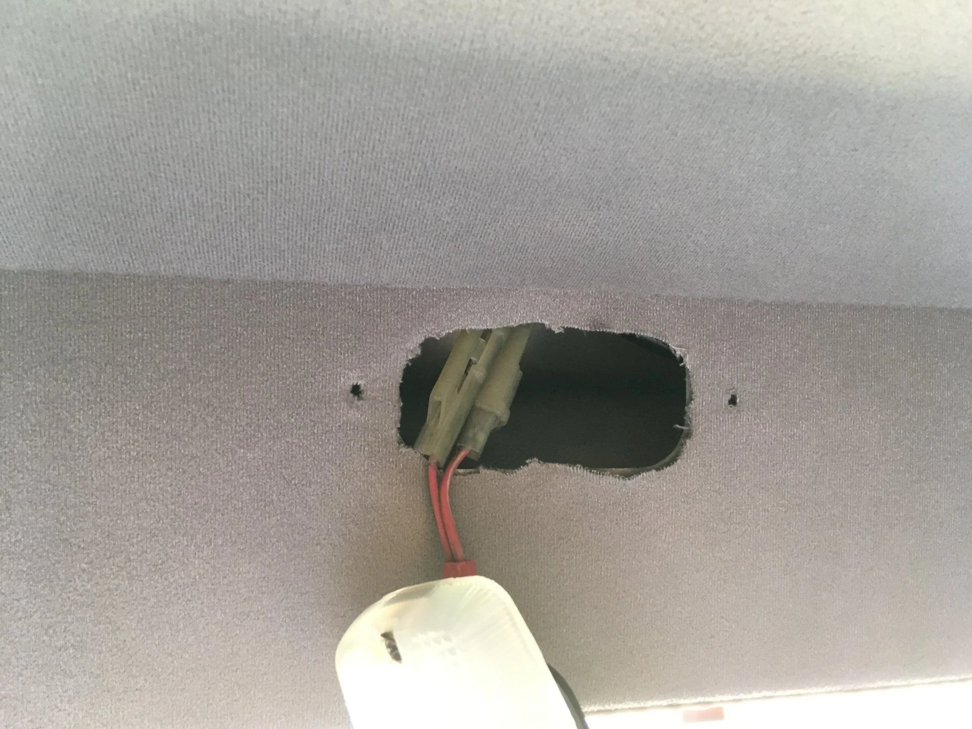

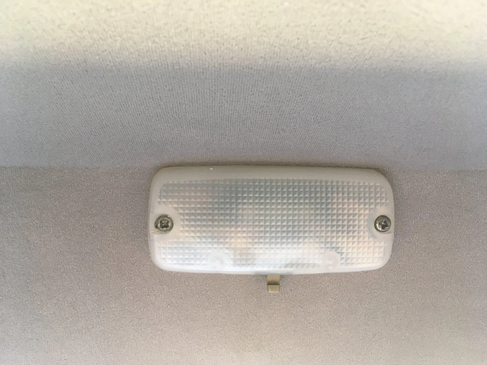

A few more interior cosmetic additions/upgrades that were finished up. The rear cargo light took painfully long to install as it was psychologically difficult to slice into a perfectly stretch headliner. But cuts were made and holes were poked to put in the old rear cargo light that was cleaned and polished with some rubbing compound. Really help to clean it up.

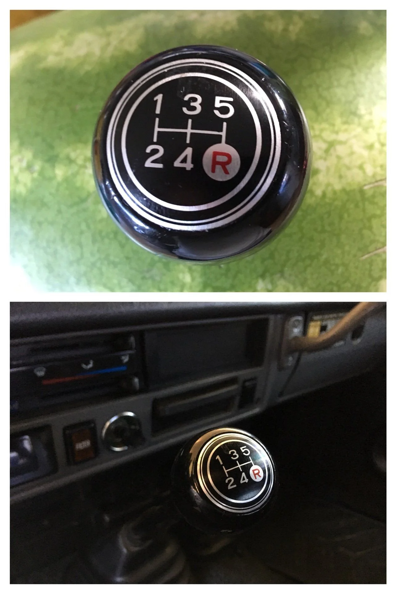

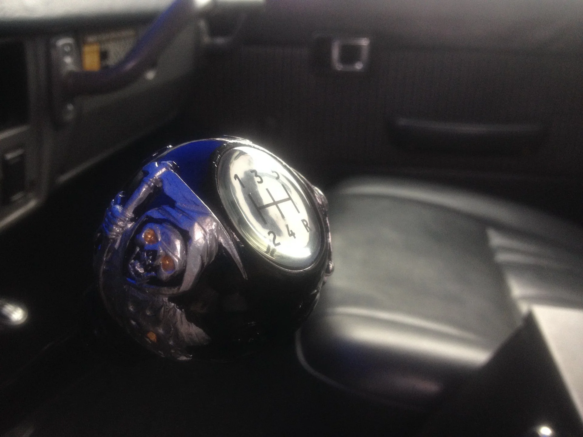

Then got rid of my aftermarket grim reaper shifter handle for some OEM goodness.
Used my old shifter handle that had long ago lost its top cap. Got a fresh new 5 speed top cap and glued it down to the cleaned and polished handle.
Looks pretty good, but more so one step closer to getting back to a more stock/original looking interior.

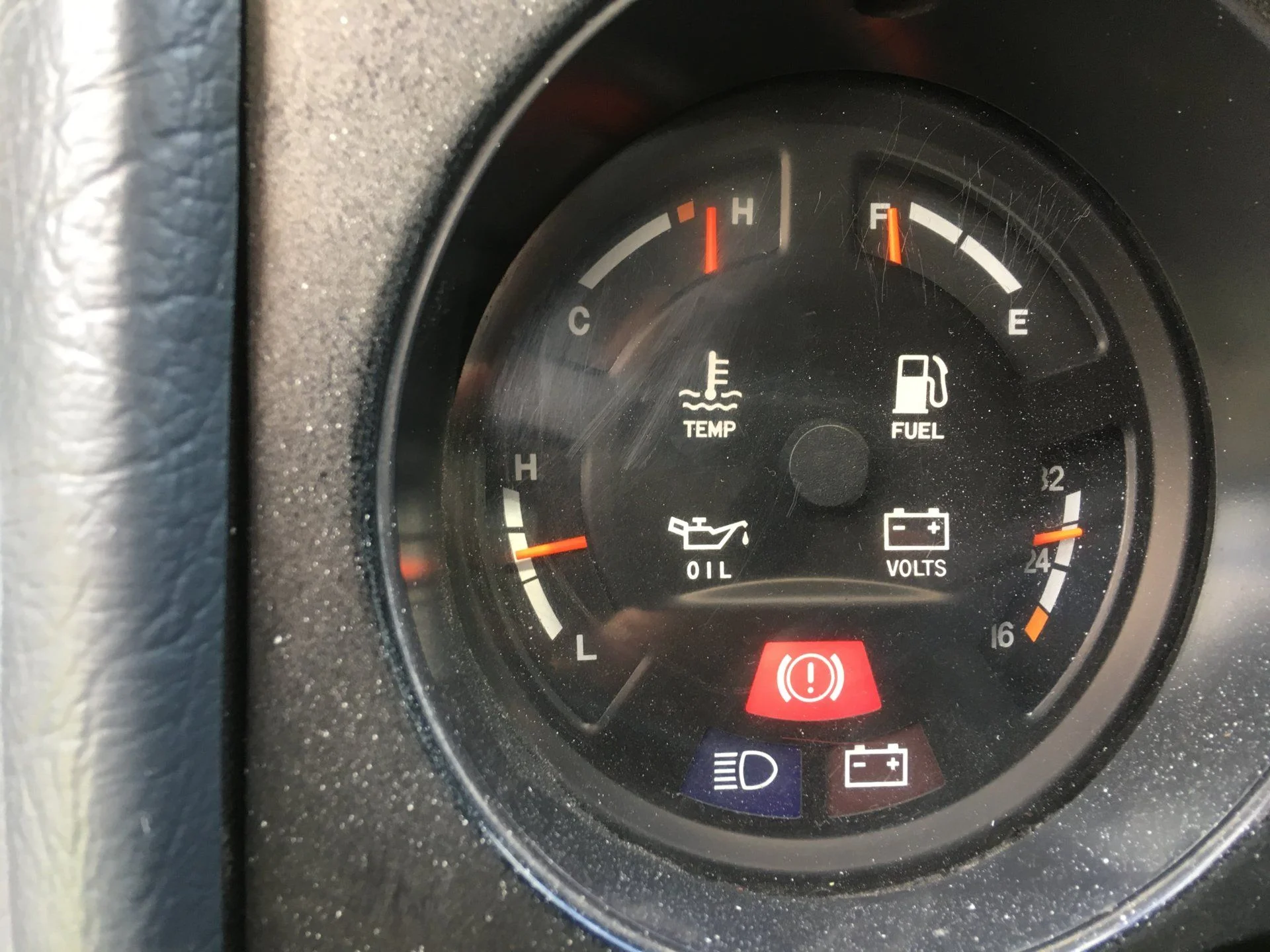

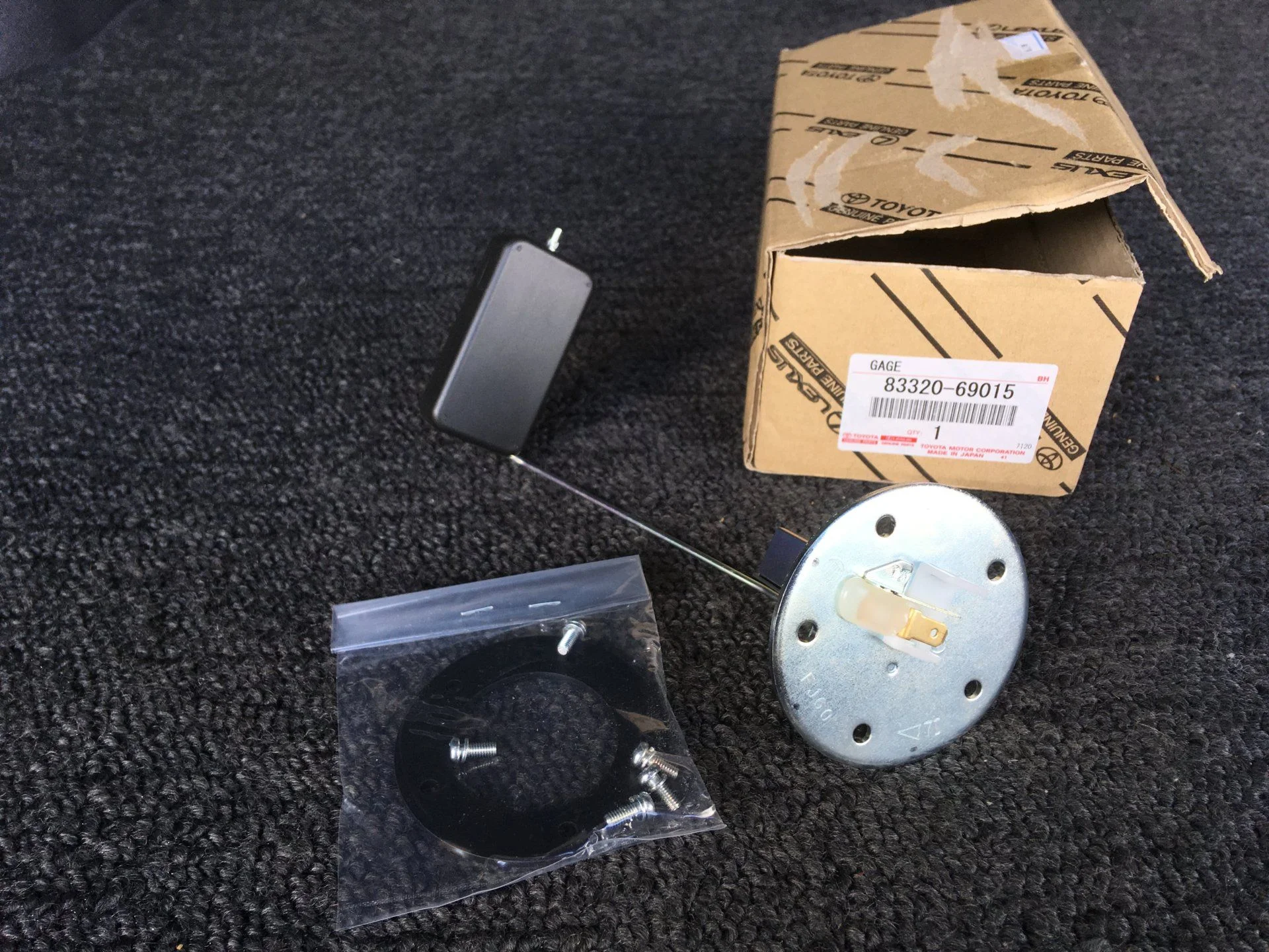

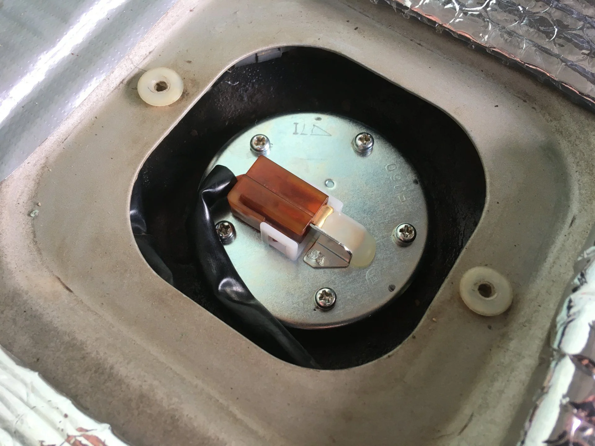

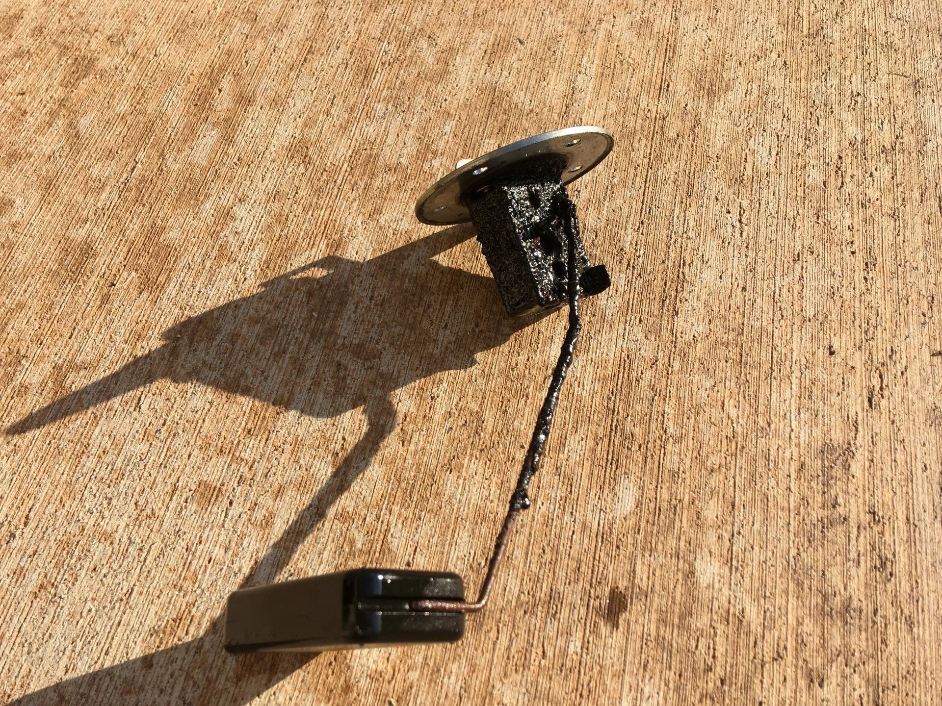

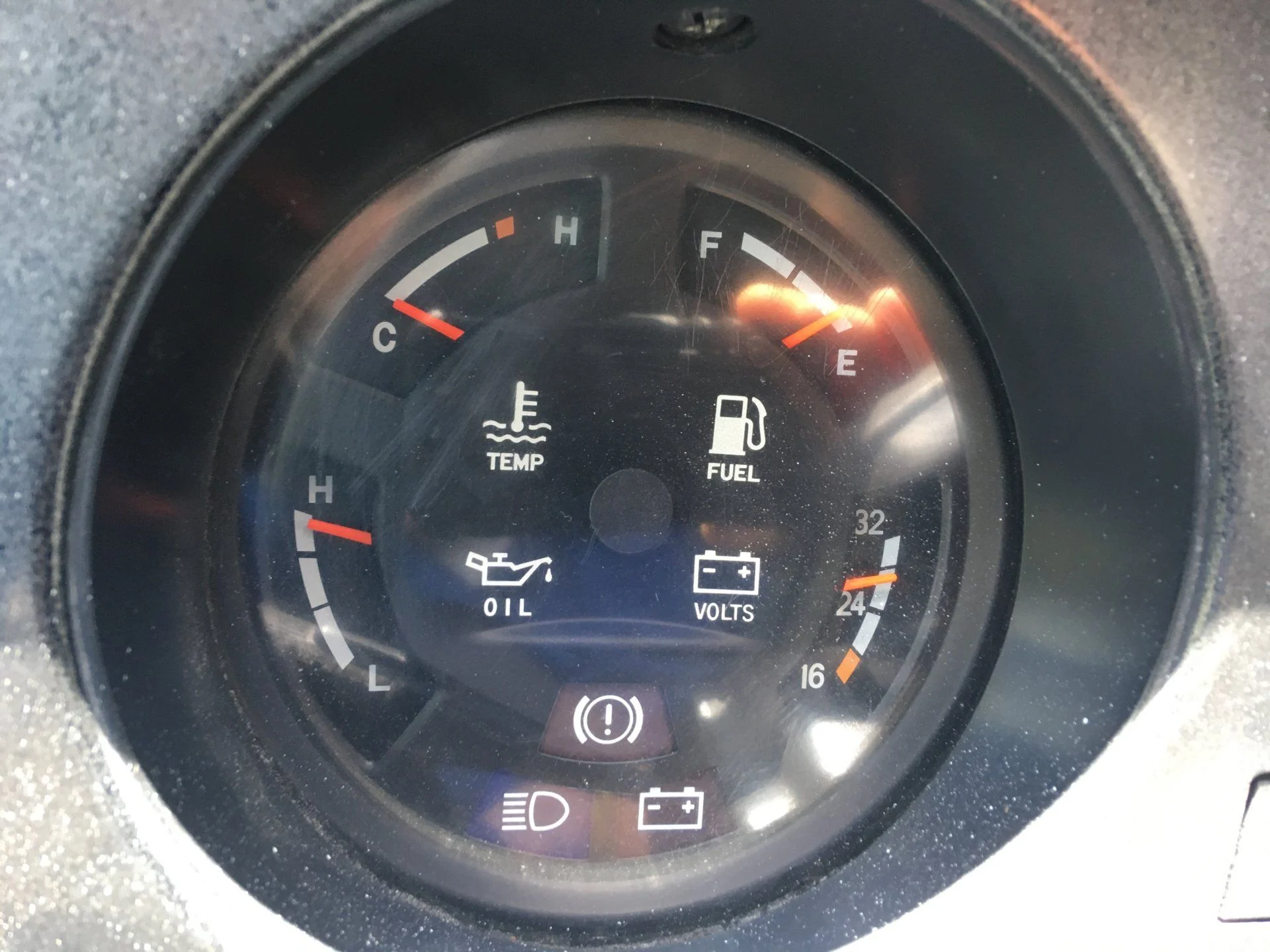

In addition to the cosmetic fixes, there has been a few mechanical updates as well. One of them has been finally to fix the crazy fuel/temp gauge spikes that had started happening nearly every time driving the 60.

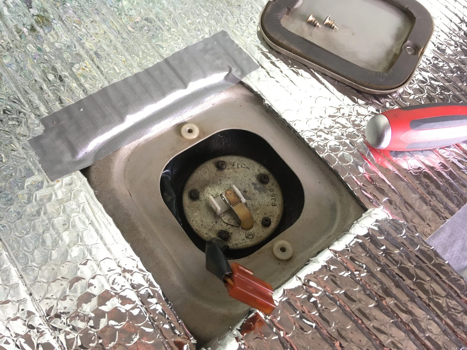

Research on this forum pointed to the problem being on the dash gauge cluster, primarily the fuel gauge contacts and or the dash fuel gauge itself going bad. But there was some hesitation about taking the main gauge cluster off and apart, as well as disconnecting speedometer cable and all the other electrical dash gauge connections. The dash fuel gauge did some other wonky fluctuating stuff, so the decision was made to start with the easy stuff, and first check the fuel level sender gauge in the rear cargo area. We left a little access cut out in our insulation during our interior refresh in anticipation of this future checkup.
This disgusting mess was pulled out of there!
Even if this wasn’t the problem with the dash gauge spikes, we still knew it needed to be replaced........
......luckily, Toyota still makes this fuel level gauge. Comes in a little kit that contains the gauge, rubber gasket and shiney new screws. Below is the part number for reference.
Got it installed and the connecting wire contact cleaned up and plugged in.
After the first drive with the new gauge installed, the dash gauge did this weird downward spike in the opposite direction to the bottom, then a few seconds later went back to normal gauge readings for the fuel and water temps. It’s been several hundred miles now and fuel and temp gauges read normal on every drive now. We are hoping this is a fix to the gauge spikes, but will report back if this fuel level sensor replacement doesn’t fix the dash gauge spikes and they return.

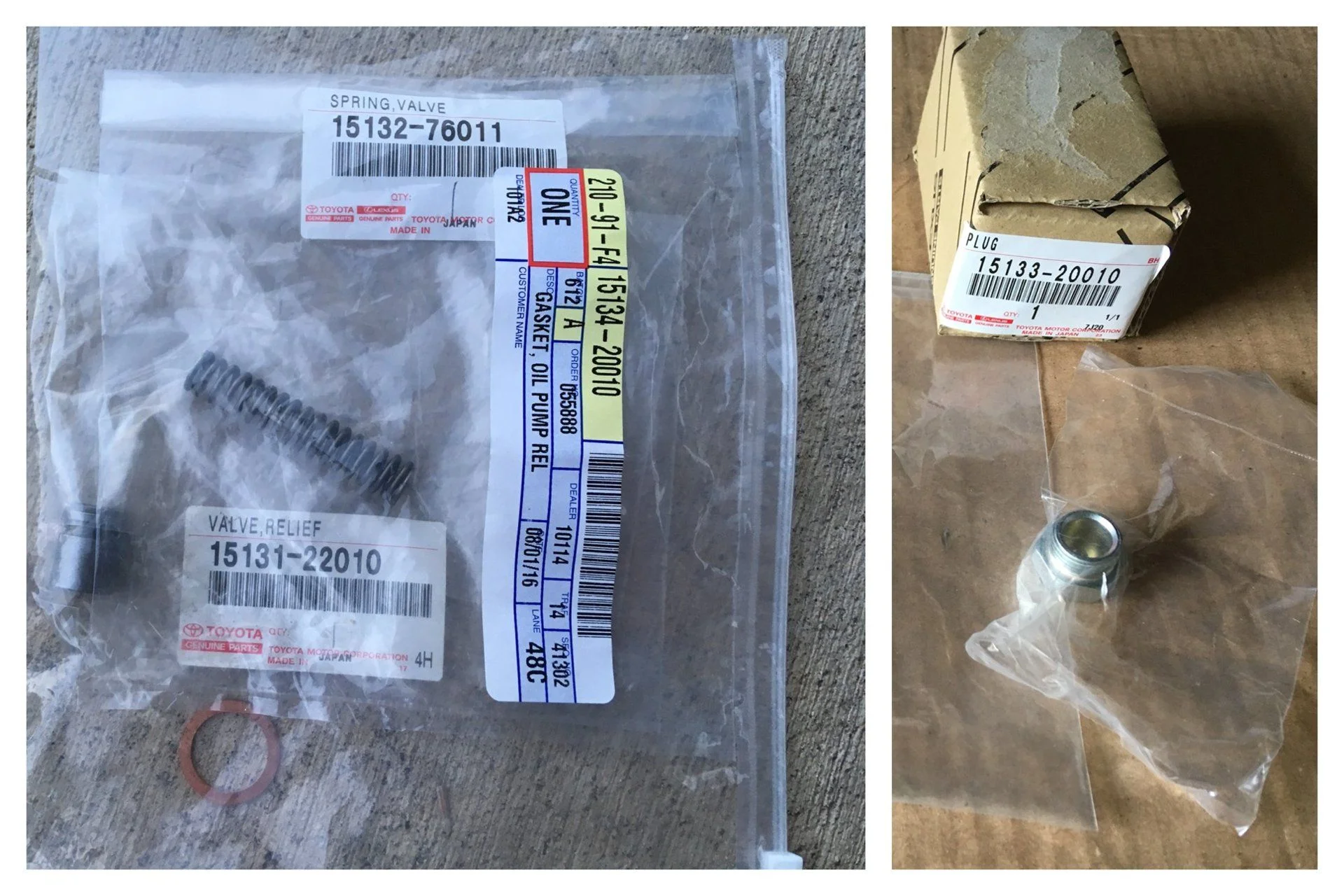

Along those same lines, but most likely unrelated were some high oil pressure readings on the oil pressure dash gauge.
I believe this may be specific to Toyota Diesel engines, but the suggestion for this fix was the replacement of the oil pressure relief valve. Again, lucky Toyota still makes these obscure little parts, but here are the numbers for reference:
Out with the old...
And in with the new. Now dash oil pressure readings are back down to normal readings.
