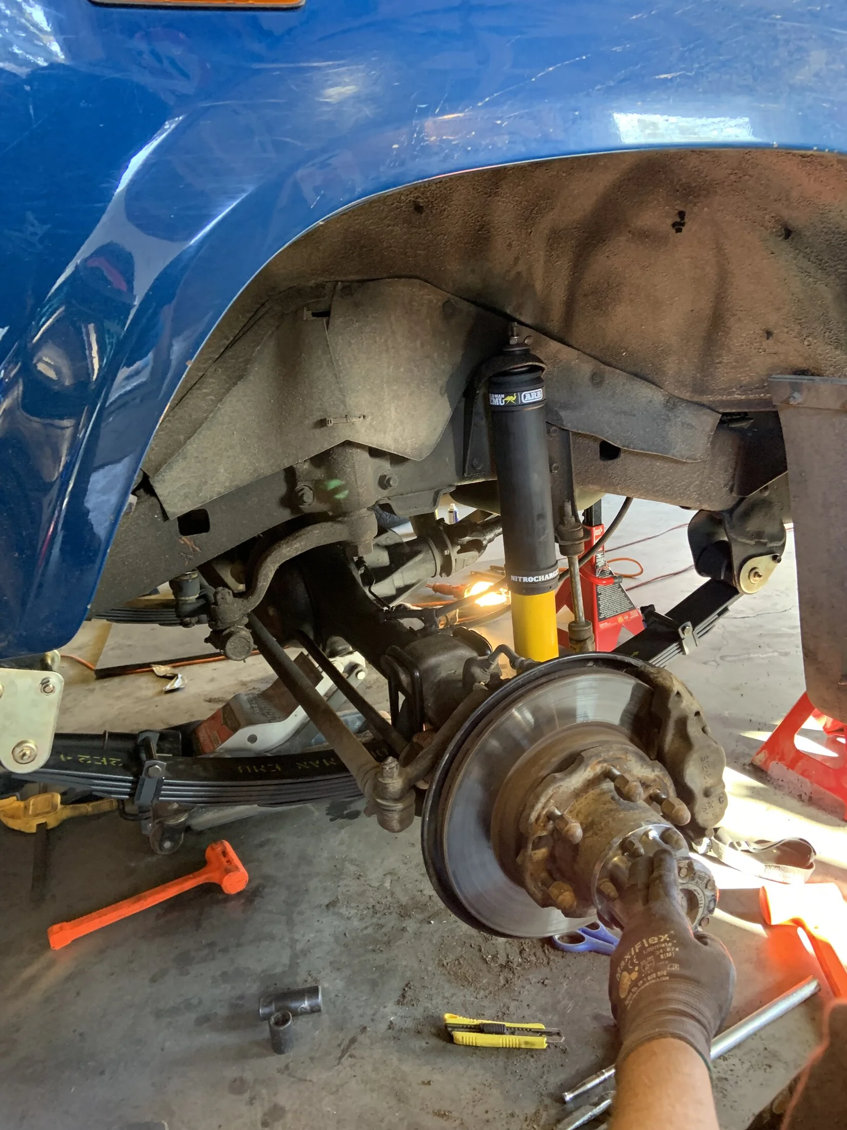

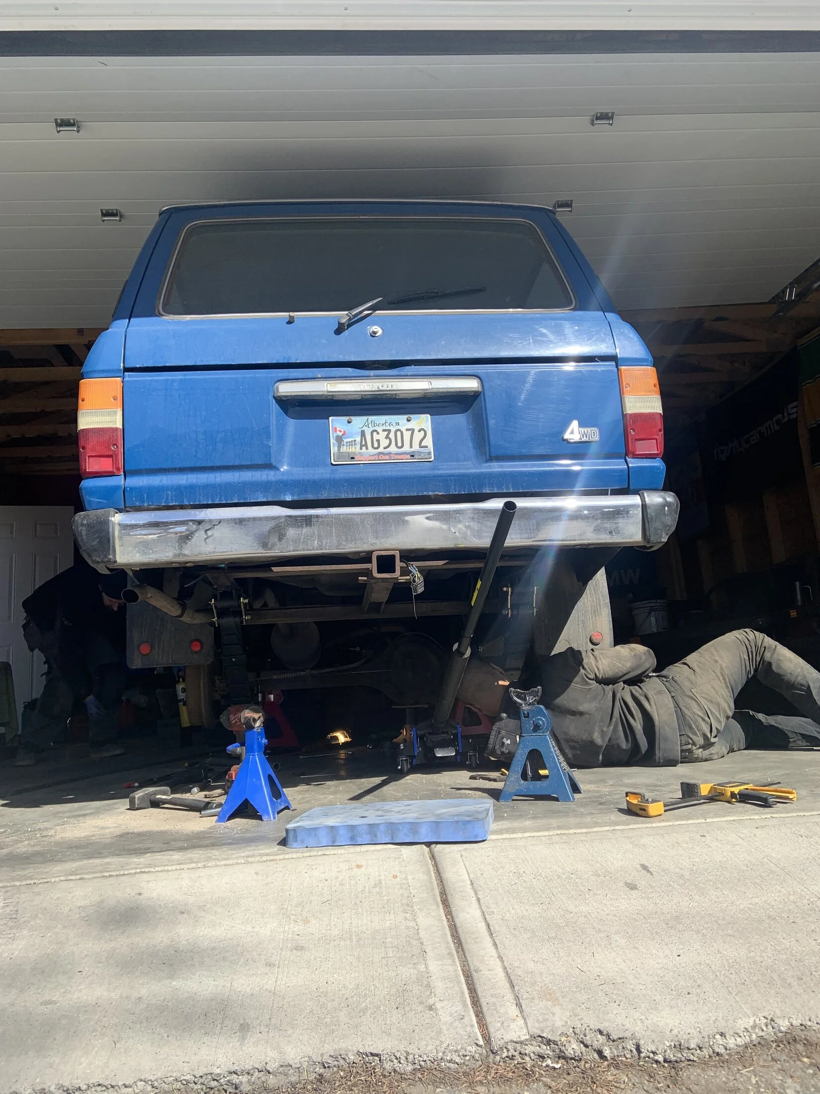

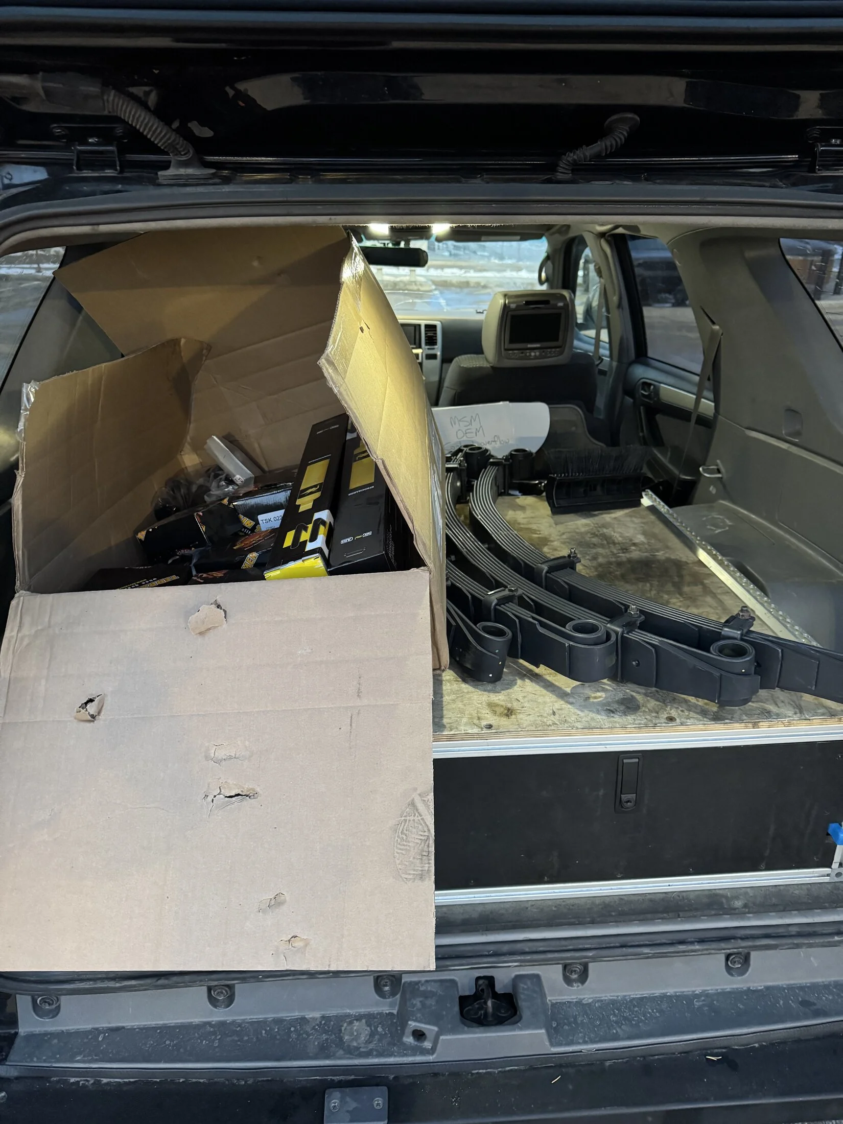

Saturday was a big day!
Called some buddies up and had a small army of workers decend on the truck to swap out the suspension.
I didn’t get as many photos as I should have, but we were hustling for 10 hours straight with only a small break for some alley BBQ smokies.

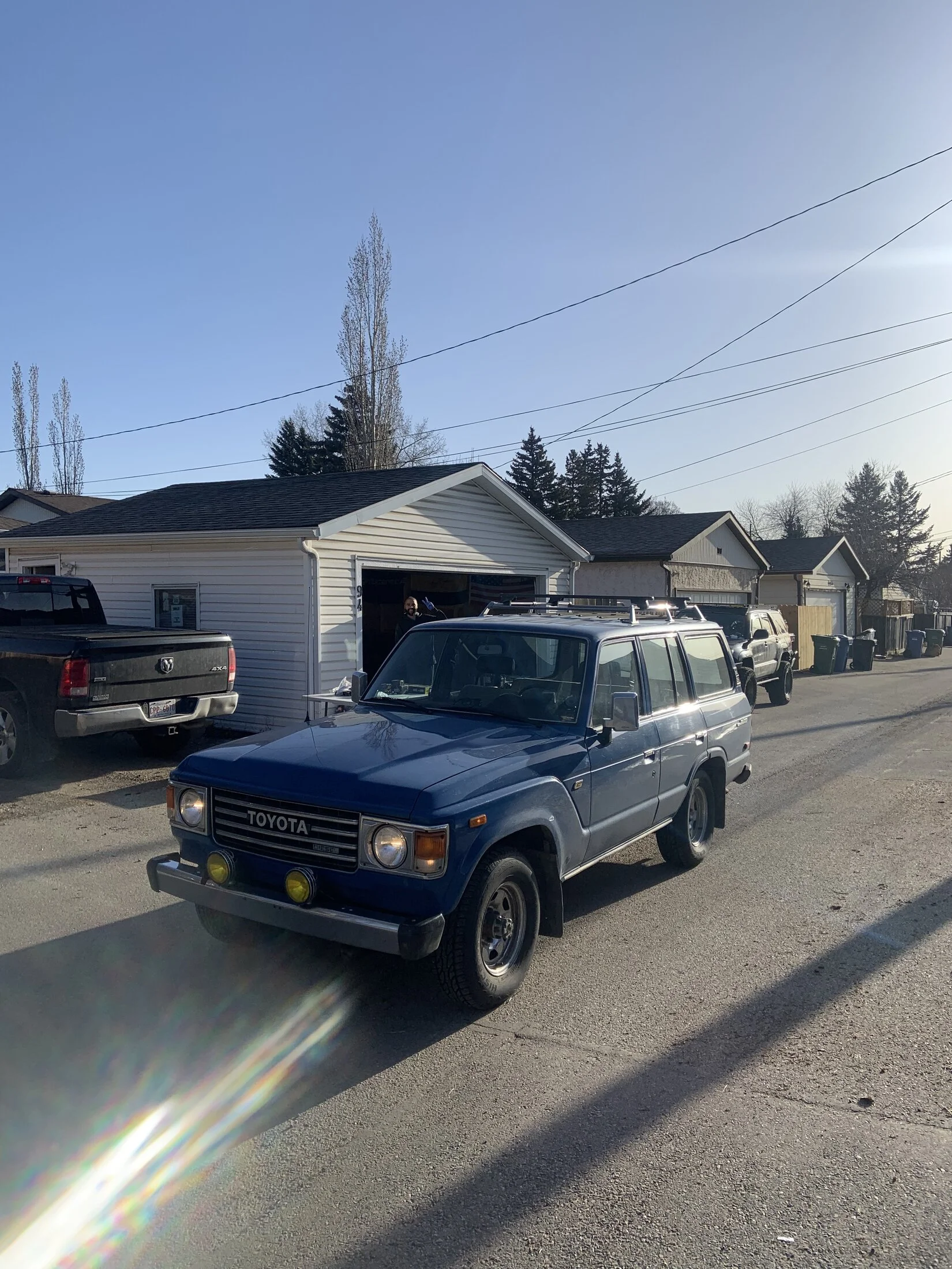

Before of the ride height
Laid out all the parts on a table and double checked everything was there. Once that was confirmed we got to cracking nearly all the nuts and bolts for the suspension pieces.

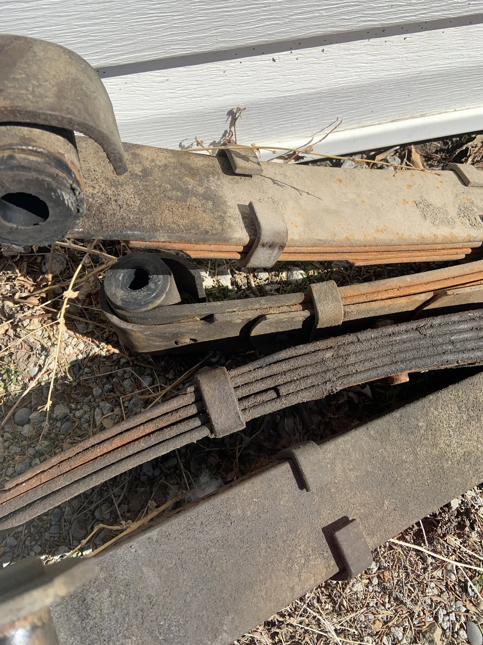

The rear was a bit of a struggle due to the lower damper mounts taking some rocks to them over the years, so they needed some loving. As well, the threaded sleeve that the damper mounts to on the bottom can be sketchy if you snap off a bolt in there so we were extremely cautious.
Luckily everything came apart relatively well on the rear. Once we greased up all the bushings and applicable assemblies, we bolted everything loosely to the truck. The drivers side rear shackle kept inverting to the wrong side when we would lower the axle. We lost about an hour trying to solve this with various straps and tension on different places on the axle and some manoeuvring of the suspension. With some manipulation of the axle we managed to straighten up the shackle and have it settle into the proper orientation once the weight was settled on the leaves. We managed to salvage more of the rubber that went on the U-Bolt plates and gave them some grease to lubricate everything for another 30 years.
We also took out the grease nipple on the driver shafts to allow them move more while manipulating the axles. Then we just disconnected them at one point to get more freedom.
We then attacked the front with minor issues. The threaded top of the old dampers was so rusted out and thin that they both snapped right off when we tried to unscrew them.
The drivers side U-Bolt plate had taken a massive beating at one point from a rock or something immovable and caused the front lip to bend in. This meant we couldn’t get a socket onto the U Bolt nut properly. So I took some material off with an angle grinder to allow for a socket to be placed on the nut. I’ll see about sourcing another one. But I’m not wheeling hard so I’m not too worry about some of the missing material on the plate.

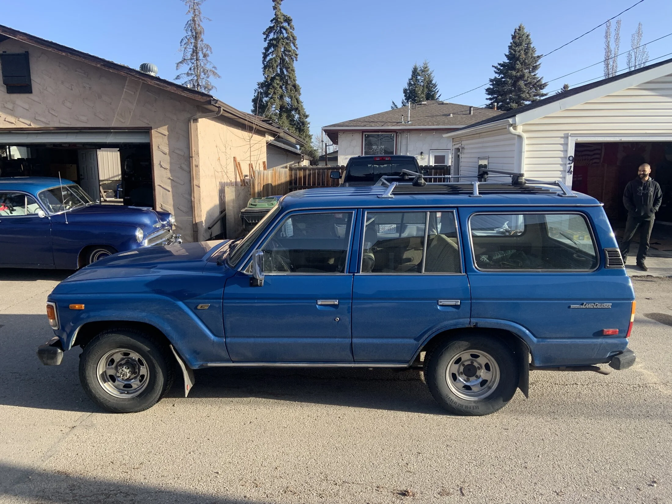

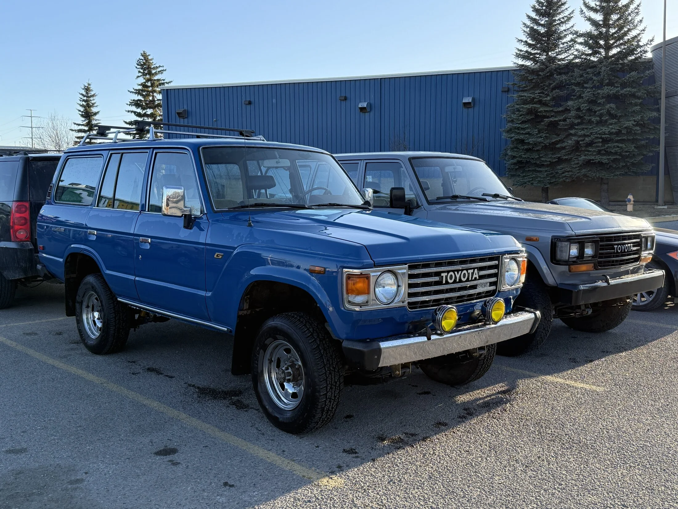

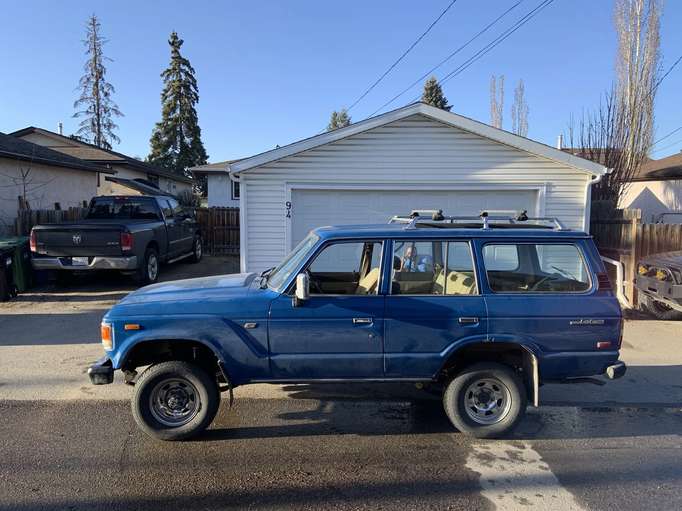

Here are some side by side comparison of the old and new look.
I do miss the low slung wagon look. But I think the handling on the new set up is too good to give up now.
I didn’t get as many photos as I should have, but we were hustling for 10 hours straight with only a small break for come alley BBQ smokies.

Nice work. I think you'll get used to the 'elephant on a skateboard' look soon enough. But some bigger tyres might help.
You can still buy the original front U bolt plates (were the mounting pins for the shocks not rotten away?) for the front axle, and superseded 70 Series plates for the rear axle.

Good to know!
They weren’t mint, but with with some sand paper and a wire wheel on the drill they cleaned up nicely.

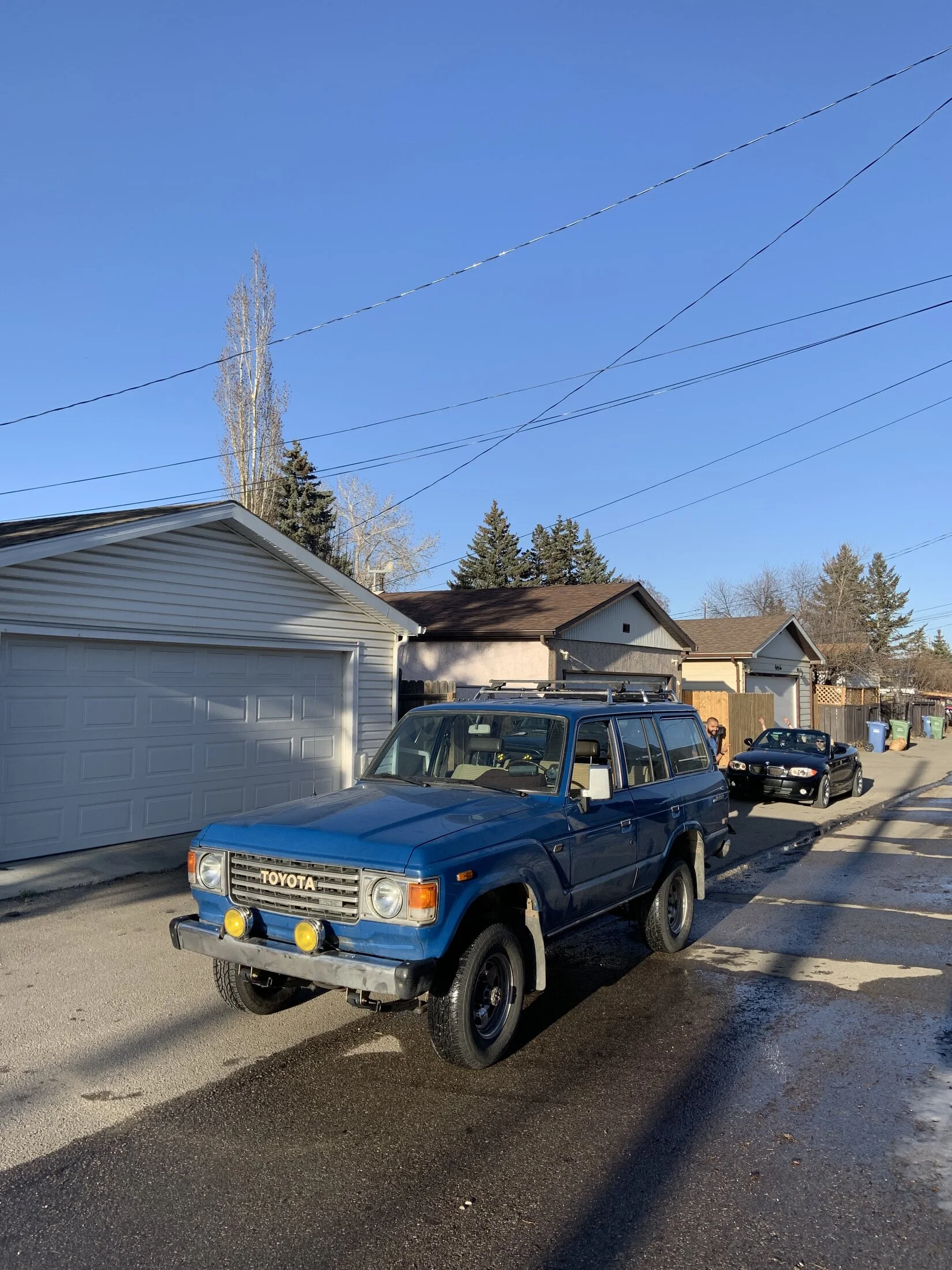

The Land Cruiser passed the Alberta safety inspection.
Ready for insurance and to become my daily driver!

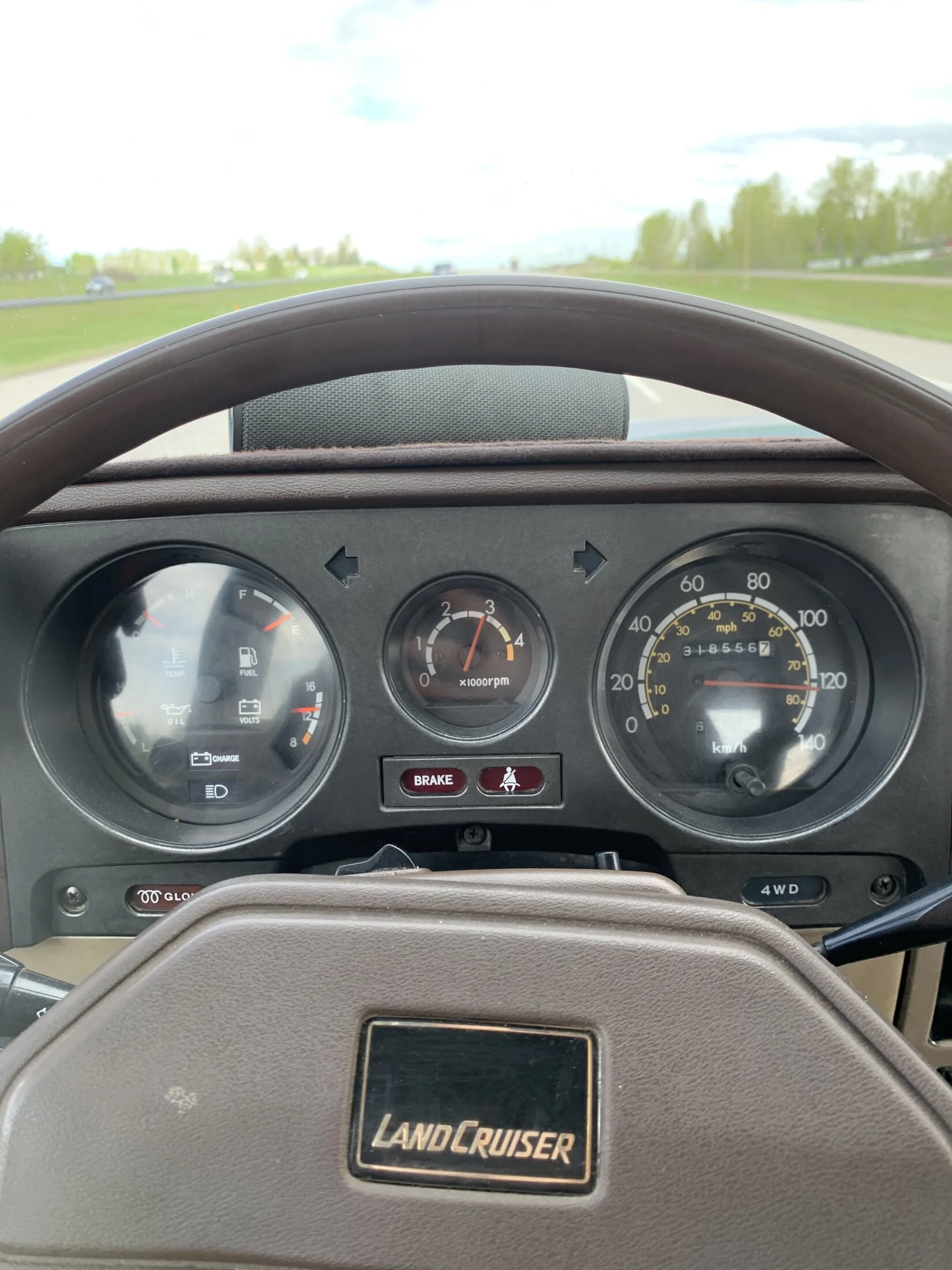

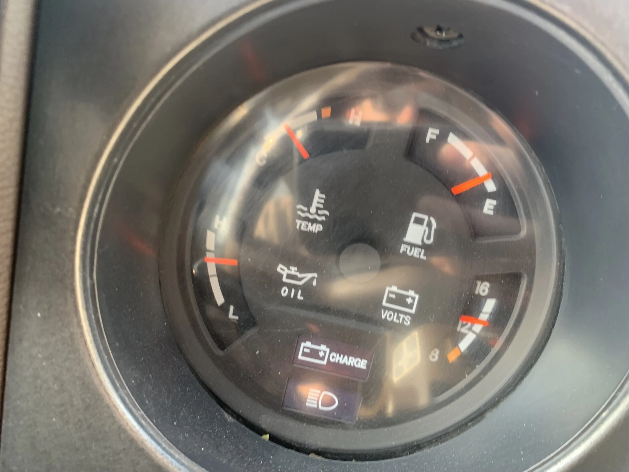

Also, see below if you’re a 3B hater. ;) Cruising speed on highways with the 5 speed is no biggie.
All systems looking great.

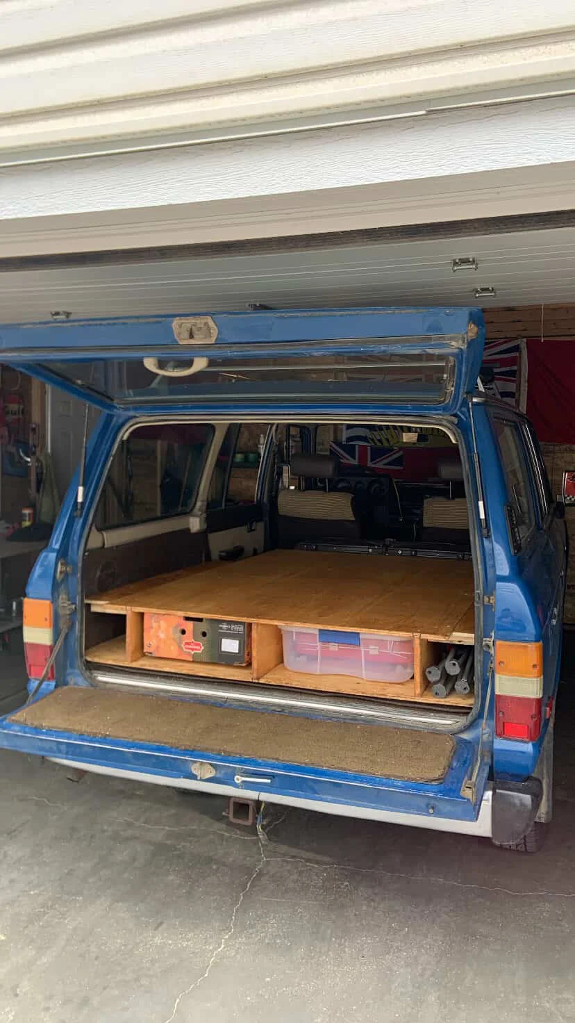

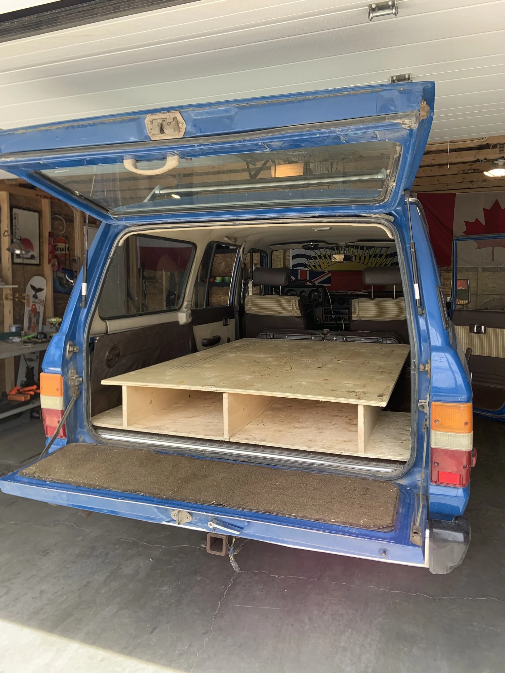

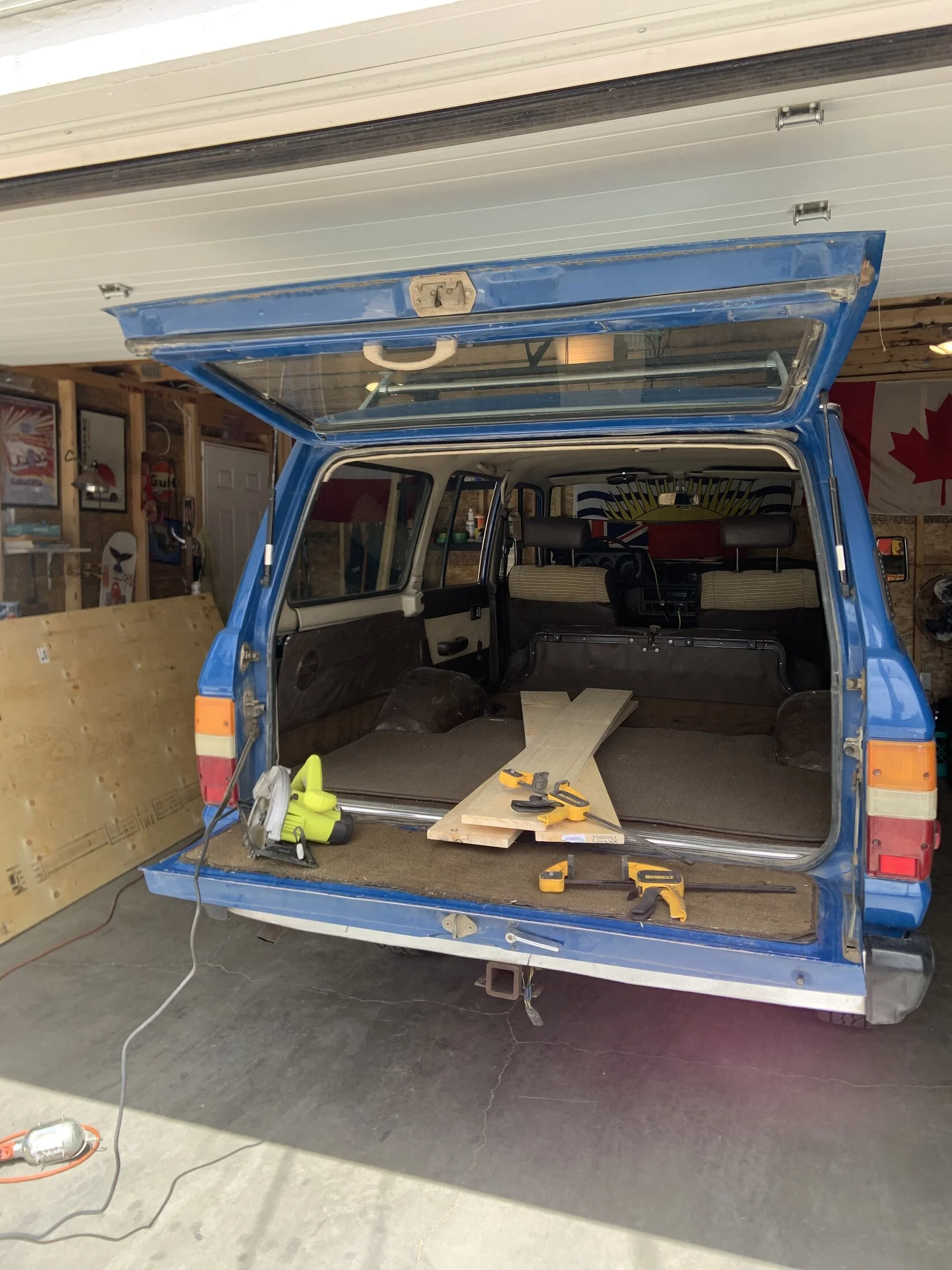

Finally started on my bed platform for my big adventure to Alaska this august!
Used 1/2 plywood for the base, 5/8 for the top part and 3x lengths of 1x8 boards to create the platform.
I also bought some 1x1 boards but never really found a need for them.
Kept the bench seat in due to my move coming up this summer as well and I won’t have a place to store it while I’m moving.
Should look cozy once I have a foam topper on it and create some blinds for the windows!
Thought about cutting the top plywood sheet so it would fit with a better tolerance on the top to each side wall. But I was too lazy to go buy an entire other sheet to ensure it would go across the whole way. I think I have enough spare pieces to build little extensions to fill the gaps if I don’t like how the mattress fills the back!
Added some extra wings to widen the platform for sleeping and had some leftover stain so have it a bit of a more cozy colour!
More to follow once I build out the interior more. Going to trial driving it around in this set to see what rattles.

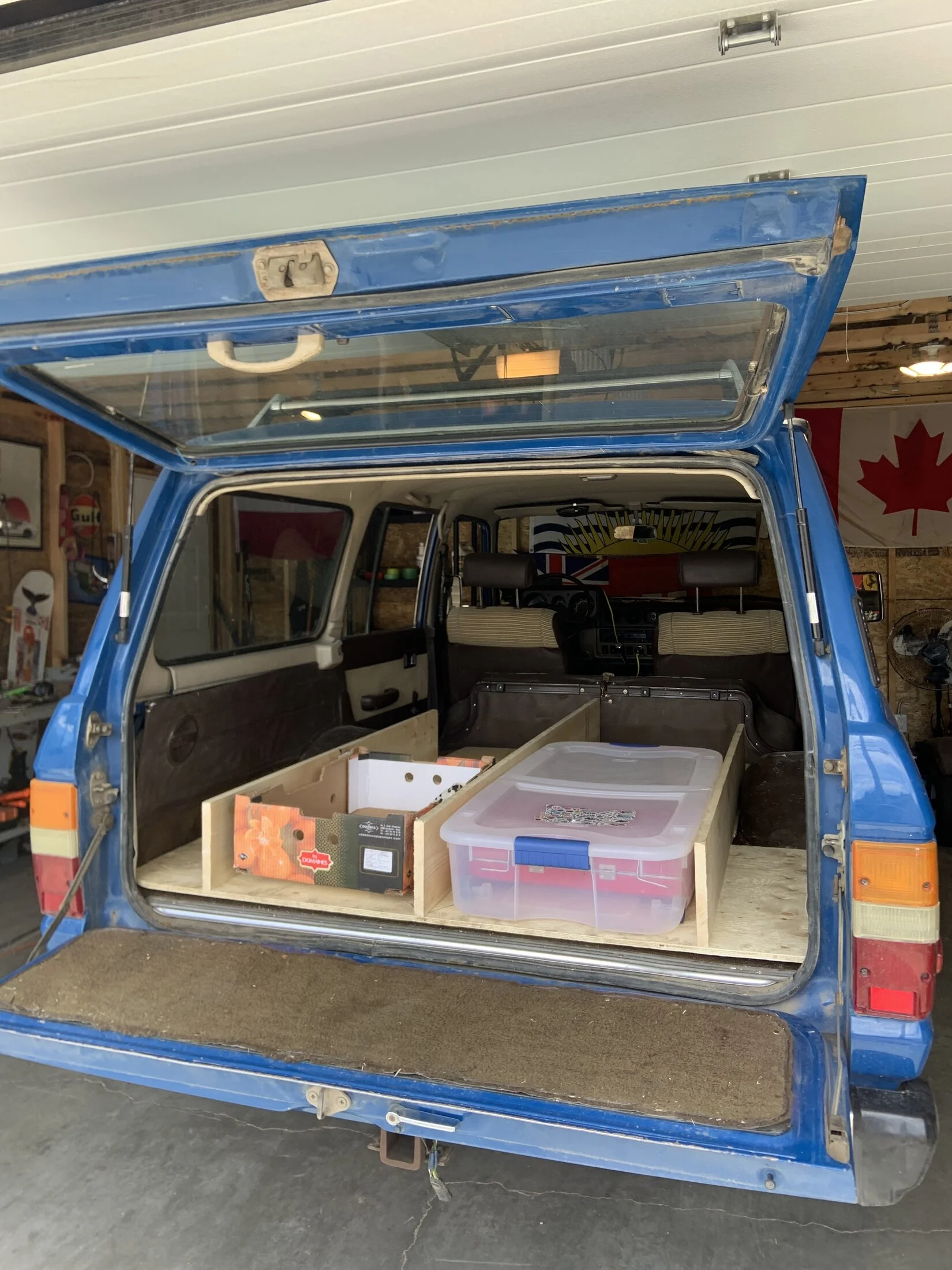

First trial of the sleeping platform was a success!
I for sure need to add blinds, and likely another inch of foam for the mattress. 2” is just not enough.
Otherwise the new suspension held up amazing off-road! We were the farthest campers in the public land use area. No one for miles around. Lots of thumbs up and smiles as people saw me trundling my way down the River bed!
