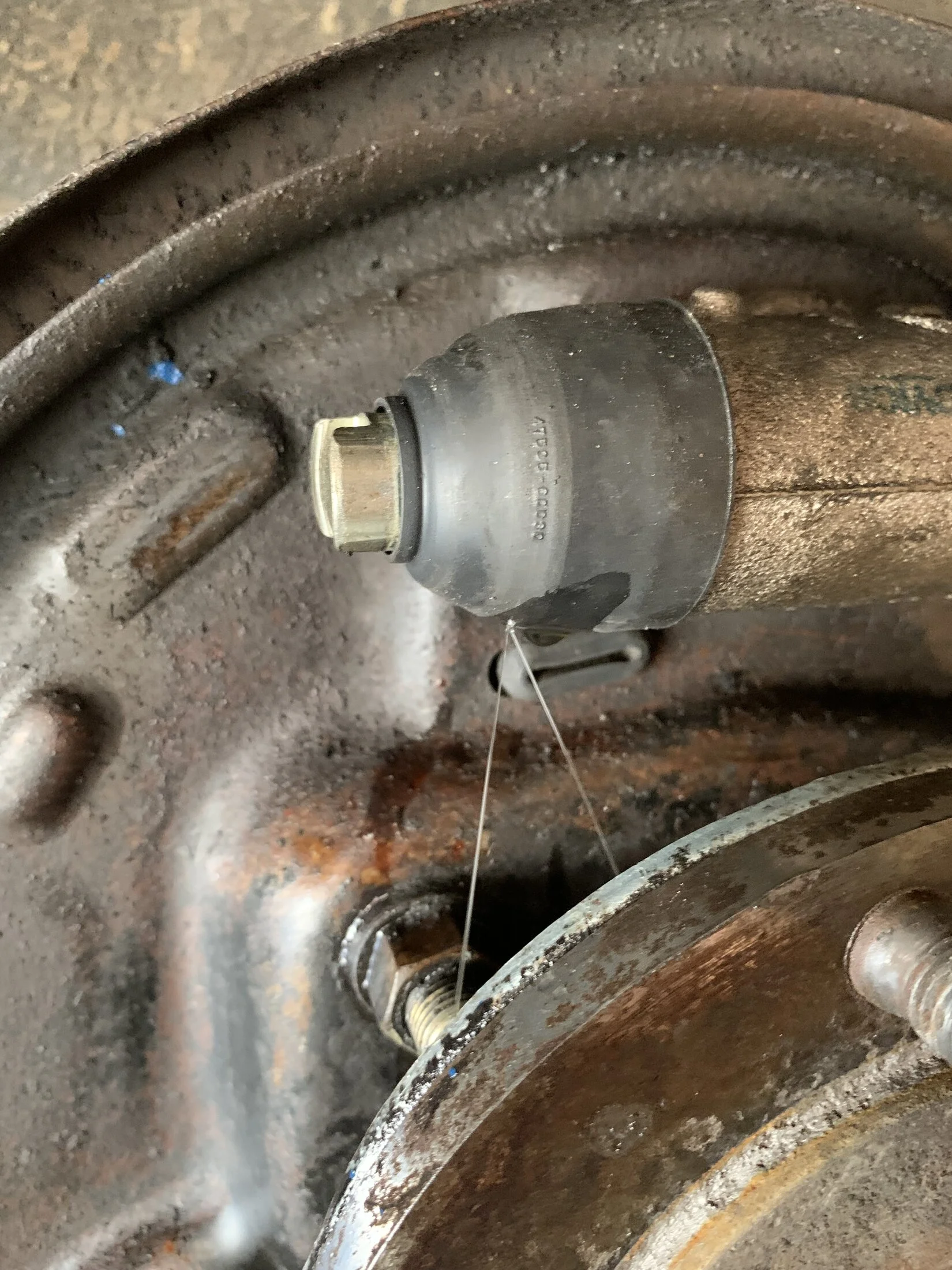

Next i wanted to replace the rock auto brake cylinder with the Aisin one that I had since I had re-done the brake master cylinder.
As it turns out, the Aisin brake cylinder was leaking!! Not good.
So a bunch of time wasted on that. I need to re-do that axle seal soon, it was reaaaallly gooey in there.

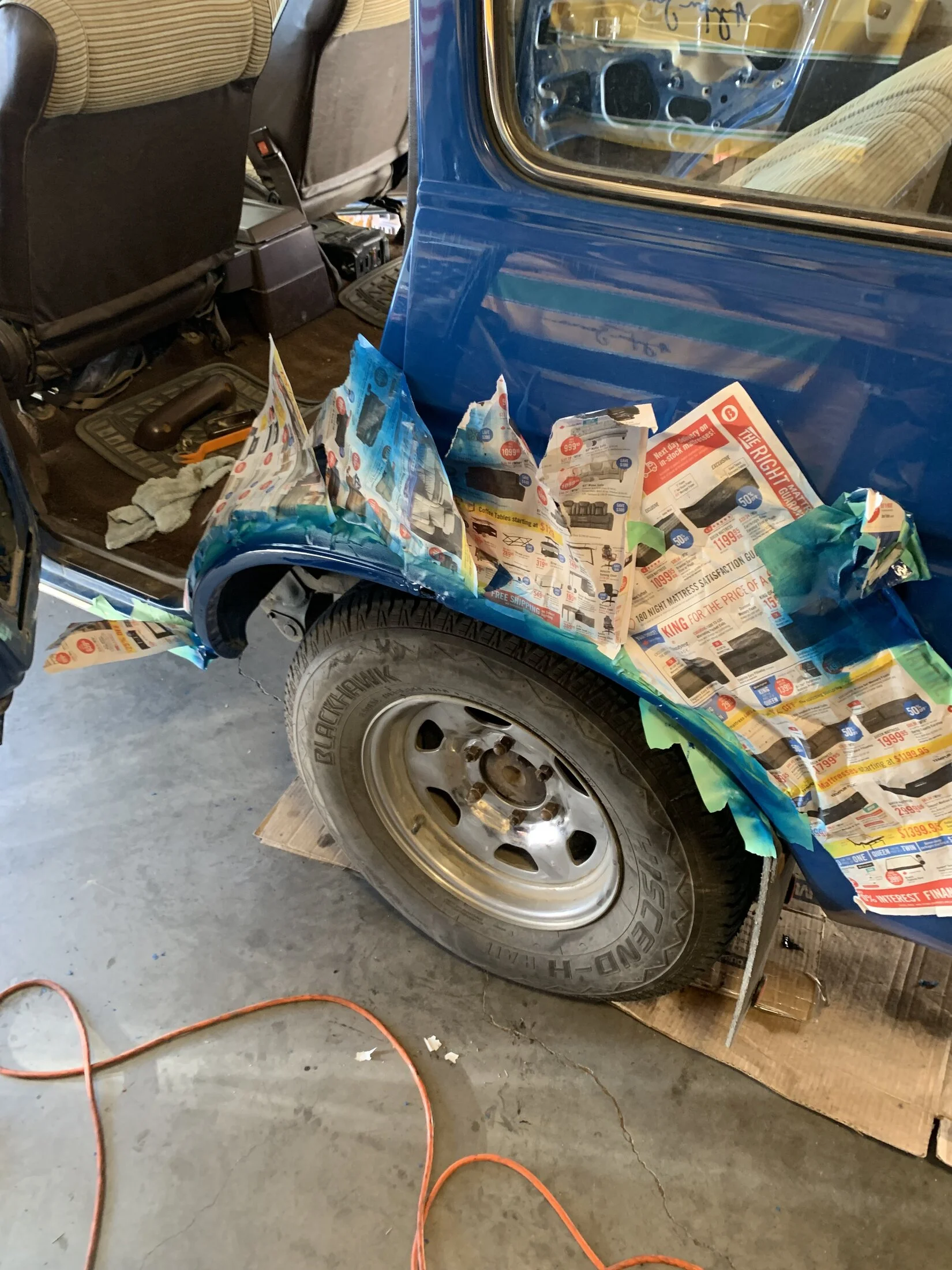

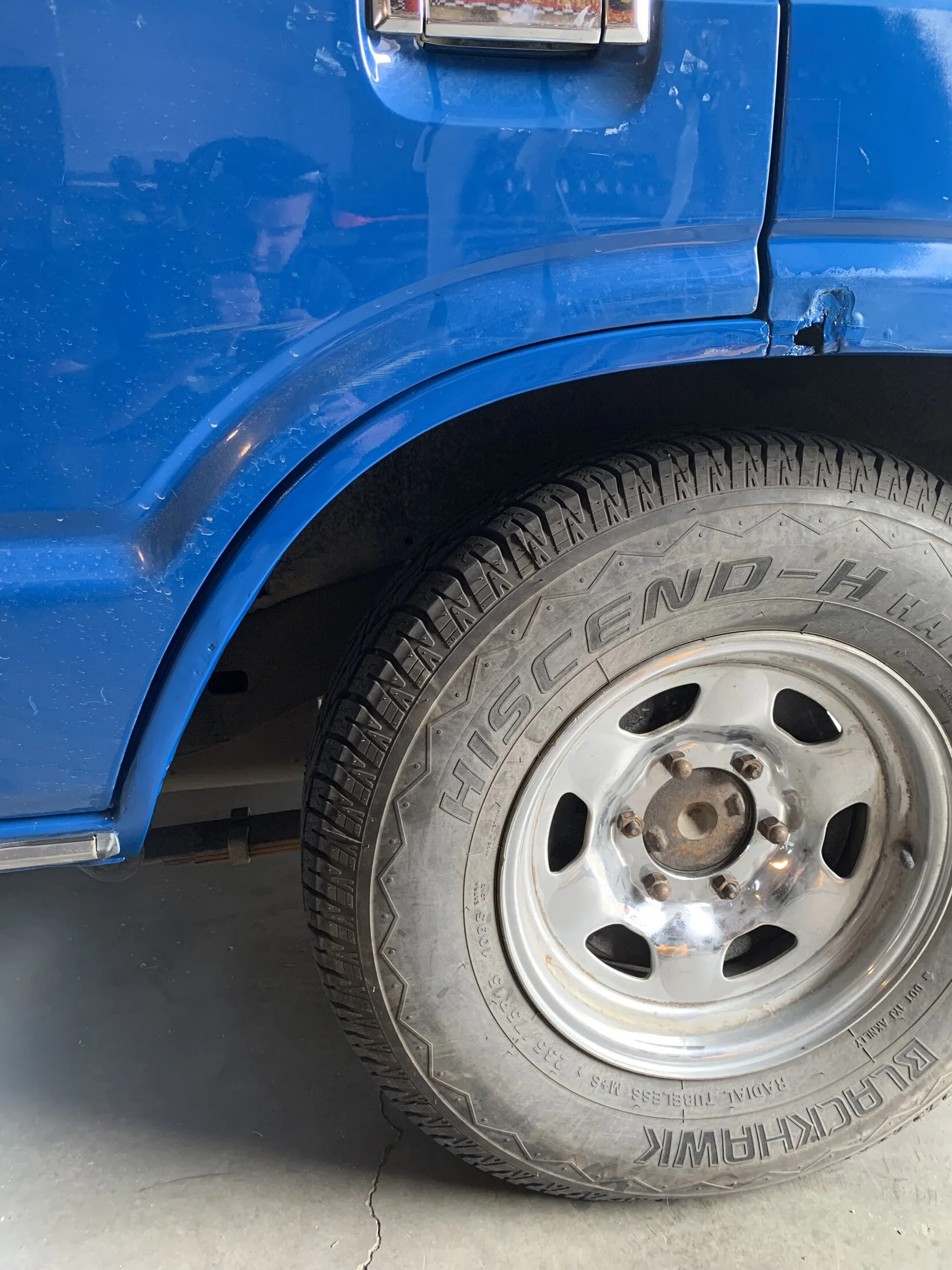

I got a bit off track and ended up sanding one of the wheel wells clean of the surface rust and tried my hand at painting it up again, just to see if the colour match was good and how it would turn out once I try some more serious body work.
Turned out alright! I’ll have to re-do it again once I properly cut that rust out and re-weld a new piece in. I’m just too nervous to dive into it since it’s my daily now.

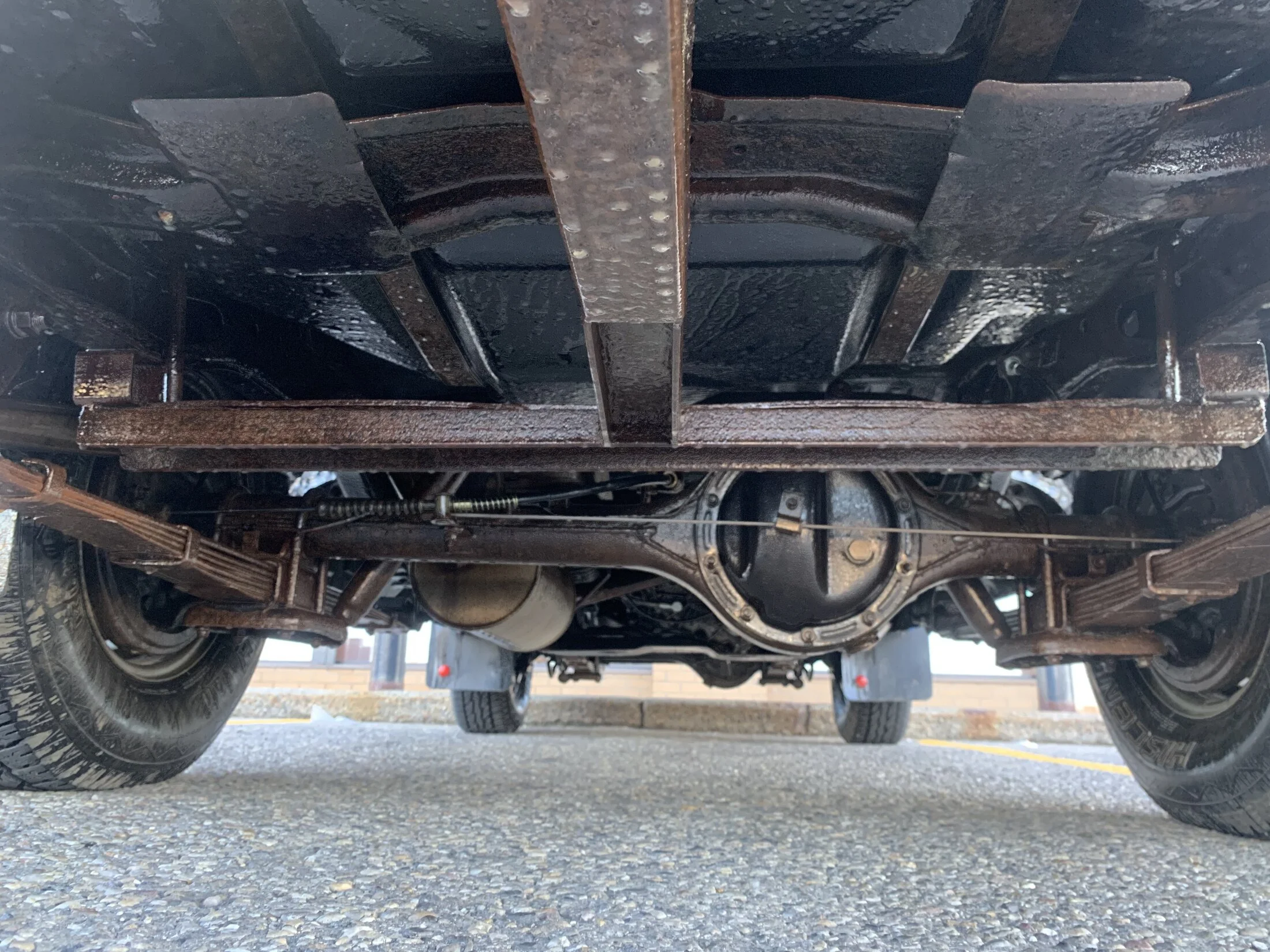

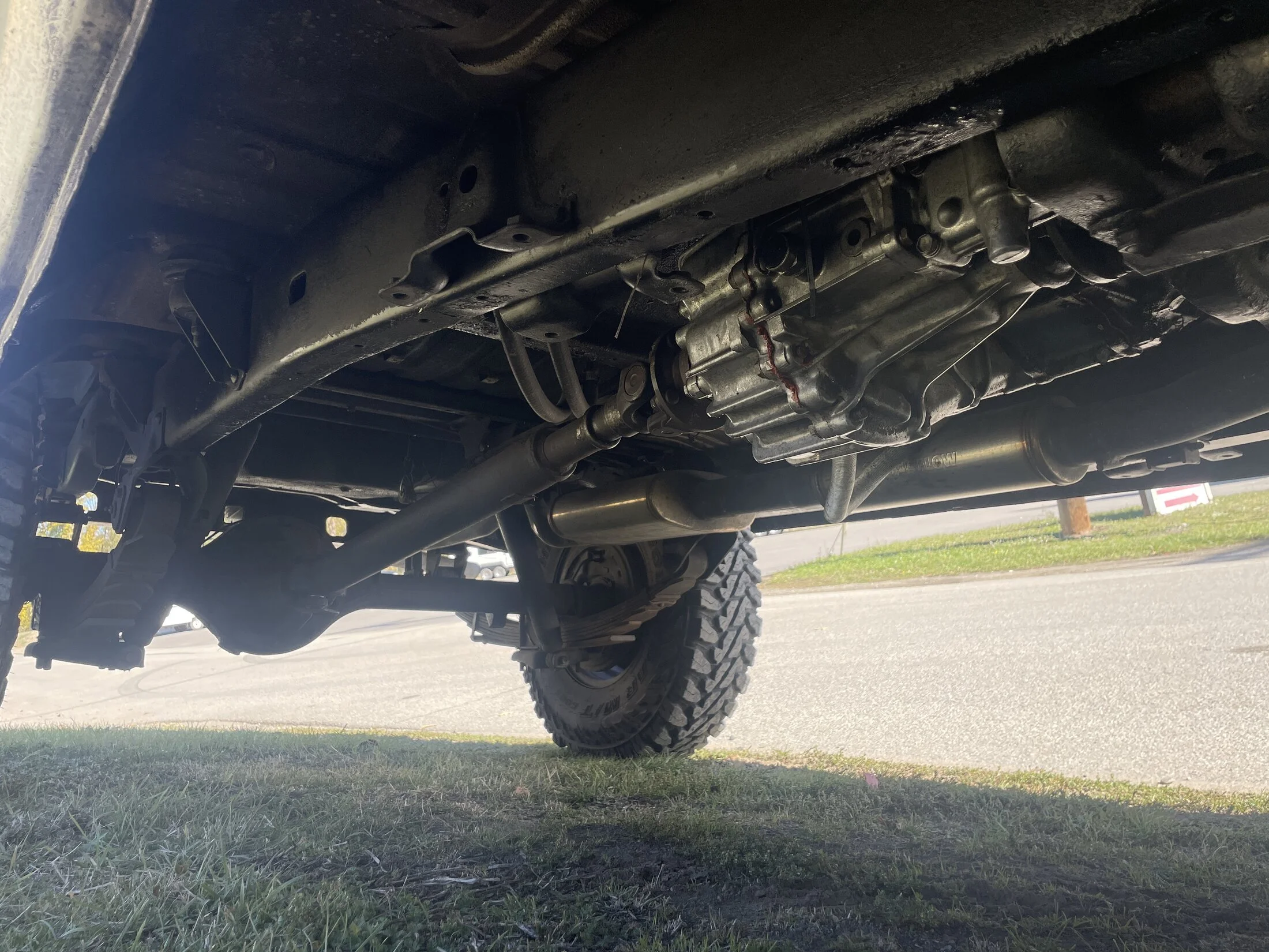

I’m also looking into those undercoating businesses. Both were close to $3500 CAD for a full dry ice blasting and wax undercoating. Good for something like 1000hrs of winter driving.
I’m kind of cheap so I think I’m going to get Krown to undercoat the truck then hit any extra spots with Fluid Film before this winter…
Just curious, between dry ice blast and wax coating (fluid film), is there any primer/paint coating? If the result of the blasting is good, I would (at lesst) consider a good coat of epoxy primer before the wax

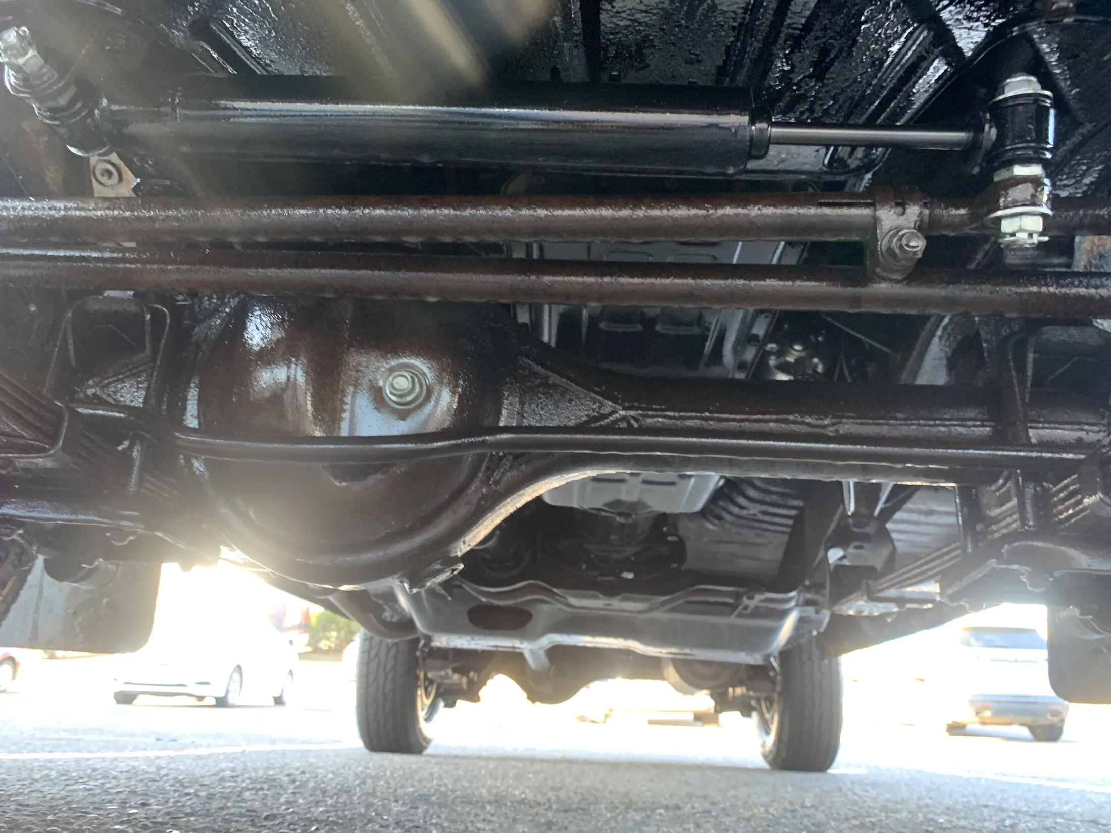

Mind you my BJ62 has nearly zero underbody rust, i fluid filmed and am never looking back EVER!
I did it myself, I bought a gallon of FF Black, and bought and applicator gun, and just sprayed everything. Now I don’t worry about my frame rusting. Even though I don’t drive it in the winter anyways.
@lacalvette @Gimme a 60
Looking like the fluid film + Krown for like $165.00 is the way to go. Ill be moving to Oregon state next year so im really only worried about driving it in the snow this winter. So a nice coating of the aforementioned should deal well this winter.
The other place in Calgary is Dry Ice Blasting Calgary | Expert Dry Ice Cleaning Services - https://www.cerberusautostyling.ca/dry-ice-blasting. Their work seems good, and it would make the underside of the truck look factory fresh, just really expensive. Is the juice worth the squeeze?
My point is that I’m worried about what happen after such a treatment (dry ice blast). It will leave some area (if not all) to bare metal. Just a wax coating won’t be good enough on long.
If it is just to clean the undercarriage , you could use a hot water/ soap pressure washer.

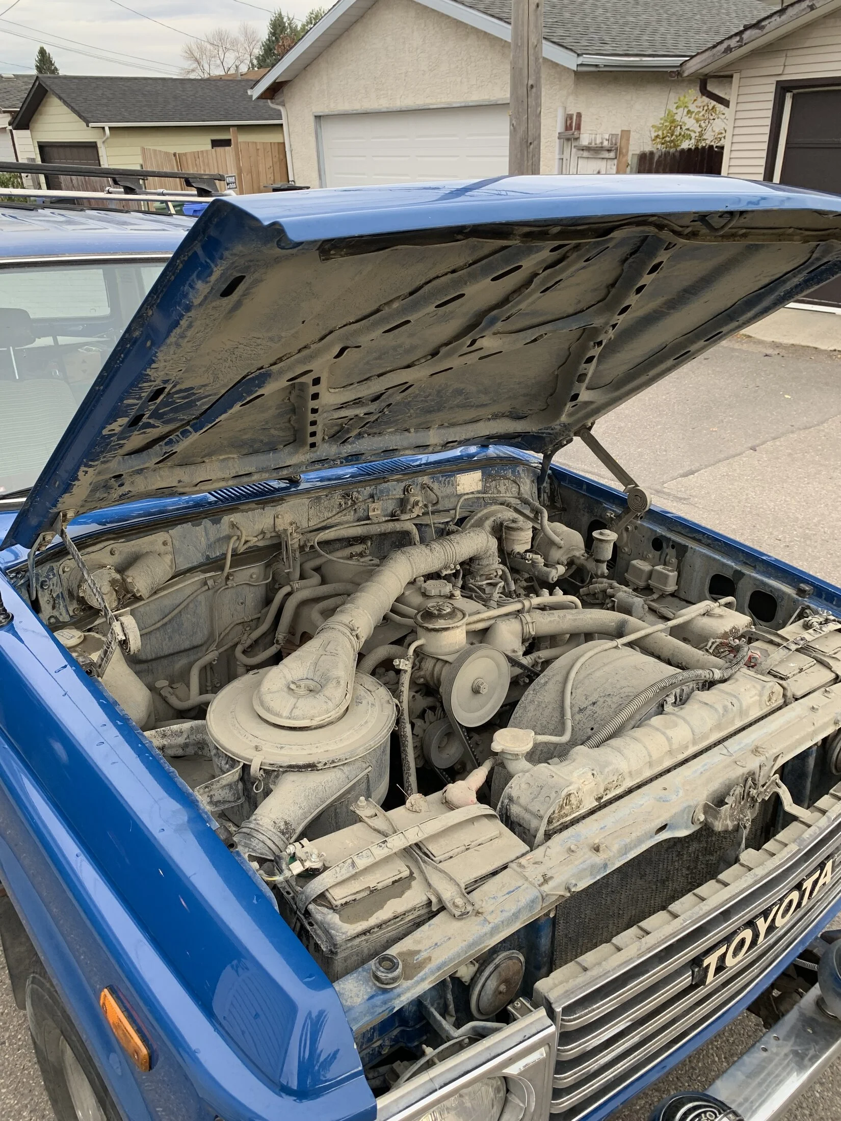

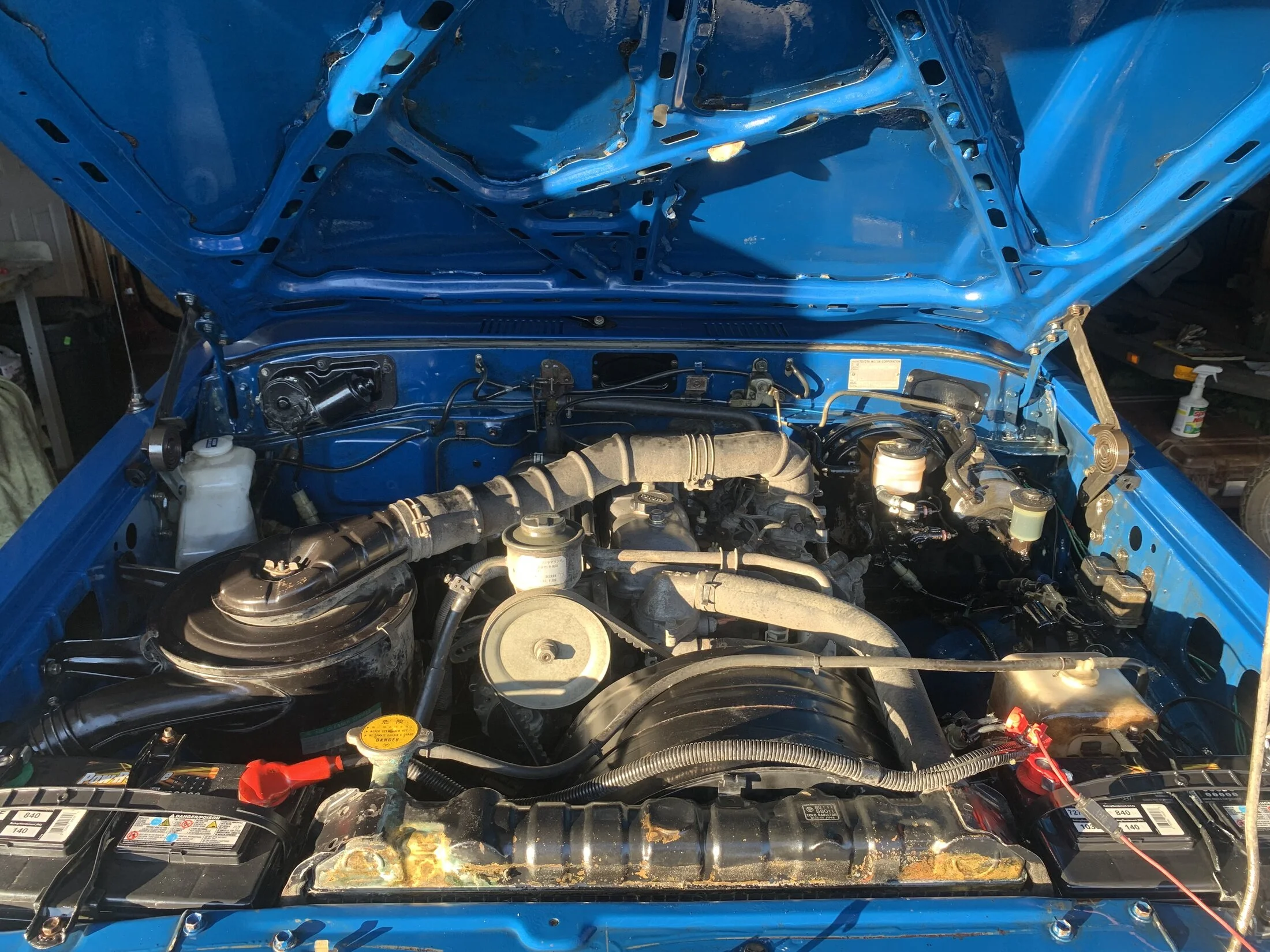

Hahah sweet engine bay shot! Good times had for sure!

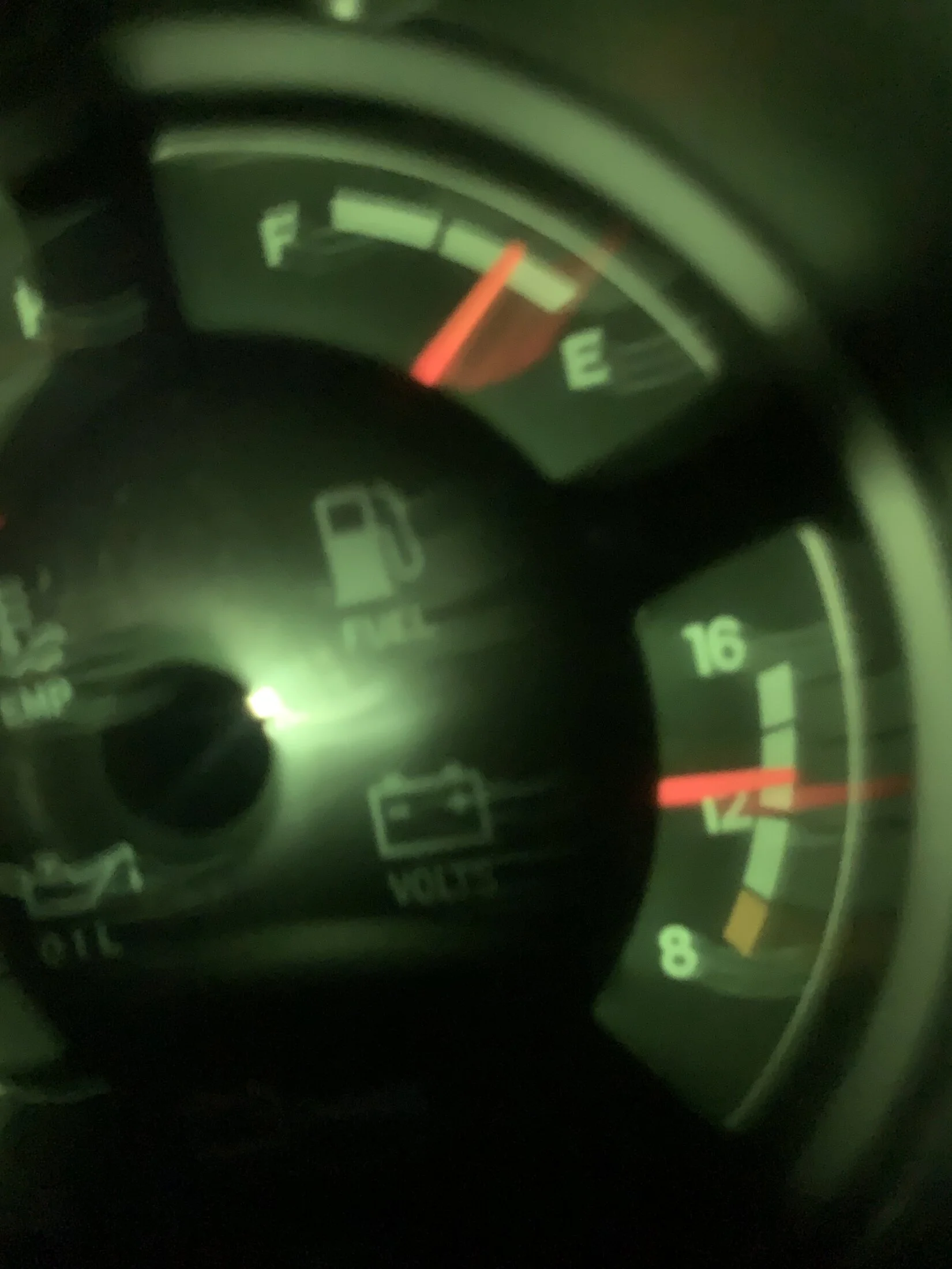

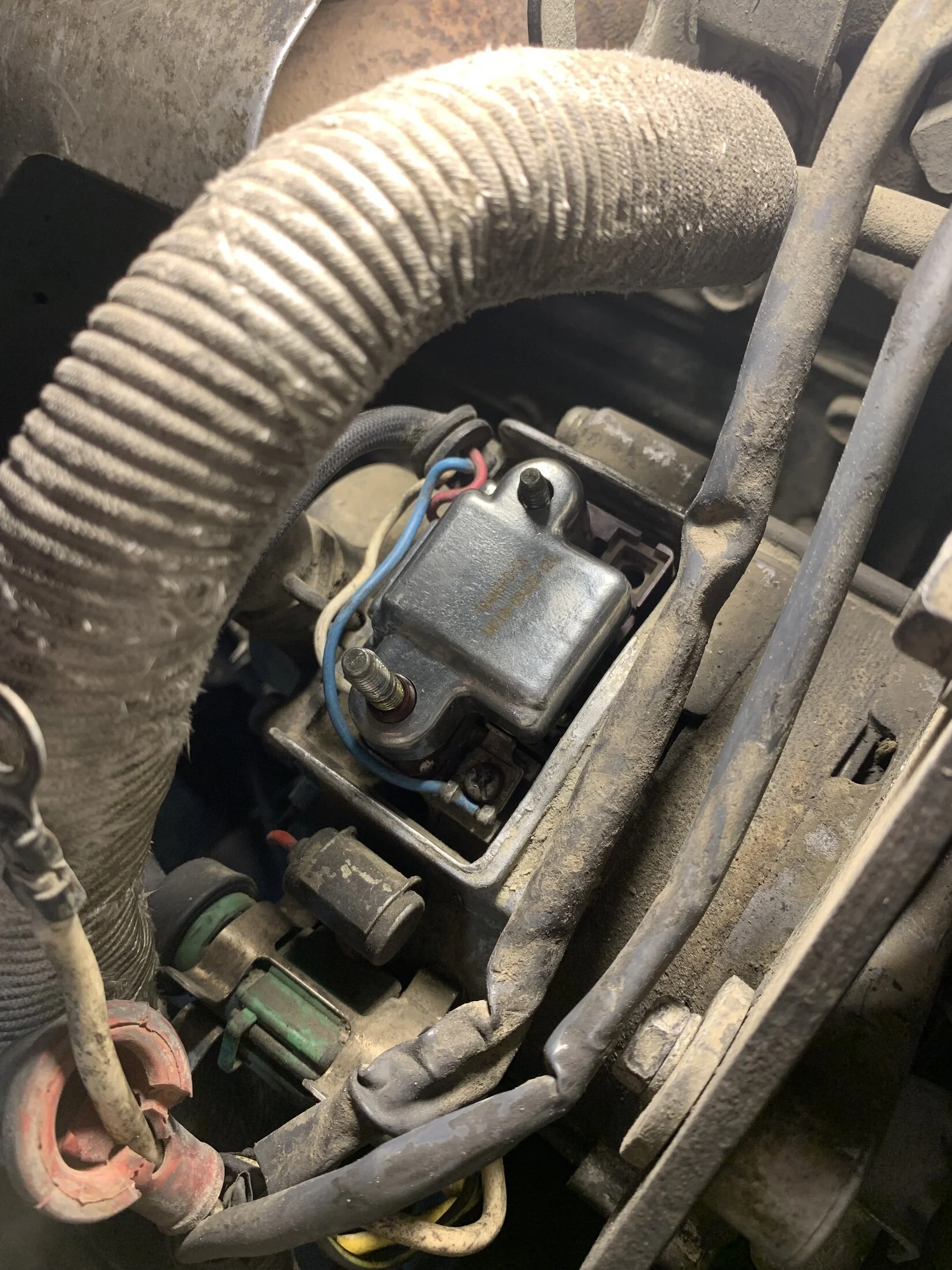

So my alternator started acting funny last week and wouldn’t put voltage out.
It completely died on my for good last night coming home from work.
I tested the voltage on the IC regulator and it says ~25V which according to the manual is a replacement. So I ordered one from Dan at 4 wheel.
Should be here this week and I can keep cruising without issues.
Tried hosing out the alternator after your mud bath?

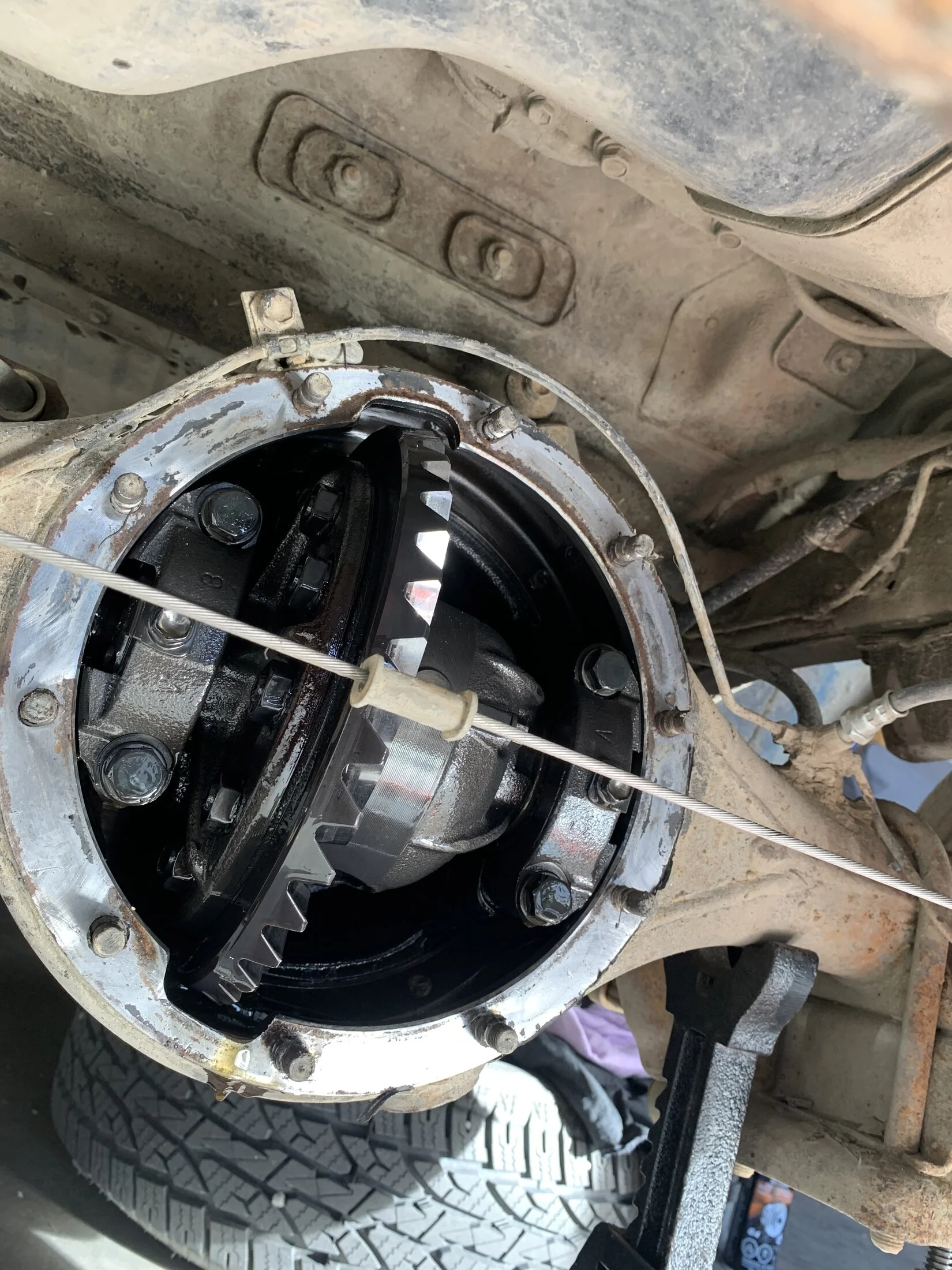

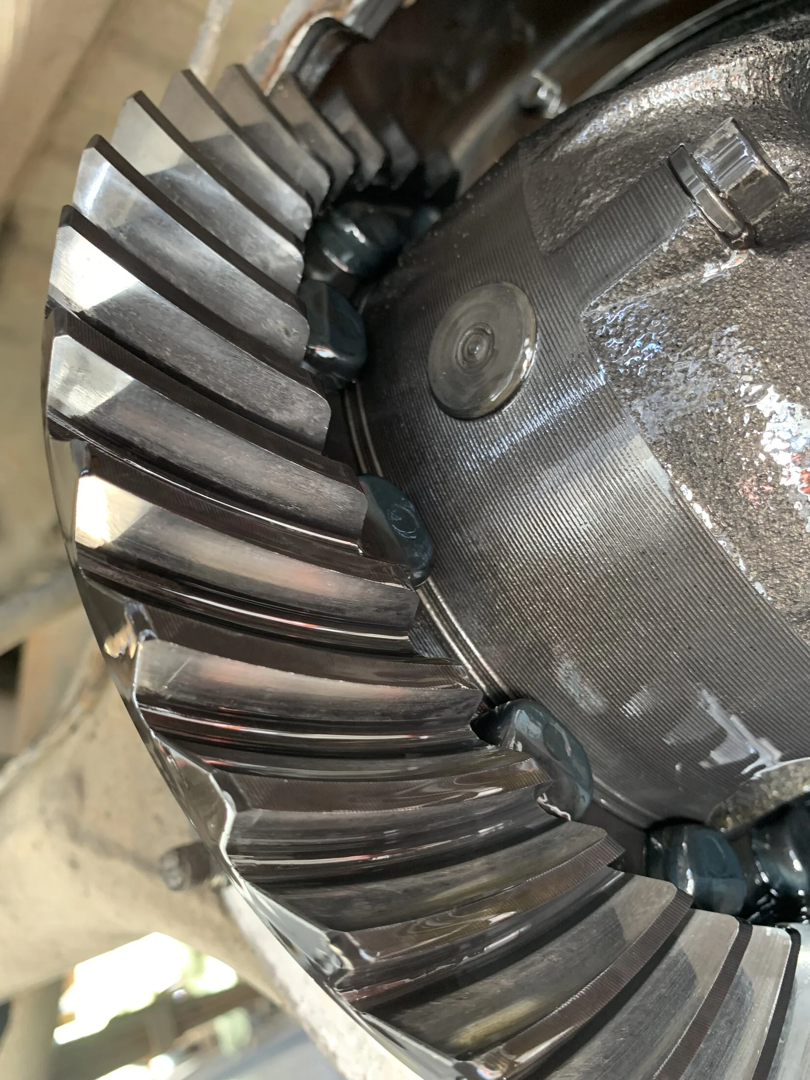

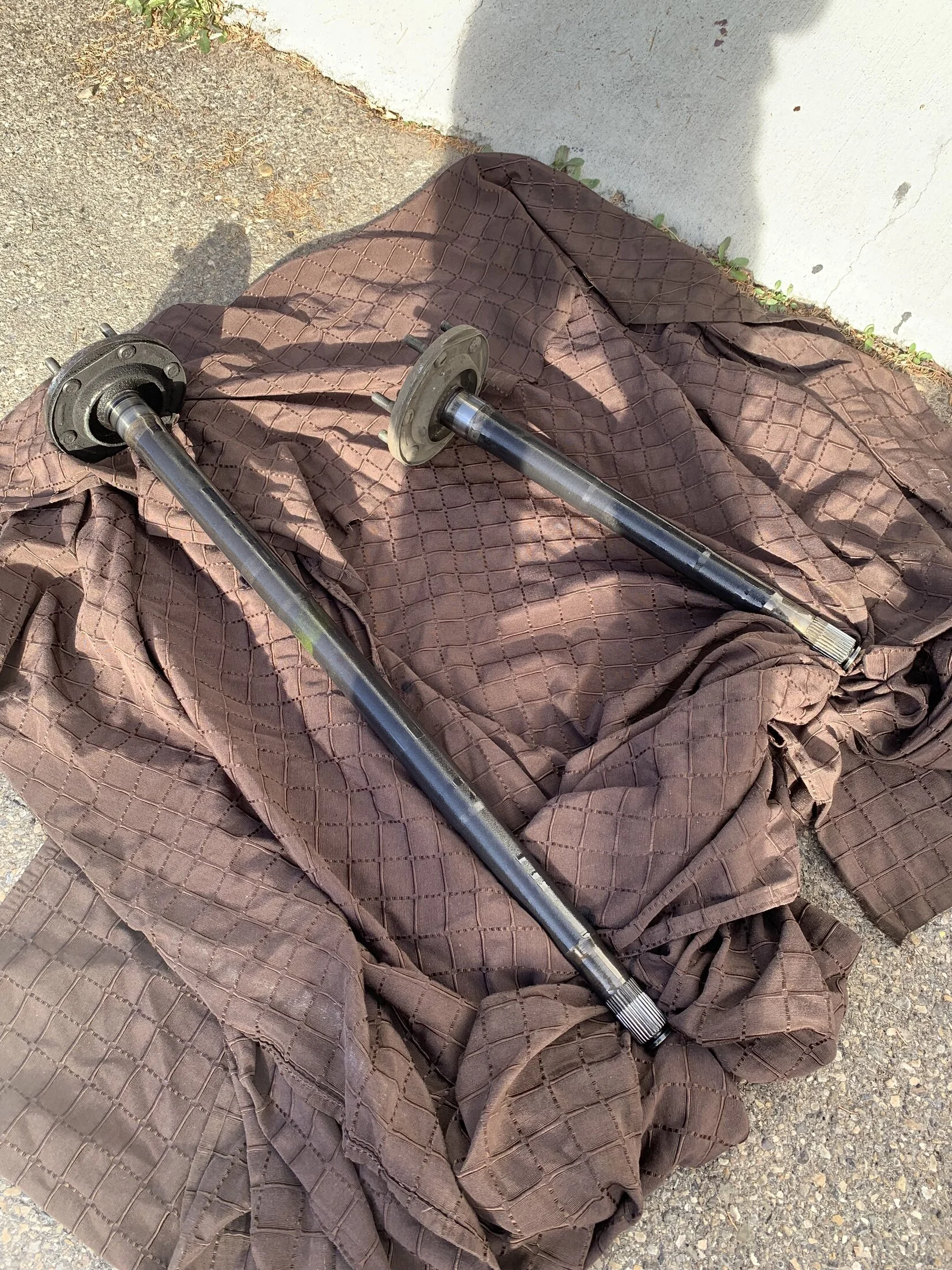

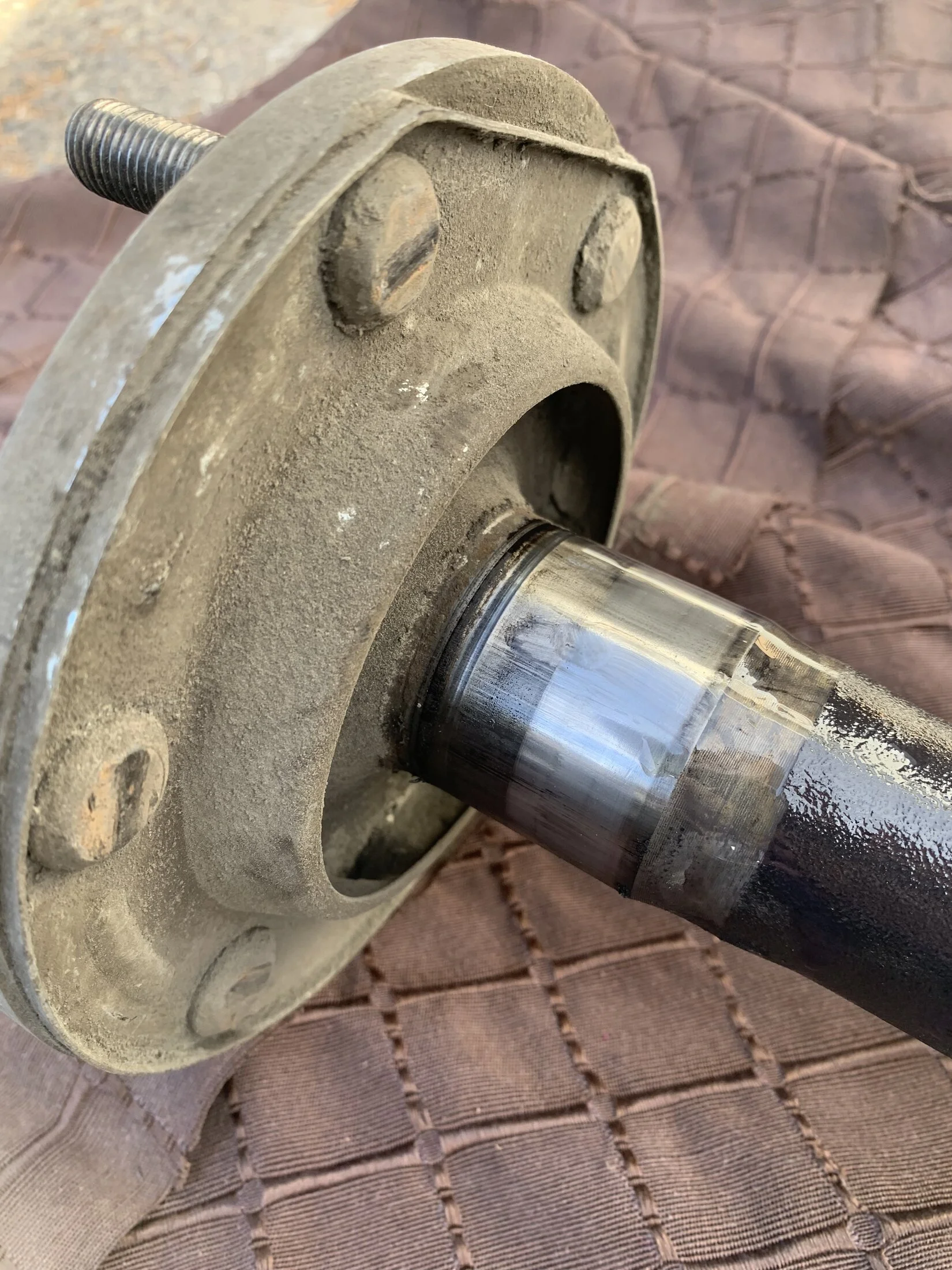

Tackled the axle seals finally today with the help of a buddy.

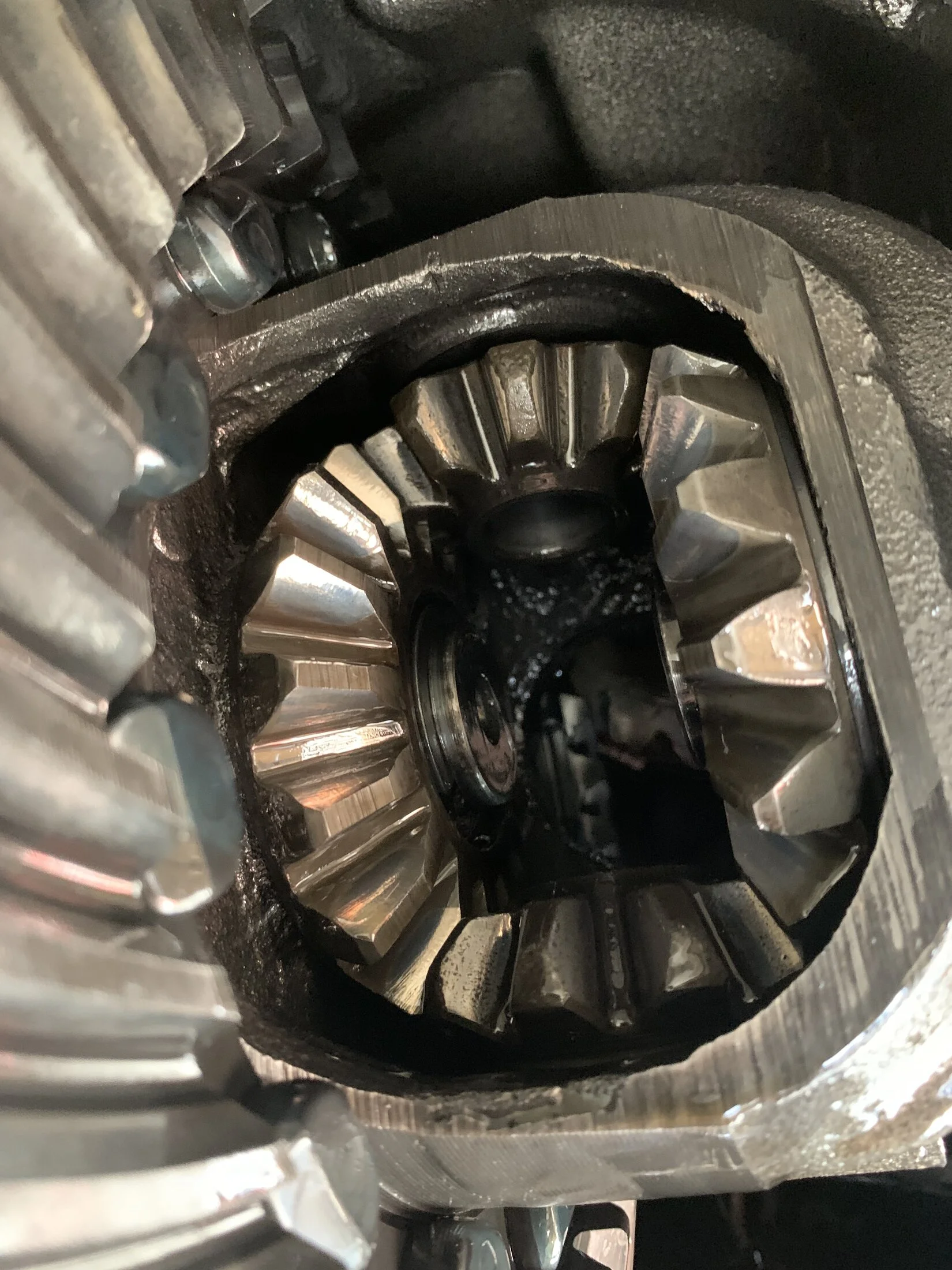

Everything inside the diff looked good! Or so to my untrained eyes.
The brakes were a mess of diff fluid and mud after that last trip. They sorely needed to be taken apart.
I think the wear looks good.
Drive shafts were in good Nick.
Had that washer above the pinion gear fall out once, had no idea where it came from. Freaked me out til I found the mega zip diagram and found out where it came from. Sneaky things.

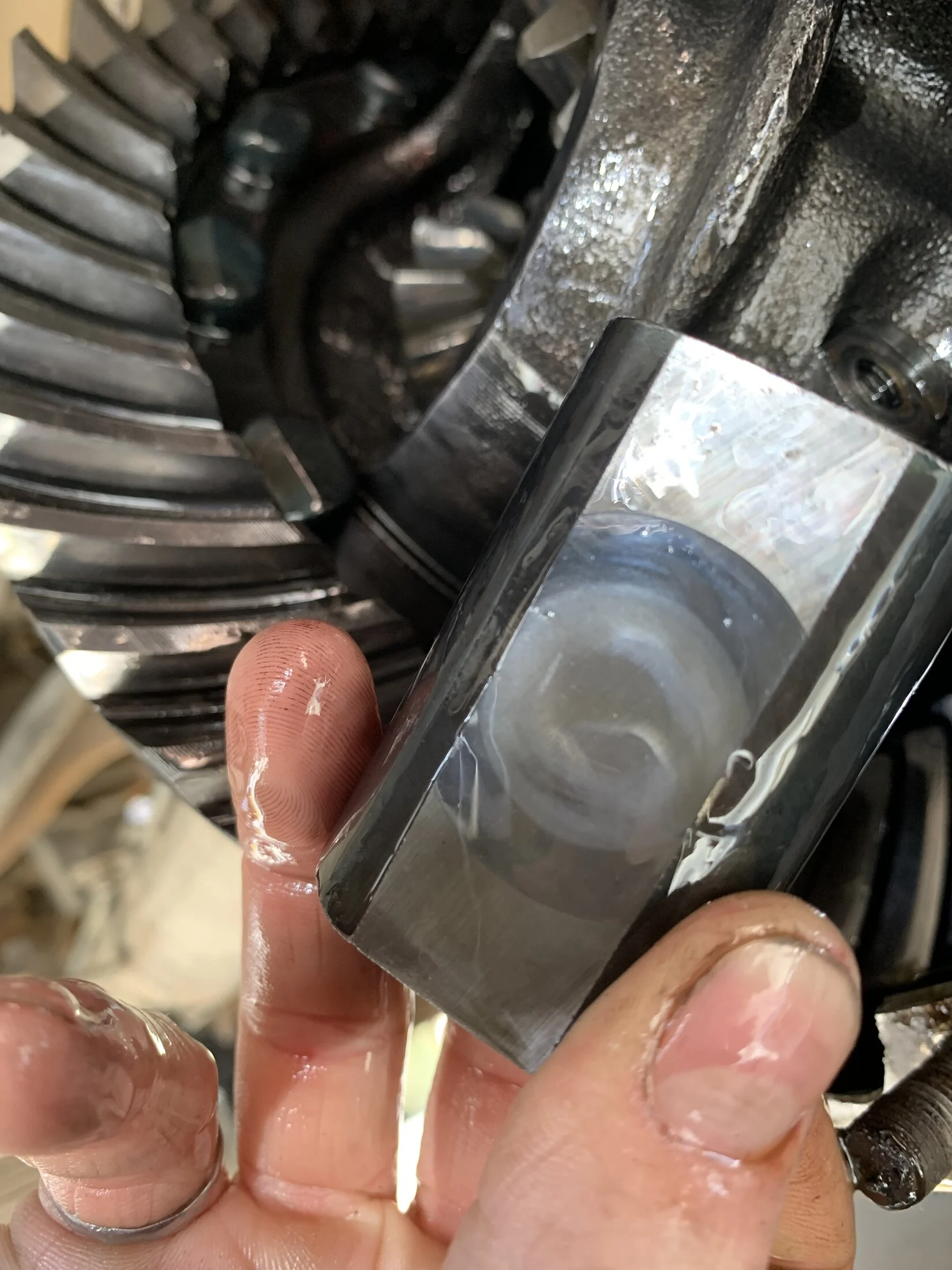

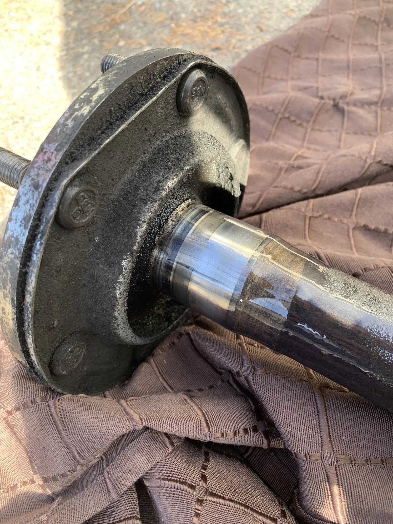

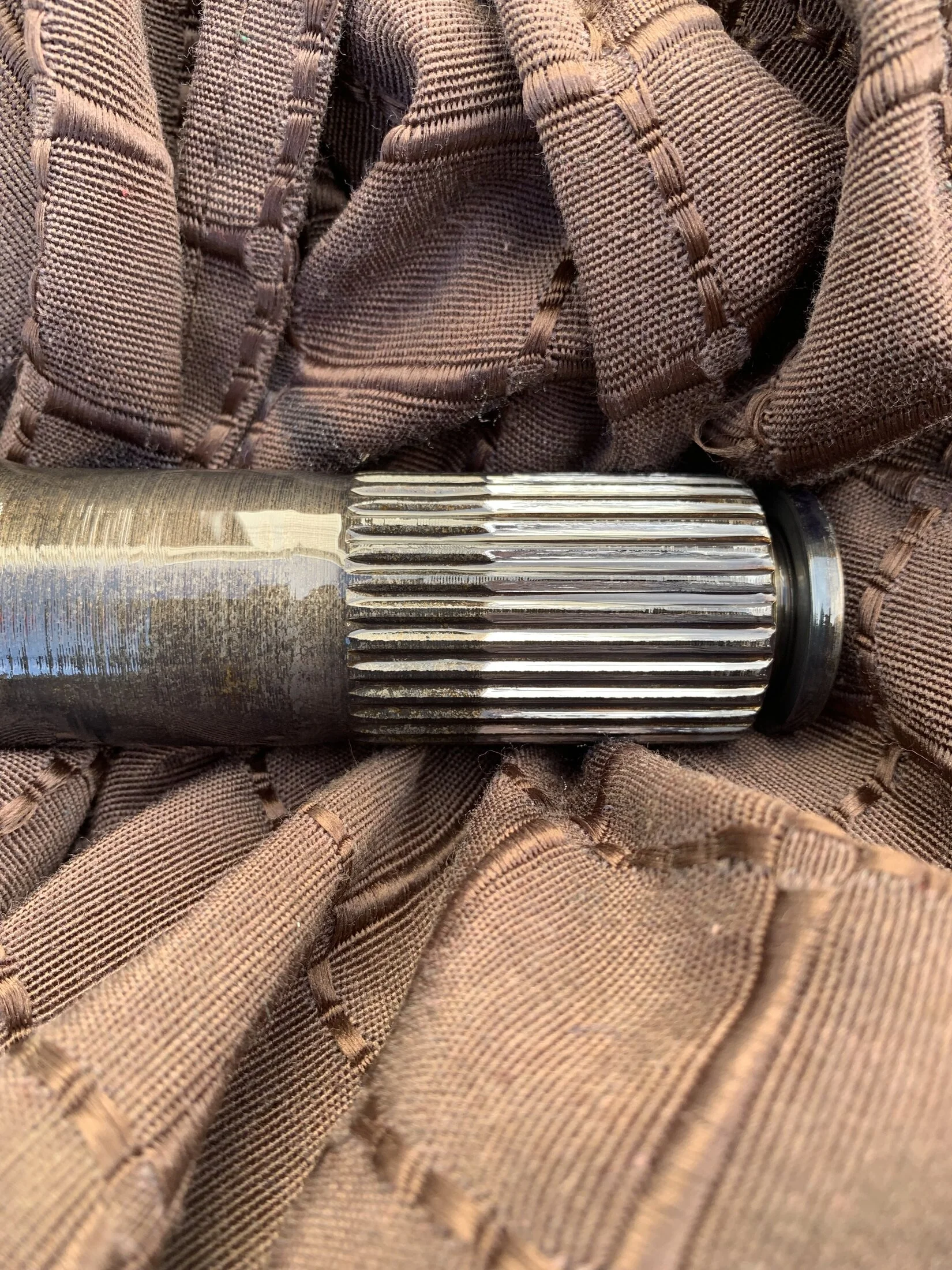

A little bit of wear on the spacer.

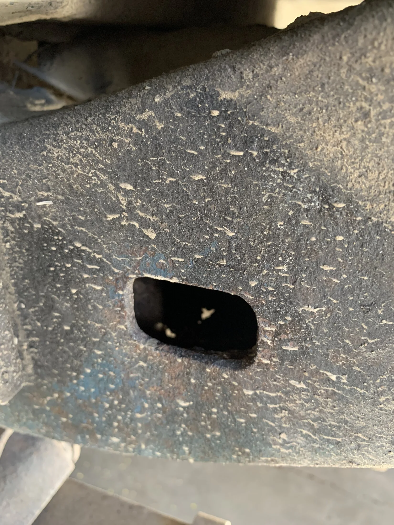

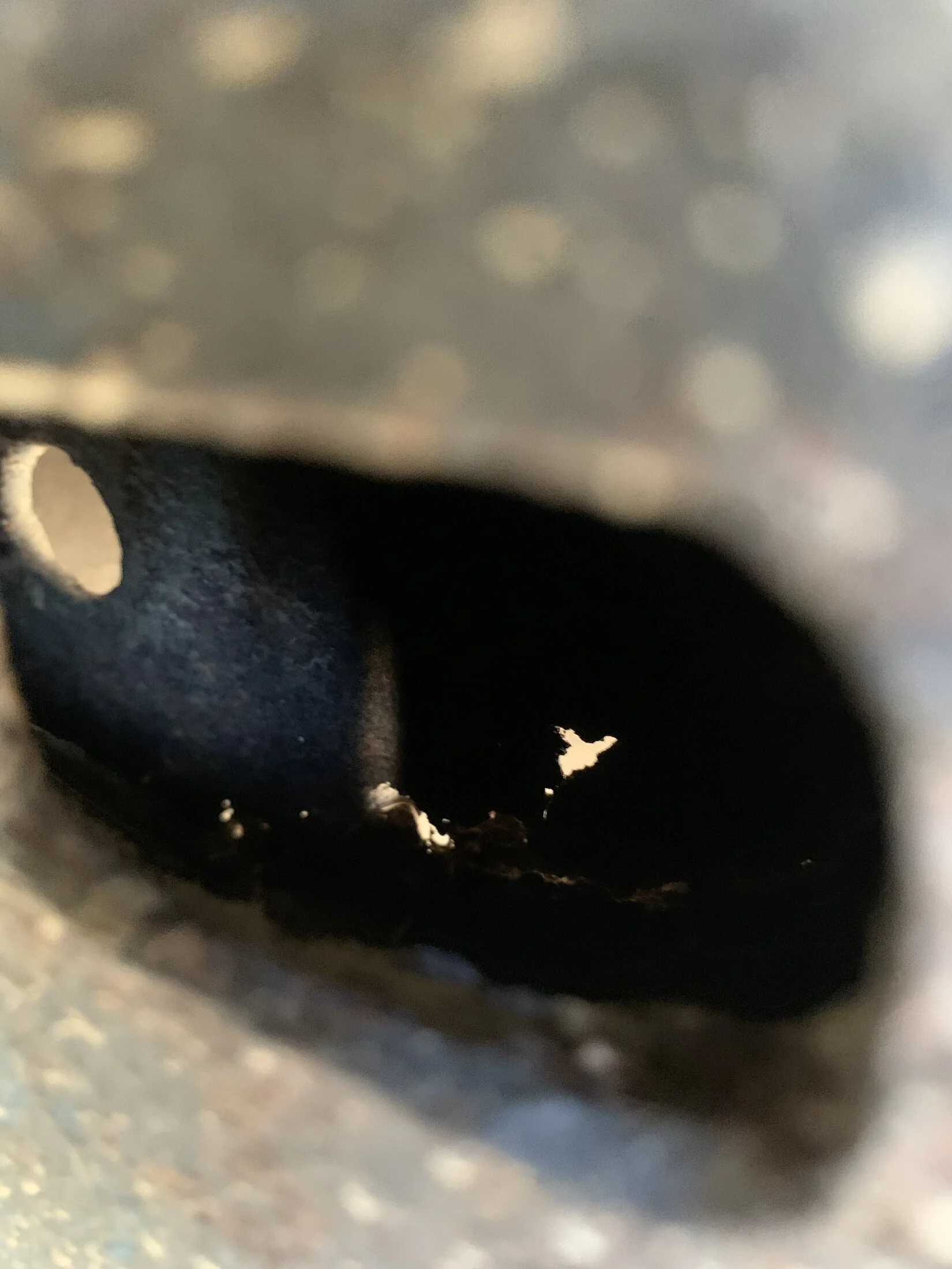

Also found some more rust holes through the frame. Same issue on both sides. :(
This pic is from the drivers side where the frame starts to go up above the rear axle. More to cut and weld later.
Then we got beers to celebrate the axle win
The crown wheel teeth look worn but nothing serious. It's the pre load on the pinion bearings that wants checking - leave it with zero pre-load for long enough and it can wear expensive parts (been there).
Those C clips are fiddly, but they are the only thing holding your axle in! I was not much impressed with the rear bearing design on the semi-floating 60 rear axle, it's easy to change the bearing but the rollers act directly on the axle half shaft, so if that wears you need to find replacements (and they are NLA from Toyota). Good to see that yours are perfect. The Hilux design is better IMO but needs a press and to change a bearing.
Easy chassis weld to fix that, so long as the tank does not need to come out :)

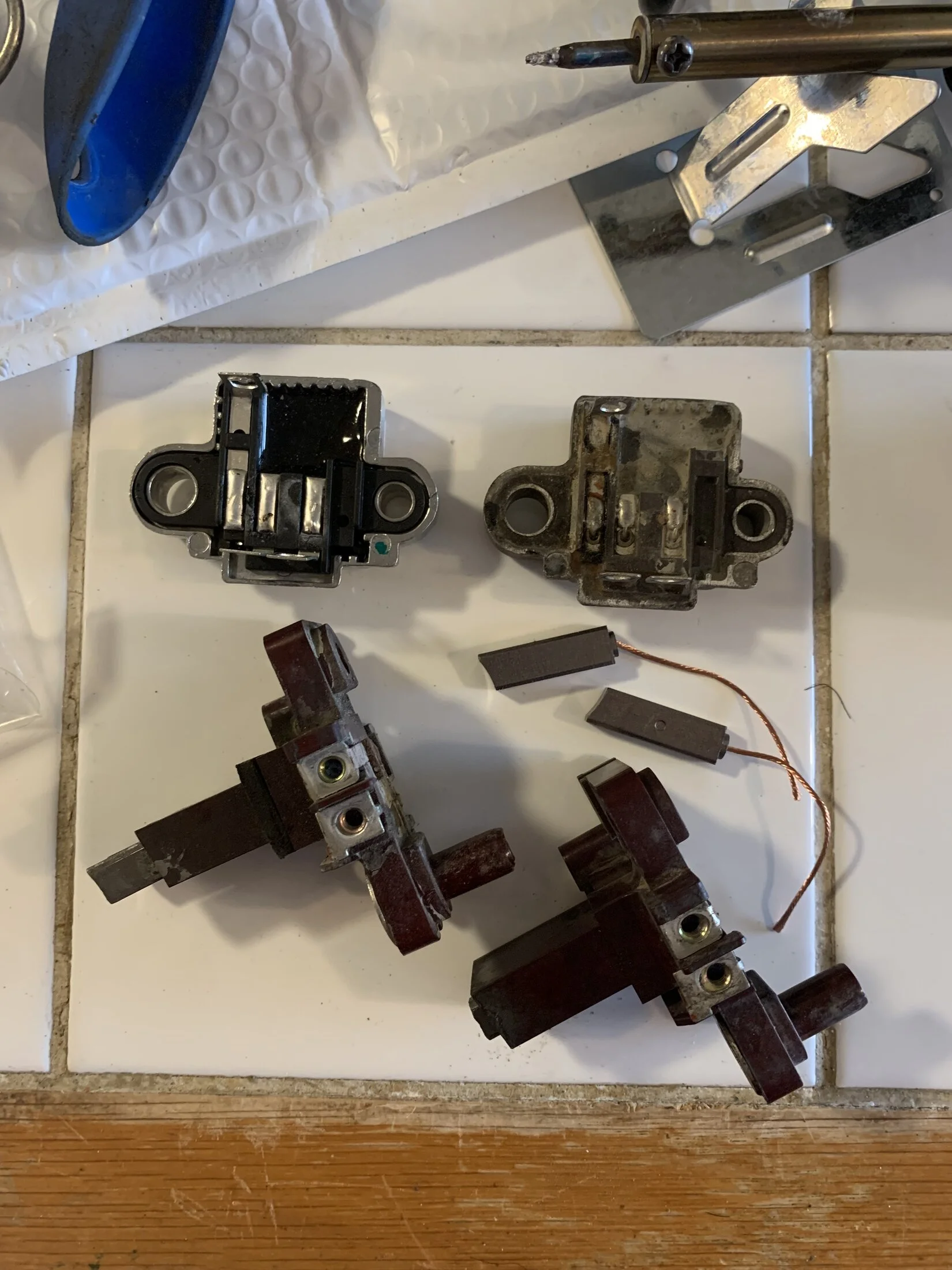

the new 12V regulator came from 4WheelAuto today! I had been driving around with no output from the alternator for a week. Some funky electronic things happen when your regulator is busted. Couple flickering lights on the dash at idle, and not as much glow in the mornings. I trickle charged the batteries each night to make sure she kept up all week. Glad to have this issue resolved.

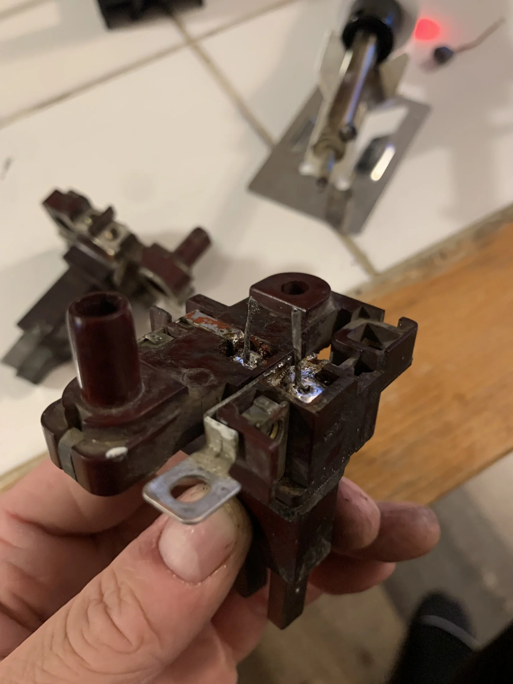

Went about installing brand new brushes I picked up from Toyota into the spare brush holder I have. I ended up snapping both brushes off the spare set the other day by accident, by being lazy in my work. Oh well, it was only a $30 mistake.
Here are all the players of todays game.
I first had to use my solder iron to release the broken brushes from the holder.
Once I had those popped out, I put some flux on the copper wires of the new brushes and added some solder to them to give them a bit of rigidity, in order to pull them through the holes of the brush holder.
I then fished some thread through the hole of the brush holder and then tied that to the end of the brush wire. Once that was set up, just had to pull the thread and the new brush wire through the hole, and solder a bit of the wire up to keep it in place! It sounds easy but it was a longer process to figure out what worked best.
Then once I had added some more solder to make sure those brushes were not going anywhere, I cut them down to size.
And after about an hour of play time, I had a brand new set of brushes with a brand new 12V regulator!
Then I was EXTREMELY careful in mounting the new brush holder into the alternator. Made sure I didn’t bust any brushes by adding lateral forces to them.

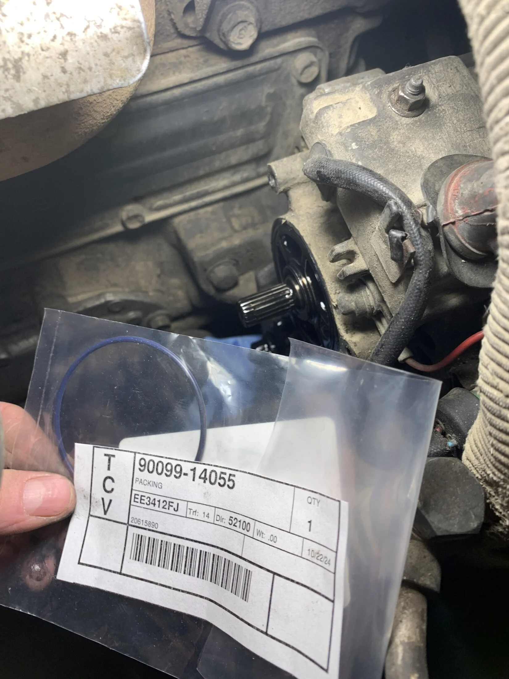

Once that was in, I finally got around to replacing that o-ring at the back of the alternator for the vacuum pump (?) I think? Either way it’s replaced and no longer seeping oil out.
After replacement. New o-ring is blue compared to black! Fun stuff.

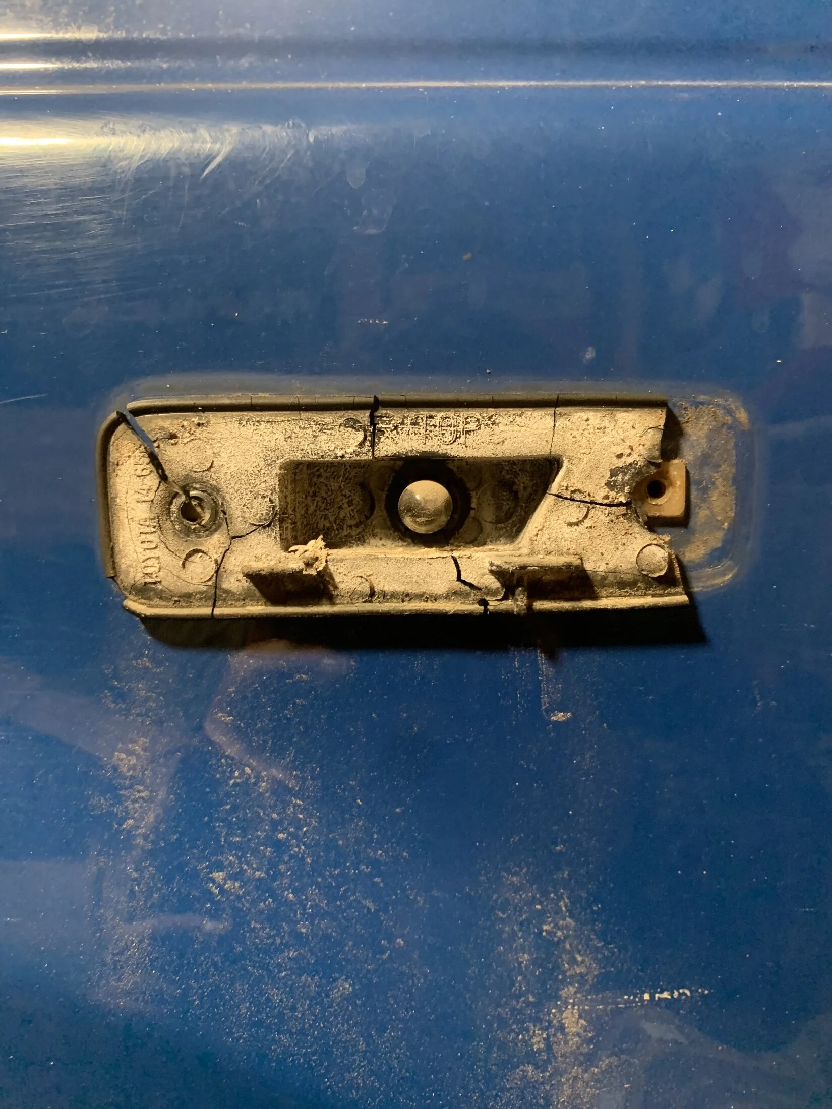

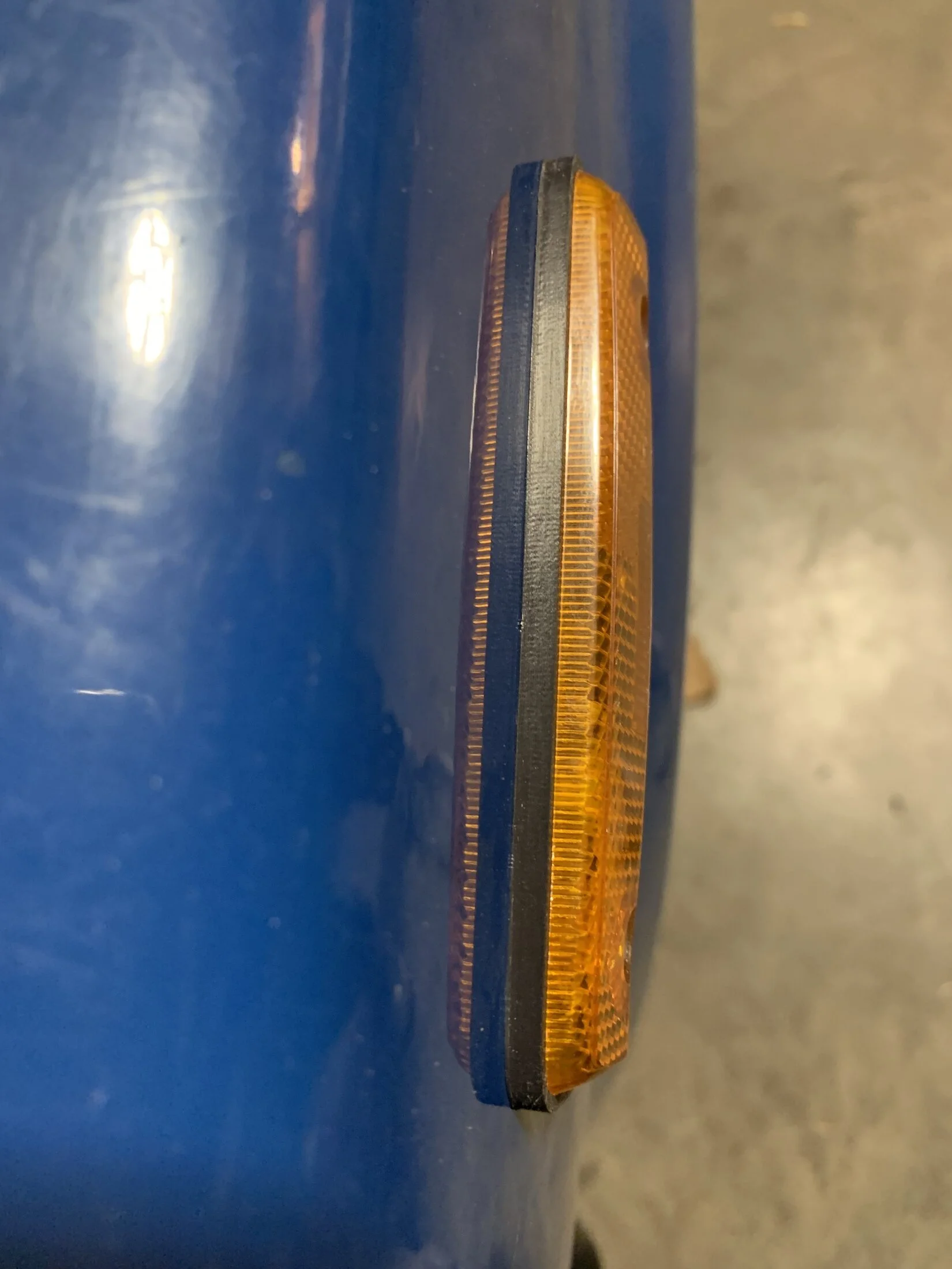

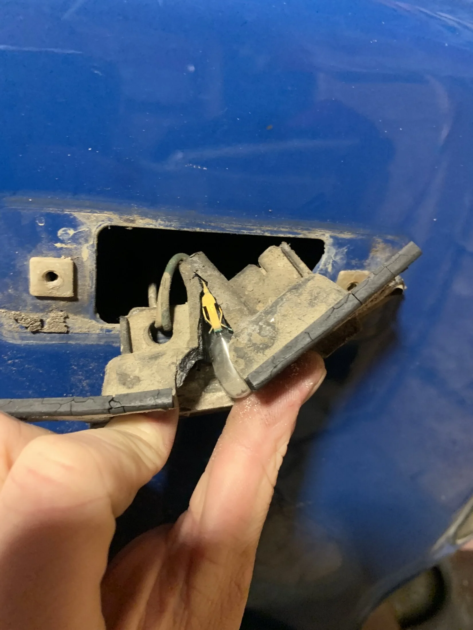

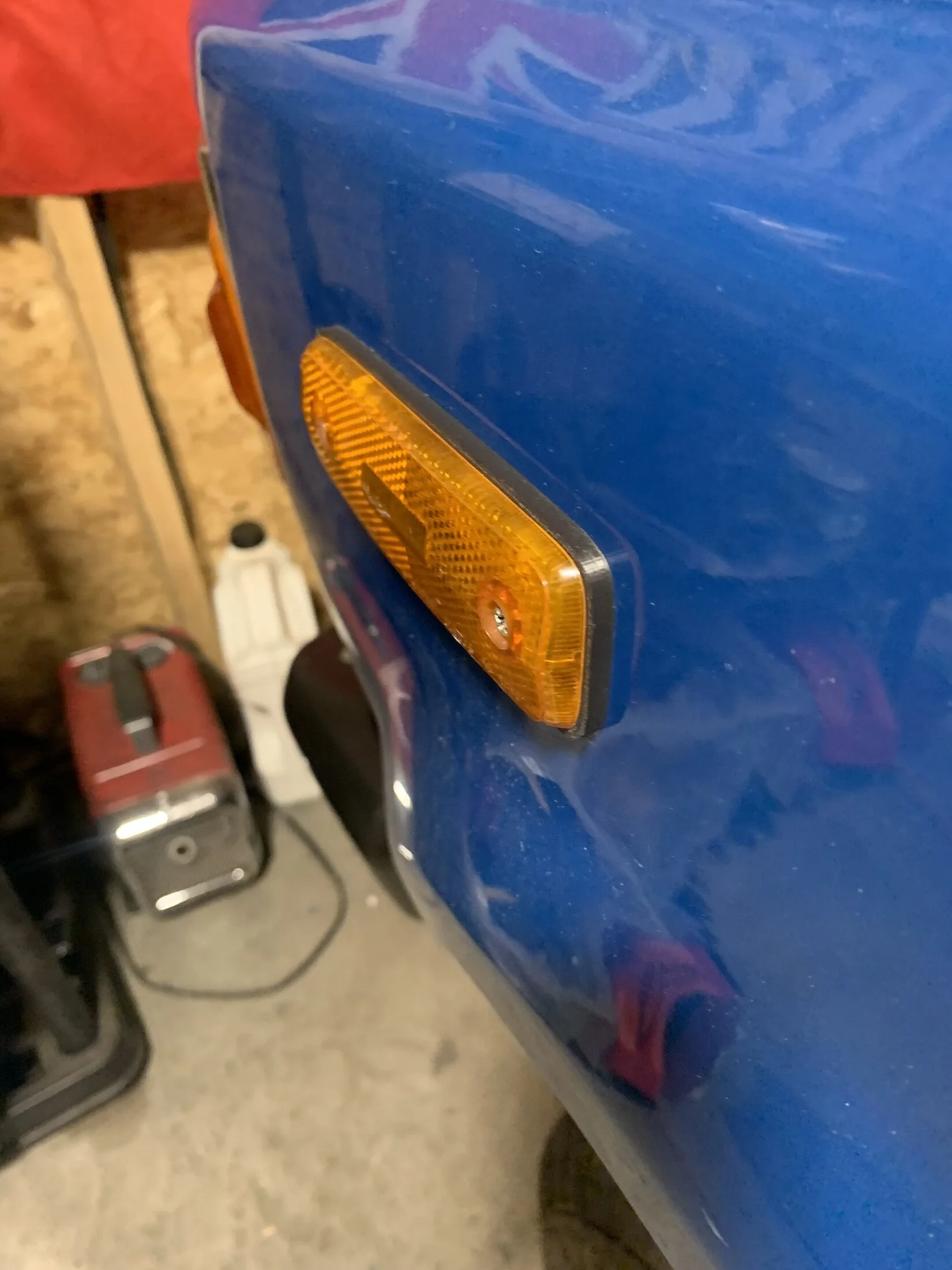

Found some 3d printable fj60 lense backings for the front side markers.
link: FJ60 Side Marker by chooch12 - https://www.thingiverse.com/thing:4679508
Sent them off to a local 3d print shop and had them printed for $63 Canadian pesos. ($45 freedom bucks)
Had them back in 2 days and slapped them on today. Turns out the holders are integrated into the light. I assumed the light has a seperate piece. So it’s held together now by electrical tape but I’ll have to buy some connectors and solder them onto the wiring cause it’ll rattle the light out shortly I’m sure.
Would I say this was worth $63? Maybe, but honestly it’s about the same price to just order new ones if you’re in the states. But I’ll take the 3d print ā€œcoolā€ factor being an engineer myself.
