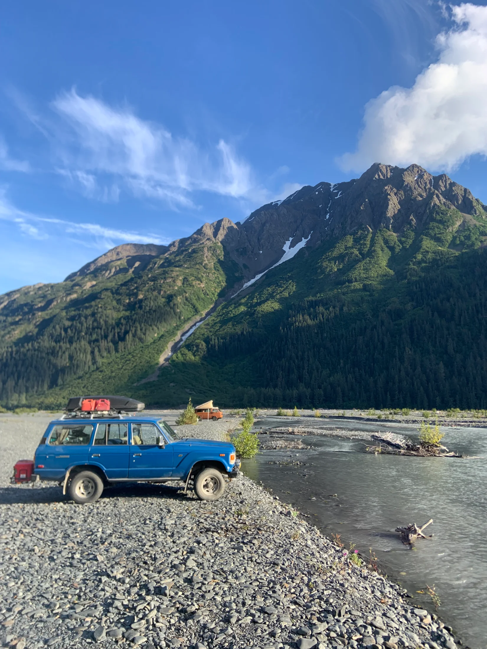

the Kenai peninsula was one of the few places I spent multiple nights in the same camp spot!
Leaving the beach was the first time I heard the knocking/rattling noise from the engine. I didn’t think much of it, and figured the bearing on the water pump was failing.

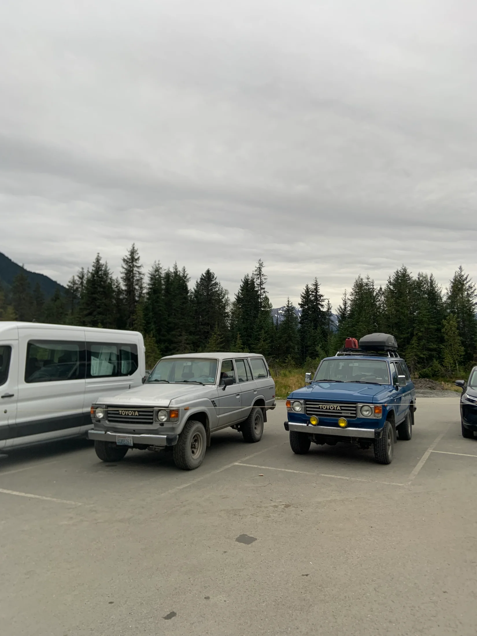

Another wicked 60 series I saw in Homer. This one was fully built and looked to be an HJ60.

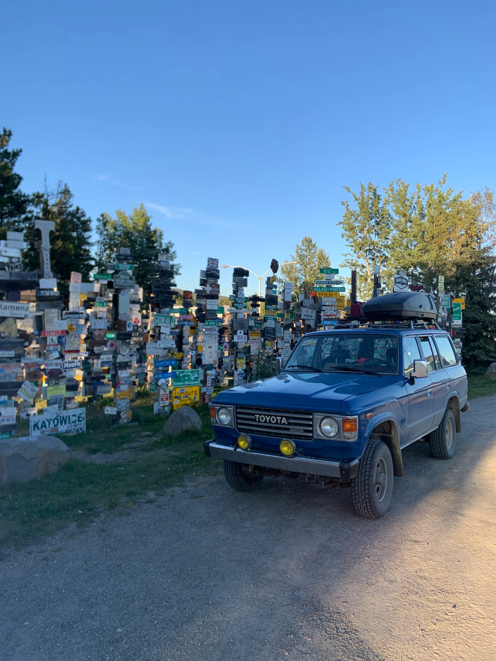

I left my sign on a post in the Watson lake sign post forest!

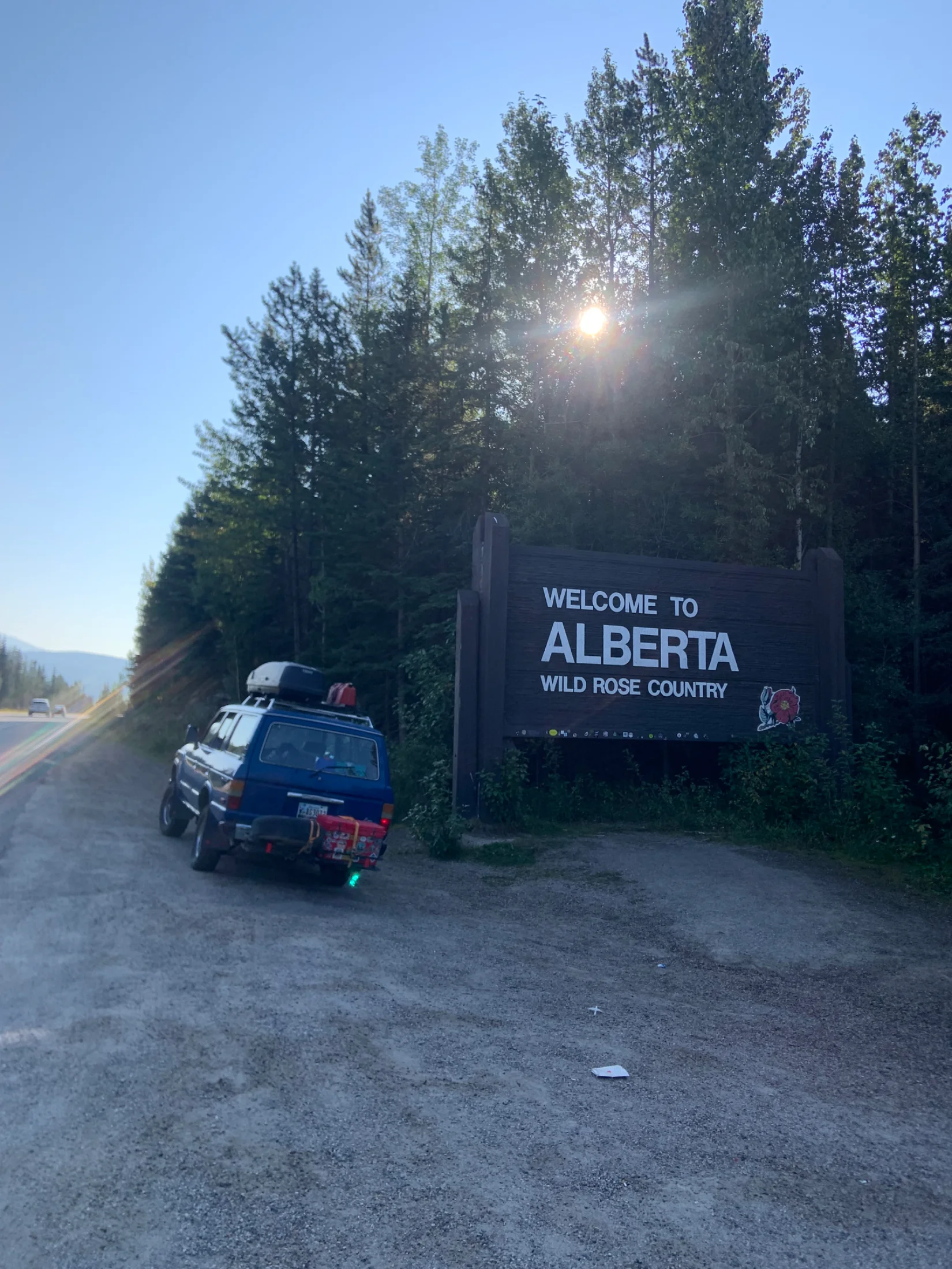

Yesterday I went from east of PG to Calgary AB where the truck blew up.
I did some small diagnostics to see if it was a stuck injector or the water pump. So I cracked the fuel lines. No change to the noise. Then I took the fan belt off the water pump to see. No change to the noise. Uh oh.
I still had the long drive through the icefield parkway to get to Calgary. Lots of hills and lots of elevation gain and worst of all, no cell service.
So as I drove back into Alberta, the knocking was getting really pronounced. In hindsight, I probably should have pulled over and had the truck towed into town, but I was too confident and hopeful that it wasn’t something catastrophic.
As I made it to Lake Louise I got cell service again but still had a 2 hour drive left. Yikes. The rattling got worse.
So I drove at a meagre 90km/h the whole way back and eventually made it into town. The knocking was really bad by now. But I made it. I made it to a city where I had contacts so I was hopeful.
This entire day I would shut the engine off on prolonged downhill sections and coast down in neutral so that I didn’t have to use the engine. I think I saved it for a few extra kilometers that allowed me to get home thankfully.
Once I was in Calgary, I made a drive to my old house that I still own and was planning to pop in for a quick visit then visit a mechanic buddy to get the problem looked at.
Just as I rolled up to a stop light only a block or two from the house. I shut down the engine and when I went to restart it and pull away, I was in first gear, pulling away and then BANG!! I heard a loud noise and then the sound of a whole lot of metallic noises fill the drain pan. It sounded like someone took a punch of pennies and tossed the into the engine block. And then, nothing!
The engine continued to run and there no longer was any knocking! What the heck???
So I immediately pulled over and shut the engine down. I walked back to the spot on the road it blew up and looked for oil or any indication that I punched a hole in the crank case.
Luckily no Swiss cheese engine block.

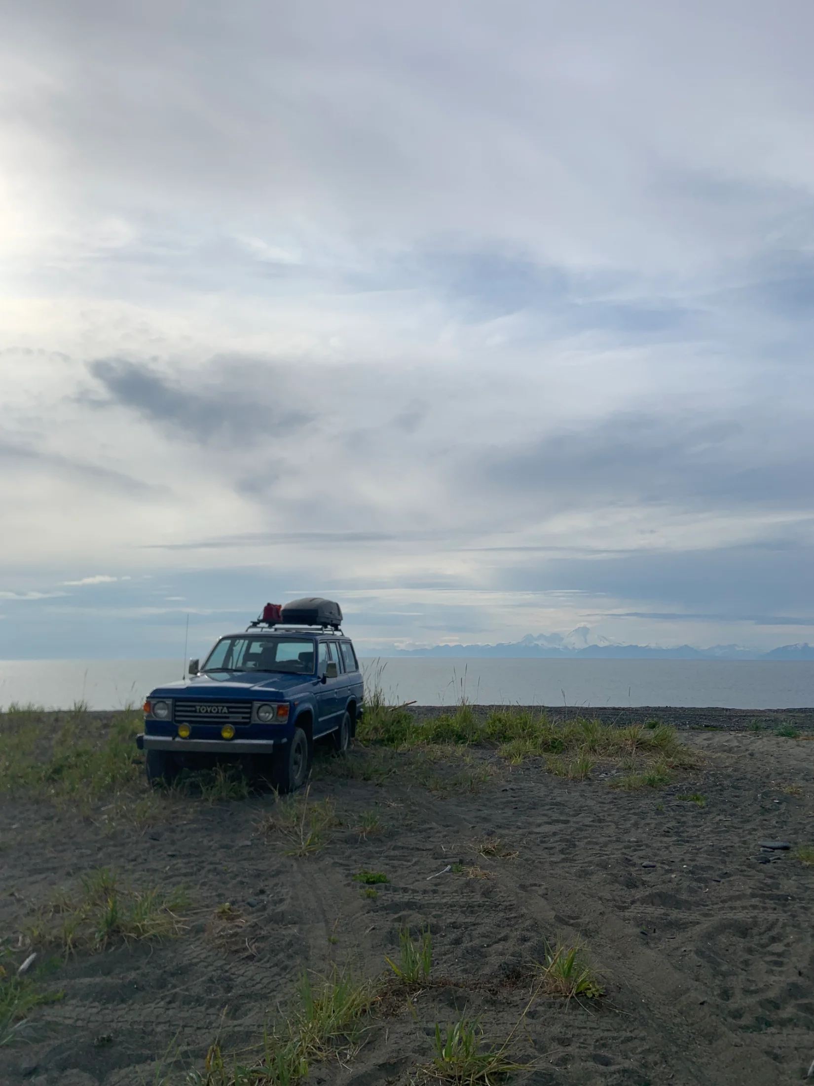

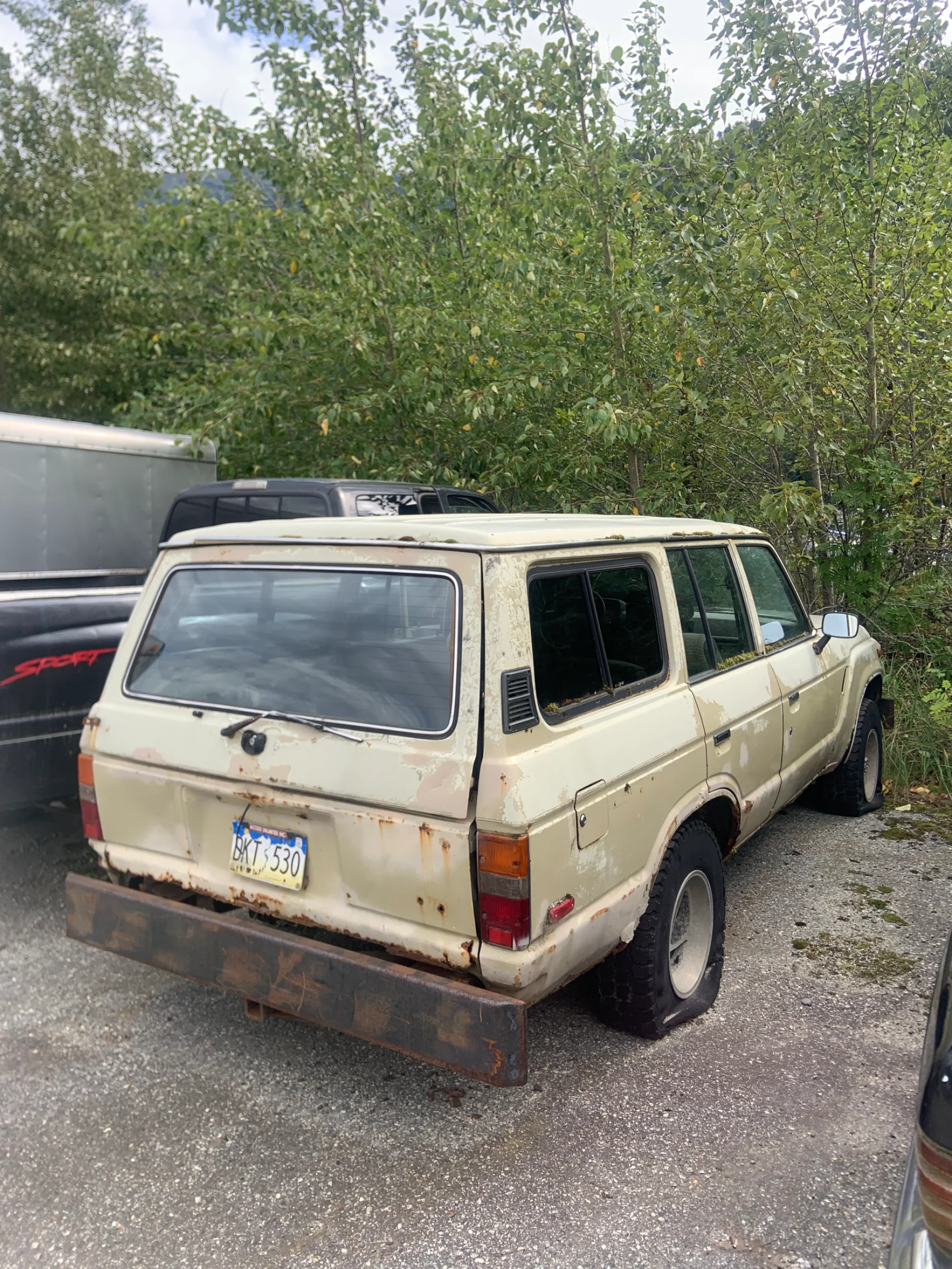

That 60 is abandoned. Was it a diesel?
I’d be getting that thing right now lol.
Hahaha yeah I should get a flight back to Alaska and see if I can find the owner!
