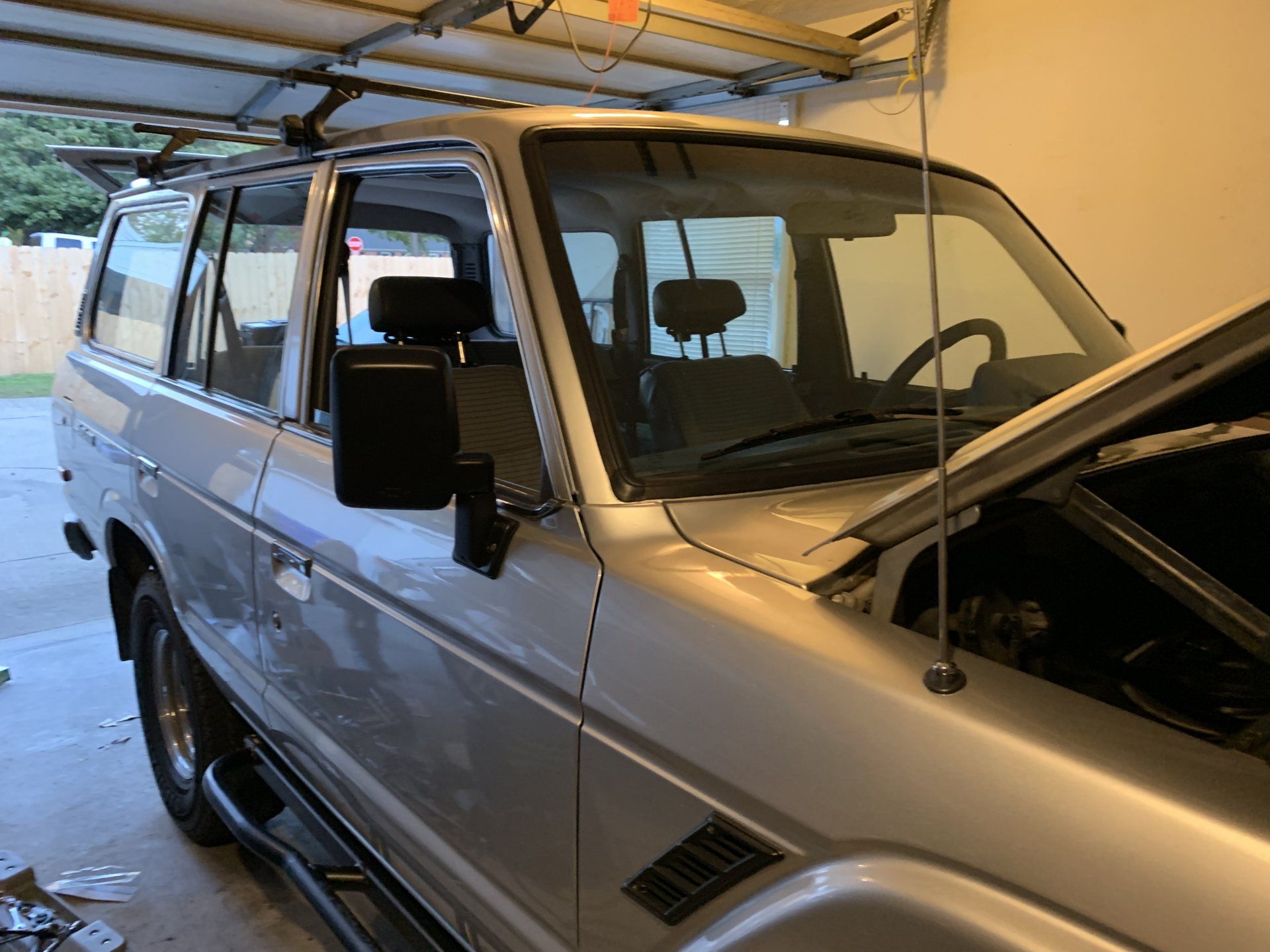

Installed the rock sliders I got from White Knuckle Offroad. I had decided that these would eventually go onto truck #2, but putting them on Chloe was a lot easier than finding a place to store them or continuing to trip over them in the garage. Should work pretty well as a step for the kids anyway.

Started re-finishing the FJ62 mirrors I harvested from truck #2.

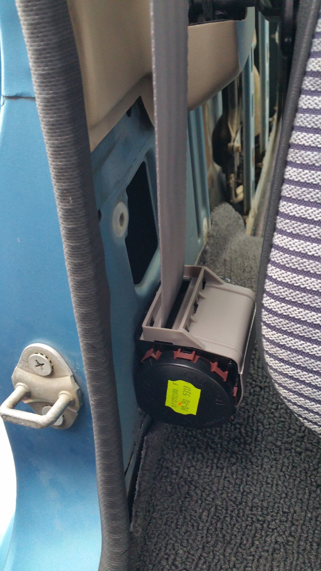

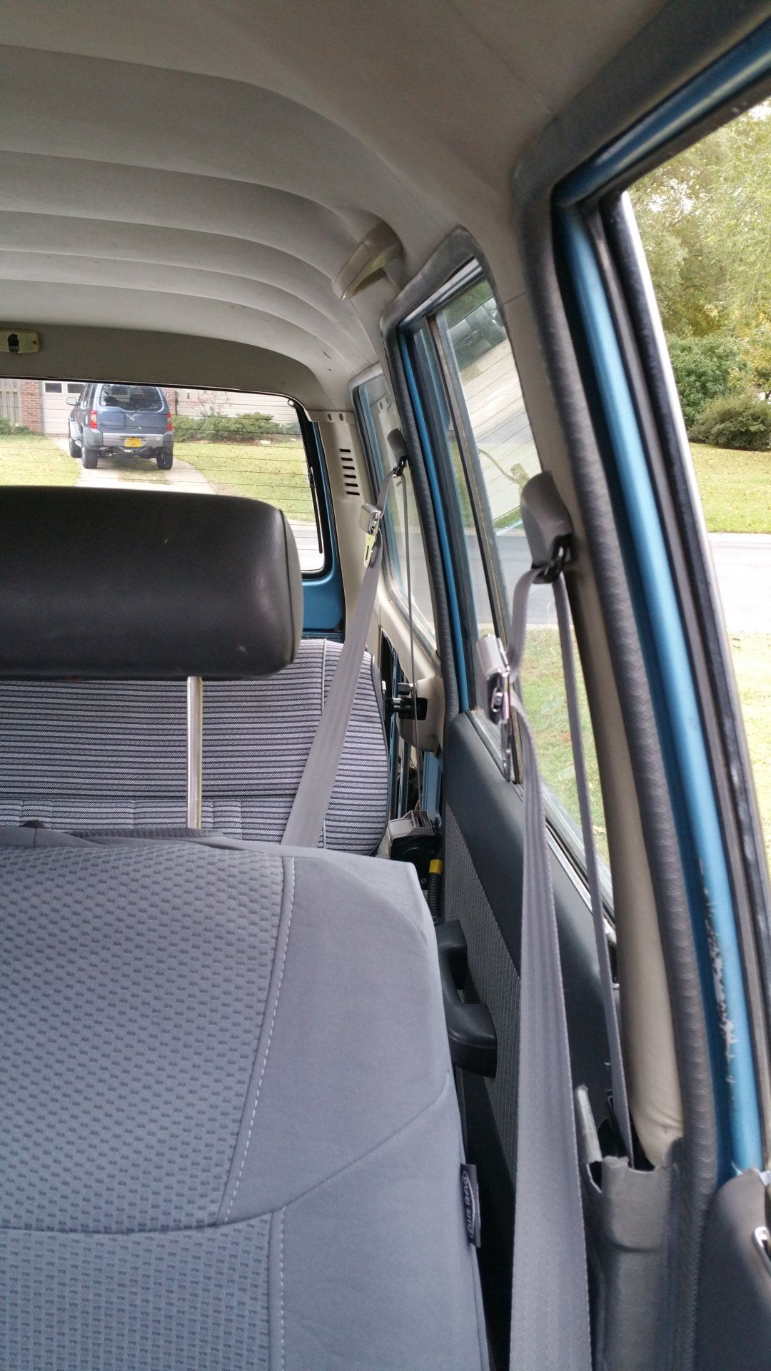

Dude props on the rear retractable seatbelts. I need to do this as my wife does not like my kids riding in the 60. My C-pillar has a drilled and threaded hole for the shoulder strap. Did you get your set through Seatbelt Planet? What rear retractable seatbelts did you get?
Yep, Seat Belt Planet. My wife was the same. I went with the FJ62 replacement rear belts (belts) because the ones that come up for a 60 are non-retractable. The longest part of the install was getting the nut set in the pillar, but it sounds like you're one of the lucky ones.
My little one (5 yr old) loves it now because the belt fits her properly without a booster seat and she can see everything from the windows.
I 2nd that with the kids! My 8 year old doesn't need booster and the 5 year old is border line. They both love riding in the cruiser and the view out.
I got the seatbelt planet belts with re-tractors. The kit was easy to install for the most part. The Seatbelt Planet part number is 5033165 and included a new center lap belt. I also replaced both my front belts as the driver side was shot. Pics are before i got side panels back on. You can reach thru body and hold very large washer at retractor. They are very well made and work perfectly. Glad i did it.

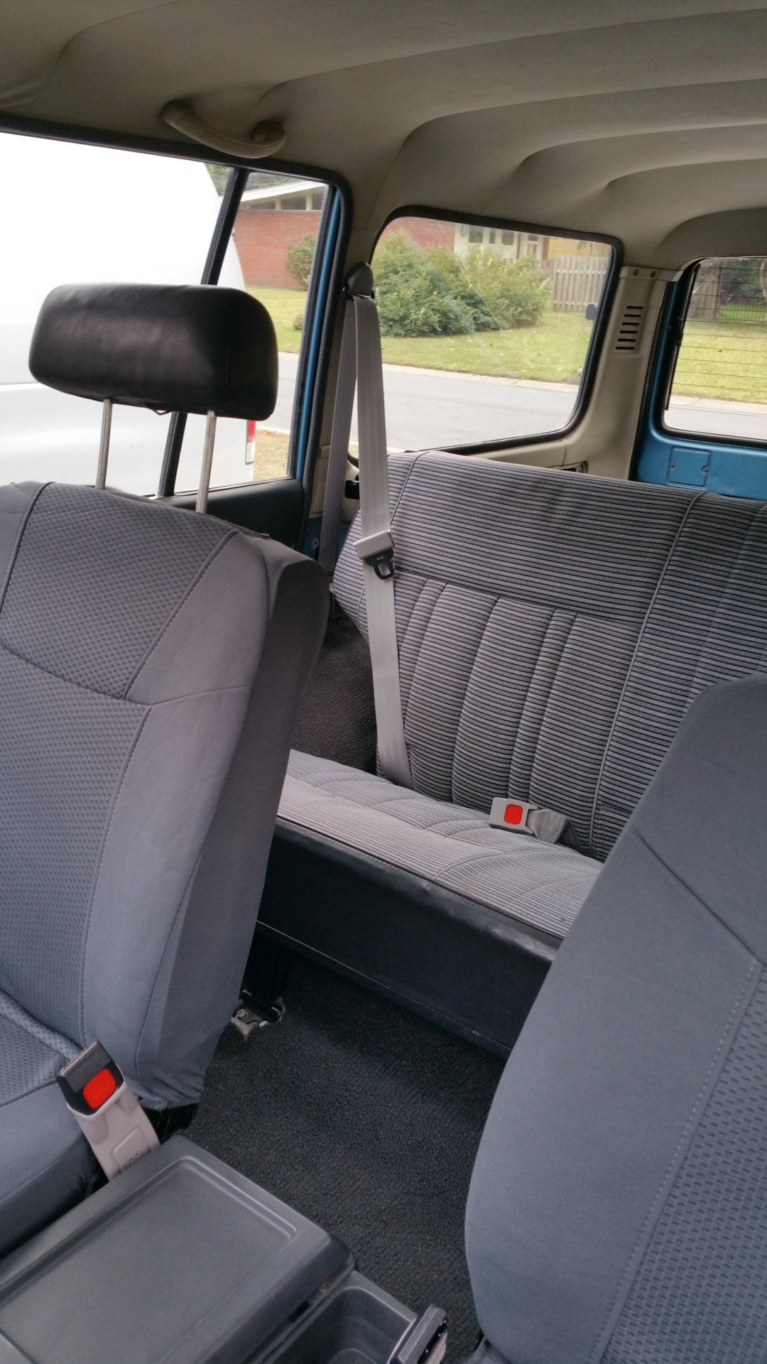

Is that color the gray 65?
Yeah @4runner2FJ60, what's up with those front seats? I like that.

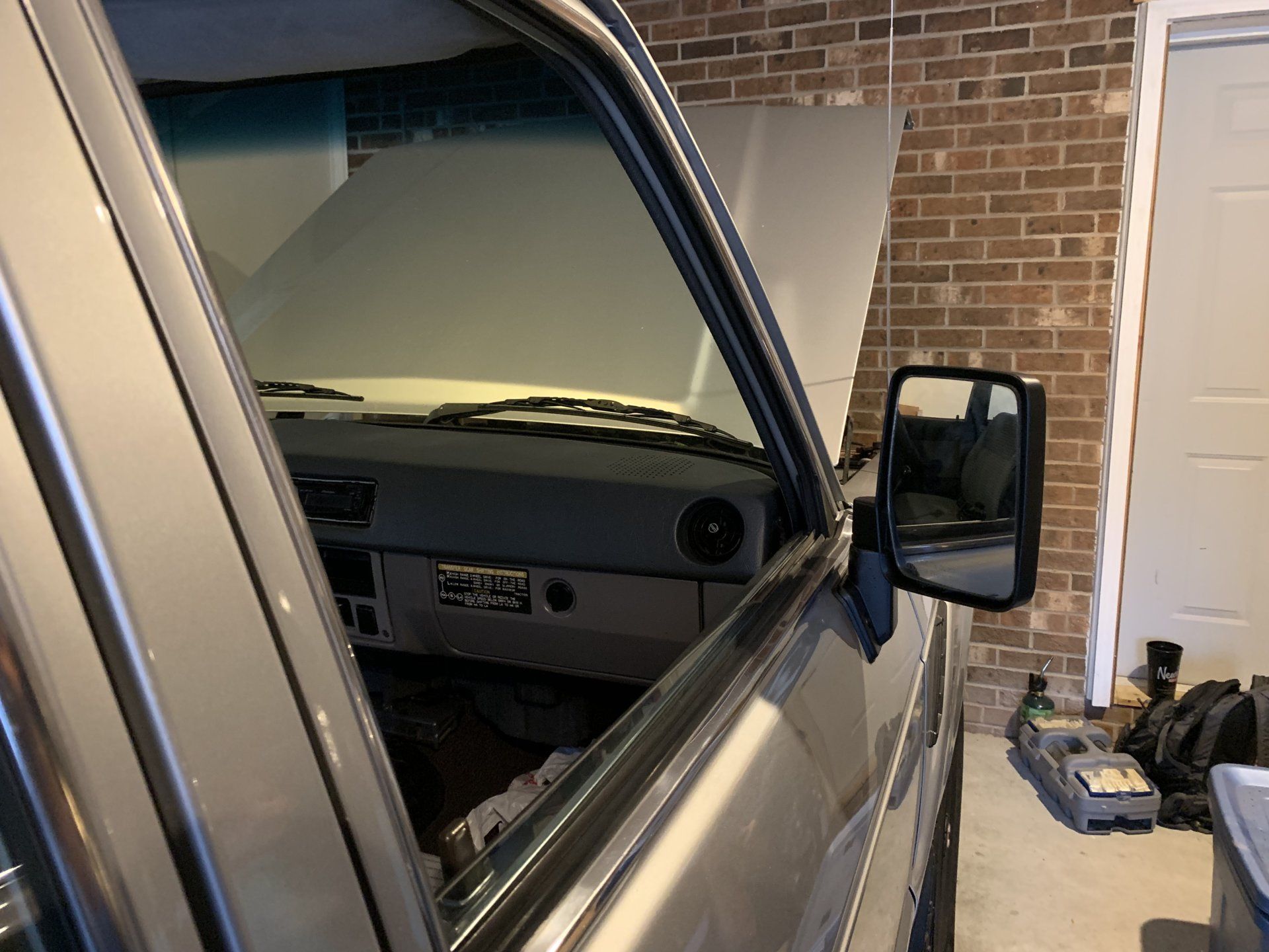

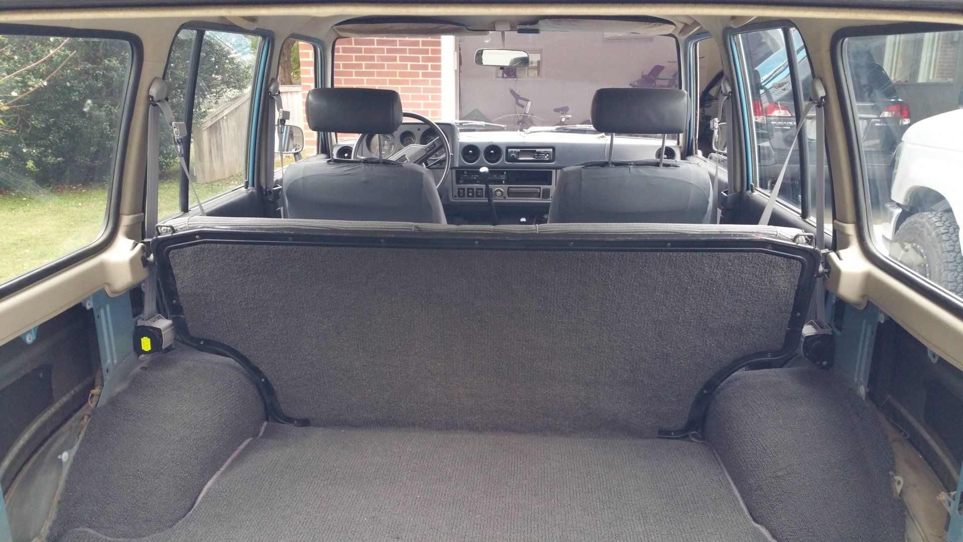

Didn't have time today to devote to fully tearing the carb down so I turned my attention to knocking out a couple other smaller projects I haven't finished. Put a final coat of paint on the FJ62 mirrors I harvested from my '85 FJ60 project truck and mounted them on Chloe. Also grabbed the '85s headrests that were in better shape than Chloe's originals. Much, much better.....

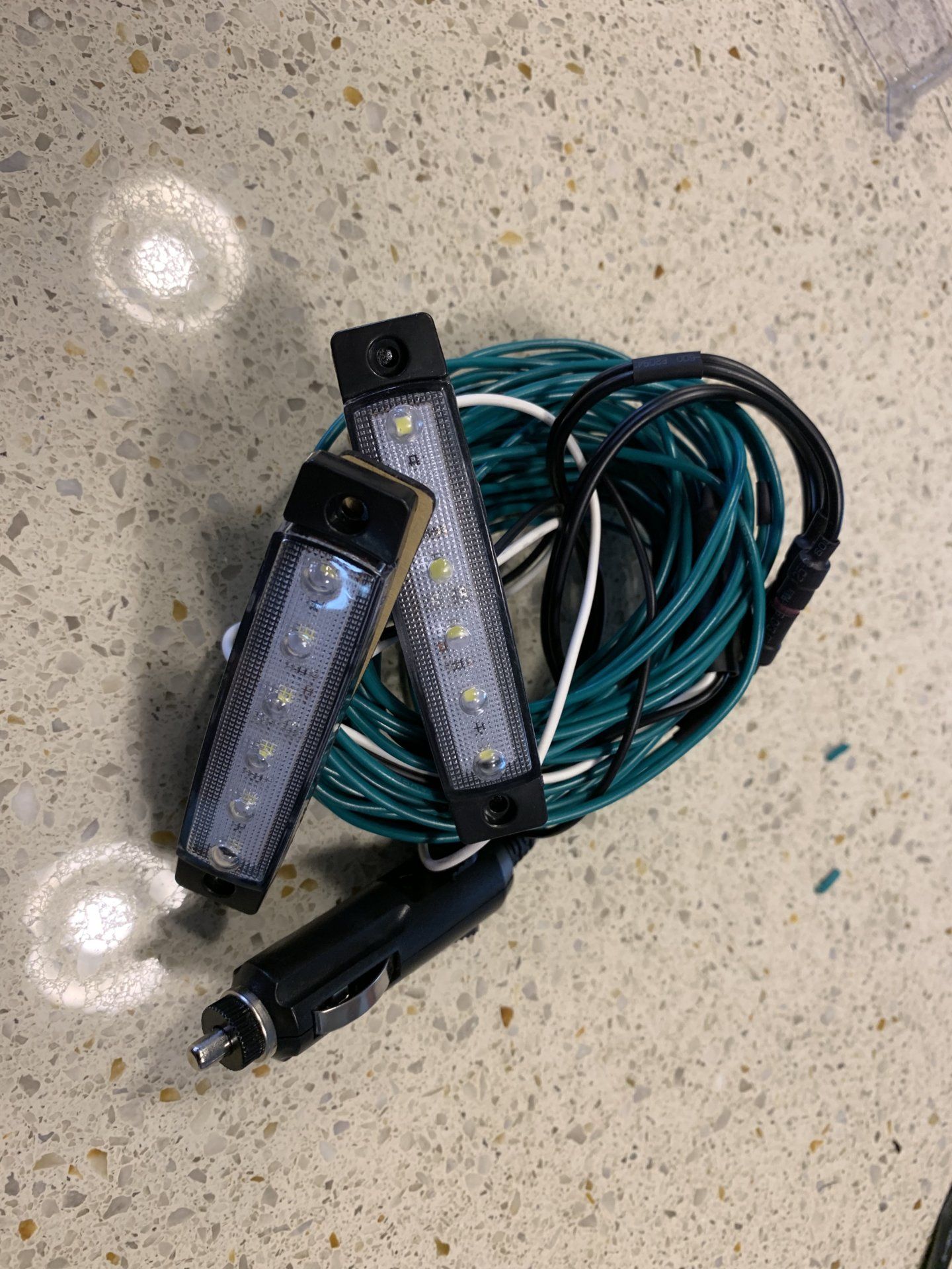

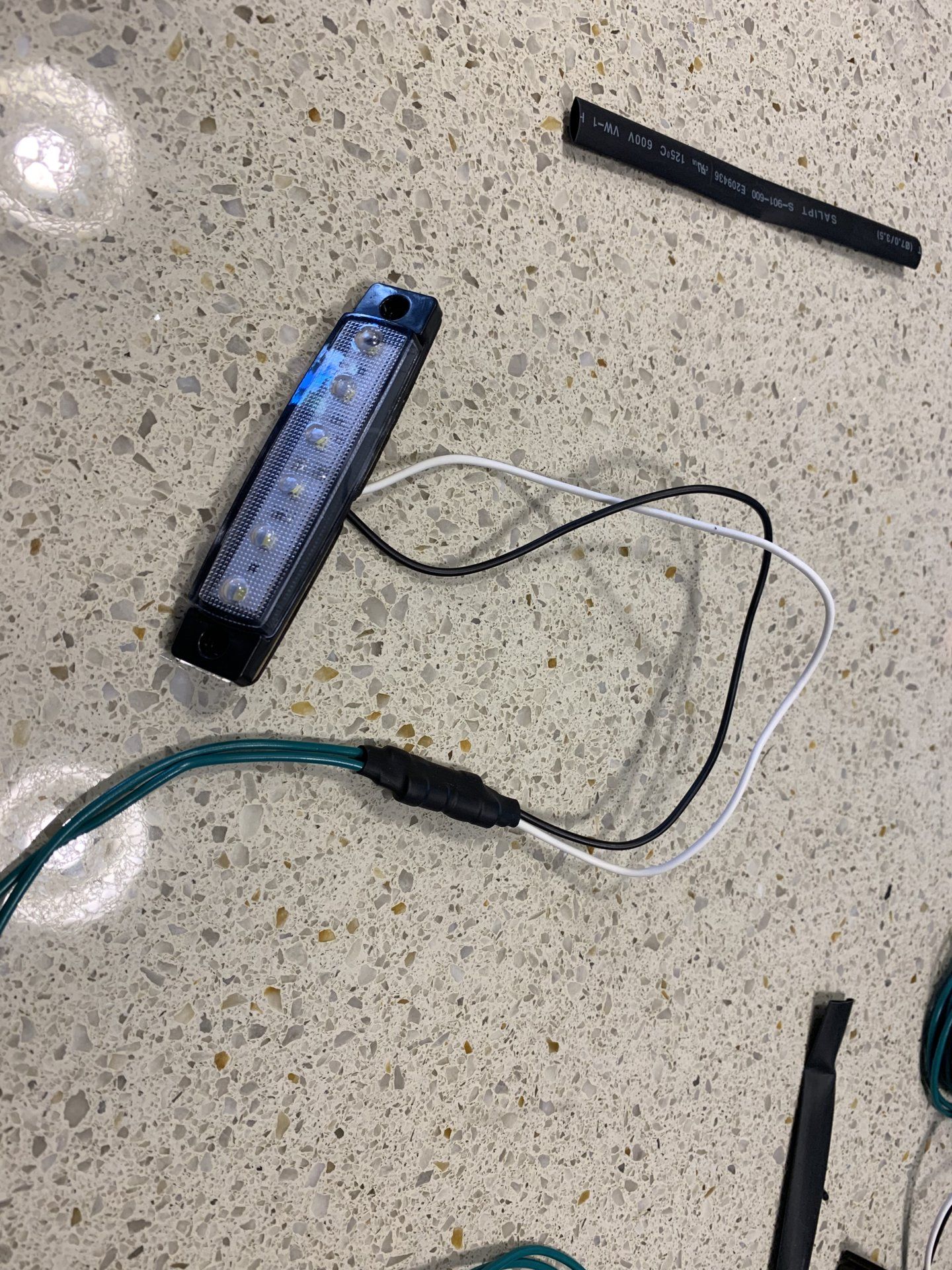

In addition to pulling the carb and finishing the mirrors, I worked on a little electrical project. I grabbed some bits and pieces I had laying around and made a 12v work light. While I was out getting primer for the '85, I grabbed a cheap 12v socket splitter and 40 feet of wire. I chopped off the 2 receptacle ends of the splitter and added long leads with a couple marine LED lights I had.
Add a few connecters and some heat shrink....
Now I've got some LED lights that can reach from my 12v outlet on the back of the center console to just about anywhere on the truck. I just want to add some magnets to the backs of the lights and wrap the leads in something to help prevent tangling. Works pretty good.
What front seats are you running? They look great.
Hey @MACFJ60 The front seats are original as are the back, but fortunately this cruiser didn't have many rear passengers as far as i could tell. The fronts are a different story but in order to get this thing more presentable for the time being i found those front seat covers at Advanced Auto Parts for $40! It beats 1k upholstery job many times over for now! Many people have thought they look good for what they are........."it even has airbags!" :rofl:
