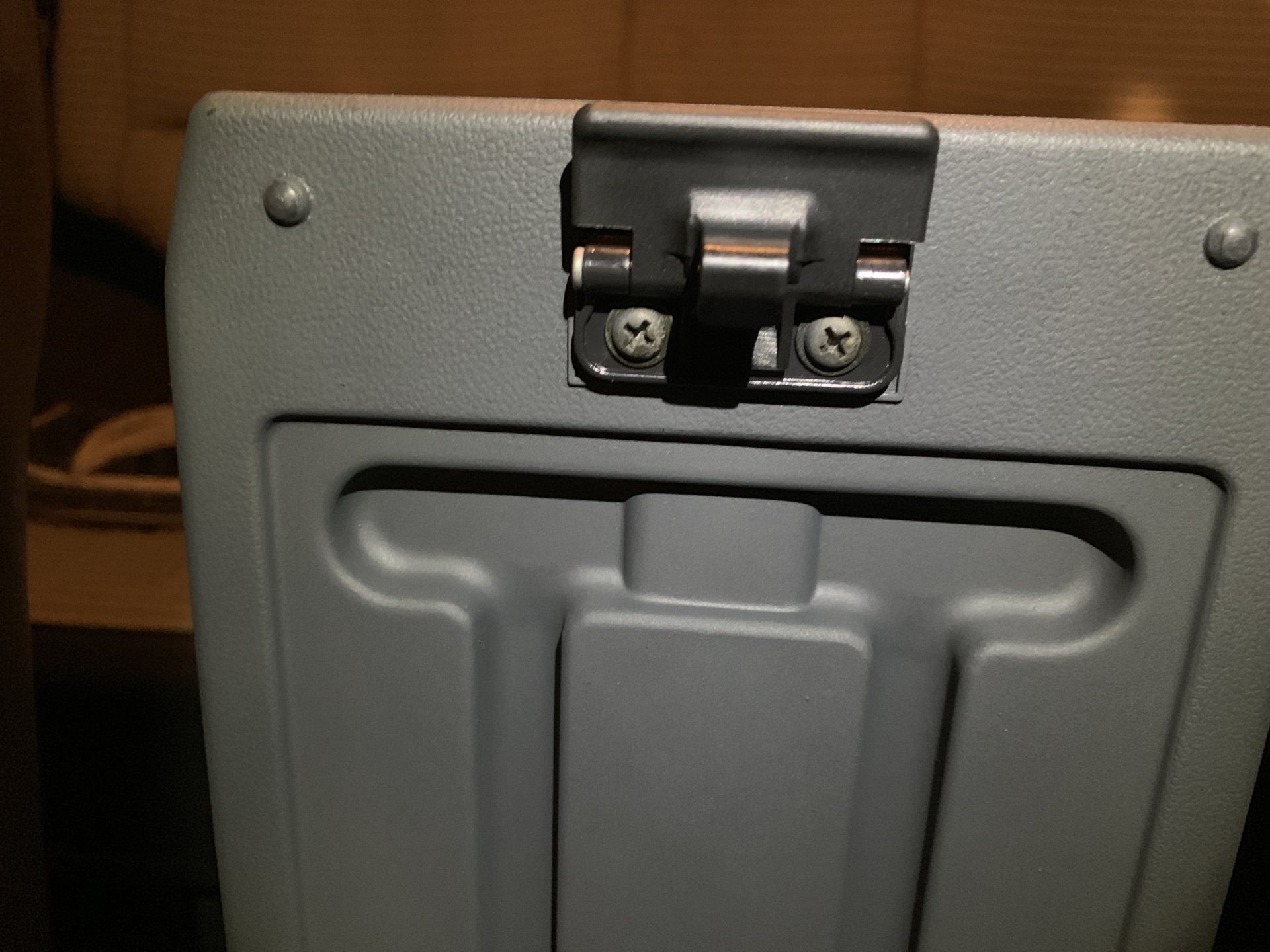

Replaced the broken latch on the center console. My life feels more complete now 🙂

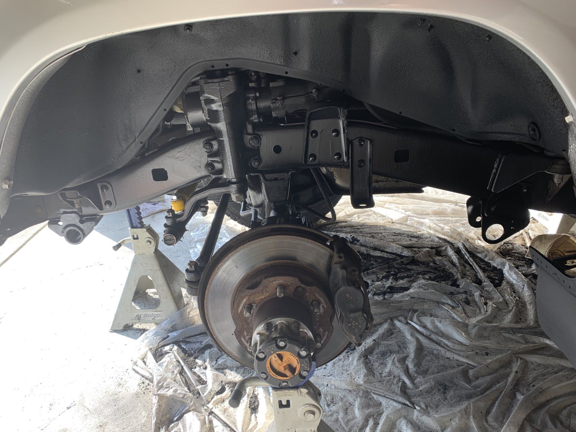

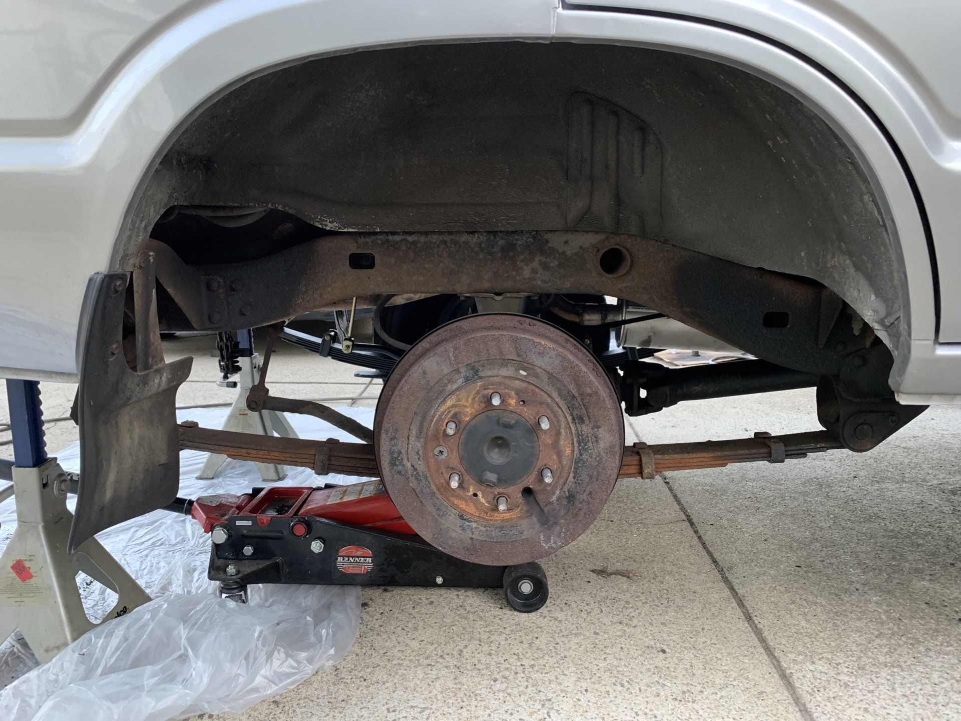

FINALLY....the lift is done. Had Friday off so I worked on finishing up the rear part of my OME lift. Took ALL day and then some, minus a lunch break and parts store run with the Mrs.
Went pretty smoothly. No real hang-ups at all. It just took forever because I was addressing rust spots and cleaning up the parts it was easy to get to with the wheels off.

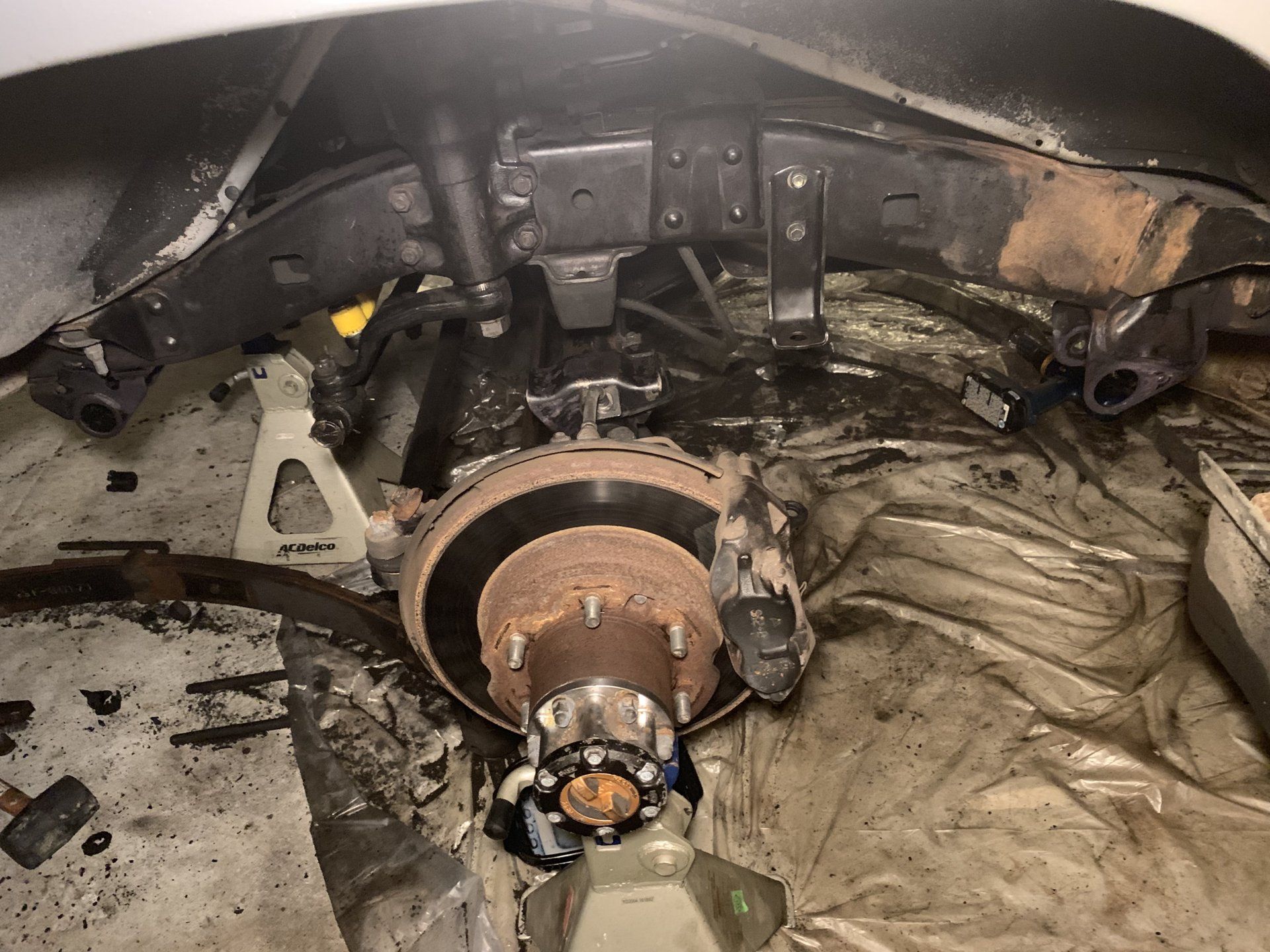

From last weekend. What I started with....Not that the truck is doing bad, but this was the best looking wheel well area of the four.
How it ended up.
PS rear..
DS ready for a suspension...
DS installed. Little bit of a difference!
Glad it's finished. Whole truck pics tomorrow. Time for sleep now

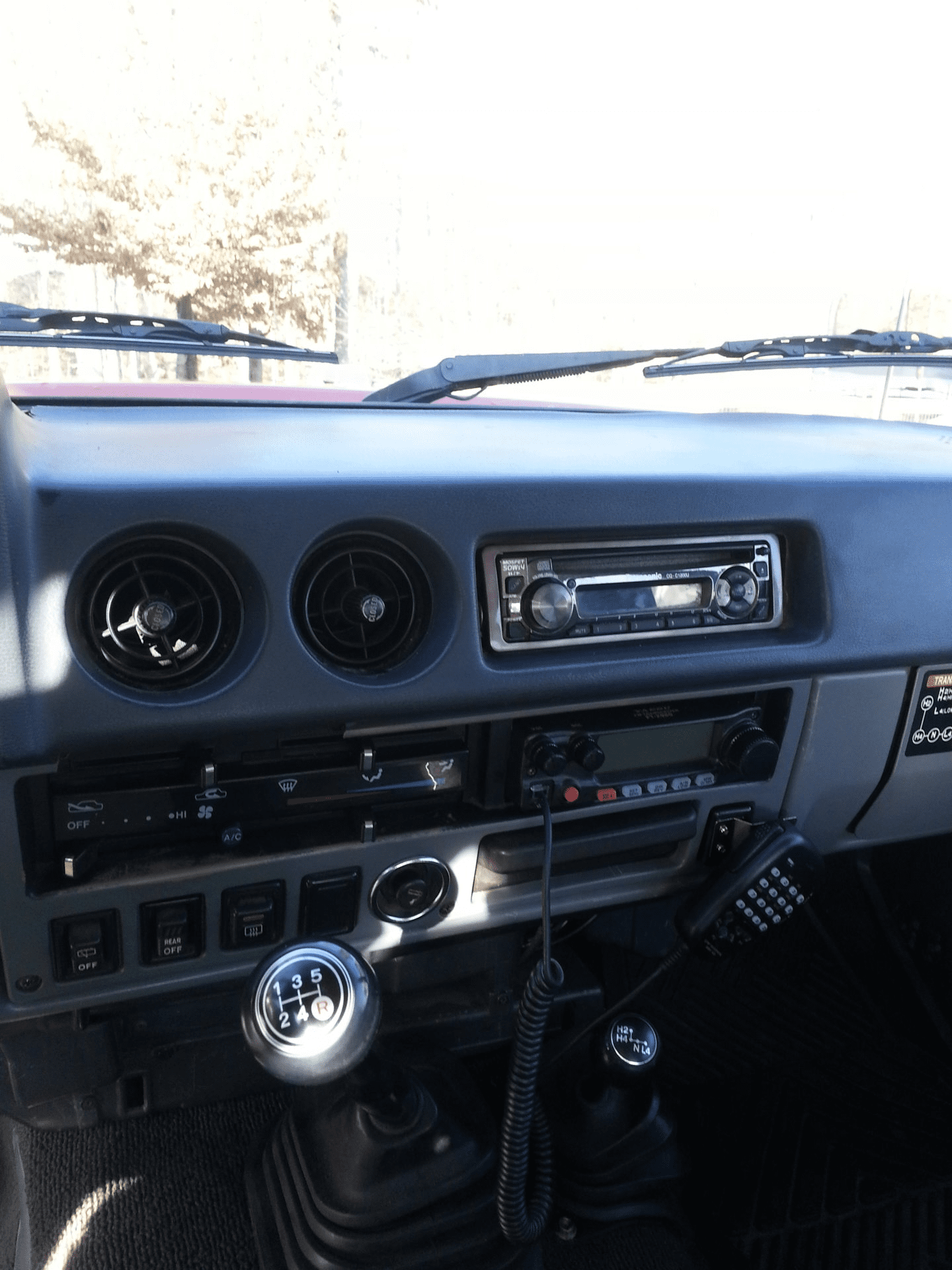

Nice work. Looking good. One trick I learned here many years ago is that you can swap out the center vents for the side vents that close. Just look for some in the classified section. All you do is turn the vent (ball shaped part) sideways and yank it out, then push the replacements in. Now you have center vents that can open and close.
@FJ Noob Congrats on the new rig. Looks sweet.
Not to highjack this thread...
G-Man, I need to know more about that HAM in the Sandwich holder. I want that same set up.

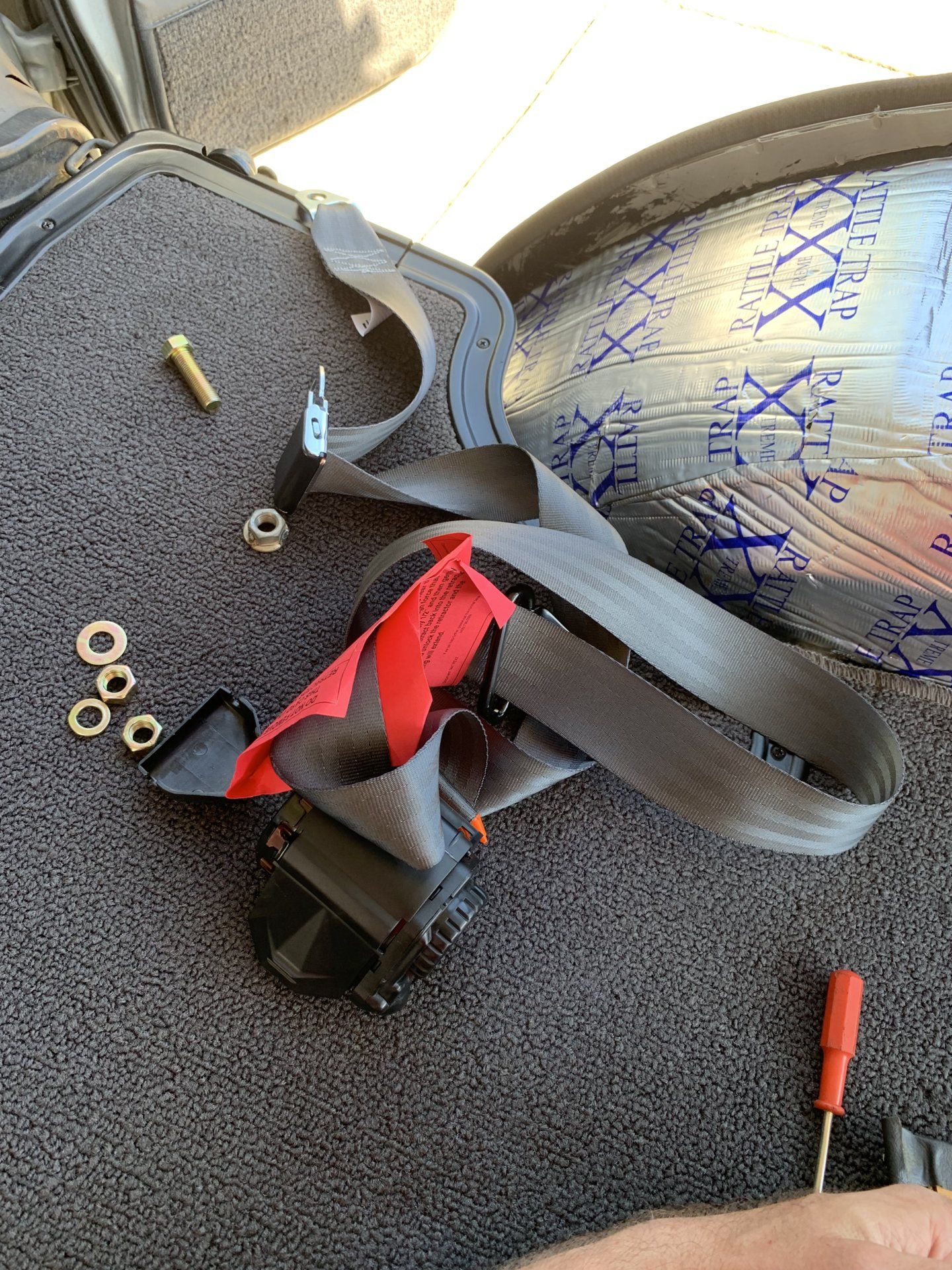

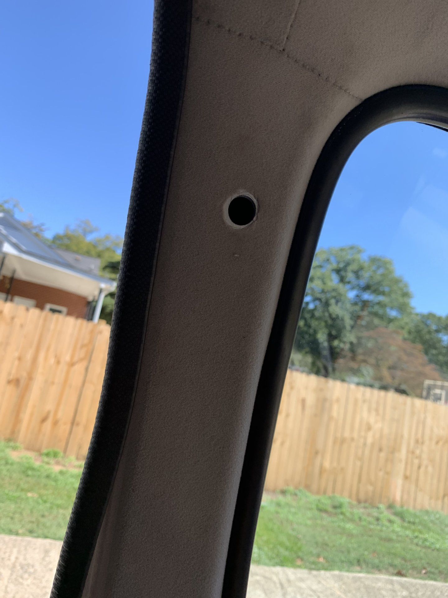

Ok, today’s scheduled project; adding 3-point seatbelts to the rear. I haven’t been looking forward to this one, but have read just about every thread on the subject. I’m probably as ready as I’m ever going to be.
Of course there is no threaded nut in the hole. I knew my luck would run out eventually. Well, if something wasn’t going to go my way, this is about as good as it can get. Now, where’s that JB Weld?
