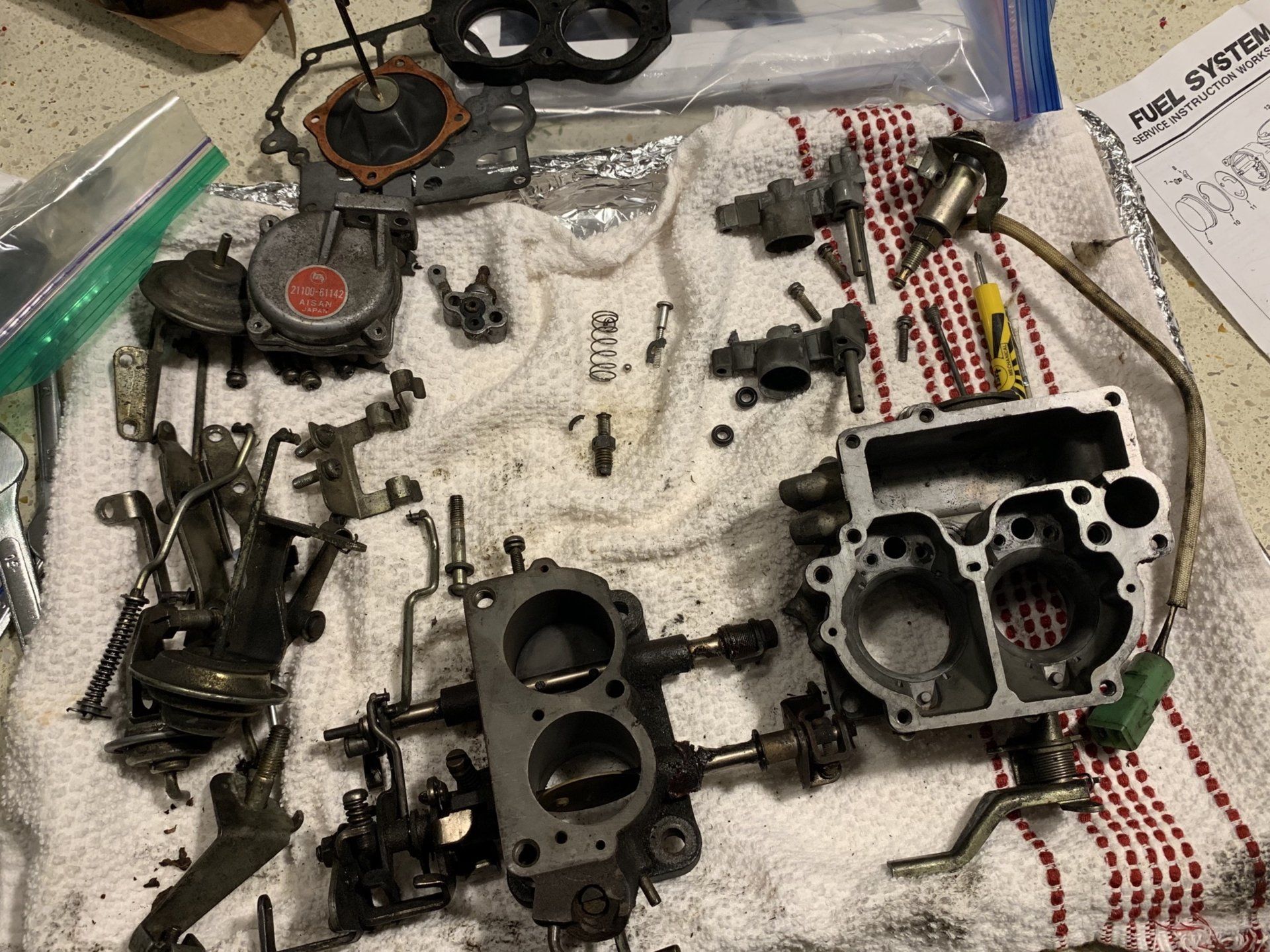

Soooo....admittedly I’m a bit impatient. I got bored after the kids went to bed and started my carb tear down. Pretty straightforward while watching Pin Head’s video series and having read the FSM section a couple times. For as good as the truck had been running, I found a few interesting things....
LOTS of what looks like rust particles... I would say possibly from the gas tank, but I put a fuel filter in 3 weeks ago have run 2 tanks through it. It still looks as clean as when I pulled it out of the package.
This is where the fuel line attaches
2) there was no little ball in the check valve under the accelerator plunger sping

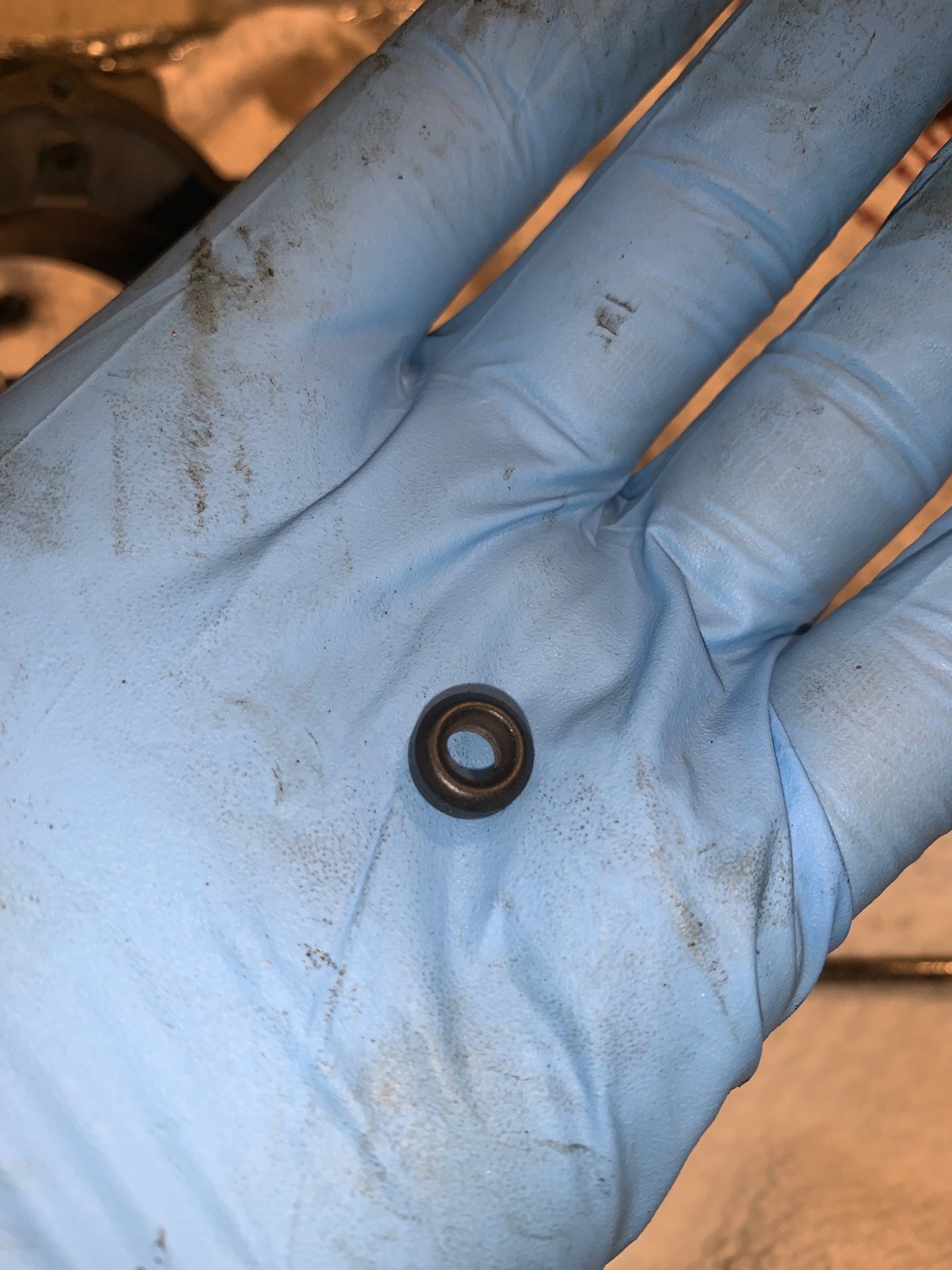

3) this random fat rubber o-ring looking thing was floating around in the bowl. Anyone know what it is? Nothing like that in Pin Head’s video and I’m having a hard time finding it in the parts schematic in the rebuild kit. @NeverGiveUpYota ...did you run across anything like this in your rebuild?
All finished though and ready for a dip!
That would normally sit on top of one venturi. It’s like a little donut gasket. I see two below the lower Venturi... was the one in the bowl a 3rd or one of those two?
No, there were just 2; 1 in the bowl and the other fell out of I don’t know where when I separated the air horn from the body. They were never on top of the venturis the first time I pulled the air cleaner assembly and looked in. Since the second one dropped out, I was focused on them going around a jet or in a hole with a spring.
Thanks for the help. Hopefully the next set of pics include a nice shiny rebuilt carb!
I don't see main jets removed in your pic? Did you get them out? FWIW don't get the check balls, jets main or secondaries, venturis mixed up. I found it much easier to get the check balls out with a slim punch with a strong magnet touching it as apposed to the tweezers that the FSM mention.
The jets you get to after removing the side bolts? Yes, they were removed. BTW, I'm only counting 2 check balls to be replaced...I'm assuming. Is that correct? The small one was missing when I pulled the retaining spring. All the other parts got marked/photographed in detail so I don't put them in the wrong place.
At this point, I have more pictures of this carb on my phone than I do of my kids :rolleyes:
Yes two check balls smaller one is goes in the bottom of the plunger the other is the counter weight. this is described in the FSM with not so clear pictures.
Between the FSM and Pin Head's videos, it make pretty good sense...but yes, being able to zoom into a hi def picture sure would help!

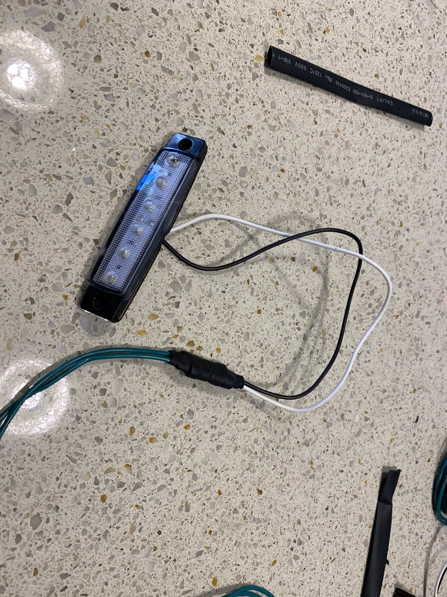

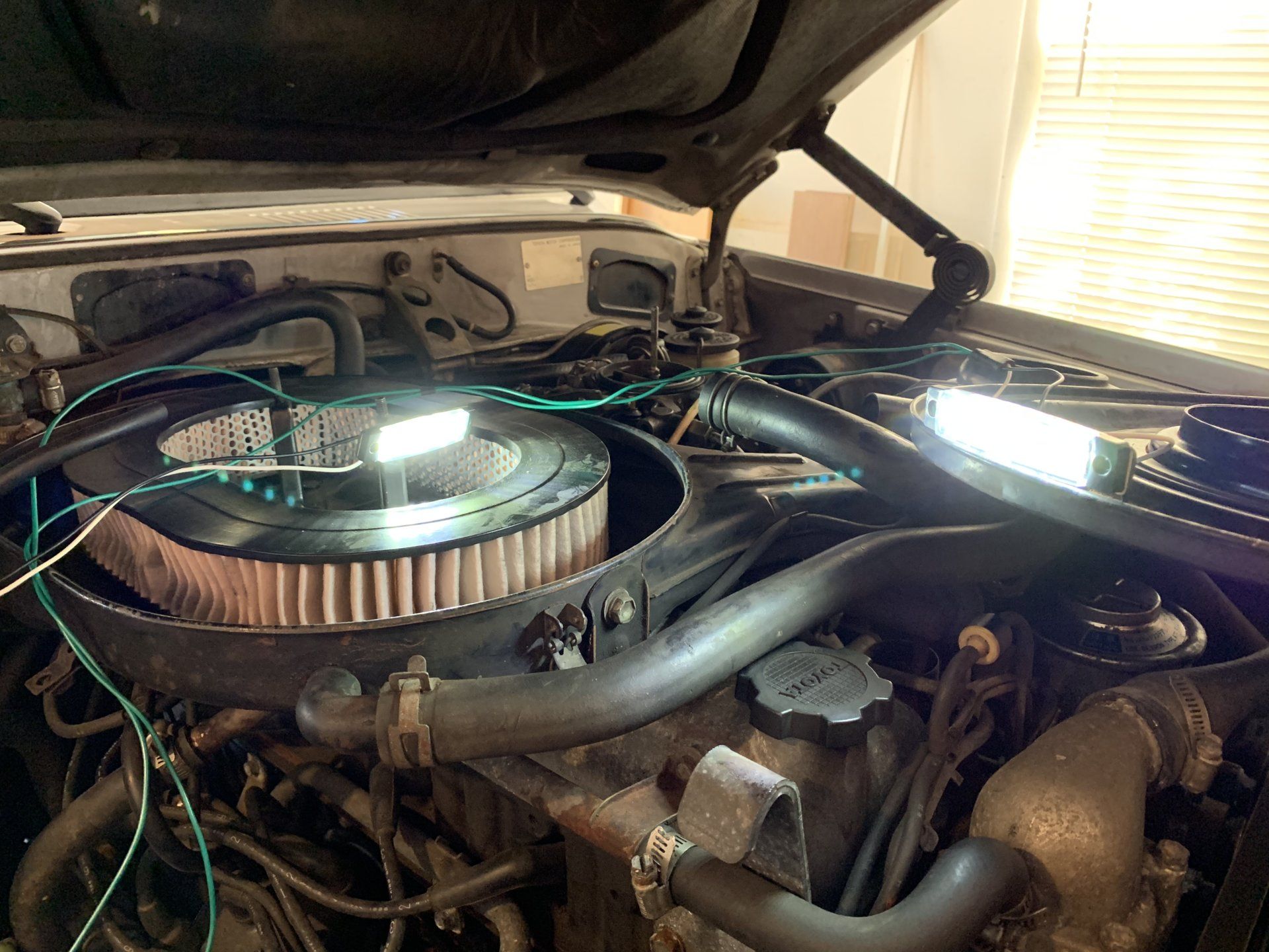

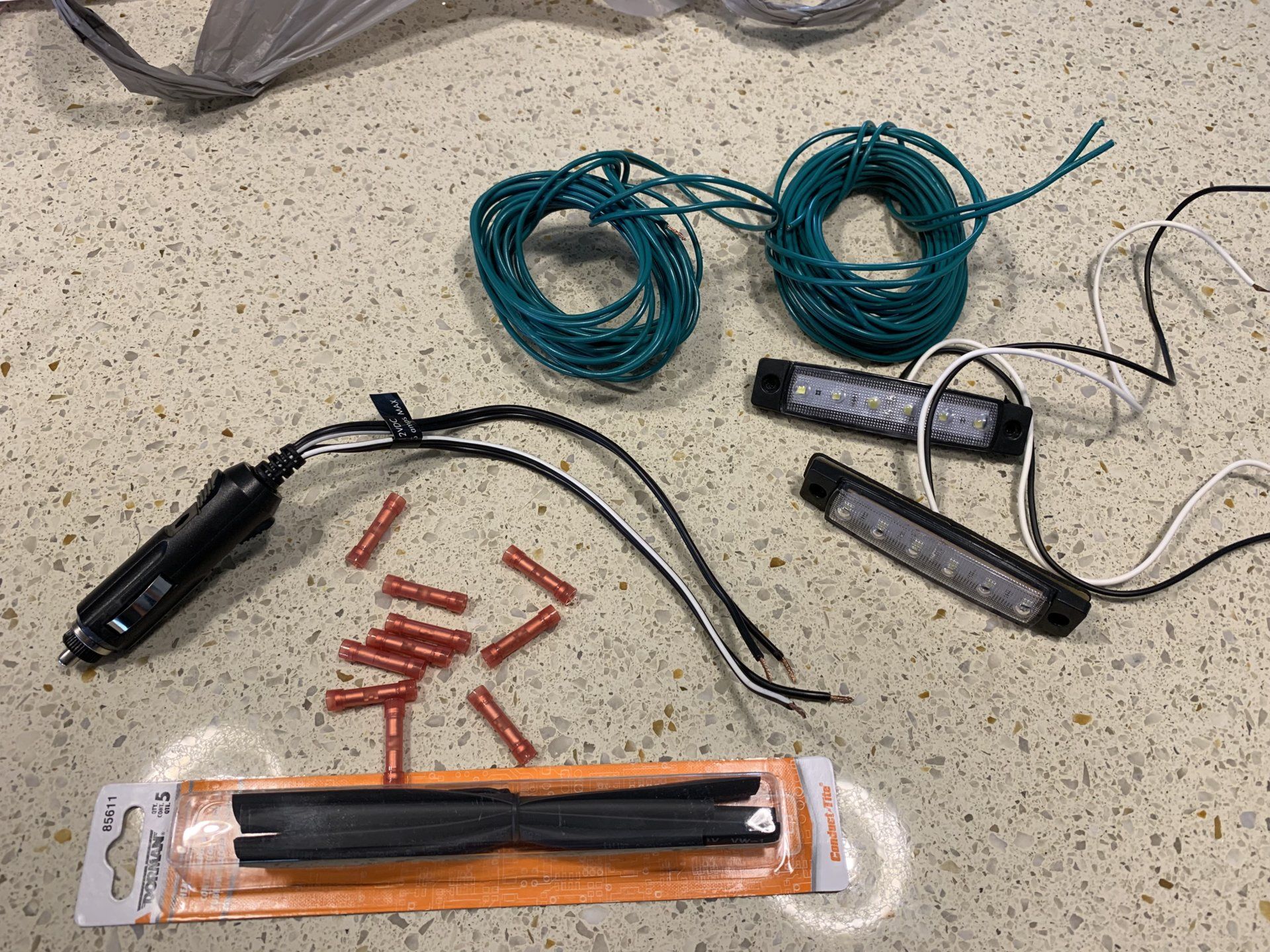

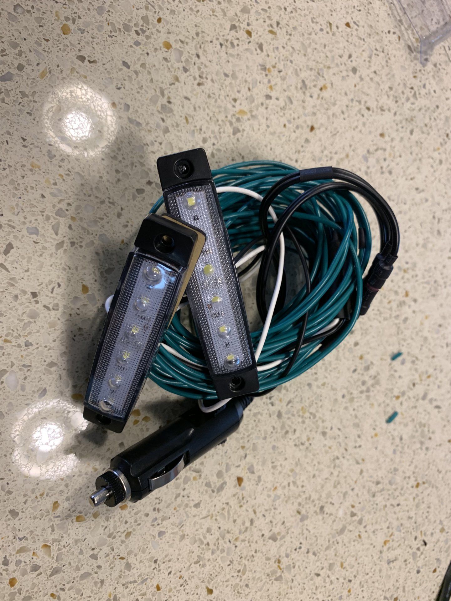

In addition to pulling the carb and finishing the mirrors, I worked on a little electrical project. I grabbed some bits and pieces I had laying around and made a 12v work light. While I was out getting primer for the '85, I grabbed a cheap 12v socket splitter and 40 feet of wire. I chopped off the 2 receptacle ends of the splitter and added long leads with a couple marine LED lights I had.
Add a few connecters and some heat shrink....View attachment 2130821
Now I've got some LED lights that can reach from my 12v outlet on the back of the center console to just about anywhere on the truck. I just want to add some magnets to the backs of the lights and wrap the leads in something to help prevent tangling. Works pretty good.

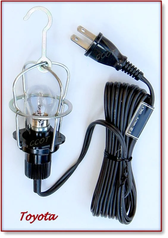

Nice addition. You made your own Toyota trouble light. There was a factory one available which uses the factory trouble light plug under the dash:
Not as good as LED but I always thought it was cool Toyota made this from the factory. They thought of everything.
Not as good as LED but kinda cool Toyota made this from the factory. They thought of everything.
Wait...WHAT :oops:!?! I knew there was the trouble light for the FJ40, but had no idea about the plug you showed since I have yet to see an FJ60 tool kit with the light. I'm going to go take a look on mine!
I don’t think the tool kit on an FJ60 included the light.
Someone please correct me if this isn’t so.
I believe you’re correct. I’ve seen it as an additional item listed, but didn’t pay attention because I didn’t think the FJ60 was set up to use it.
Some FJ60s had that plug, others didn't. The lower dash panel part number changed in 4/85, but don't know if that was one of the changes.
