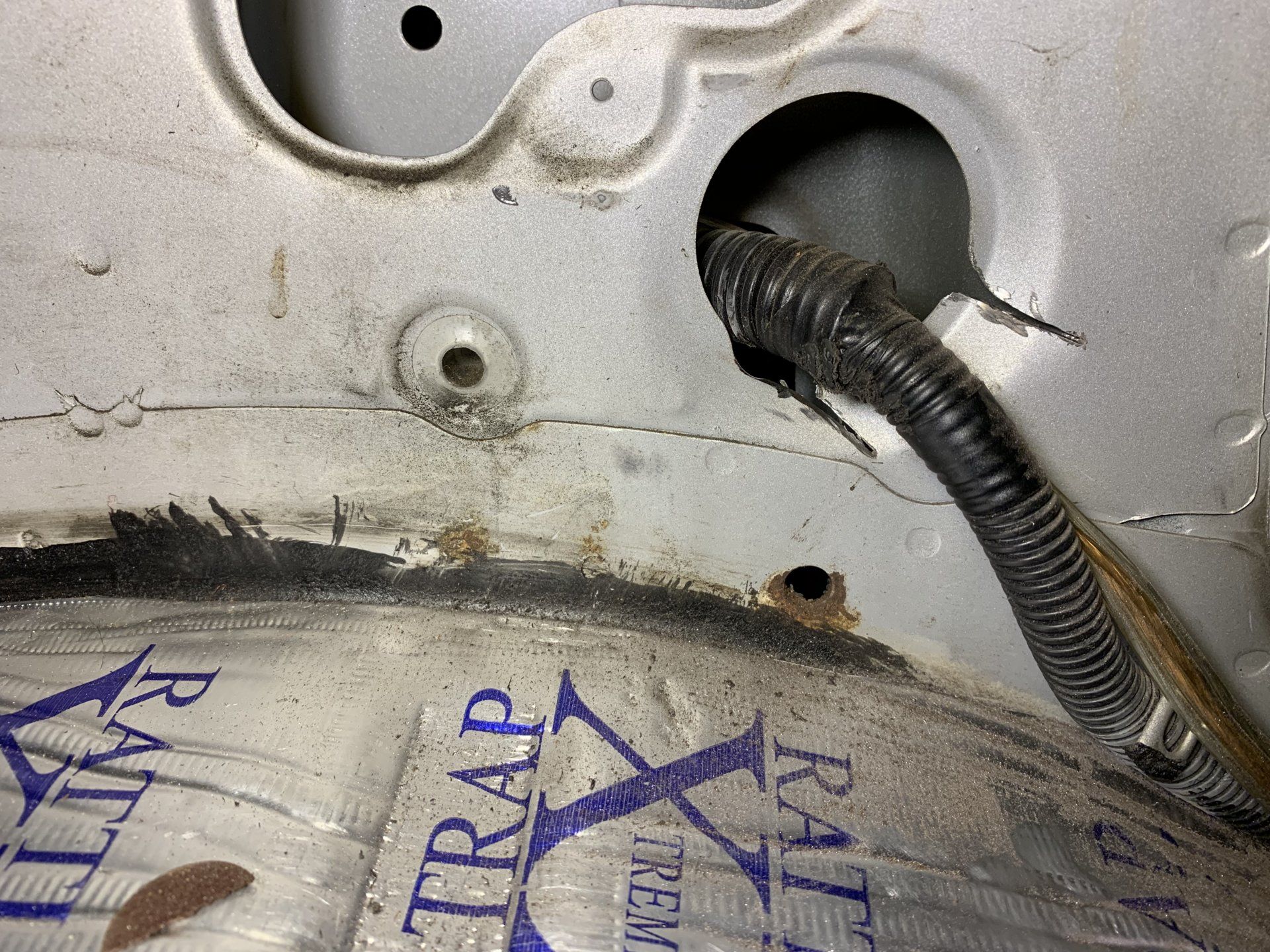

Welded up a nut and washer for the B pillar mount and fished some wire down to pull it into place. Nailed it first time on the practice run, BUT I couldn't get it back out to apply the JB weld. The practice run became "go time". I spread some JB weld around the inside of the pillar hole as best I could, pulled the nut into place, quickly cleaned up squeeze-out, let it start setting up.
Decided the easiest mounting option was going to be "outside the pillar" using the huge reinforcing plate/washer supplied by Seatbelt Planet. Cur out a little bit to allow the plate to sit flush inside the pillar....
Sharp edges cleaned up and hole drilled for mounting bolt...

I cut a little bit of the panel backer out so I could slip just the vinyl behind the retractor for a clean look. It was a tight fit, so I went back and added a spacer between the sheet metal and retractor. When you pull the original lap belt retractors, there is a perfect little spacer on the bolt you can reuse.
Retractor installed...
The longest part was waiting for the JB weld to set fully so I could absolutely tighten down the top bolt without shearing the weld and getting stuck with a bolt I couldn’t tighten or loosen. Not a problem for you though!! With the right tools, I bet you could be done in 3 hours easy.

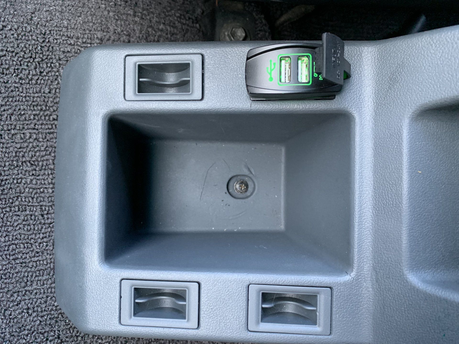

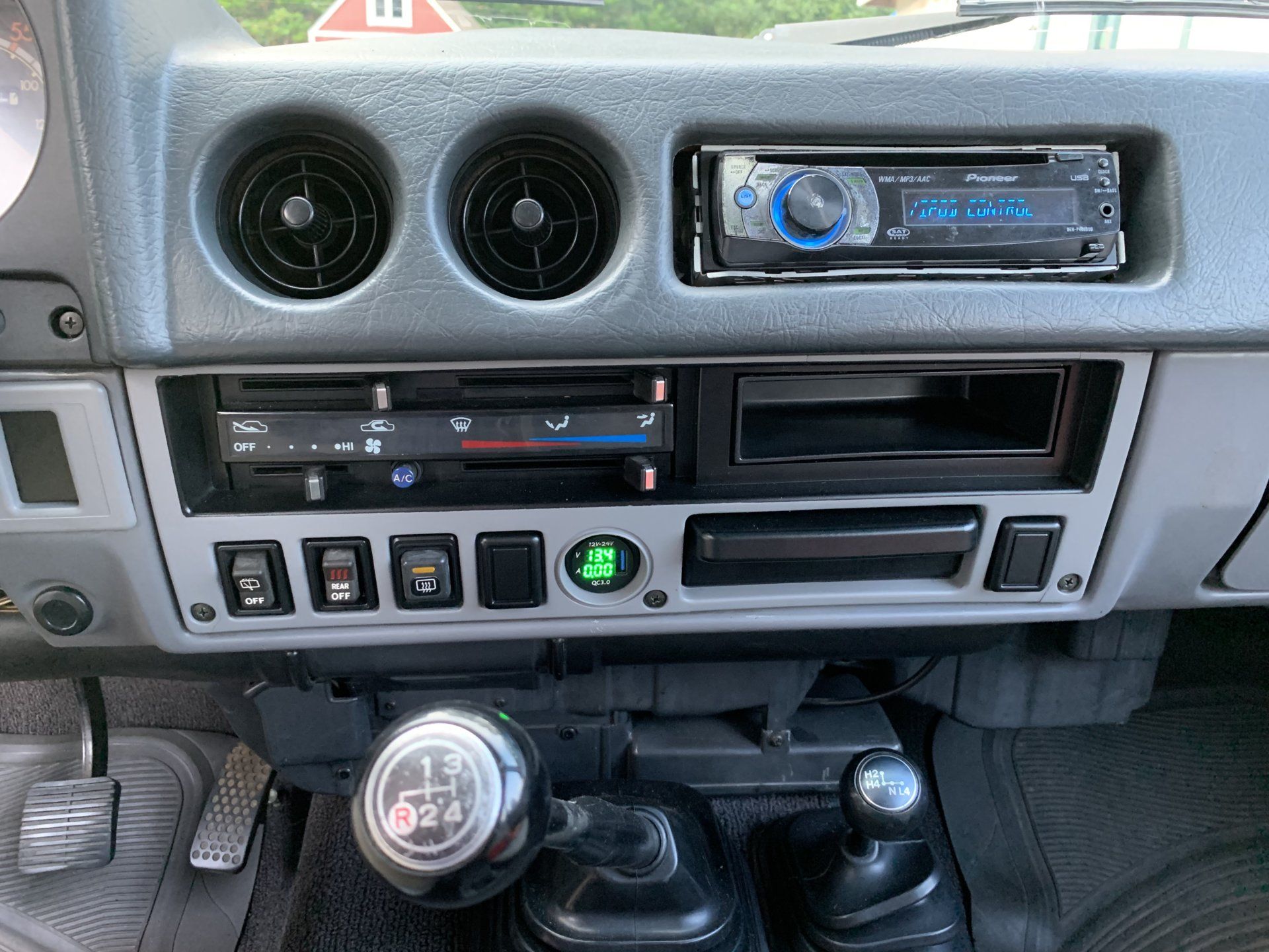

Drvr/Pass USB ports

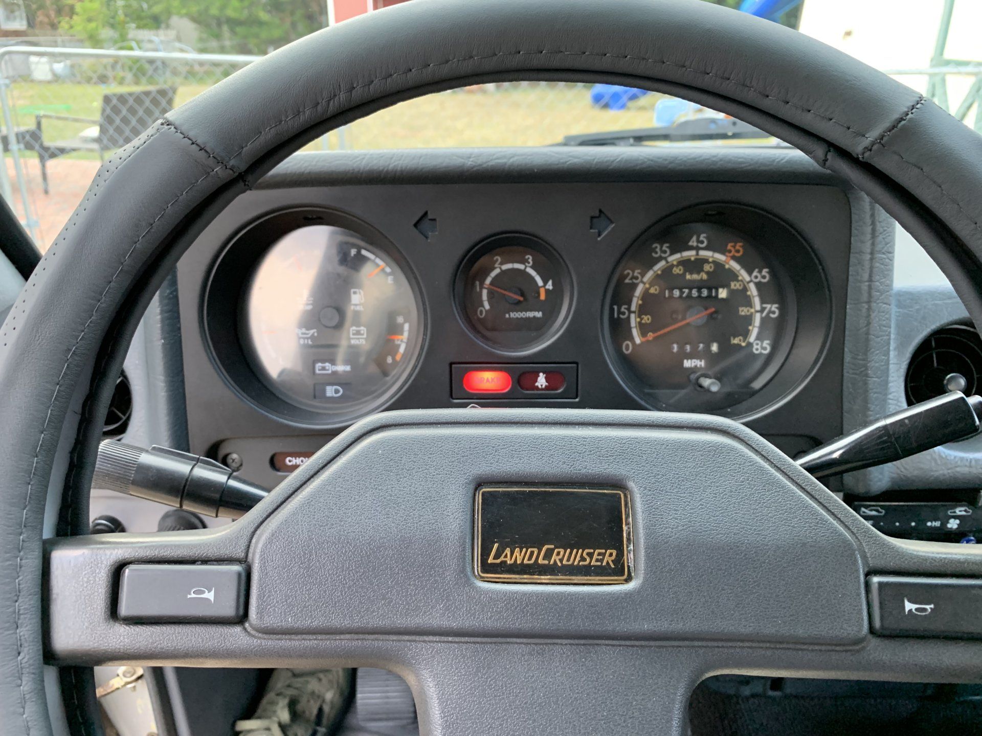

Hard to tell, but updated paint on all the plastic bits below the dash pad. I decided the leave the metal alone because it has a very subtle patina I like. Reminds me of all the grey Cold War metal furniture I grew up around visiting my dad at work (I know, weird). Also added the volt meter to the cig lighter hole. I actually dig the original green backlighting on the dash, so I'm sticking to green with any electronic updates up front.
Cleaned up the gauges and painted the gauge panel...

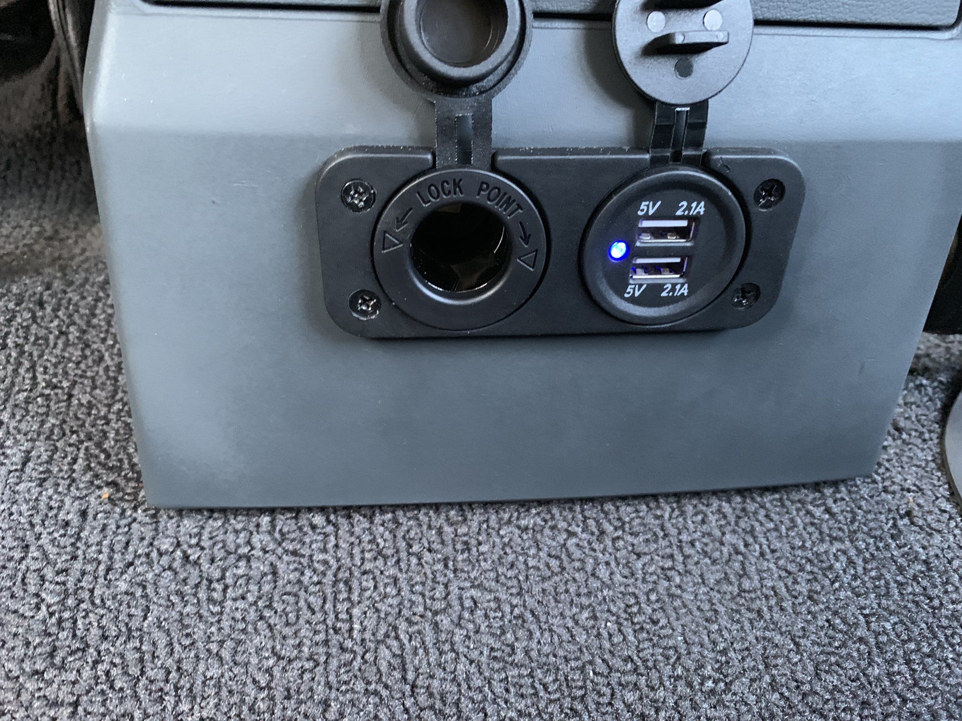

Rear USB and 12v socket installed in the rear of the console for passengers...

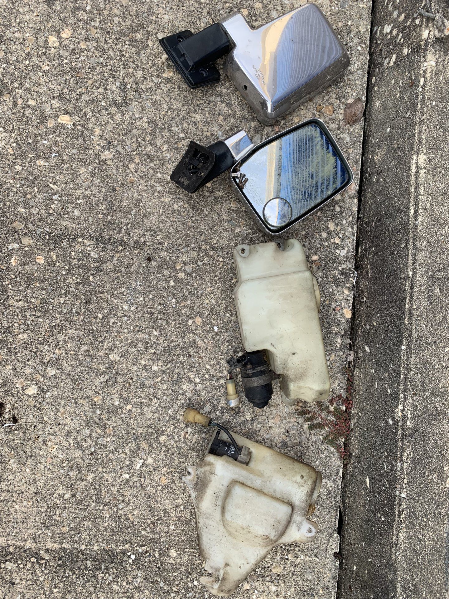

Harvested some good parts from FJ #2, but didn't finish installing them. I put some fluid in Chloe's rear bag and tried the washer out. Nothing on the window, but a nice steady stream of washer fluid coming out the rear through the headliner :confused:. Dried it up and called it a day. I'll chase tubing some other time.
Well...hard lesson learned. I pulled the two FJ62 mirrors from my donor truck to put on Chloe. While screwing around with the DS mirror to figure out how I could take it apart to refinish it, I broke the glass :mad:. Luckily, a quick web search brought me to this site for replacement mirror glass. Better than having to buy a whole assembly for a bunch more $$$, but my "free" mirrors just became $20 mirrors. Not bad in the grand scheme, but I'll definitely start slowing down and being a bit more patient when handling these 30+ yr old parts!

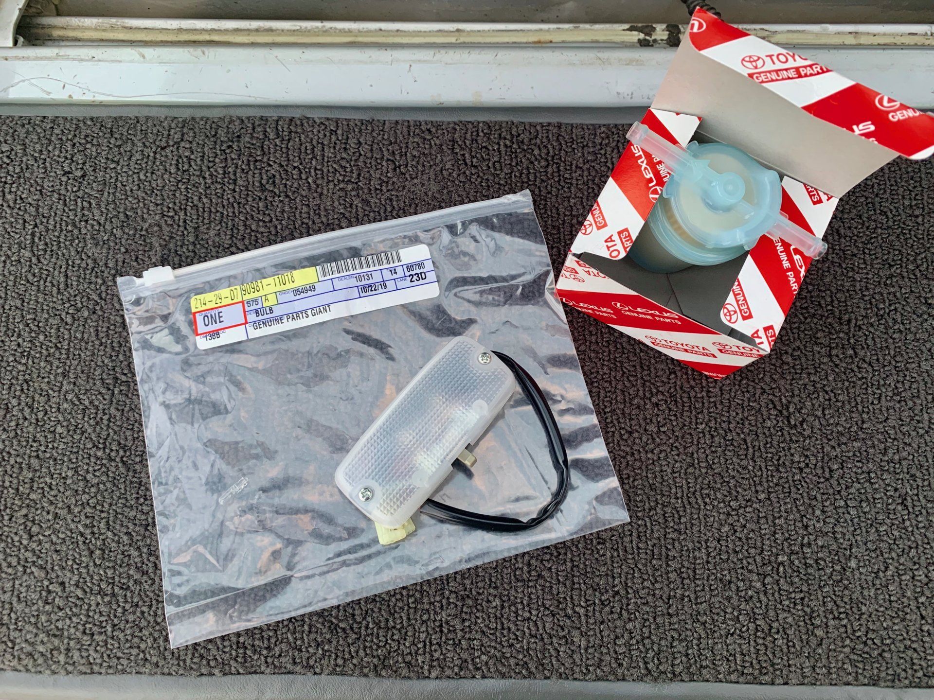

Small projects for a Monday evening. New rear light assembly, fuel filter, and glove box bulb installed!
