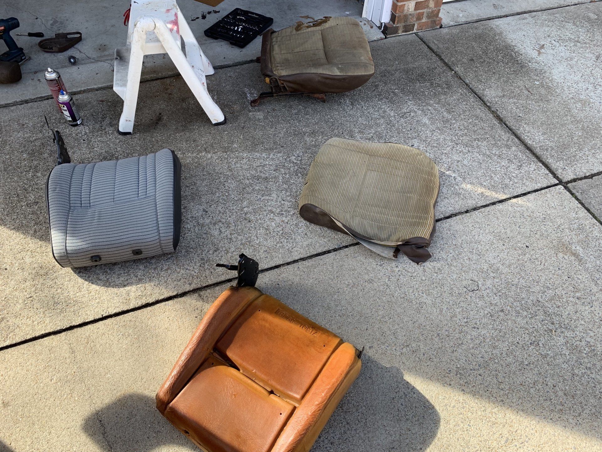

Performed a little seat surgery today using the frame I picked up from another MUD member. A little steam to bring the foam back to life, maybe not totally but better anyway, and some upholstery swapped...new seat back.
So nice to have a seat I can adjust!!!

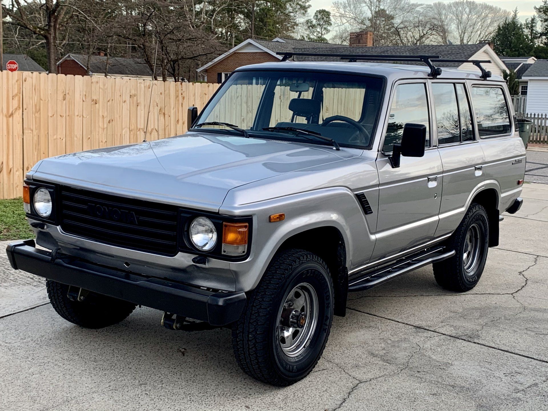

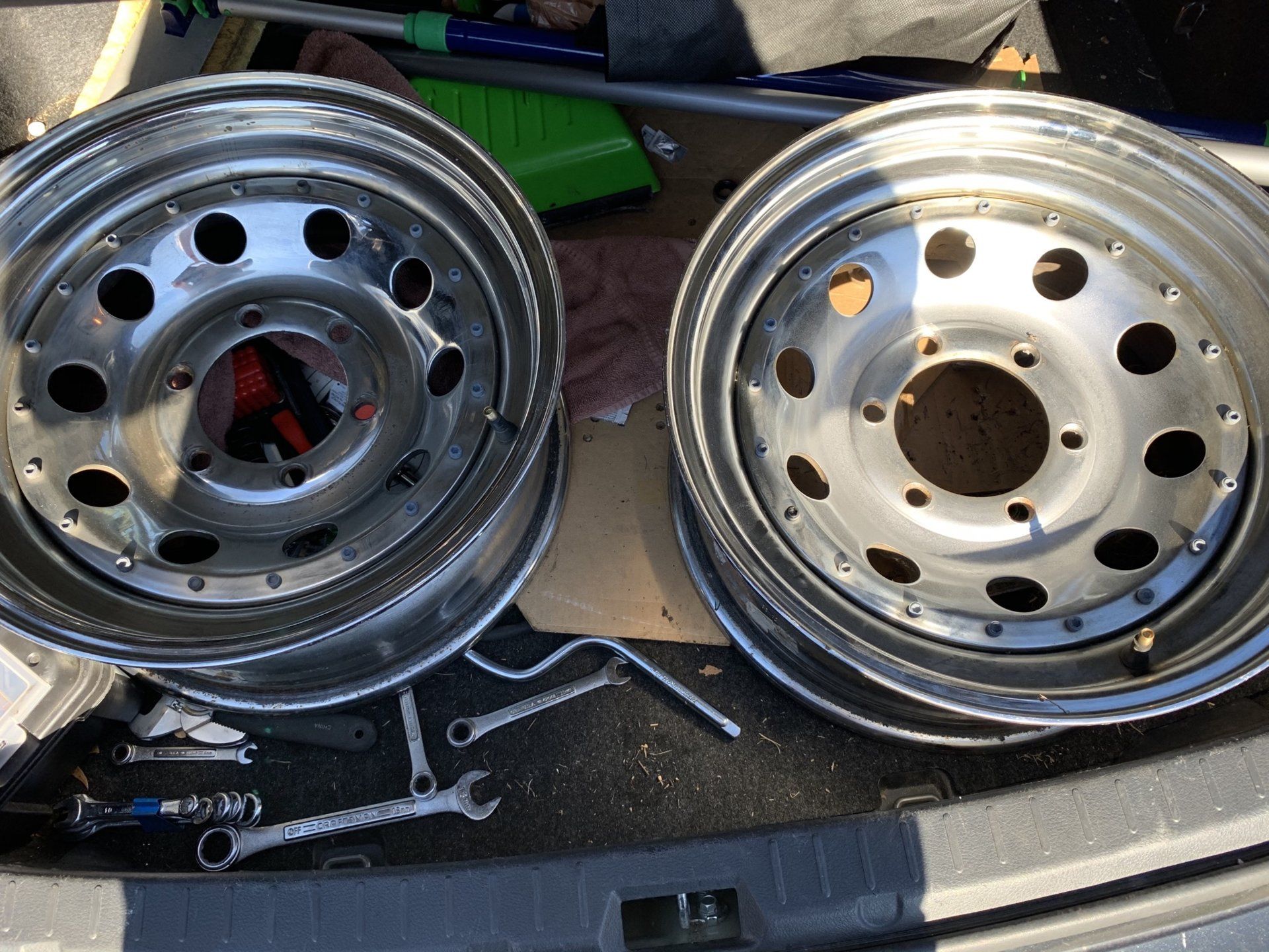

This thing is going to look totally B.A....

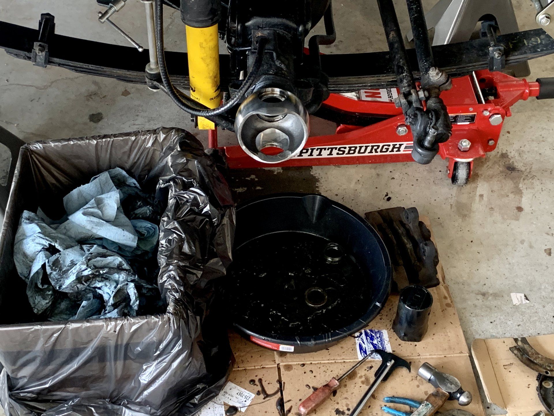

I actually did get these put on Chloe tonight, but didn’t make it out for a test drive. I sprung a leak in my DS caliper and suddenly had no brakes. One day I’ll get ahead of the game on the thing :rolleyes:
