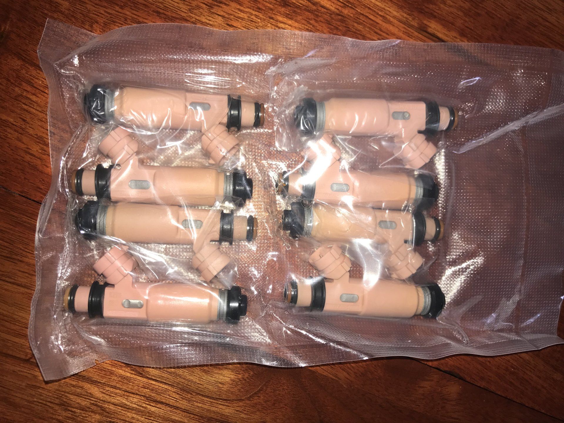

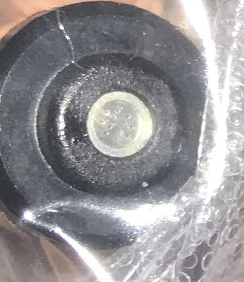

Just came in this week. Along with with all new oem rotors and pads, an oem right rear speed sensor, and valve cover gaskets these will be going in this week.

Murckman, did you install injectors? How they working for you?
I did get them installed. Still kind of feeling them out. My truck was out of commission for about 4 weeks prior to getting them installed. I had a bunch of work done; front and rear oem rotors and pads, front calipers, valve cover gaskets, speed sensor, X2 27F battery, and the injectors.
I can’t say I really noticed anything considerable right away with the injectors. In fact I contacted Keith at Dirty Deeds to find out if what I installed were the right ones for my application (Unichip with catback exhaust) because I didn’t feel an immediate change. I was contemplating reinstalling my existing 4 hole injectors just so I could see if I felt a difference. He assured me the 250 cc ones were correct.
So now after about 3 weeks I’m still somewhat on the fence about it. Don’t get me wrong, the engine does run great with these injectors and throttle response on the low end feels better. On the higher end I felt my 4 holes made the truck pull better. There was no change at all in fuel economy.
Again, I hadn’t drove it for a month so it was hard for me to tell. I honestly don’t think there was any horsepower change (and no I’m not going to do a dyno) but it may have slightly changed the torque curve. The 4 hole ones that came out still looked really good and I did keep them. I figured after 17 years and 160k getting new ones wasn’t a bad idea. I may eventually swap them back just so I can see if I feel a difference between the two without a month downtime.

Murckman, I would recommend you get an OBD monitor device of some sort and check out the air-fuel ratio when WOT. With the Unichip and exhaust it's possible you are going lean with the 250cc injectors.
A cheap bluetooth adapter like this and a smartphone app like Torque and you can read your AFRs: Konnwei bluetooth adapter
You want the AFR to be in the 12-12.7 range for best HP.
