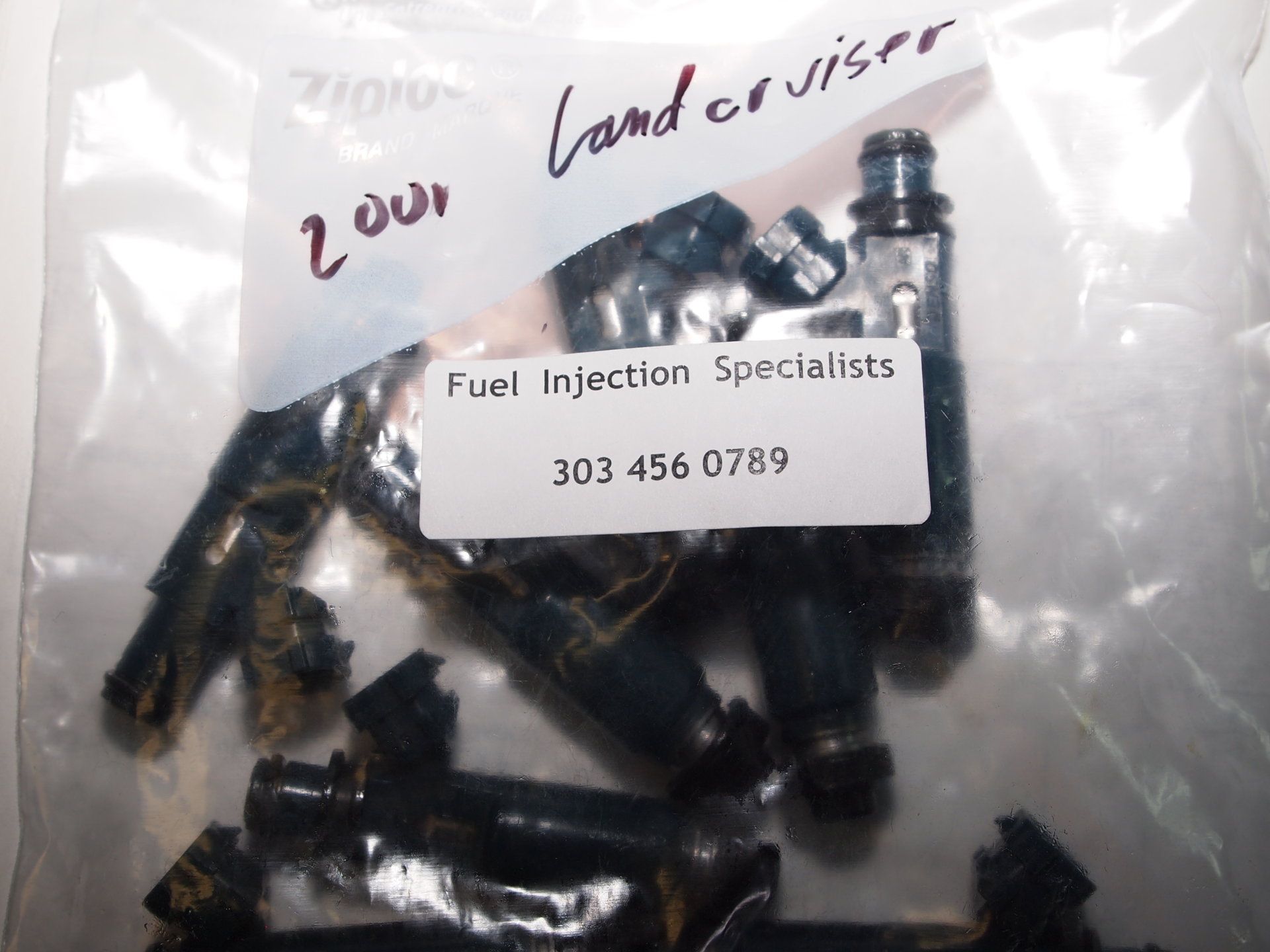

I'm sending a set out now, to FIS for servicing. They'll be tested, cleaned and rebuilt which is only way to know condition for sure before installing. Serviced one's, need installing and used within 30 days.

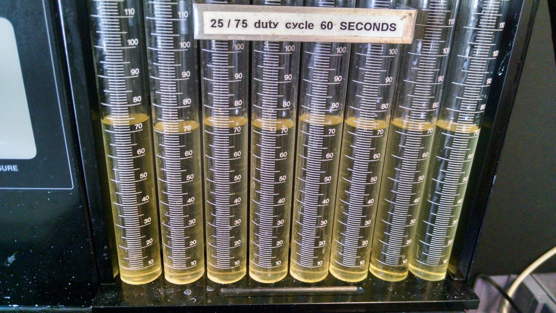

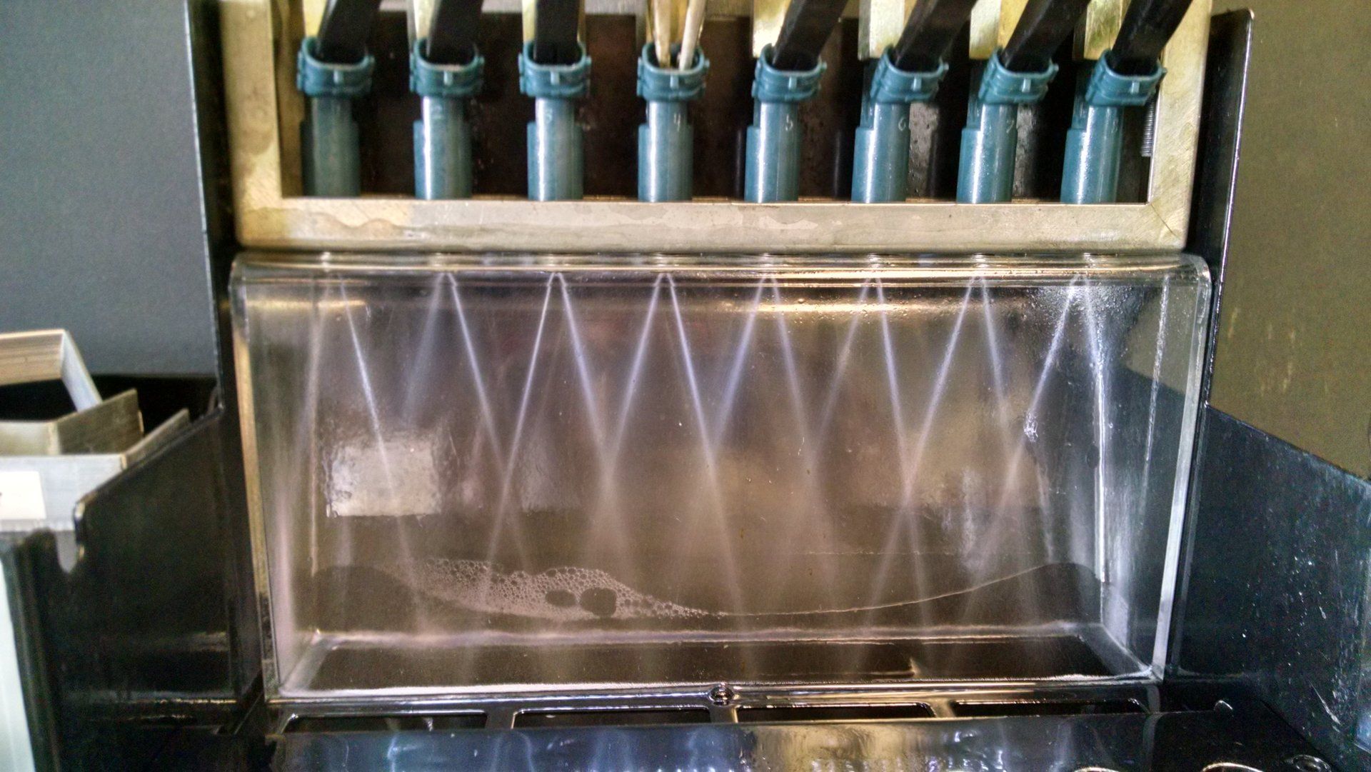

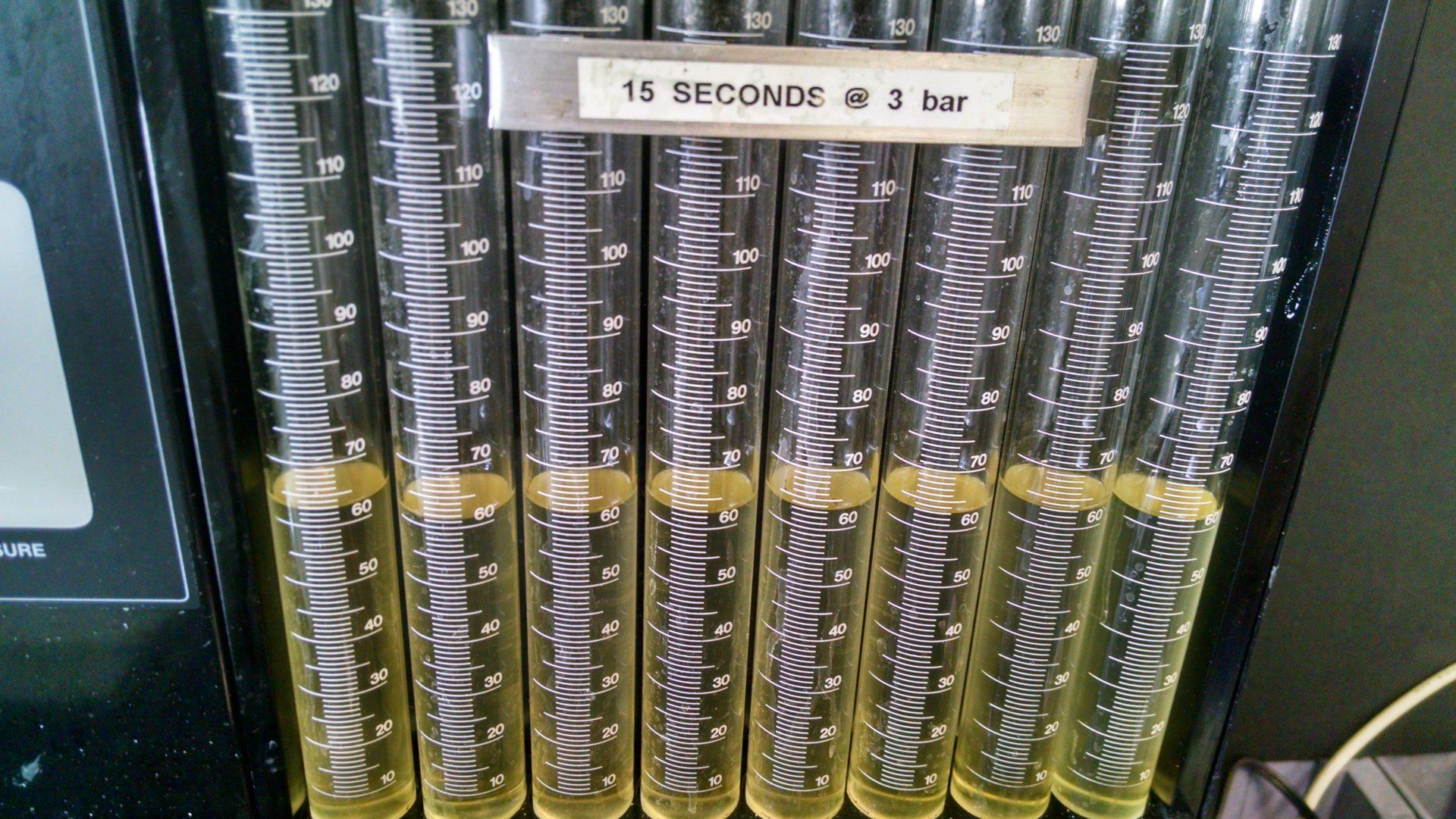

What are your thoughts on these lovely looking 12 hole injectors? I'm looking at something like this down the road since we don't have a local shop to clean/test (I also have one car to get me where I need to go).I send them out to be cleaned, tested and rebuilt. During testing they look at leak down rate, flow volume and spray pattern. It's the only way to know for sure.
