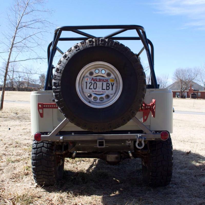

Here's some pics just to put the proper ending to this build thread.
And some more. I might update this thread a few more times as I take care of the little things that a potential buyer might like to be done before buying it.
