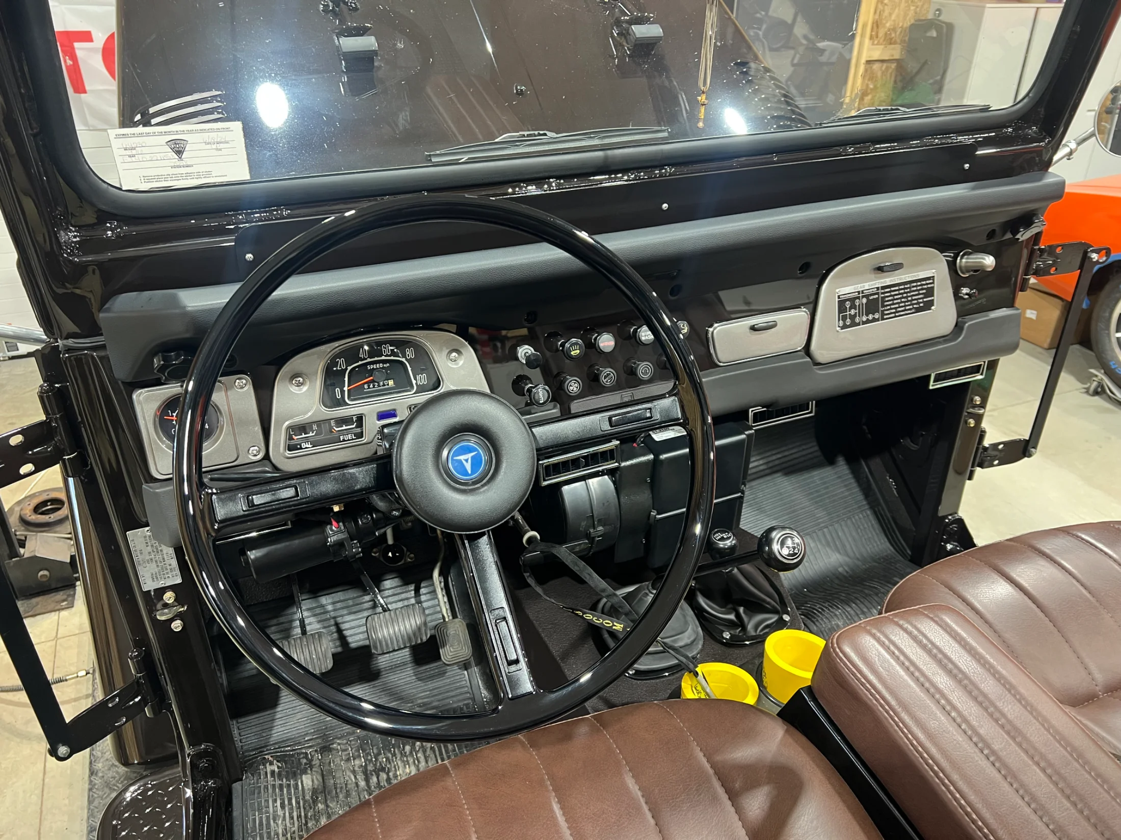

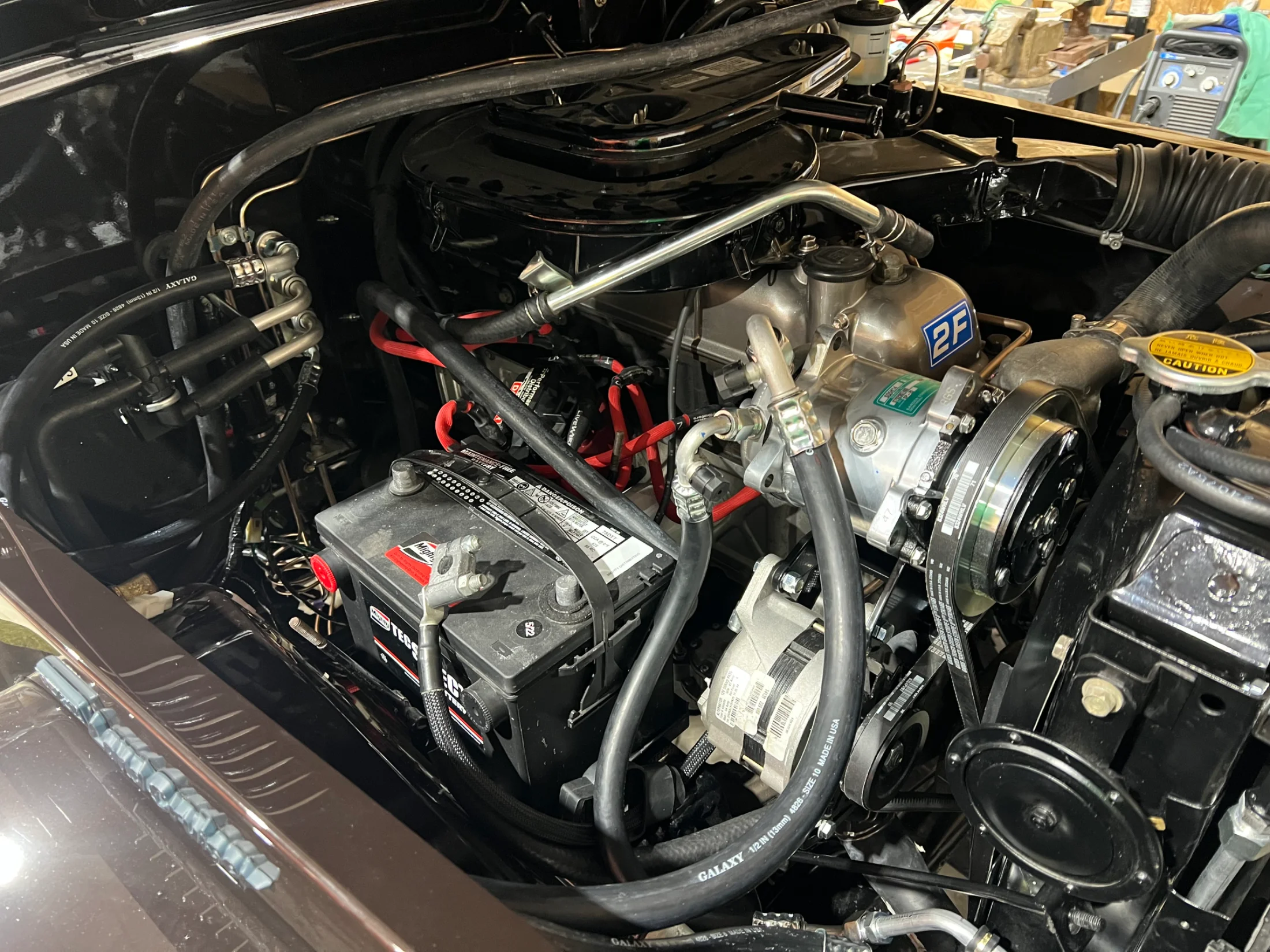

Old air/Vintage air combo in a 40 series. Spaced the vents out for a more even air flow. A/C tested this summer = Game changer. So far I’ve only tested the heat on a cool morning. Initial results are outstanding. Cold/frost test TBD.

Thanks for the note and feedback. I like the sound of that! Timing wise, I’m probably another winter and summer away from making any moves on heat/air. My part of CA is pretty mild, nothing an extra pair of pants or gallon of water can’t fix.
Looks like the interior hardware all stays where the factory heater was. I like the look of that. Looks like it could work RHD too, so you think?
