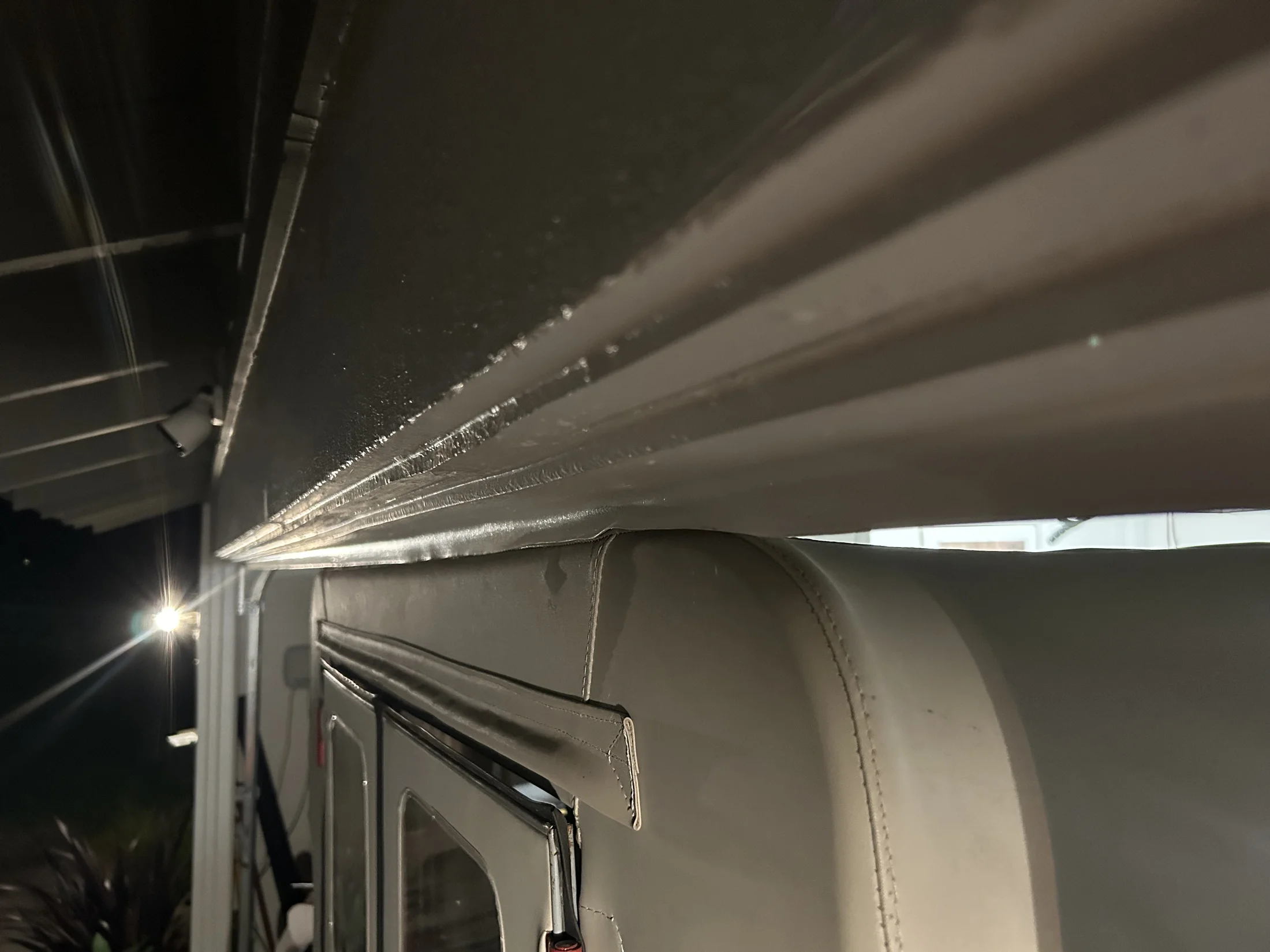

Is airing down or taking the top down/off an option?
I can, and that’s pretty much what I’ve been doing, just to get by. But long term I just want to be able to pull out, drive and pull back in. Any more effort than that and I won’t drive the 43 as much as I want to.

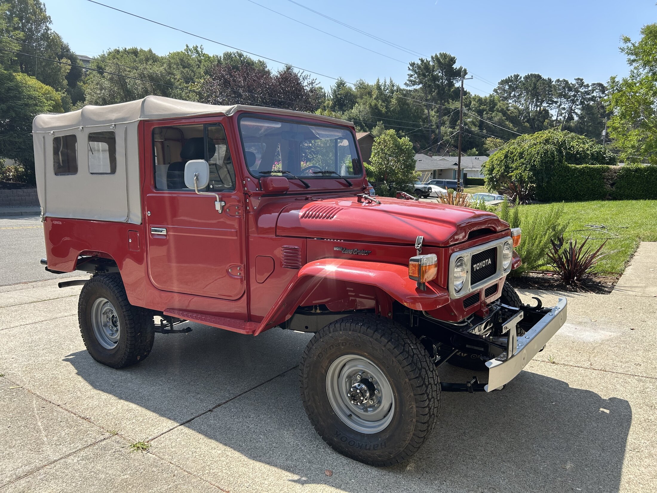

I think I got it to work. Last week I adjusted the upper stop of the garage door, allowing it to open more and stop slightly above the actual framed opening. I also put on my final tires, 235 85 16s. And dropped the air to a more comfortable 25psi. I’m now fitting in/out with about 1/4” clearance on the passenger side. 3/4” on drivers.
This rig has proven to be exactly what can be expected from Colombian rigs. I wasn’t understanding the side to side height difference, until I checked the body mounts. Different sizes installed left to right but only on the last 3 rows of mounts. 43s seem to have an extra row over 40s. Add it to the list. New mounts will be ordered soon. Hopefully I don’t find some other reason for the mismatch hiding.
