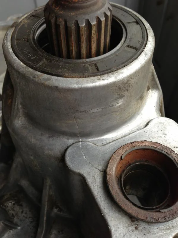

found a crack in my split case?
I was cleaning my new split case and noticed a tiny "crack". It doesn't appear to go all the way through to the inside. I'm not even sure if its a crack or some kind of casting defect. What do you think? Should I get another one, leave it alone, or have it welded?

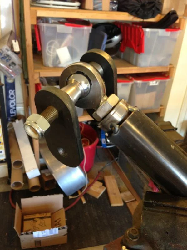

Anti-wrap bar
Today I'm working on my anti-wrap bar. This will be as close to centered on the axle as I can get it. Hopefully it won't limit travel or have any binding. We'll see.

Anti wrap bar progress
Don't put the bushings in to mock it up and definitely don't think you can weld it with the bushings in there (since they're so hard to remove)
