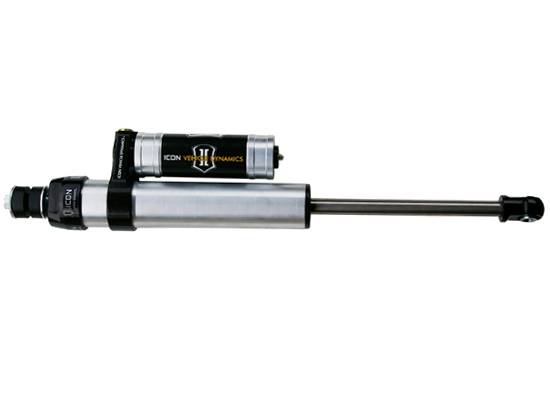

Finally had a chance to lower windows and drive through potholed dt streets. Rear noise is still there (metal on metal snappy noise and loud at times). Front ICON shocks make this odd pfffft noise over abrupt bumps and of course when you call them they can't diagnose it over the phone.

Noise reduced in rear, but still makes noise over certain type of bumps at speed. Clack!
Decided to dump the OME 61029 shocks and go for the 57725 piggy-back ICON shocks.

I would be interested to see if that fixes your problem. As we discussed on the phone, the OME should not make noise. I would expect some noises from a remote reservoir shock more than a regular twin tube shock. You are now going from a bushing, bushing mounted shock to one with spherical bearings on the bottom. The changes of those starting to make noise is a lot greater than the bushings.

christo, same here! As we had discussed via this thread and in our phone conversation, the real challenge is finding the right help who knows the 200. Metaltech comes recommended by ih8 and icon. They were kind enough to accept a Saturday appt which I appreciate. The thing that confuses me about OMEs is that if the factory shock doesn't require extra washers for added pre-load, then why does the OME sometimes require this?

They should be able to take care off you. The extra washer is really not a big deal and I would not stress about that. Any installer of shocks should know what the bushings need to be preloaded to and what it looks/feels like when installed.
We discussed what I believe is the problem, but not sure if you ever go that conveyed to the installer. Either they have two index washers on both sides of the frame mounting hole and the lips are touching each other, but the shock is not secure, or they have the lip not centered in the hole.
