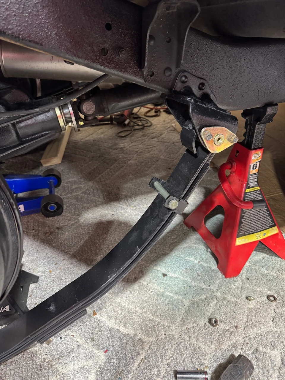

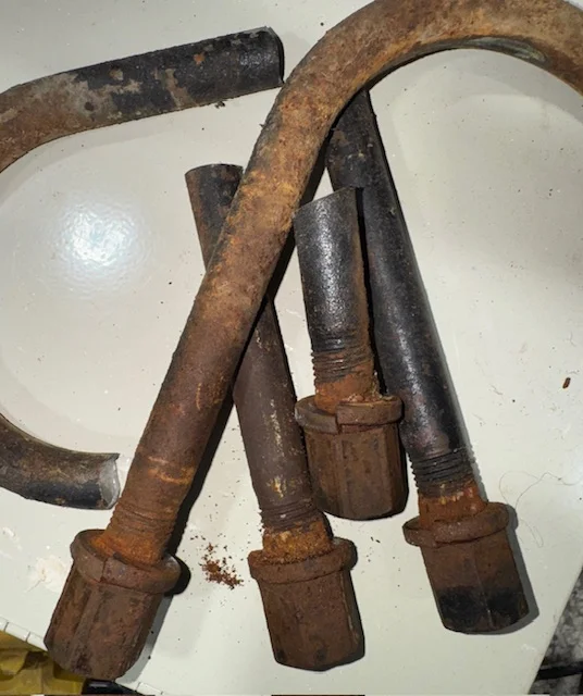

Made good progress today until…I had to break the rhythm and stop. But, here is a picture anyway. These was no way these were coming off whole. I was a set to put the new spring in place, new bushing in and lubed.

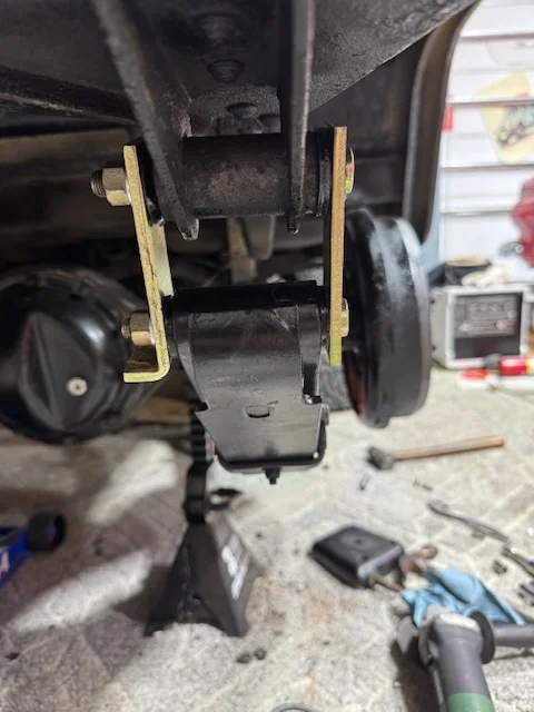

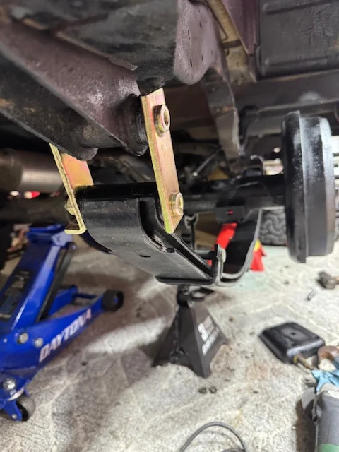

Just drawing the spring pin slowly closing the gap to the perch
Finished the job ! Went around the truck to make sure everything is properly torqued. Had 65 lbs on the u-bolt nuts. I read that Terrain Tamer suggests 80 lbs. I dialed in 80lbs on the torque wrench but after 2 more cranks on the wrench I let it sit until I can get a few easy miles under my belt and I’ll go back and re-torque them. Greased all of the zerks …12 more currently

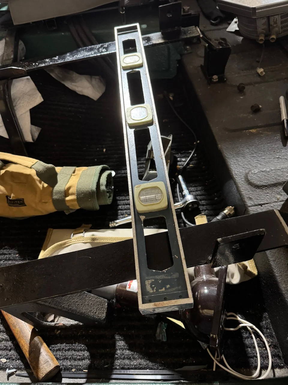

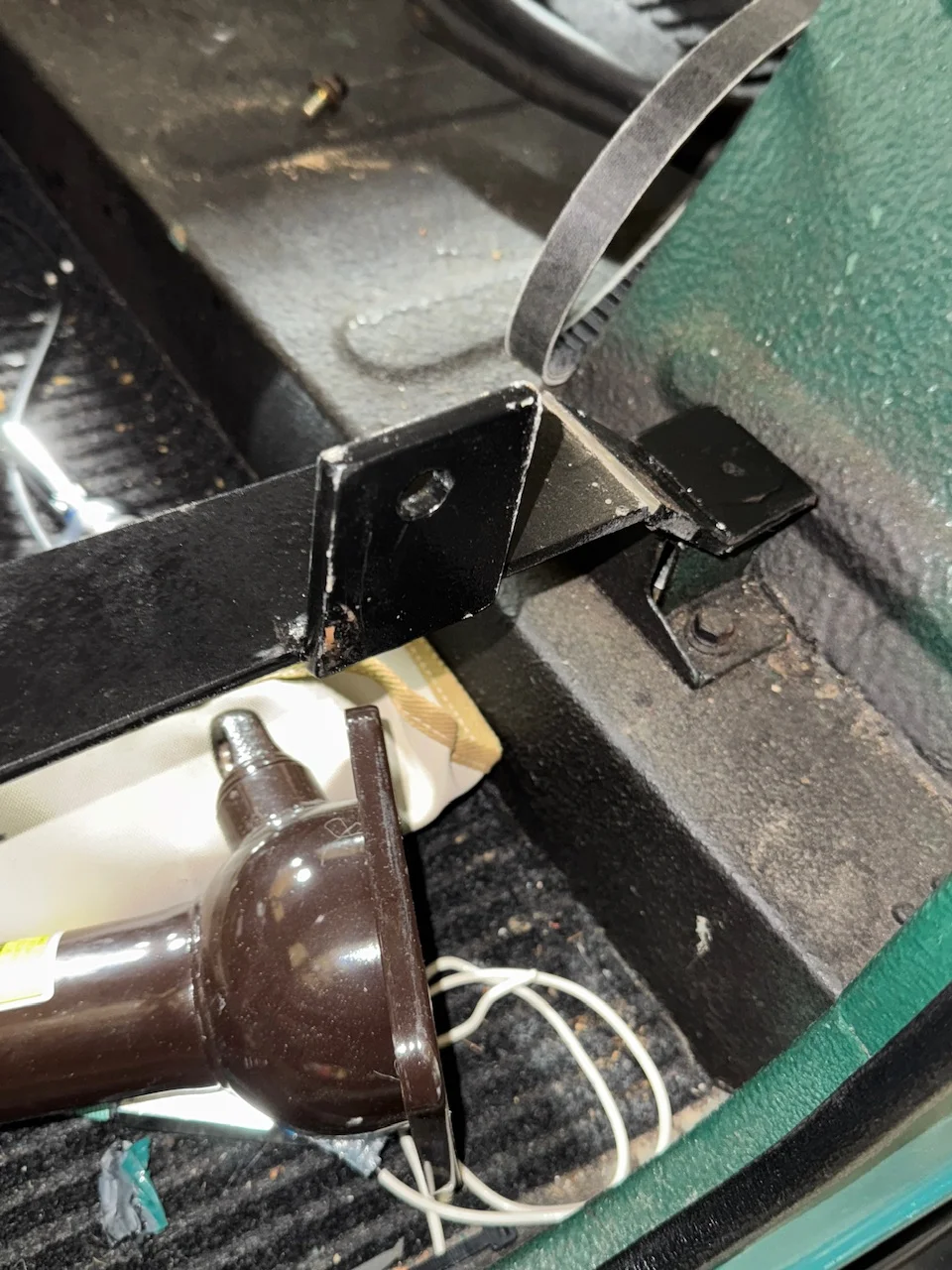

Went back in the garage to size up what the ProCar seats is going to involve and starting to get the welder setup. I decided despite my own fabrication I would order one of these brackets to see what it looks like and how it was made for the application on the FJ 40.
it looked pretty decent and actually looked very nicely made, and seemed to follow the exact lines of what I have been planning to Weld together.

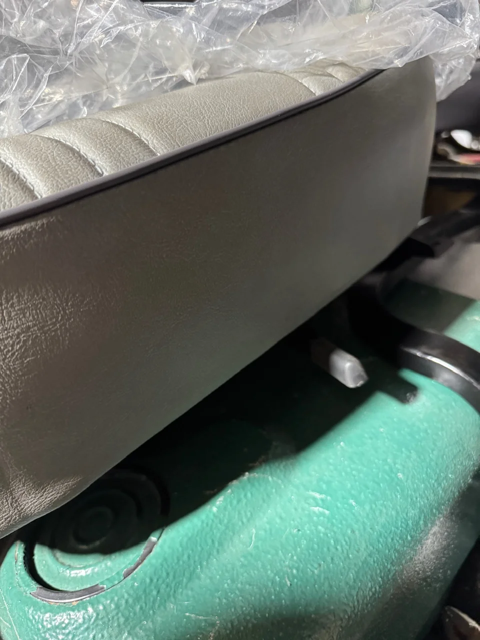

I unbolted all of my welding pieces from the seat frame and swapped the pro car seat bracket for the Land Cruiser in place.
Within 45 minutes the seat was fully installed and looks terrific so I parked my ass on it and quite frankly it’s about an inch and a half higher, which is exactly what I was looking for. Firm enough to support you comfortably and exactly as @1911 did say it’s much more comfortable than that 50 year-old dead foam.
I ordered the drivers side bracket a few minutes ago. That’s how well it fit.. plus they do recline,
something that would have been a benefit 50 years ago.

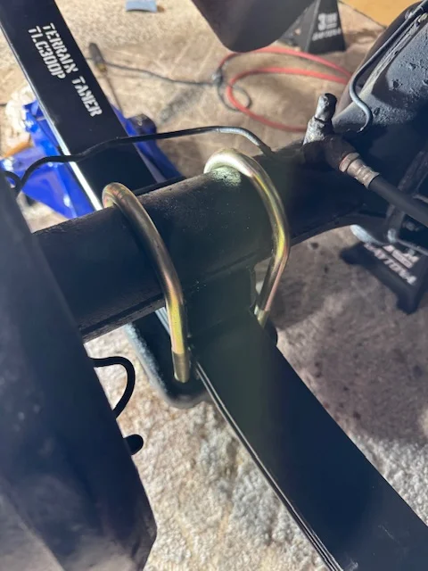

@JKIII FJ40 i tend to think the springs are a very nice upgrade. I don’t have a lot of drive time yet. Once you “finish” the job you then go back and double check each nut and fitting. The new u-bolts have to be cut twice. During initial tightening, my deep sockets were not deep enough to close the gaps fully so cutting 2” off of each gave me the next step to draw the springs up fully. They are still hanging below the u-bolt plates. Then you’ve gotta grease all the 12 new fittings for the bushings with the recommended molybdenum disulfide grease

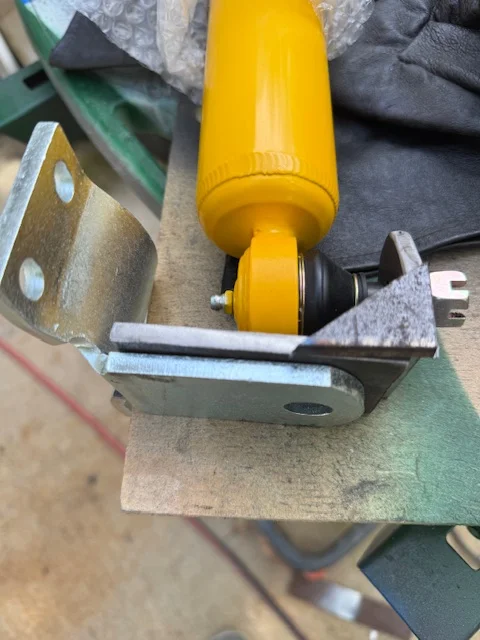

One other development in my case is the Saginaw power steering. The Terrain Tamer steering stabilizer fits the stock pitman arm since it is equipped with the required hole for the stock mounted unit. Once you change the arm to accommodate the splines of the steering gearbox, it’s only a straight piece and has no mount.
So the required stabilizer is now a pin to pin mount with the mounting hardware bolted to the axle and the tie road. Many of the older cruiser add on stabilizers used this method. I think my ‘74 was one of them.
When I discussed this with @orangefj45 , he’d suggested selling the one I have and using something like the rough country types that do mount this way.
I did not care for that option… and here’s why. When I took the TT stabilizer out of the box it was a bigger and heftier monster stabilizer…I did not want to give it up.

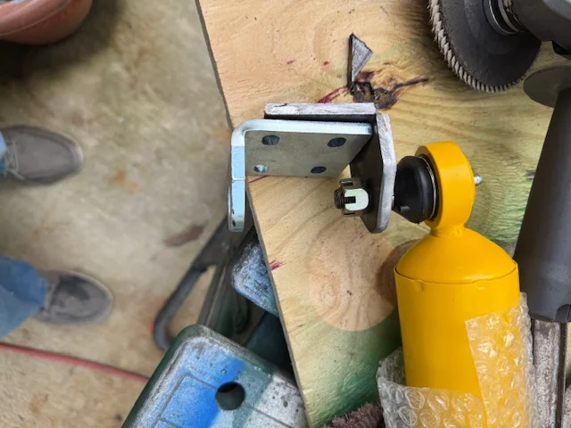

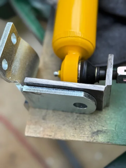

I ordered the rough country one and took the hardware out to modify it to accommodate the Terrain Tamer stabilizer and here is my starting point
I just need to remember to mount the grease zero to the side with the most clearance for lube time.
@orangefj45. Do you or anyone else see any problems doing it this way…something crazy like geometry and outside forces impacting steering control…physics just ain’t my thing. Welding this up today
I should add: when I say it is bigger and tougher feeling… by comparison, the new rough country stabilizer looks to be about 20% thinner than the TT model

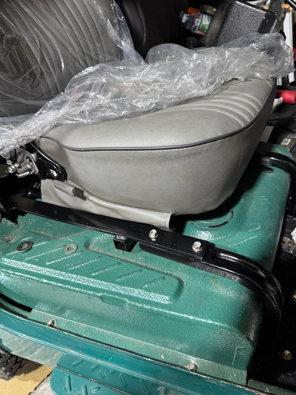

I found out today the drivers side seat adapter for the Pro-Car seat won’t be shipped until October 19. The passenger side is in and works perfectly and it would be nice to get it all done.

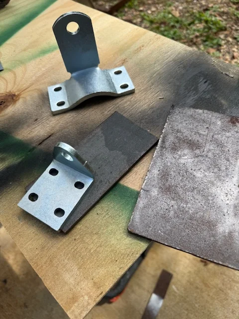

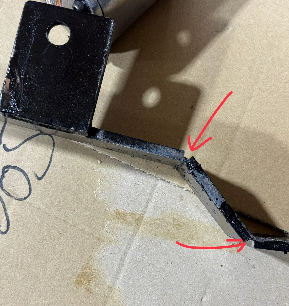

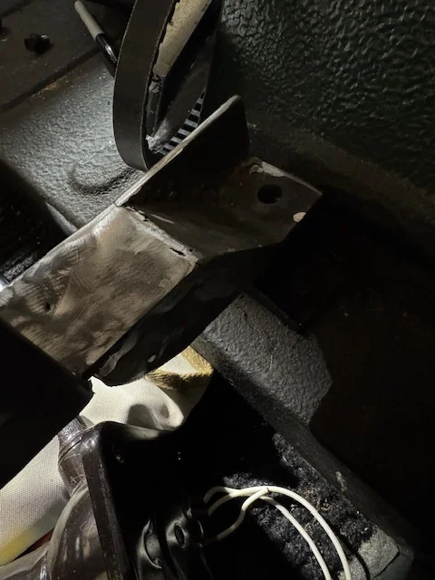

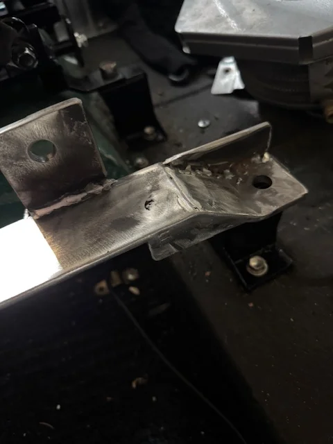

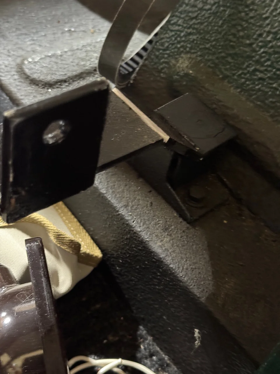

Enter 1/4” flat bar stock. Took the measurements and realized the bends in the original seat mounts accommodate the rise that the seat has naturally. I found a few angles that will allow me to re-create that same effect without adding spacers to the rear of the mounts. Cut, bent, leveled and welded the bars. This worked out very well.m so tomorrow I can finish up the mounts and get the seat installed. Here are a few midway photos.
It will need a major cleaning and vacuuming when it’s finished…it looks horrible in there now
Question for real welders…. In order to work the steel with two 45* bends for that flat bar, I cut a groove across the flat with a cut-off wheel but only 1/2 way in depth. Once I get the bends I need, I will weld up that gap as you can see in these pictures to restore the “strength” back in.
How does this actually affect the metal?
I am also adding a gusset above and below each bend
MIG…. .030 carbon steel wire probably run of the mill, 1/4 x 2” flat bar… cold roll 1018 . it was left over from my junk pile

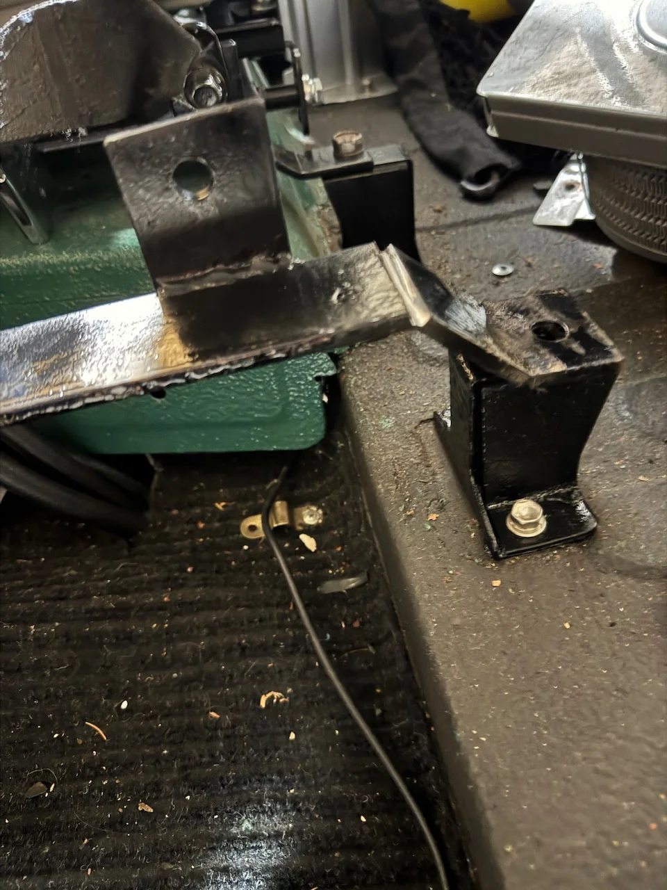

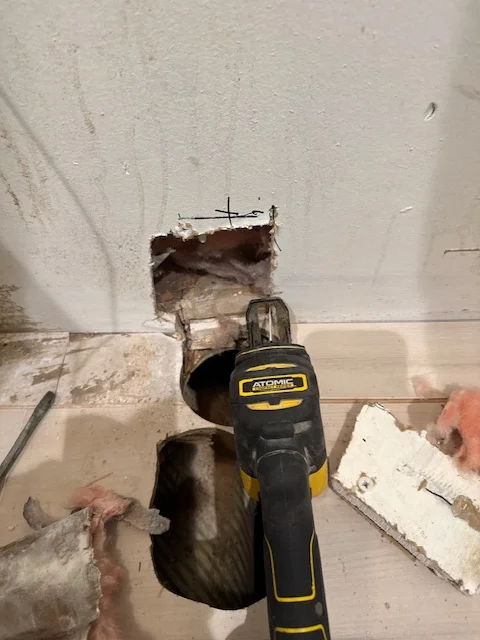

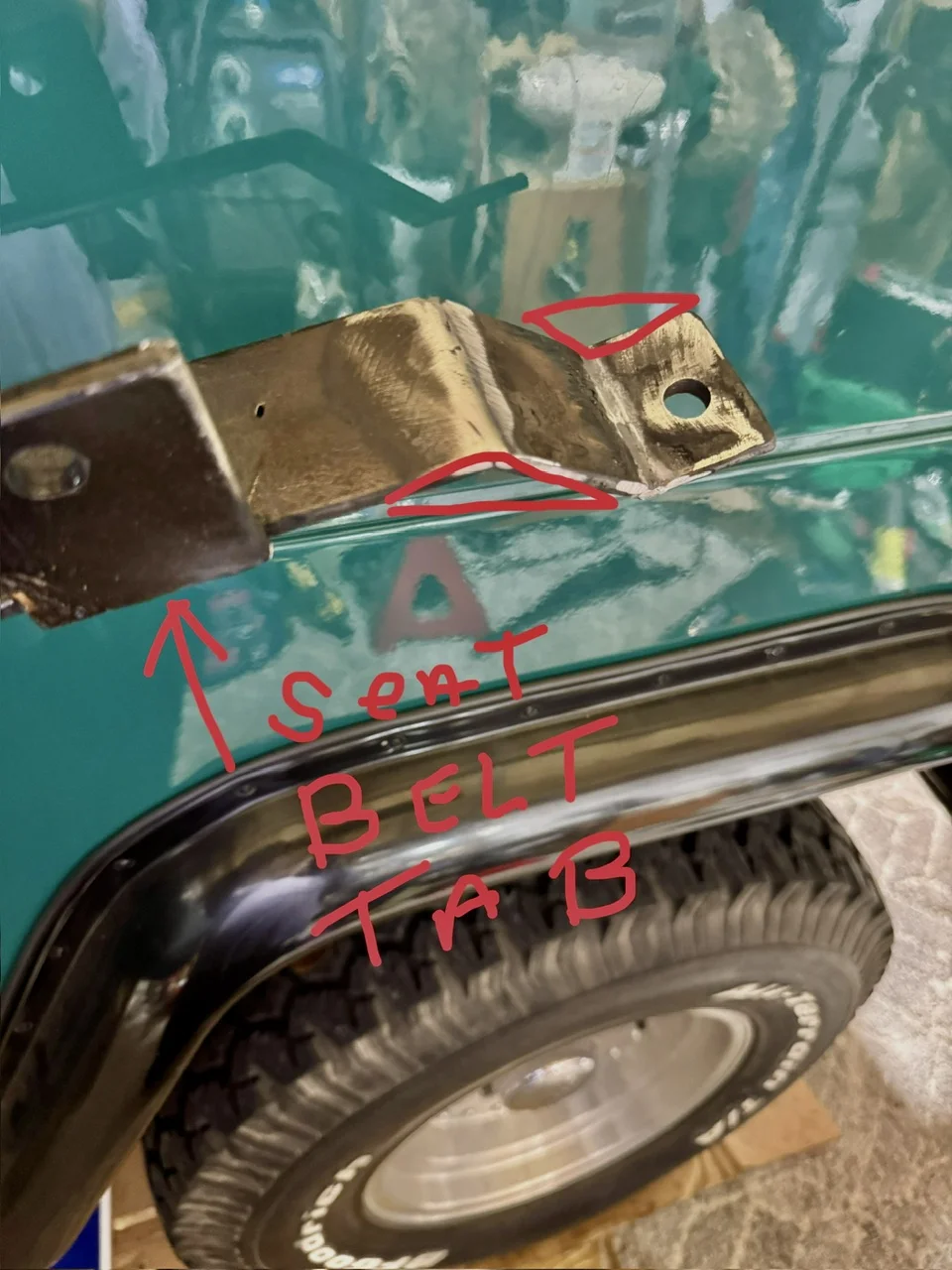

Wanted to finish the seat mounts for the driver side… After my battle with the clothes dryer the other day, the new one was delivered and needed a custom install for the dryer vent. This 1 hour job took me 5 hours to finish so I could only get the main section of the brackets welded with the gussets so it’s off still until tomorrow to grind the rest
Here’s some pictures
